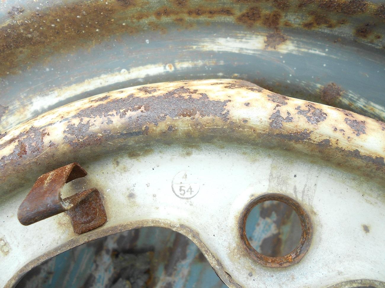

Another 4/'54 15" Bus wheel

PostPosted: Tue Sep 10, 2019 9:52 pm    Post subject: Re: 15" bus rim discussion thread Reply with quote
Might be worth updating the list at the front of this thread to include the 4/54 dated smooth face Lemmerz rims with 3/54 barrels. We now have evidence of 4 in existance(3 silver white, and 1 pgsg)
Added this pic of Longroof’s pgsg rim barrel:
Posts: 71533
PostPosted: Tue Sep 10, 2019 10:09 pm    Post subject: Re: 15" bus rim discussion thread Reply with quote
Thanks, I will add it
