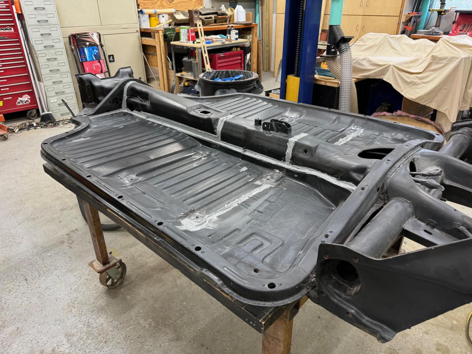

Got some stuff done on the pan, seam sealed and painted. Motor is out being assembled and had the transaxle refreshed with new bearings and a .82 4th gear.

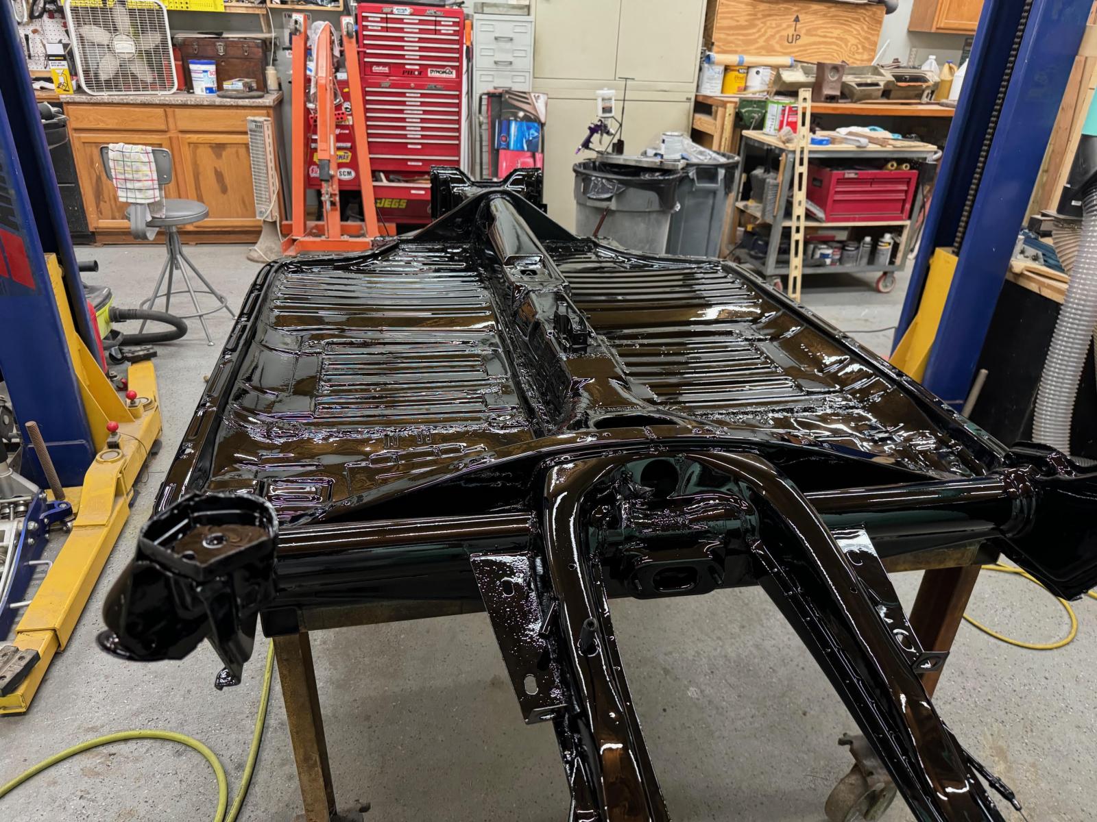

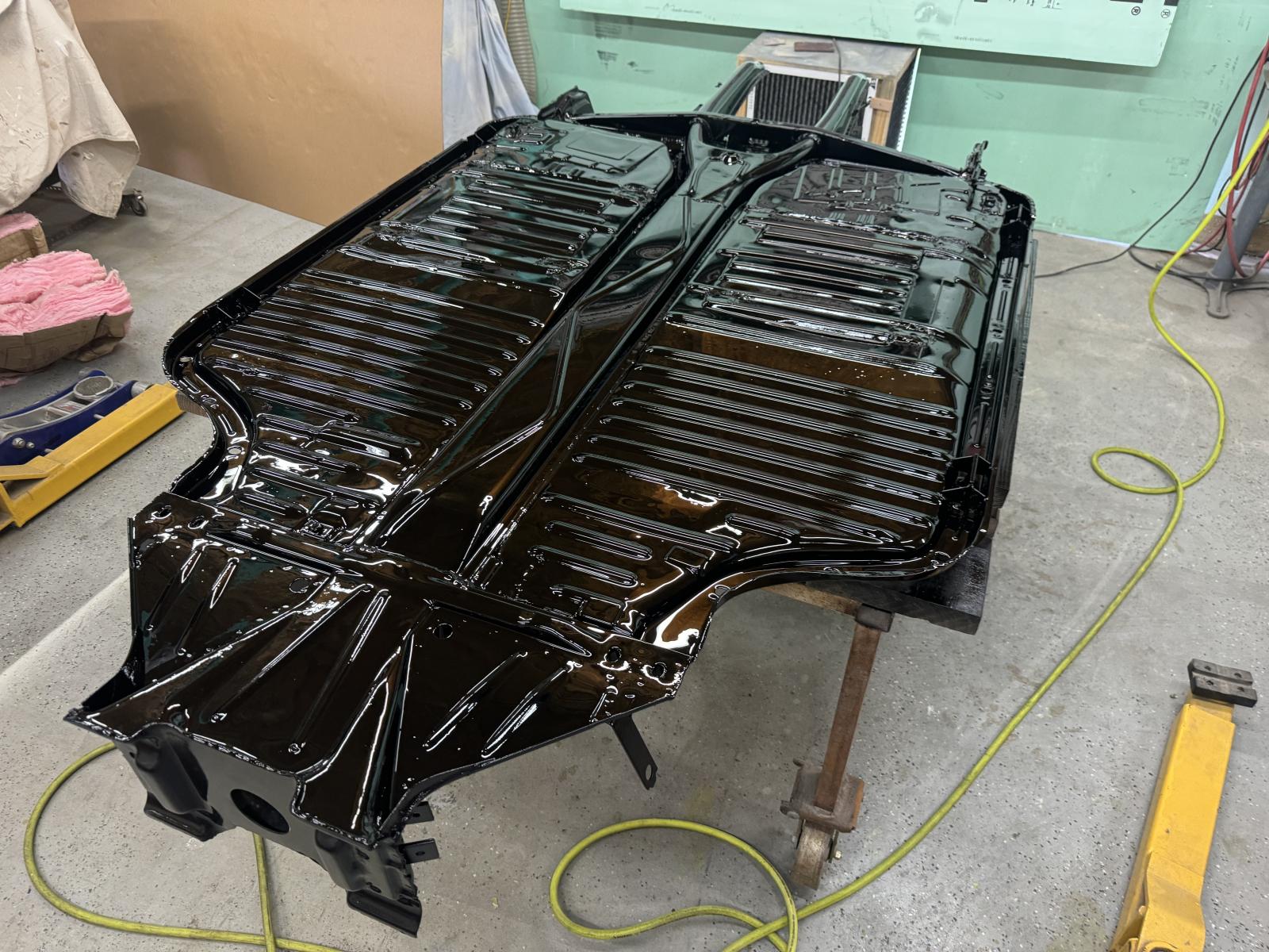

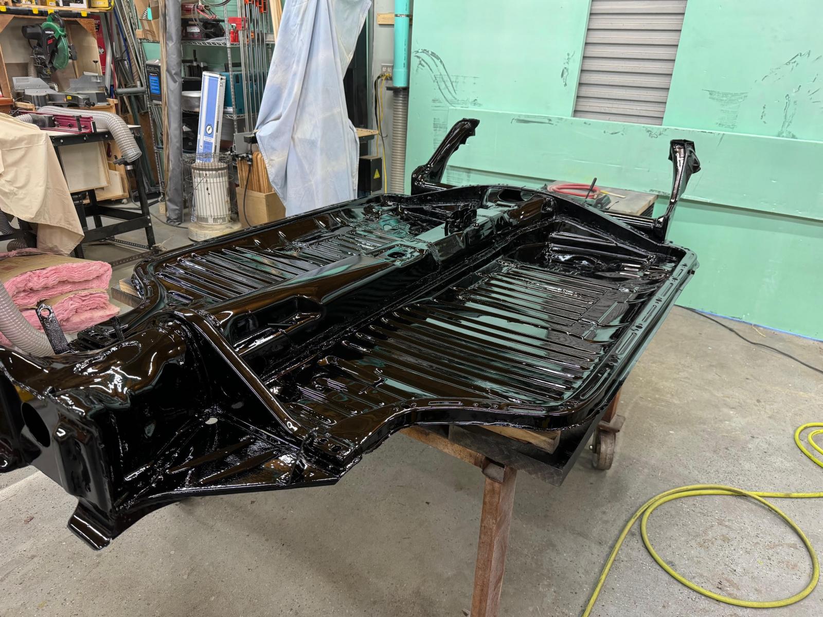

I let the top fully cure and today I flipped the pan over the spay the bottom. Well, I'll spray it when the extra quart of paint shows up. I spilled 3/4 of the quart I had to do the job. I'm using Eastwood frame paint.
Petfisheric
Joined: November 27, 2014
Posts: 141
Location: Knoxville, TN
Petfisheric is offline
PostPosted: Sun Sep 15, 2024 1:16 pm    Post subject: Re: Found my lost cat Reply with quote
And the final step before assembly, a fresh coat of paint for the bottom of the pan. Laughing Very Happy Laughing Razz

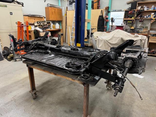

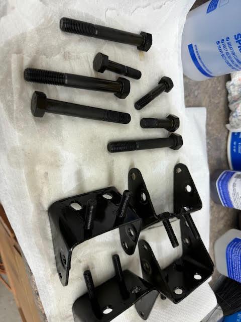

Got the pan on the assembly table and started putting parts on. Front beam is on, and the transaxle is installed. Waiting for a couple of part and it will be back on the ground with tires and motor installed. I also picked up chemicals to do black oxide for some of the parts and bolts.

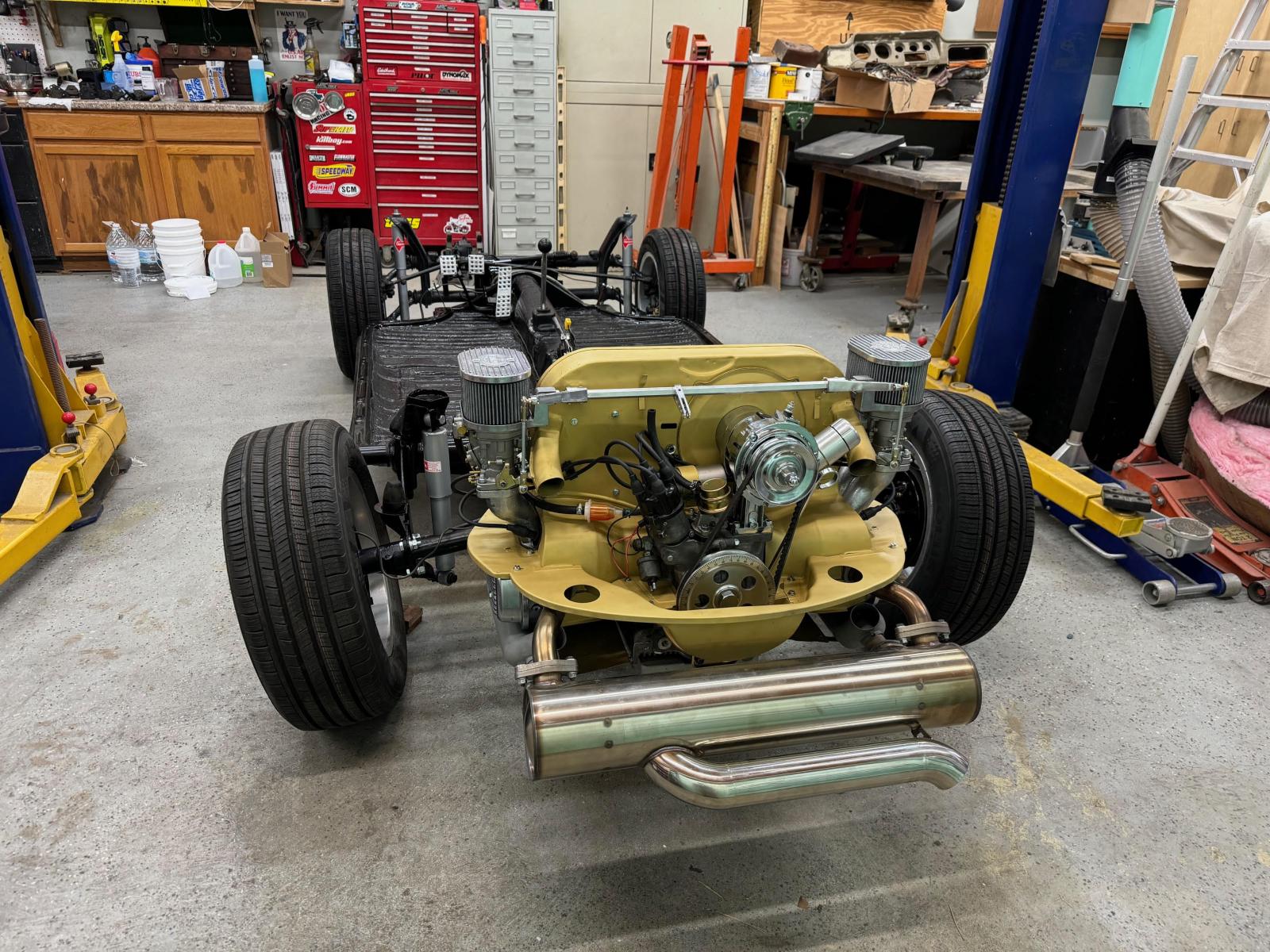

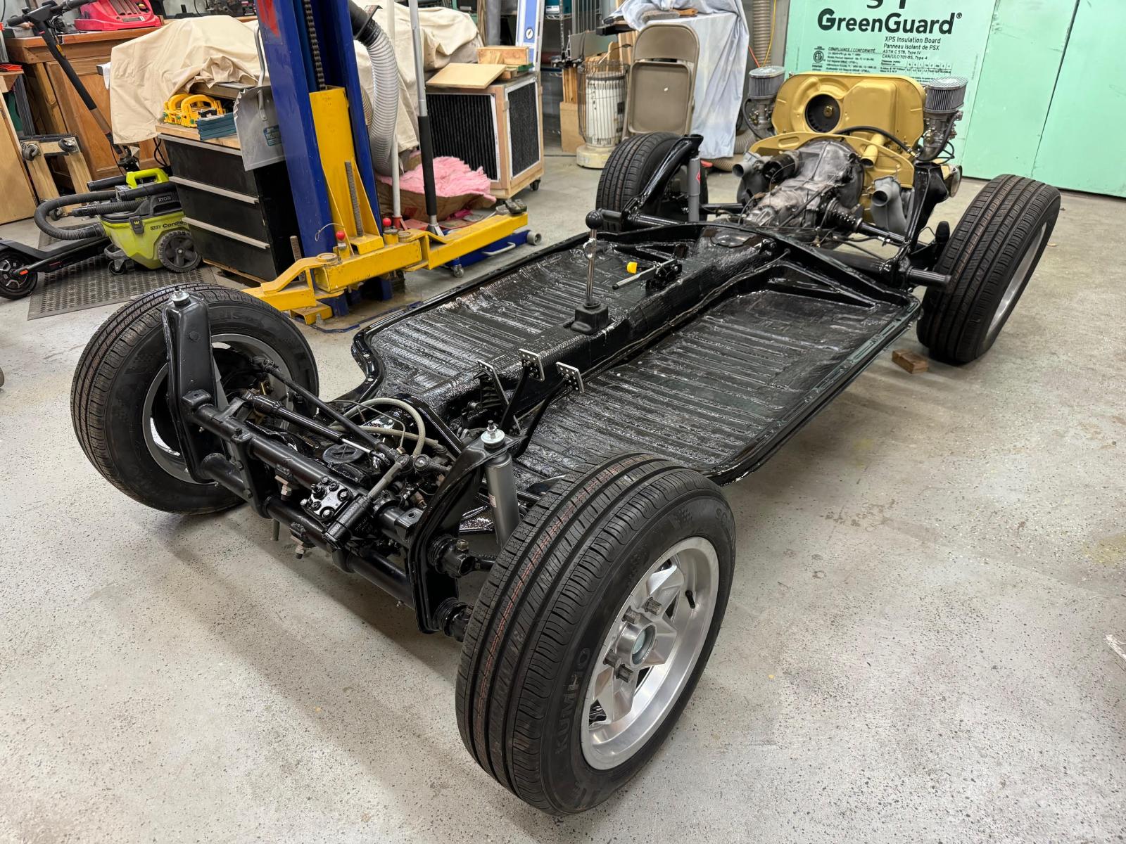

PostPosted: Sat Oct 19, 2024 3:10 pm    Post subject: Re: Found my lost cat Reply with quote
Bit by bit it's coming together. I got the rear brakes installed, wheels on, and motor attached. Biggest issue was getting the throttle cable to feed through the tube. I had some sort of obstruction in the tube around the cut line where it was shortened by the factory. Didn't have issues before so I'm kind of stumped as to what caused it. I was able to use a brass rod about twice the diameter of a coat hanger to punch it out.

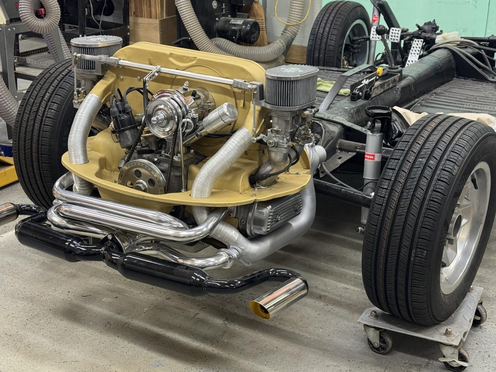

I've been picking away with little things. Did a test fit of the body and found the exhaust was not going to work. Super bummed on that the Vintage Speed sounds awesome. Had to get a tuck away merged header, not sure about the sound but it fits.
After the test fit, I had to make some adjustments to the engine bay. Puma wasn't concerned with sealing the engine bay and didn't take any effort in sealing around the engine tin. That always bothered me, so I had to fix it. Now it should seal up like the VW Gods intended.
Before
After
I also had to make some adjustments to the deck lid to take care of carburator air filter
interference.
