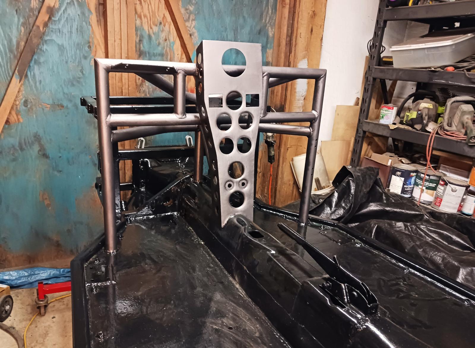

Today I finished the 3rd and last coat of black single stage on the chassis. My plan is to paint the interior section/console/steering support/roll cage and seats in metalic silver.. Once the black has cured and been scuffed up, it'll get a coat of grey primer followed by 'Volvo Lava Sand Metallic' and likely House of Kolors flat clear to finish.

Almost looks like I stripped the paint off again. I was going to do the interior floor/tunnel in silver as well, but I think the added contrast looks good too. The floor will be covered in butyl sound deadner (foil backed generic Dynamat) and industrial rubber mats over that. Another coat of base colour and I'll clear coat the whole chassis together.

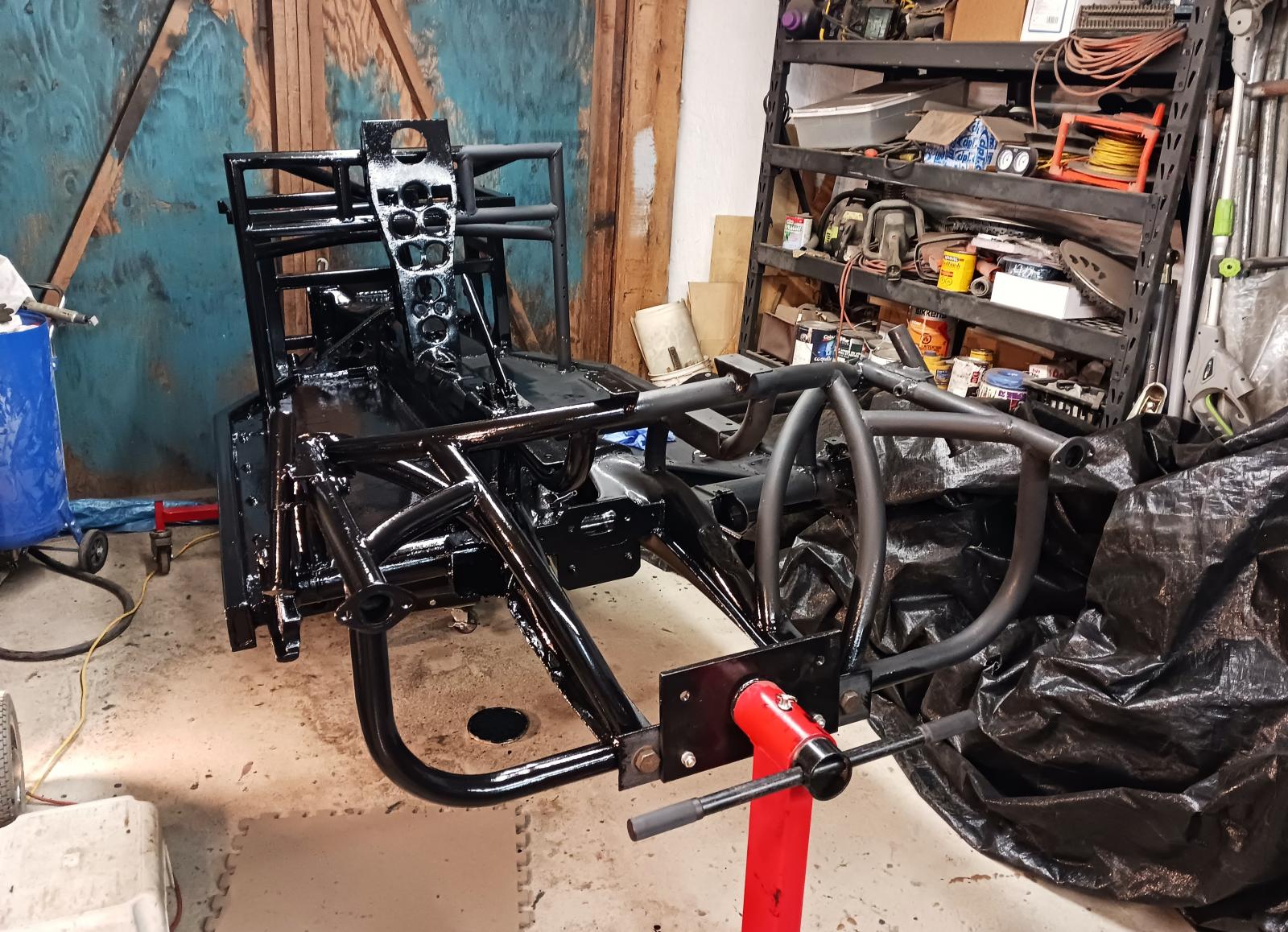

Shot the gloss clear on the chassis today after scuffing the 3rd coat of black, things went well, I'm quite happy overall. So far it looks much deeper/glossier than before. Once it sits overnight to cure, i'll be able to mask off the chassis, shoot flat clear on the interior area and that will be it done. When the rear control arms are assembled, I'll finally be on the road to completion.

PostPosted: Sun Jan 26, 2025 2:23 pm    Post subject: Re: Low down Hillbilly Reply with quote
Yesterday I finished the top side of the chassis. Now the interior is done in satin clear, the rest of the chassis in gloss and the body will be Dove Blue L31 covered in flat clear. The seats and roll cage will be painted to match the console/steering support.

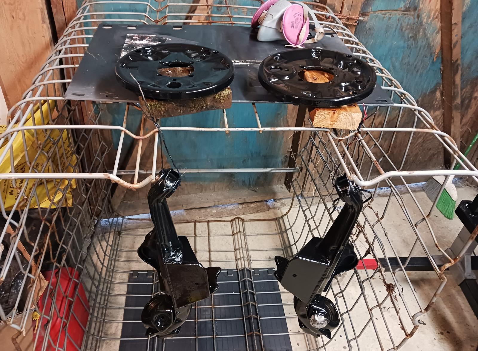

The four spring plate delete pieces, fire extinguisher bracket and drive axles have now been base coated silver, currently waiting for a second coat/clear as it was raining today and I couldn't paint outside. I did however dissolve the old axle grease using Gunk and followed up by scrubbing the CVs clean with Simple Green, which was very effective. They are now ready to pack with grease and install along with new boot kits. The black one on the upper right appears aftermarket as the other three are shiny silver and have VW symbols on them. All the CVs seem to be in good condition and move smoothly/freely for their age.
