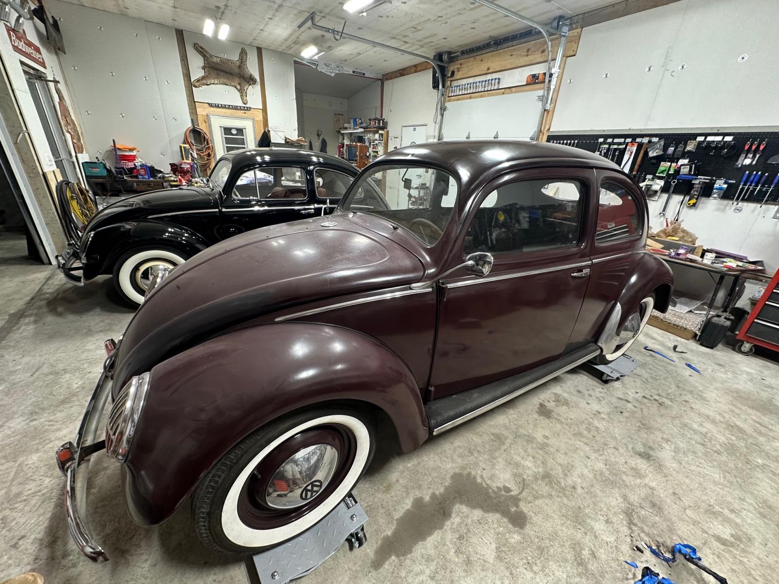

Two Glove Boxes
Joined: March 03, 2005
Posts: 973
Location: Texas
Two Glove Boxes is offline
PostPosted: Wed Apr 23, 2025 7:29 pm    Post subject: Re: 1950 January Original Paint L-51 Deluxe (Preservation build) Reply with quote
Thanks Jimbo & Frank!
Jimbo, I am waiting on the painter for paint correction which we could be in less than two weeks. I'm hoping I get the call to bring it as soon as possible so we will see.
Frank, I hope to have it at something in So Cal this year (RVA, VW Revival show.)

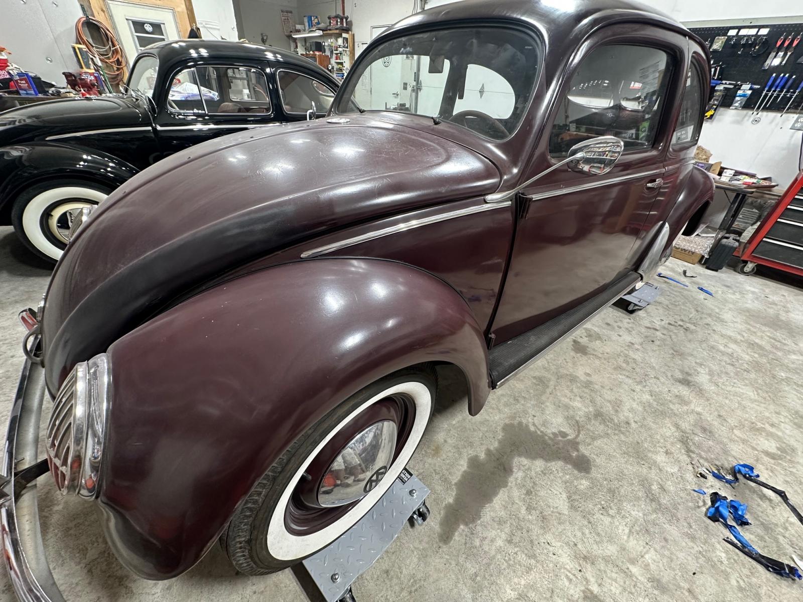

Two Glove Boxes
Posts: 973
Location: Texas
PostPosted: Mon May 19, 2025 8:21 am    Post subject: Re: 1950 January Original Paint L-51 Deluxe (Preservation build) Reply with quote
VW_Jimbo wrote:
If you come out to California and have that in a show, please let me know! I wanna go see it! That is worth a drive out of my bubble!
Jimbo, for sure I will let my samba family know so people get a chance to check it out in person.
Well I finally got to install the NOS HUF steering lock and it was a little tricky to get it dialed in but I am really pleased on how it turned out.
OG from Germany and as pretty as they come.
I recommend to test fit everything outside of the car to make it as easy as possible and a lot quicker. Ask me how I know. Laughing Laughing Laughing
1950 Deluxe Sedan Build

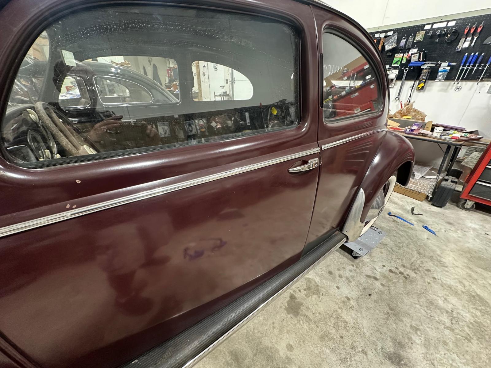

PostPosted: Thu Jun 12, 2025 9:04 am    Post subject: Re: 1950 January Original Paint L-51 Deluxe (Preservation build) Reply with quote
SHOT IN THE DARK Hoping you are still on the SAMBA anyway I have a 1950 Deluxe.. same color, original Paint also... Do you have any paint match to yours that I could copy? or do you know of a paint code that matches our 50 SPLITS?
wow so great to see another the same color
50' SPLIT, 56' OVAL, 65, 66, 71, 73 SB
bigelowsupply@gmail.com
Joined: January 14, 2025
Posts: 2
Location: MI
bigelowsupply@gmail.com is offline
PostPosted: Thu Jun 12, 2025 3:19 pm    Post subject: Re: 1950 January Original Paint L-51 Deluxe (Preservation build) Reply with quote
1950 DELUXE original paint. I do need some exact match for touch up..
Does anyone have a resource for matching paint. I tried TEMPLE as recommended from the SAMBA... maybe I got a bad batch of paint
I requested BORDEAUX RED L-51 "not even close " waste of time and money.
ANY input would be so appreciated....
