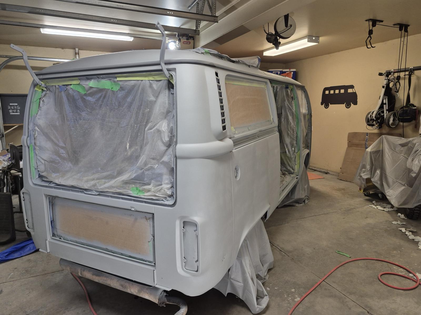

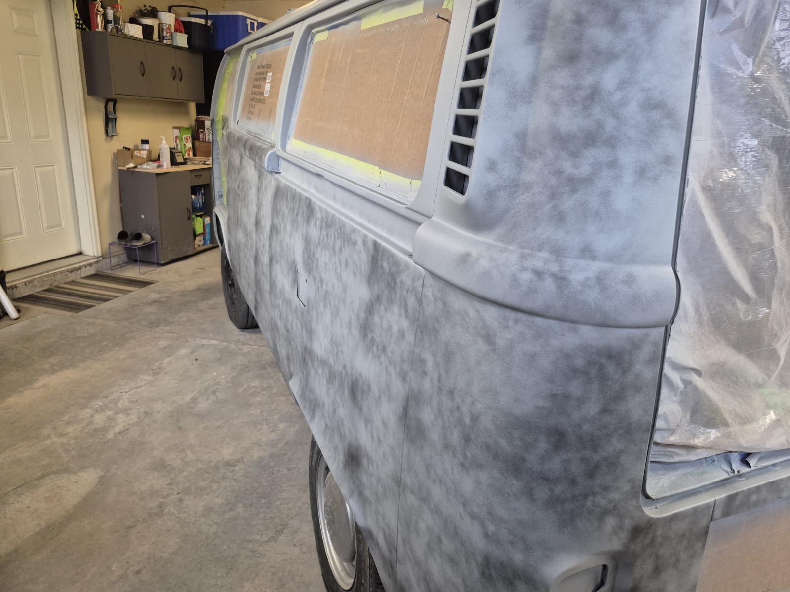

Well, I think I've gotten the body to the point where I am happy with the filler job and looking to move on to next steps.
Cleaned, cleaned and cleaned again and ready for hi-build primer:
And shot:
Then guide coat:

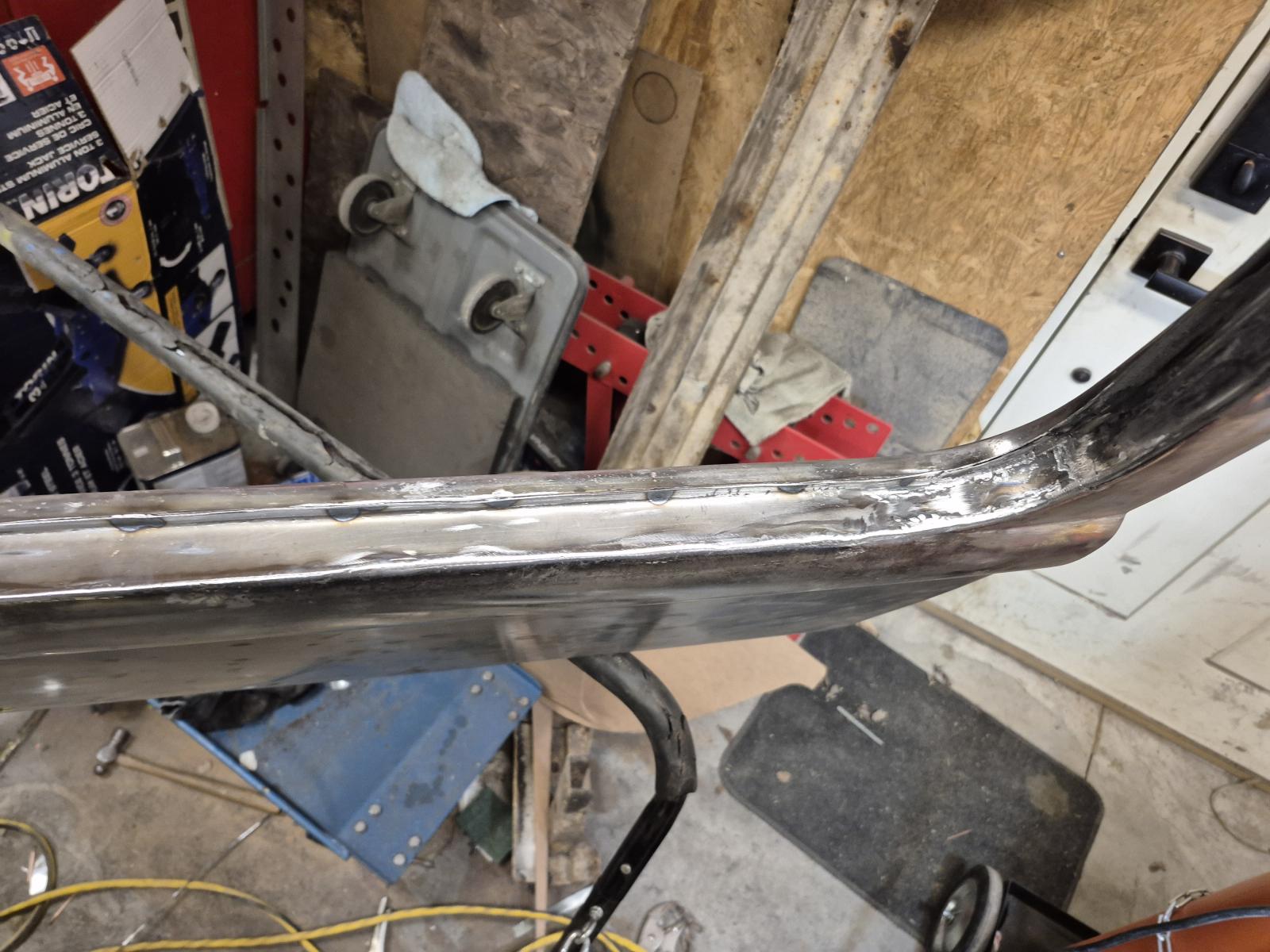

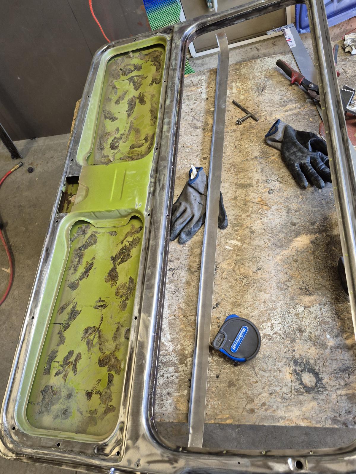

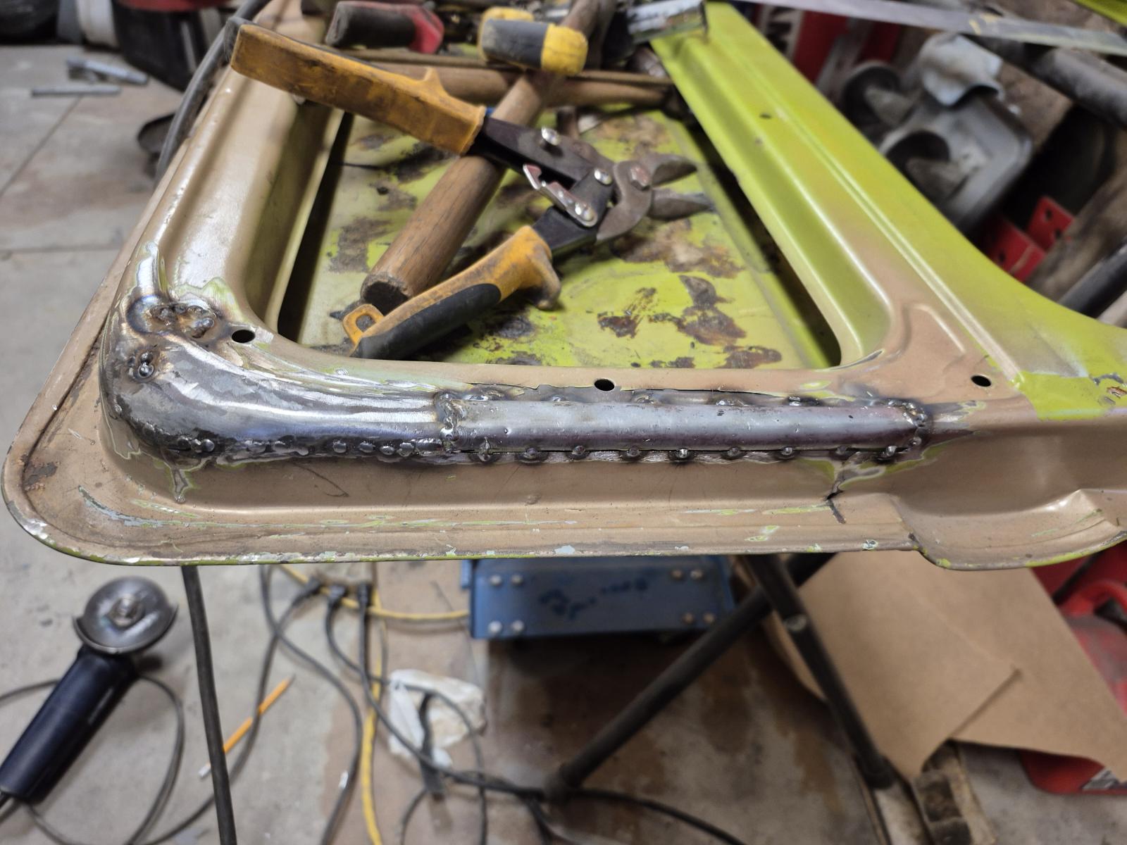

Next I'm turning attention to the doors. I hadn't touched the back hatch yet and it needed some attention:

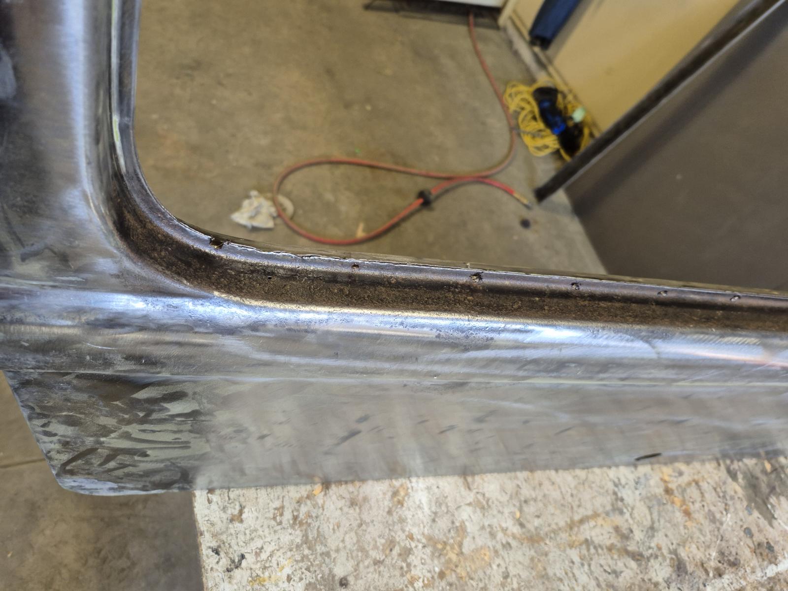

Someone had bolted a gas canister bracket through the door and pinched all the inner structure, so I cut it out and tried to replicate the original:
Of course the window ledge was rusty and I had to fabricate a new one:

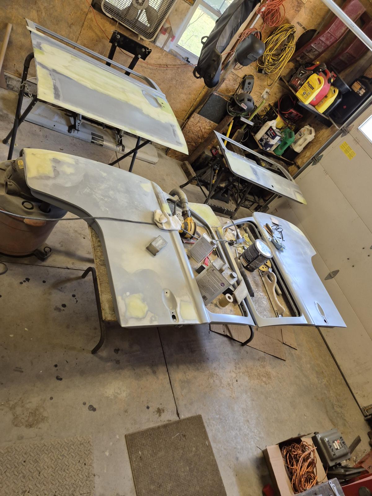

Next endless cleaning of the doors and hung them to epoxy prime:
Next I have them laid out and ready to start on the filler:
I also used some window/door sealer since it stays rubbery when dry to seal the outside skin of the slider to the inner frame:
Fingers crossed that I can get some quality shop time this week to get the doors caught up to the body and start blocking it out as one piece!

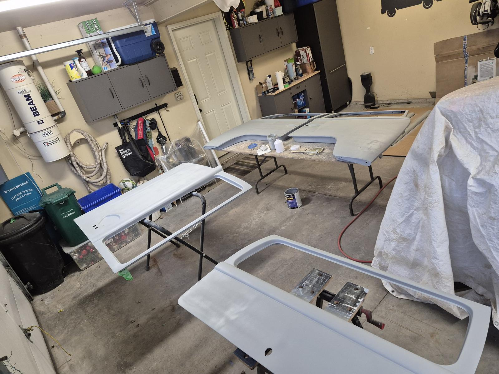

Every spare minute spent in the garage this week. Doors were all filled, sanded and sprayed with Hi-Build:
On to blocking out everything now. Is it best to hang the doors and block it out in one piece? Only asking as there are so many adjustments to make to get them to hang flush and I don't know that they ever really were Wink

PostPosted: Mon Apr 07, 2025 9:32 am    Post subject: Re: Body Panel Replacement - A First Timer's Journey... Reply with quote
yes i think is,s best to hang them get it all adjusted then block it,then you will know that it all fits proper and the surfaces are all flush with each other,I saw one video where he used filler to lock all the panels in place ,after adjusting,and blocked the body as one unit ,but that was on a over the top ,restoration an a non vw classic car.

PostPosted: Mon Apr 07, 2025 11:24 am    Post subject: Re: Body Panel Replacement - A First Timer's Journey... Reply with quote
Looking good, I agree that its best to hang the doors and block while they are on. Can make any final adjustments to the door gaps at that time as well.

PostPosted: Wed Apr 09, 2025 5:25 am    Post subject: Re: Body Panel Replacement - A First Timer's Journey... Reply with quote
Hanging the doors will allow you to fudge gaps and transitions when you do your filler. I didn’t do it this way when I repainted my cab door. I think the slider would benefit most from being installed and adjusted before filling. Mine is already painted but was hung and lined up when I did the final metal finishing on it as well as the b-pillar and rear quarter. It will be installed again for when I do the final filler work on the front wheel arch and rear quarter. A great place to cheat like hell.

This is all I got with 5hrs straight of sanding with 220. My shoulder is killing me today.

PostPosted: Wed Apr 09, 2025 7:52 am    Post subject: Re: Body Panel Replacement - A First Timer's Journey... Reply with quote
220 may be a bit fine for shaping,100 or even 80 ,will remove material much quicker,after you have it shaped use the finer paper to remove scratches from the course paper.
use a wire brush to clean your sand paper often during use.

I thought I had it all shaped Wink I even filled the engine cover to what I thought was flat. As you can see, lots of low spots to putty...

PostPosted: Fri Apr 11, 2025 5:15 am    Post subject: Re: Body Panel Replacement - A First Timer's Journey... Reply with quote
The thread from Clatter I posted awhile back explains it best.
Full spread of filler on the panels.
Sand with 36 grit on a long board.
Repeat until level. Leveling is all 36 (or 40) grit.
Finer grits are for prepping an already level surface for high build primer and top coat.
Hopefully once it’s level you will have enough filler left to sand through the finer grits. If not, a full skim coat to fill voids, pinholes, etc, then on to the finer grits.
It works way better and is actually faster than chasing low spots. It may feel like you are slathering on a bunch of filler, but most of it gets sanded off. This advice helped me a lot. I’m still not a master of dead straight panels, but a lot better than I used to be.

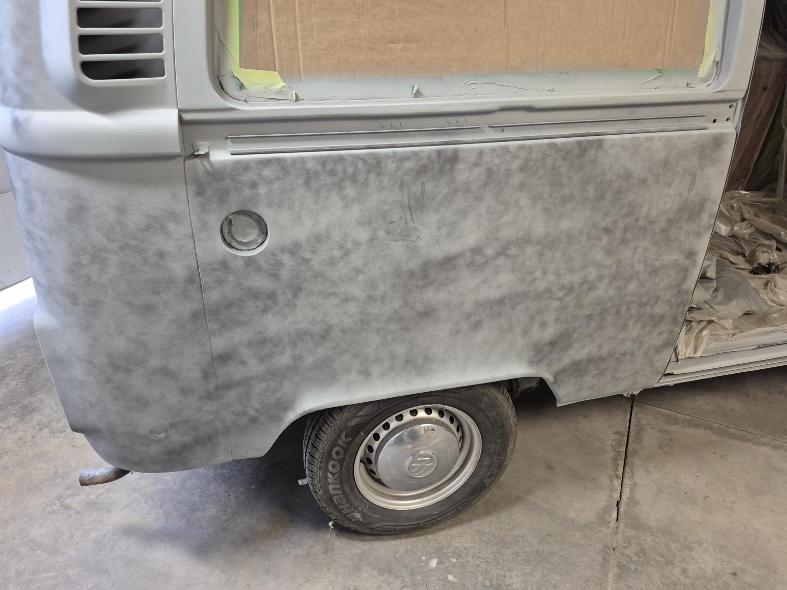

PostPosted: Mon Apr 14, 2025 10:53 am    Post subject: Re: Body Panel Replacement - A First Timer's Journey... Reply with quote
Lived in the garage for the last week, but did get the body sanded, puttied and 2k'd. The putty stage was the worst, it seemed like any low spots became super high spots and I question if I would have been better off without it... Moving On!

PostPosted: Mon Apr 14, 2025 1:07 pm    Post subject: Re: Body Panel Replacement - A First Timer's Journey... Reply with quote
maybe dry fit the cover onto that piece with the bead rubber and see how it goes together ,then decide,
what colour are you painting ,white hides body imperfections,black hi-lites them,

320 sanding has started and already burned through in a few areas. Will be more careful moving forward as I'll have to respray these spots, let dry and sand again...
