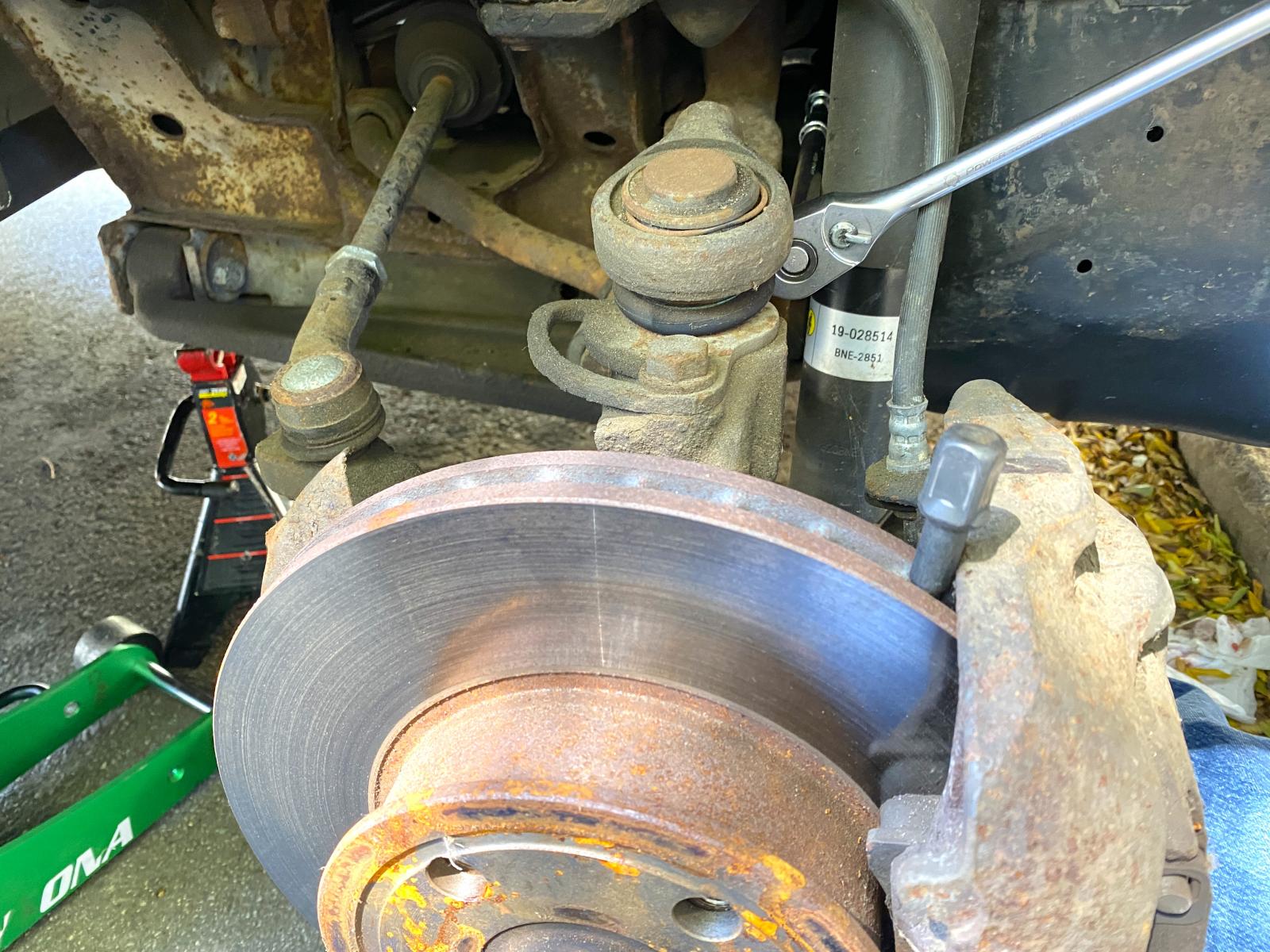

Before taking it on a drive down the coast, one of the areas I want to check are the right side inner CV bolts. Two years ago while under the van changing out the starter, I noticed these bolts had worked their way loose, some of them were not even finger tight. Back in 2021, I replaced the entire passenger side axle/CV joints and thought I had tightened everything sufficiently. Removing the front tire off the van, I can access the bolts using several extensions. As suspected, they are loose though not to the same extent as two years previously. Using a M10 XZN socket, tighten all 6 bolts once again. This is done by turning the axle to line up a bolt in the gap and placing a socket extension into the center vent of the rotor. This locks things from turning to be able to fully tighten these fasteners. Since they have a history of working their way loose, give a bit more muscle on their last round. Check all the fluid levels, coolant hoses and vacuum lines.
