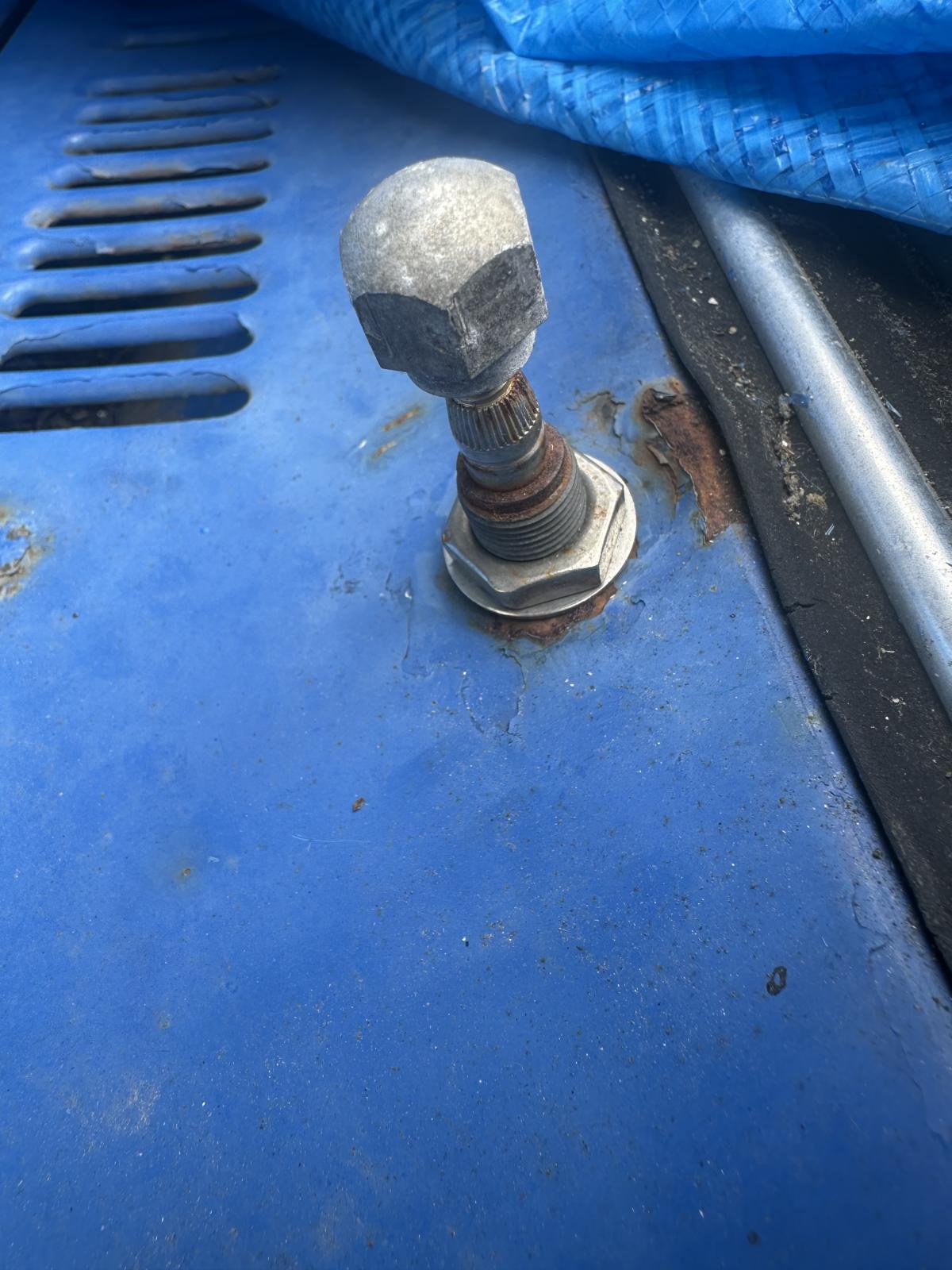

I'm new to the VW world and recently purchased an abandoned father son project, a 72 square back. Build date in Nov. of 71.
One of the parts missing are the wiper arms. I referenced this thread:
https://www.thesamba.com/vw/forum/viewtopic.php?t=648259&highlight=wiper+arm and bought part #311 955 407 D.
Unfortunately that is the wrong part, or my car has different arm mounts. This is what the mounts on my car look like:
What would be the part number or a reasonable facsimile be for this?
Thanks

The part number is correct. They should look like these https://www.ebay.co.uk/itm/362175223934
New wiper arms are smooth inside the mounting hole. The get "splined" when installaled the first time.

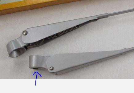

That image isn't what I received, the arms I have don't have the hole in the top of the mounting point as shown below:

I guess I'm going to have to return the ones I got.
Is there any beetle wiper arms that will fit on a 72 type 3, or a close approximation? I'm not looking for originality, but want this car to be a daily drive so need to be able to drive in the rain.

I'd look in the Samba classifieds for them. Look for 71-73 as they should be the same. 70 was the first year for that mounting style, but they are set up backwards for the 71-73 (the 70 arms are one year only and park on the same side as the 61-69's, on the left side). I hope this helps.
P.S. Beetle arms are too short, same with super beetle and Karmann Ghia arms.

You might want to try a junkyard or two in your area. Maybe a good semi-complete rusty car might have them. Like I said, 71 thru 73 are the same, and park on the right side.

The later cars (71-73) used 15 inch blades, because they parked on the opposite side. Don't you still have a couple of late model parts cars Mike?
