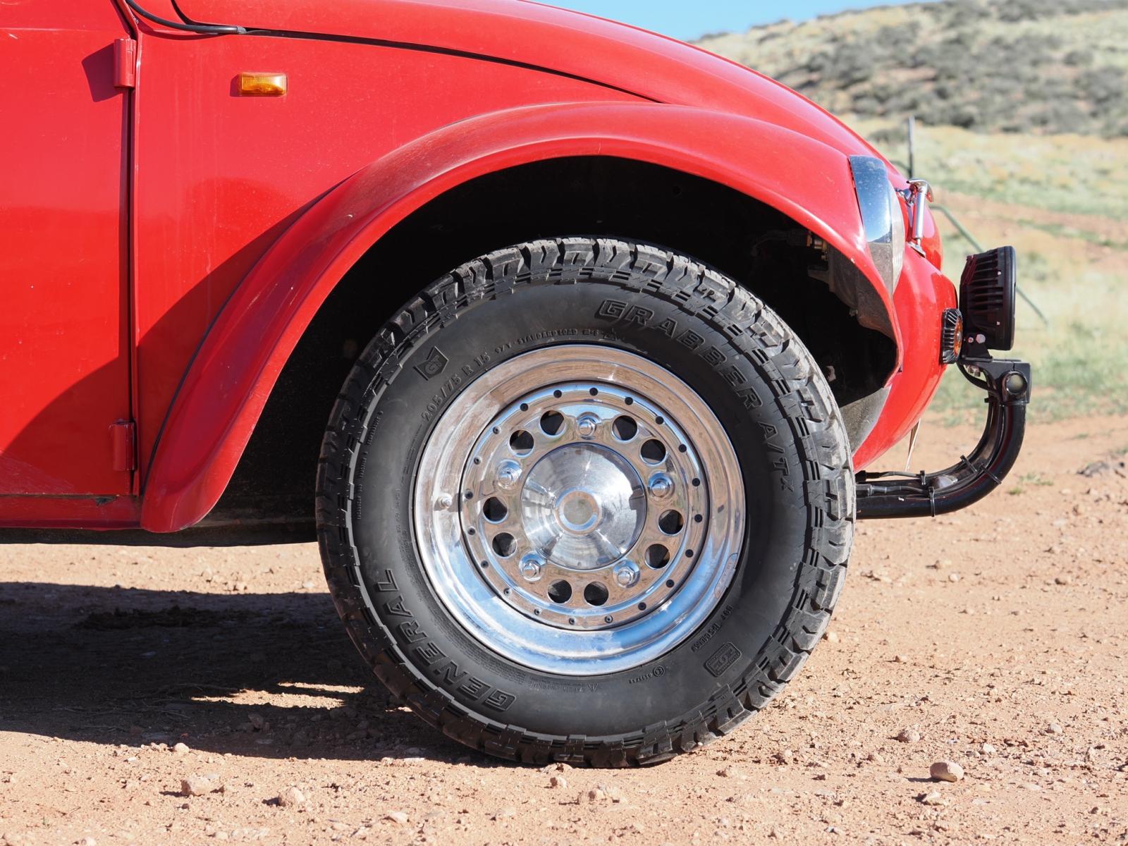

I recently put on Goodyear Wrangler Duratracs for the rear in 31×10.5R15 and General Grabber in 205/75/15 .
More pics here: https://robonza.com/beetle/index.php/2024/04/17/new-tires-for-the-baja/

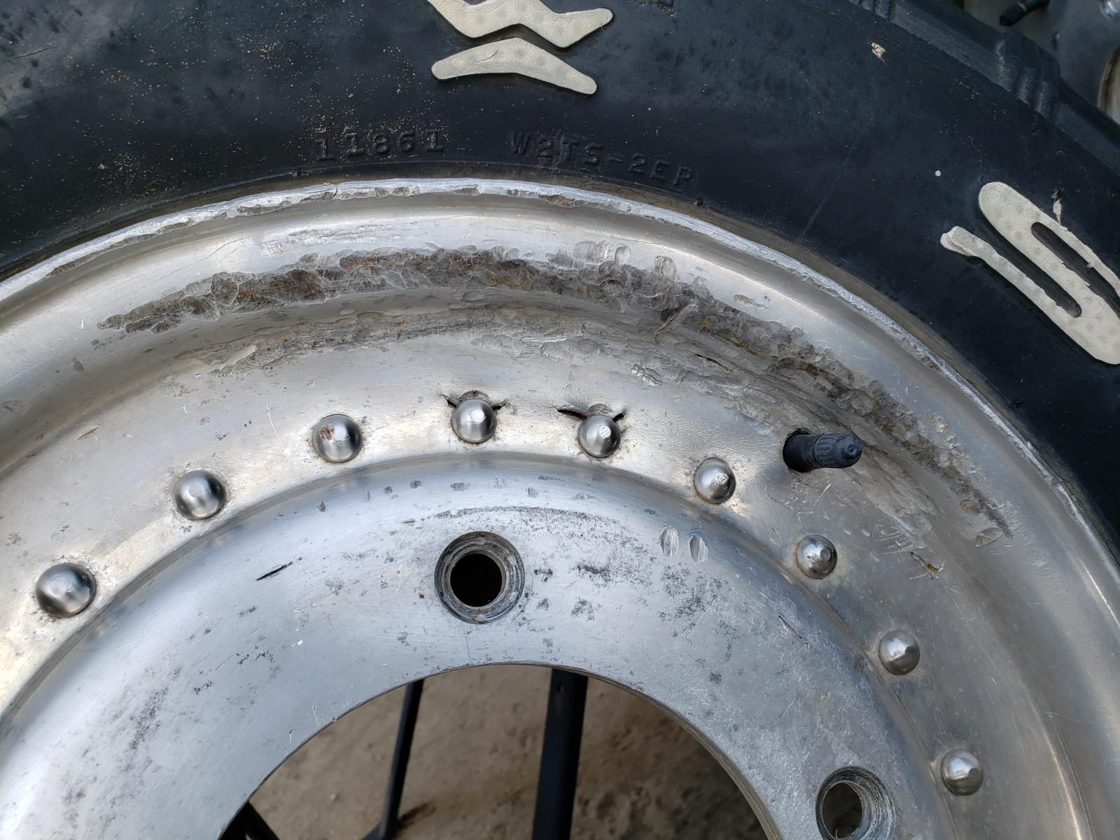

I'm taking this to the dunes tomorrow and I'm not sure what to do with my fronts. Should I air them down? Air them up? Remove them and put my bald firestone drags back on the front? I will be in deep sand (obviously) and this is rig is on the heavy side (2Klbs). The old drags are on rims that are so thick they push the centerline out about 1.5" from the drum which is why I don't run them any more. However, that's not a big issue in sand. I've been trying to sell them but maybe I should keep them for sand if my power kings are going to suck.
Let me know what you think.

After the fact, my powerkings were fine, but those rears aired down to 8psi were terrible on my my heavy rig. My engine was way too hot most of the time prompting me to go home after a few hours at the dunes. Granted it was purty hot that day feeling like close to 90 on the dunes which was amazing since it's right next to the cold lake michigan and there was a decent breeze. Orange just isn't built for the thick sand. She didn't have any problems getting up test, but the spinning and drag was too much for my cooling system. If I had paddles I think things could be a lot different. I'm just not sure I like the dunes enough to blow a grand on a paddle/rim set up. I'm just baffled by how much effort I've put into making my cooling system work and I still have problems. All I can think is the iron block of my Quad4 just isn't as efficient at cooling. I saw plenty of ecotecs out there most running the radiator configuration I originally had with it mounted on the side of the engine hugging the intake and they did fine. I should have gone ecotec in the first place. Oh well, she works good in the woods and that's what I was aiming for. So maybe I'm not giving myself enough credit. Party on.
