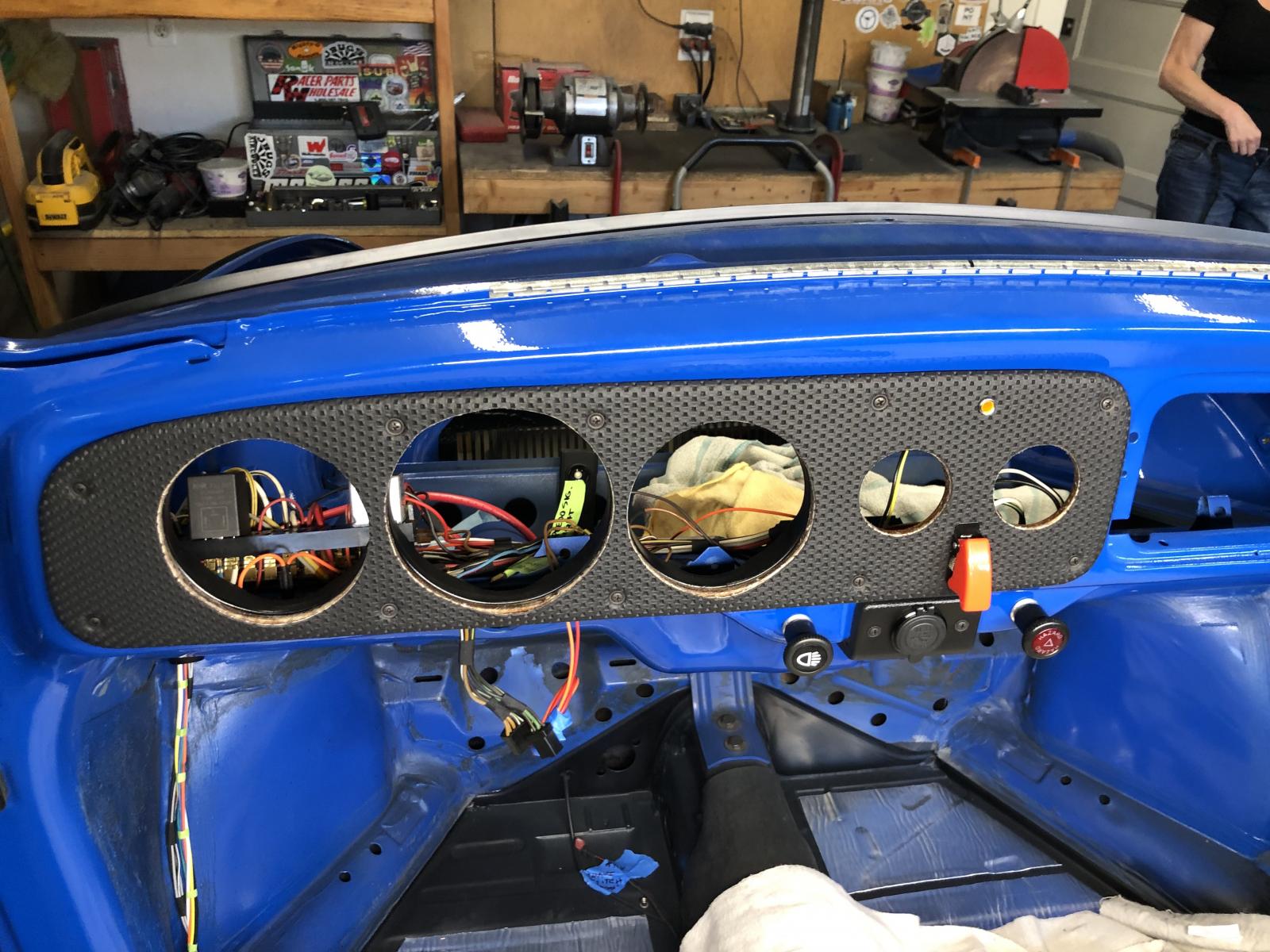

More progress…
Continued making progress on the wiring install. Made a fuse/relay panel for the ignition, radiator fan, fuel pump, and USB charger (with room for a fourth relay for maybe heated seats?)
Used OEM mounts for the ‘rain collector’ and an aluminum strap to mount the panel…
I’m not an electrical expert, however I did come up with a wiring diagram for this ‘new to the car’ wiring for trouble shooting in the future if needed…
…installed the ignition switch…
…hooked up my test battery and tested all the circuits…no smoke was released and all circuits had continuity Thumbs Up Thumbs Up
Still have to run the wires for the rear tail, brake, turn, reverse, and license lights…
…then deal with this…
…and this…
…etc., etc., etc… Rolling Eyes Laughing

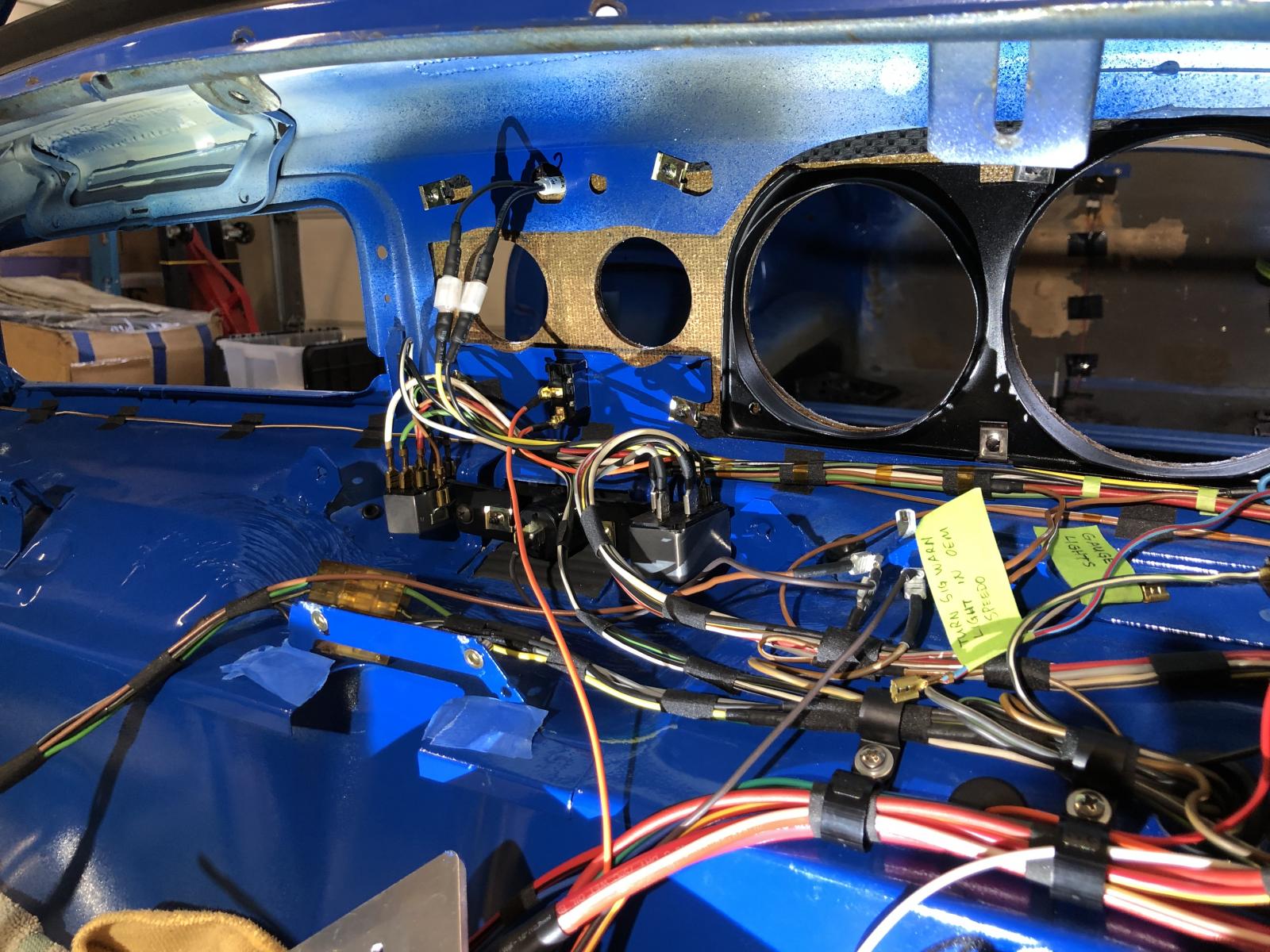

…more progress:
Searched and found the wiper motor. It’s been a minute since I removed it and tossed it in a tote labeled “Interior”…huh?…must of made sense at the time. Rolling Eyes
Bench tested the 53 yr old relic…
…it works! Both speeds, smooth and silent…amazing! Cleaned it up and lubed all pivots.
To keep the wires tidy, I shortened the wiper and switch harness a good 12”.
That placed the ‘T4’ connector in the cavity (where the ash tray would of gone) behind the new relay panel…
I was pleased to see that the wiper motor plays nicely with my new relay panel.
I also added a couple M4 Rivnuts for p-clamps to further tame the wires…
Probably at the half way point on the wiring. Still have to run the chassis wires to the rear for the tail, brake, turn, reverse and license lights, make all the VW-to-Subaru wire connects, and all the battery wiring.
J.

I located a ‘secret switch’ upstream of the ignition switch. It disables the ignition switch…an anti theft device of sorts.
Starting to get a bit crowded behind the scenes…
Looks like this is going to be the summer of wiring! d'oh!
J.

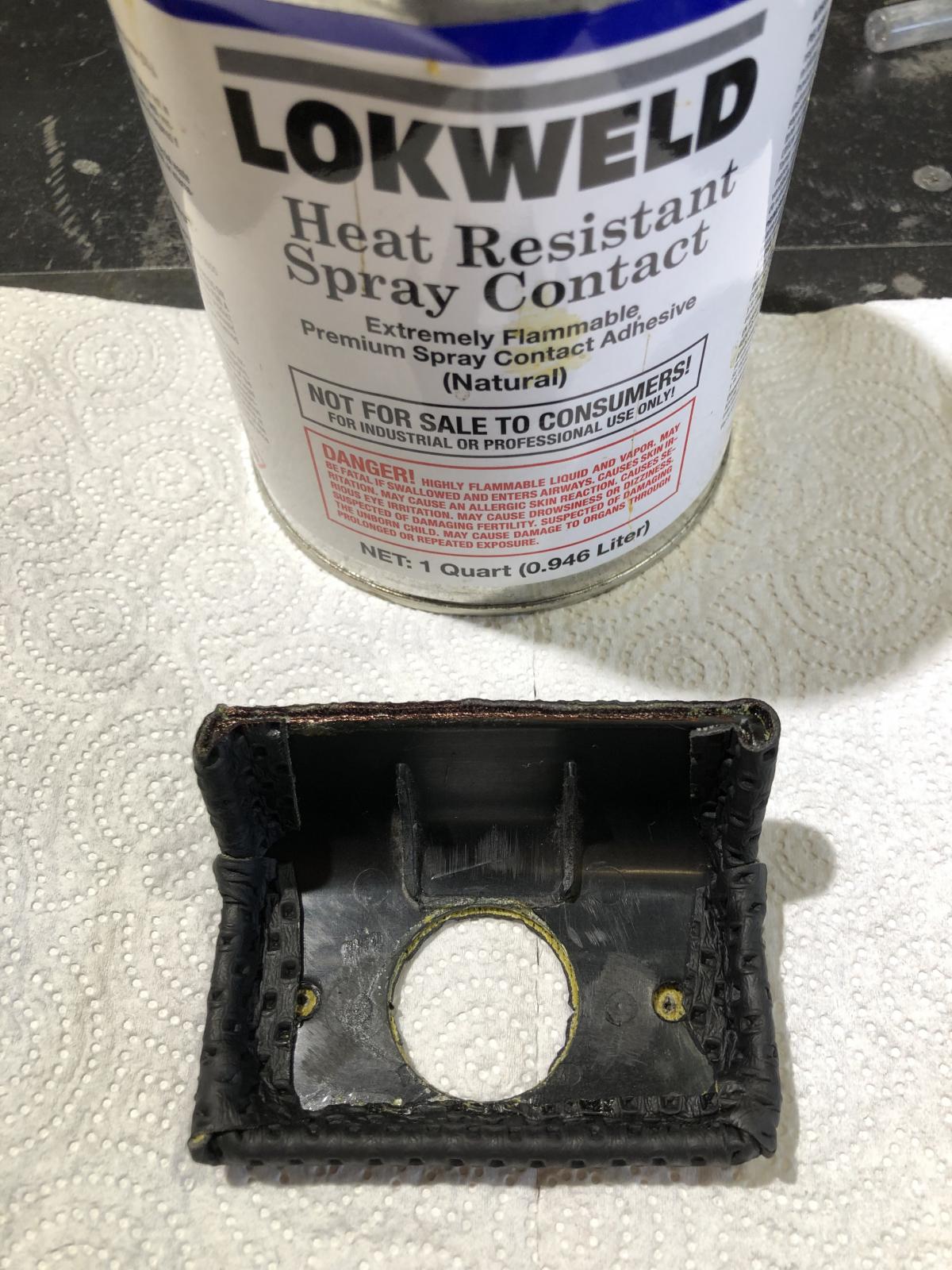

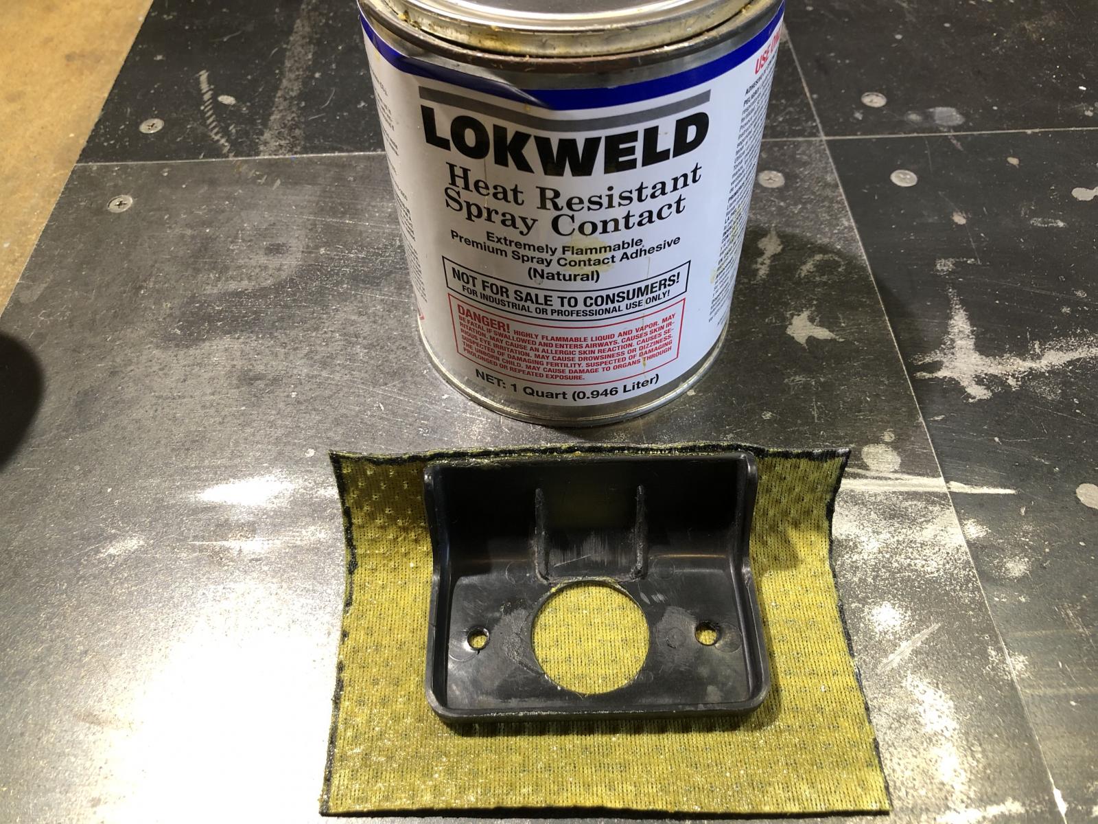

Except…after looking at the pics, I didn’t like this detail…
…the USB charger mount black plastic (I used the OEM ashtray cover) doesn’t match the dash.
So I took it apart and covered it w/the same German ‘basket weave’ vinyl that I used to cover the dash, glove box door, and soon the door and quarter panel cards.
I like that much better! Very Happy
