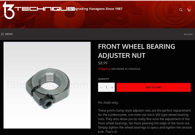

Yes, can be re-used but find a new spot for the new “peen”.
Or, invest in and start re-using these re-reusable nuts:
https://t3technique.com/products/front-wheel-beari...&_ss=r

It’s been a while but IIRC, there are two opposite sides of the spindle clearanced for peening the nut. If you peened on top first time, peen from the bottom into fresh metal. On an un-rotated bearing I wouldn’t give it a second thought.
The T3 nuts are bombproof though, and you’ll never need to buy another.
…plus, Chris is a great guy! Cool

Despite being a one use only nut I have reused the stock nut for many years and many removal cycles. As long as you can peen it so it will not rotate you should be fine. YMMV.
That being said, the locking nut from T3 or other sources is the bees knees.

Just the same, I am going to buy the mercedes adjustable nut.. that's gold.
