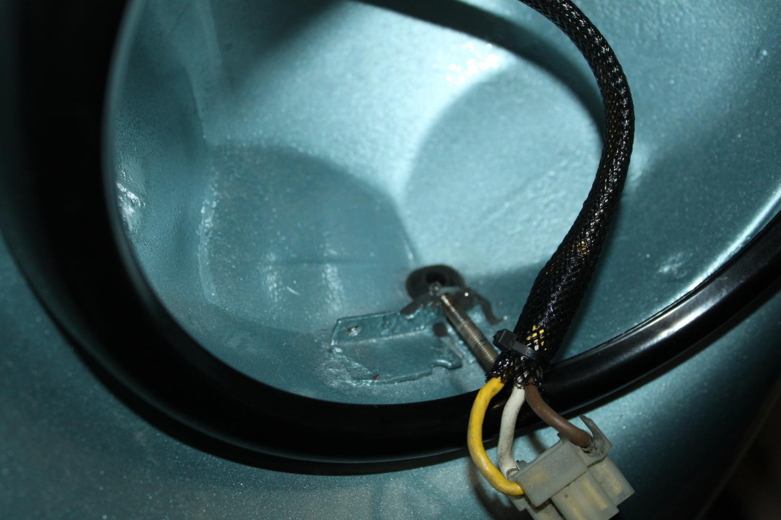

CWAVE wrote:
...the screw location for the headlight ring screw was gone (rotted away years ago). So, I had to spend some time fabing up a repair. Threaded a piece of metal and a bit of JBWeld hopefully will hold it in place. I know I should have welded it... but we are in the season of bitter cold, and welding indoors isn't healthy or safe... It'll do. And if it doesn't hold, I can always re-visit it in the summertime.
Thomas
Thomas is out in the garage busy building his car so I thought I'd grab this from his thread as one idea. Here is the link as well. https://www.thesamba.com/vw/forum/viewtopic.php?t=...;start=200
One of my screws is stripped out too so I am curious to see what solutions people have tried.

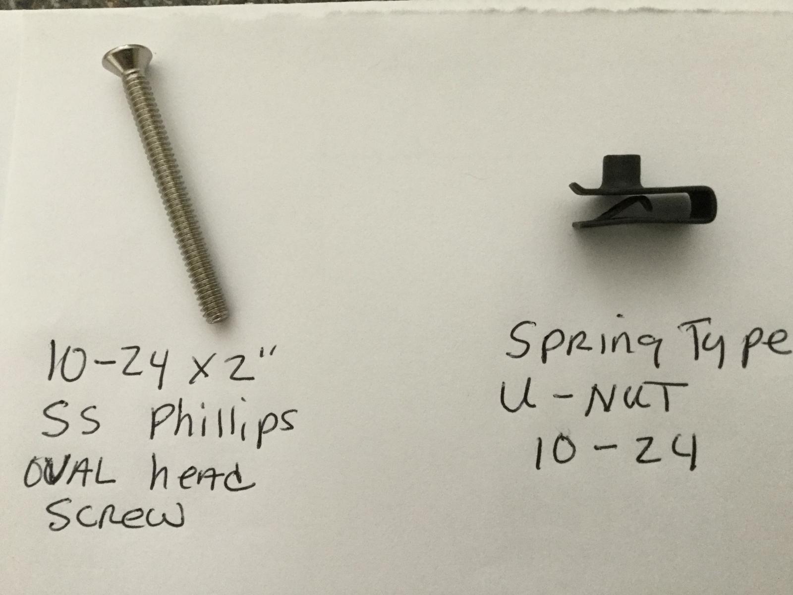

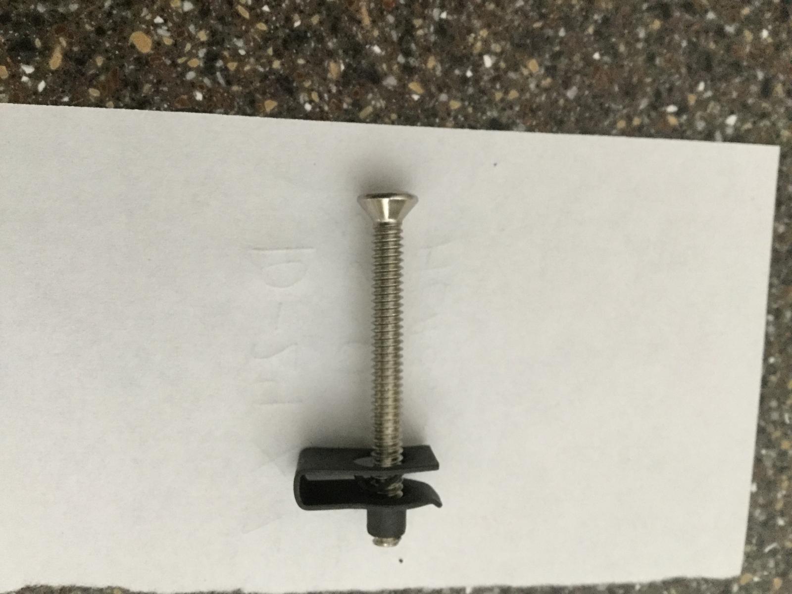

I was able to attach the Chrome Headlight Ring using a 10-24 U-Nut, and the results are excellent. The attached photos is the hardware I used.
I went with the 10-24 u-nut and 10-24x2” screw because I wasn’t able to find the hardware in metric. The original screw is an M5 x 50mm.
The picture of the screw and clip are how I oriented the clip when I attached it to the metal tab.
Rick
