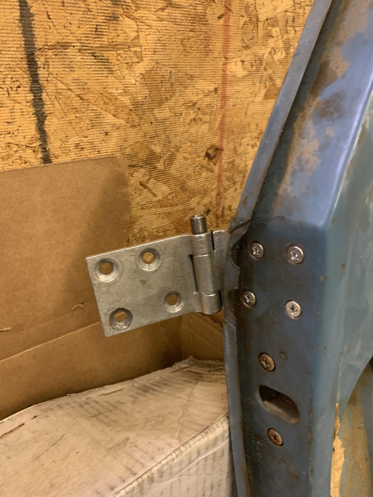

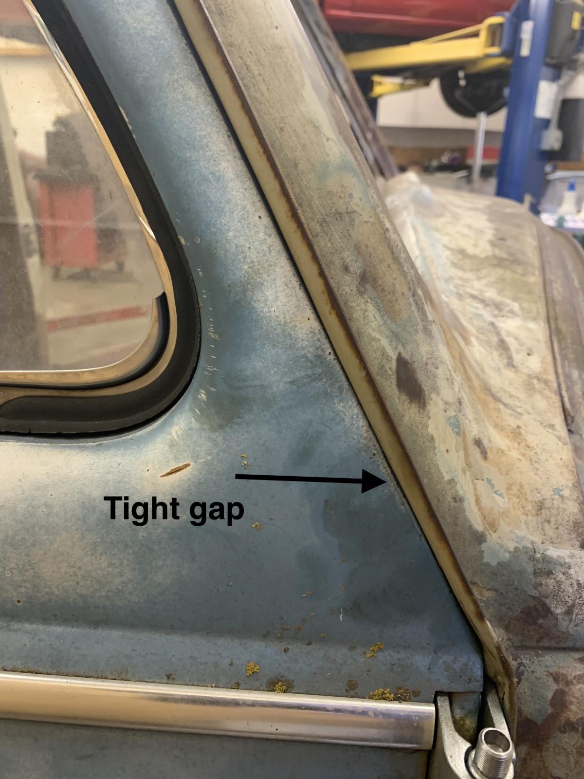

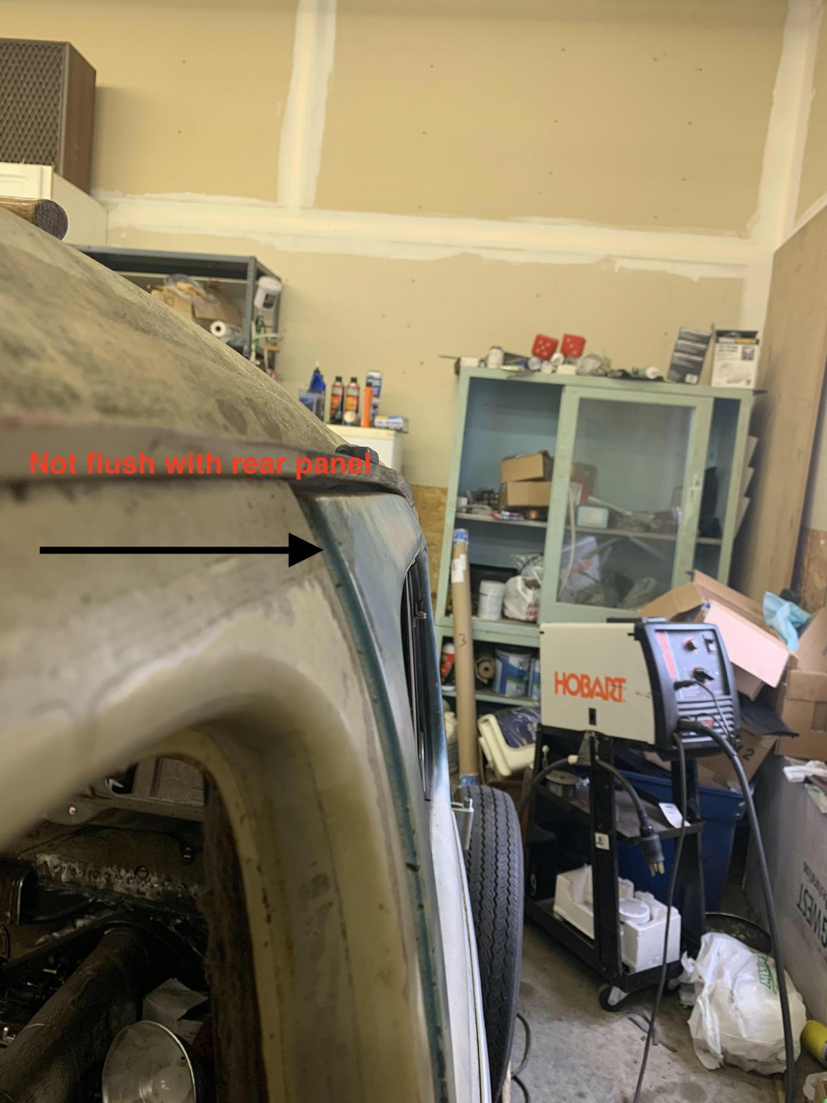

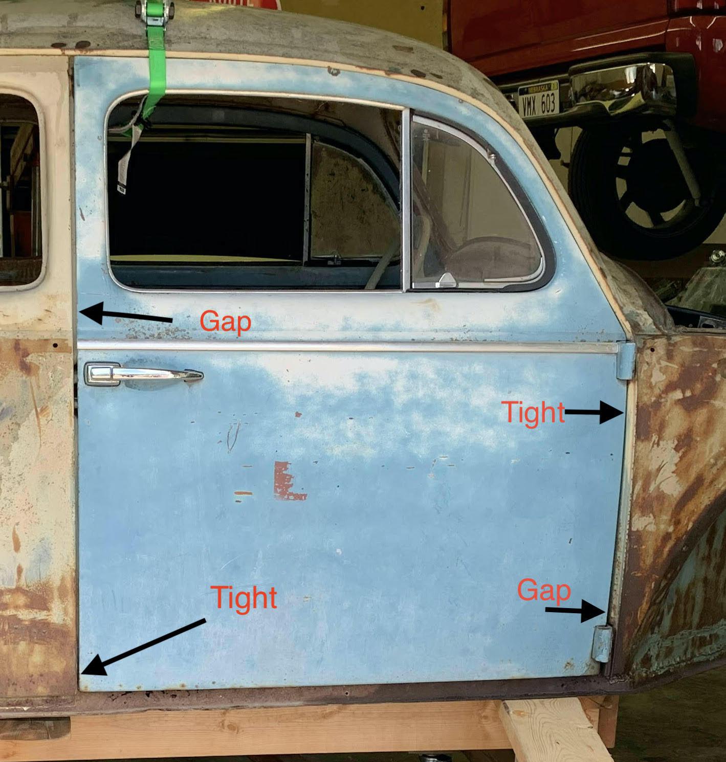

Need some expert advice. I'm in the process of doing a ground up restoration on my 59 Bug. I've removed the body off the pan and installed new pans and working on the heater channels. I did brace the body before I removed it. The issue I'm having is the passenger door where it meets the front pillar is not straight (see photo). I first thought it was the hinge but after I replaced the hinge nothing changed. I have not secured the passenger A pillar as yet because I wanted to make sure the door is aligned before I tack the pillar to the heater channel. I think I can shim it and it would be fine, but my biggest concern is the door not fitting flush with rear panel.

Re the hinges. The hinges themselves are really strong but the reinforcement piece that holds the door to the hinge is just folded sheet metal. Sometimes the hinges are replaced but the reinforcement piece has been twisted out of shape due to rough handling like banging on hinge pins with a big hammer or hanging the door in a vice and banging away.

This might be of help to make sure the door opening is within spec: https://www.thesamba.com/vw/forum/album_page.php?pic_id=867962
It may be necessary to loosen the body to pan bolts then adjust the body via a spreader bar, jacking under chassis, or tightening/loosening the six body mount bolts to get the door opening size and shape where it needs to be. It's also quite possible you may need to shim the upper door hinge away from the A pillar a little bit to get the front gap even.

The smart way to do this, as the circumstances are as follows.
Get your door and surrounding pillars wedged with paint sticks and tacked with with a bridge that you will have to cut off and clean up later. The idea here is to get as much of the original metal in place and not moving. So you can attend to fitting and welding lower repair sections. You may have to be real attentive to support points holding body off the floor. I’d start from the upper hinge bolted and adjusted naturally. The door frame should be symmetrical with door on all four floor edges. Long panels are more forgiving than hard corners and body seams. Measure twice, cut and weld once. A good secure temp hold fixture is Philips self tapping screws.
The support points should mirror each other and on level concrete. An 1/8 of an inch of crud holding a corner higher than the rest can make the job much harder.
The new panels should have little oddities where they fit the old panels. Those are markers. Commonly assumed to be flaws. Good luck. Don’t run long beads you may have to grind off later. Just make good tacks and screw it together until you see it coming together. Save all the long welds for when in back together. Trust me.

I noticed the blue door in the picture appear to be a 40 horse era door (1961-1964). Even in the '80's and early '90's those doors could have an issue that damaged either the door or the body where the hinges attached the two. The door stop during those years was just a little longer than the older one and as the rubber pad on the stop rod compressed the door would be stopped from opening by the hinges hitting the hard stop build into them, instead of the stop rod. This would slowly tweak the hinge mount points on either the body, the door, or both, and that would cause the door to fit ever further forward in its opening. If it was bad enough there would actually be a little rubbing of the door against the body in the area of the wing vent.
With that slightly later door you may be seeing that issue complicating alignment issues already made challenging due to the extensive lower sheet metal replacement you are doing.
