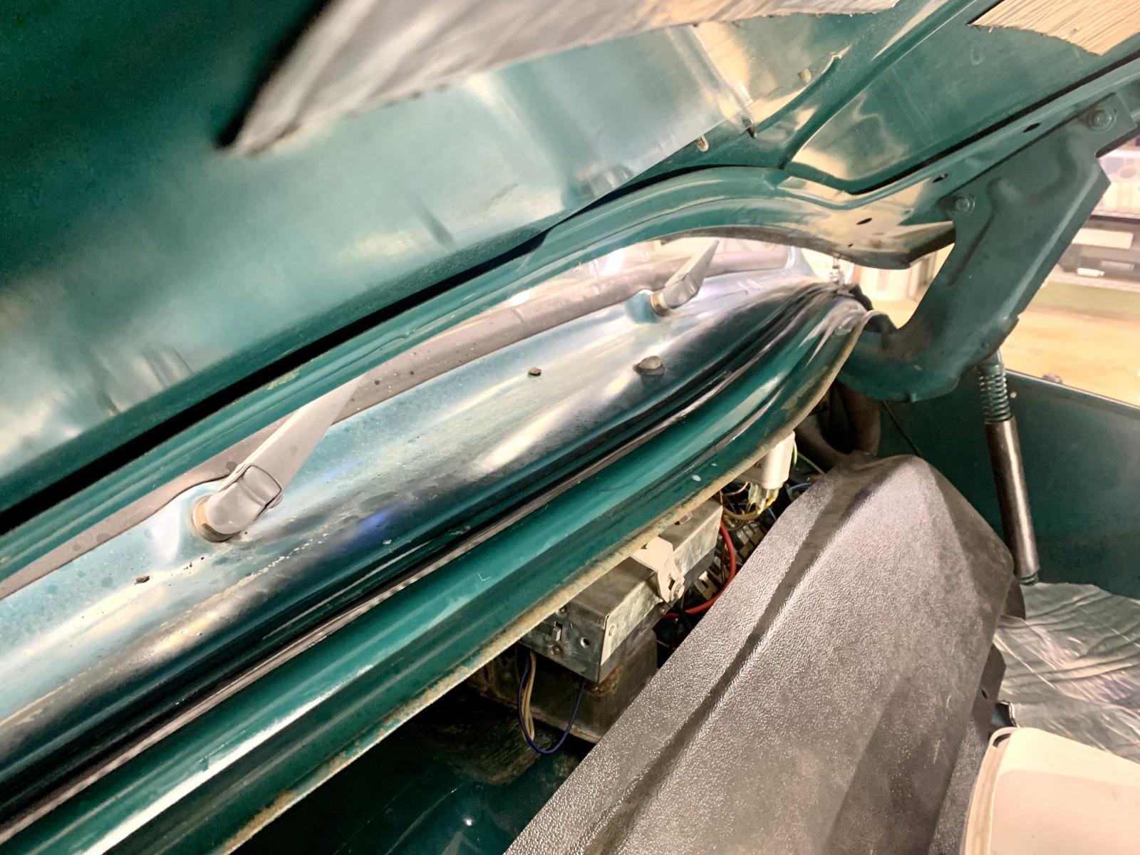

I finally decided to look for my water leak!! The vent wing window rubber on the vertical fixed guide is brittle and mostly missing. In fact there's not even enough material left to guess what the profile looked like or how it was oriented. The samba to the rescue!https://www.thesamba.com/vw/forum/viewtopic.php?t=781724&highlight=vent+window+seal
Dry and crusty, just like the door seals.
Seal removed with a dull-ish nylon scraper and a hook pick, it came out much easier than the door seals did.
These seals came from CIP1 as an add-on when I ordered the collapsible steering shaft clip thingy. It hits the top of the door wing seal, leaving a gap in the very corner. This angled cut with a bit of lip sticking out fills almost the entire corner and fits great!
There's nothing to the install. A quick spritz of silicone spray lubed the channel up, the seal slid right in with just the right amount of pressure, and finished it off clipping the excess length at the bottom.
Pulls nice and tight with the latch - again, just the right amount of snug, not too tight and not loose at all!

passenger side vent window seal
Hooray! The passenger side fixed seal was in MUCH better condition than the drivers side, so I am able to compare it to the CIP1 seal!
It’s hard to get a good shot of how the old seal sits in the groove to mate with the main seal.
This is how VW had the end of the seal, at an angle.
And comparing stock to CIP1, I would say the aftermarket seal is very close. It fits well in the window and does a really good job fully sealing up the window edge. Overall a 10/10 from me, with the one caveat we all know about rubber seals: no telling how long it will last! Laughing

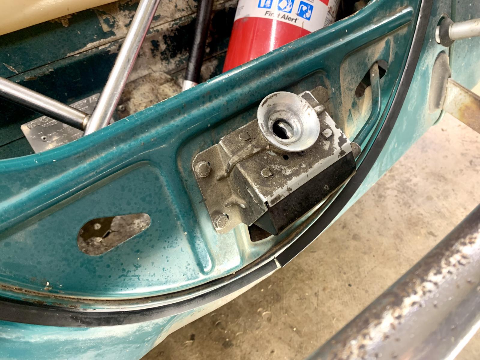

Murphy’s Law sent me a taillight housing and FedEx dropped it off this morning!
The lens will replace my tired left-side original.
The Wolfsburg west order also showed up
A nice pair of grommets for the rear engine tin preheat tubes. They have been out of stock for a bit, and I’ve been worried about the tin chafing a hole through the tubes!
I also got their stock pillar mount antenna. Small issue with it. The nut doesn’t tighten up enough and leaves some slight movement of the antenna. It’s an easy fix to swap in the original angled pillar piece and nut; the base is firm now with no play. It needs to be secure for two reasons… one, it will waggle while driving and wear the base or mount hole. Two, the base pinches hard against the backside of the a-pillar for an antenna ground plane. Not the best ground plane in the world but apparently it’s acceptable enough.
My dash filler radios haven’t been powered up yet and I’m expecting nothing or maybe static at best. A buddy at work just installed a retrosound in his old truck and got me thinking about going that route… I’m not convinced yet. Might just give this current radio a try, it’s one of the four stock units I bought at Way Out Salvage in Kingston, Arkansas last year (was it last year? Year before? I’m getting old!) on my road trip with the boys!

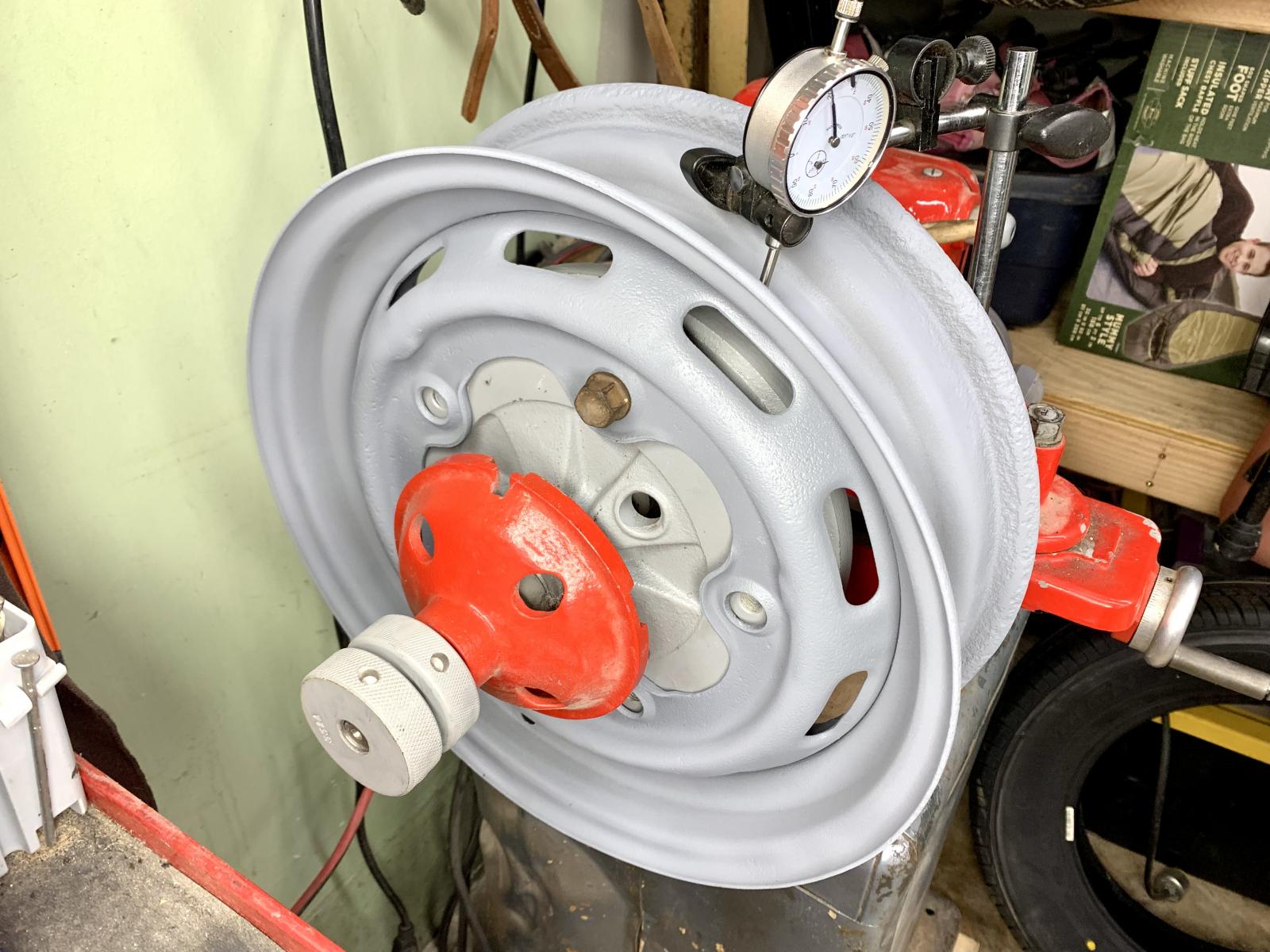

Since I'll be mixing up some epoxy primer for the crossmembers and package tray, I picked a few other epoxy-deficient parts to glass bead blast.
Starting with the spare wheel.. it looked okay from the outside minus a heavy kink on the outboard lip. The kink knocked out okay. It doesn't run very straight on the brake lathe though, and glass beading revealed some dirty secrets under the bead flangies!
Even the valve stem was Made in Germany!
Now on the restored(ish) Drum Doktor brake lathe, bolted to the OG rear brake drum from my car.. if you recall from page 2, this is the drum that had several stripped lug bolt holes...it's now a nice museum piece to look at, and help work on my wheels
My old Horrible Fright dial indicator became trash a while back.. a cheap bezos replacement is on the way. Got to check runout on the bead seating surfaces, from my quick-n-dirty assesment it looks out of round and/or lumpy.
Close up of the valve stem sealing area pressing. Just a cool detail. And now... drumroll... NUMBERS MATCHING BRUH
The date stamp reveals this to be a 12/66 wheel, narrowing down my car's production date range from Nov-Dec to a mid-late-December. It's awesome to find these little numbers matching nuggets, I really nerd out on this stuff!
The inboard side bead looks much worse than the outboard, no idear why it is like that. Hey it held air before, so it'll hold air again. It did have a lot of bead sealer rubber goop - I'll hope for the best and plan for the worst.
Also blasted a decklid script that was in better condition than mine.. this one has all three pegs
Stock Bilstein jack that I picked up from Way Out Salvage
Hopefully I can figure reassembly out!
Might try cold blueing on a few of the pieces, the main shaft for sure needs a good hard surface coating besides paint. I'm planning to get all of the above in epoxy by the end of this week

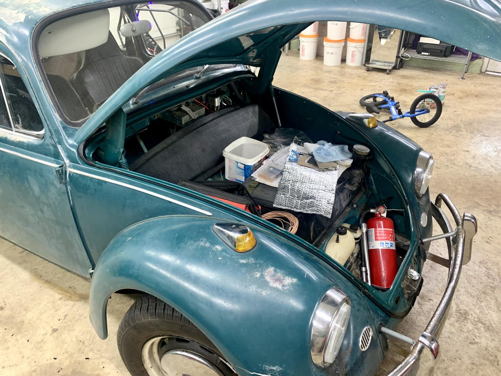

Putting things all back together for driving again.
I don’t want to tear the car back apart for rust right now, so I’ll plan my rust repairs for later this year or next. That will give me time to collect all the panels I need.. like the package tray, which I started to clean up with a wire wheel and had to stop when some holes began to grow! Shocked
The rust areas get scotchbrite rolocs and a wire wheel on the die grinder, then a phosphoric acid wash. Surface prep wash, then epoxy brushed on, then 3M 2k seam sealer. Not my favorite way of doing things but I’m really limited in what I can do without tearing the car down or masking literally everything else off
And the seat belt floor brackets.
If I’d thought far enough ahead, I could have spot welded a nice seat belt anchor plate onto the pan halves before powdercoat.

Lastly, today I finished excavating the frunk seal channel, revealing very little to no rust, and lubed up a new Brazil seal. I’ve read several topics of how bad the Brazil seals are - after I already bought the seal Very Happy - and had none of the problems so commonly parroted. The corner nibs took some pressure with a 1/4” nut driver and I used thin long nose pliers for most of them, and they all slipped in securely without ado.
Trim to fit, and presto! The frunk now closes with a satisfying “thck-clnk!”
