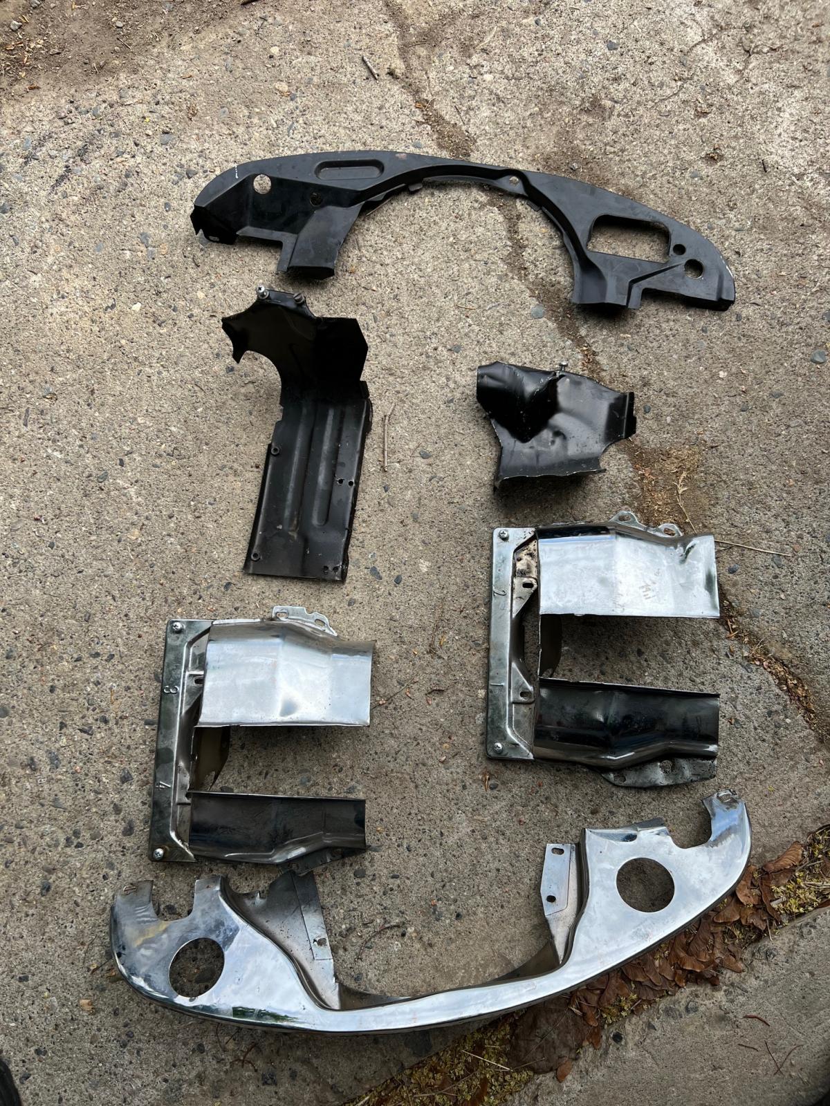

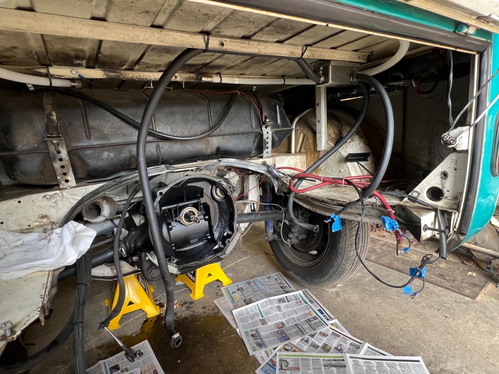

Meanwhile, I've taken the bull by the horns. I drained the oil, it was diluted with fuel, no viscosity whatsoever. I pulled out the motor and took off what little cooling tin was on it. I also got the fuel tank out, that was a chore. It turns out it is from a 1977 bus, at least that is what is written on it. The fit was tight, I thought I was going to have to pull out an acetylene torch and cut it out. Someone cut a hole above it, undoubtably to get to the sending unit. They then screwed a plate to cover the hole. I had to back the screws out to get the tank up as high as I could, and even then, the two metal connections at the bottom of the tank wouldn't clear the opening. I even tried using a wonder bar to no avail. Finally, I got under the bus and was considering options when I got the tubes to clear by pushing up on the tank and slightly tipping it. I was then able to wiggle and pull it out. Needless to say, that tank isn't going back in.
Pics or it didn't happen, eh?
Here is the motor now:
This is the cooling tin I coiuld get off:
I got the screws out, but I haven't figured out how to get it off without removing the pulley. How do you like the customising to fit around the brass fitting?
Here is the tank before:
And removed:

Well you are definitely missing the foam seal over the oil cooler to seal that cooler to the fan shroud. All cooling air needs to go thru the cooler, none around it.
