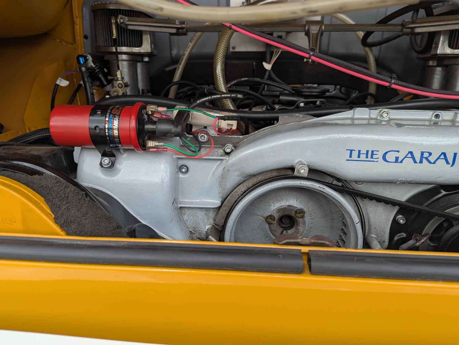

I bought a '77 Westy this winter and it's running rough. The engine runs a fuel pump with its own computer. I know very little about cars.
The bus is runs with a lot of backfiring and when I last had it on the highway, it lost power. I changed out the spark plugs with no effect.
The computer is from CB Performance and I downloaded the software (2010) and the manual from their website. I bought a nine pin to USB cord from Amazon and I run my computer in compatibility mode for Windows XP.
I can load the Quick Tune software and it shows data from the computer.
The air-fuel ratio is showing 19 when idling which is really high.
There are two slider bars; Acceleration Enrichment and Cooler Enrichment (warm up).
After about 30 seconds, the screen blinks and all the meters go to zero.
My questions:
1: How would I lower the Air to Fuel ratio?
2: Is there a better solution here?
Thanks!

Are those carburetors in your picture? Is that an older pic before the efi?
They look like ITB's or throttle bodies. You can see the injectors a bit , into the manifolds.

panel wrote:
Thanks.

Please see my note about not knowing anything about cars.
I meant "fuel pump", not injector.
Yes, those are carburetors, I believe. But again, I don't know.
