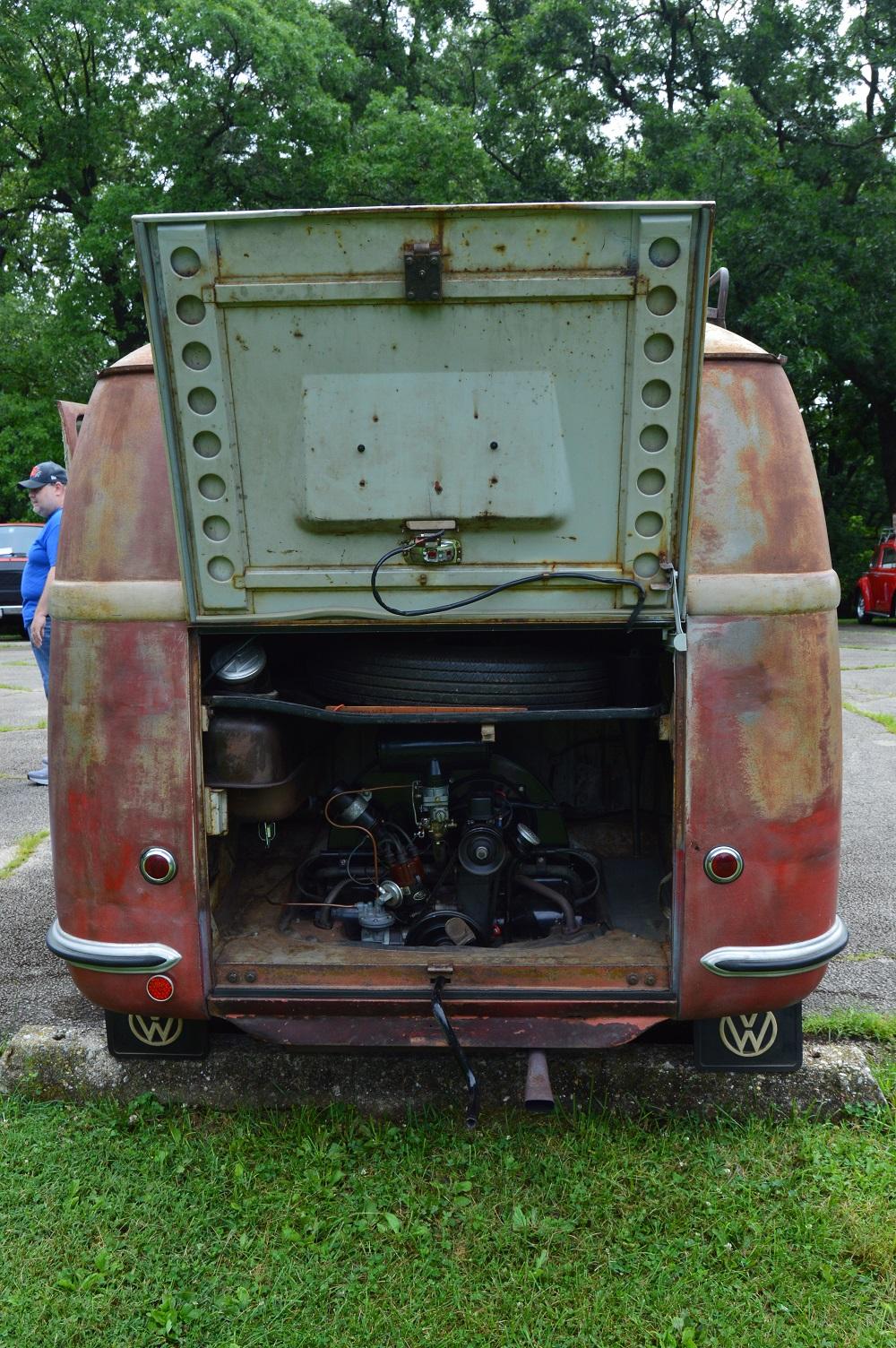

Drove down to Rockford, Illinois this morning for the 2024 Vintage Picnic show. It was a nice time. The park it was held at had lots of large oak trees providing some much-needed shade as it got pretty hot by noon. The drive down was very rainy, but it stopped a bit before I got to Rockford. Lots of nice VW's. My favorite was a 1951 Barndoor Bus. It was from Sweden originally and still had the logos for the logging company it once belonged to. That's the first barndoor bus I've ever seen in person. I left a bit before 1:00 because it was getting pretty hot, and I had about an hour and a half drive back home. The VW did great as always.
1951 Barndoor bus with Swedish logging company logos.
Engine compartment of the '51 bus. Even had the crank start handle.

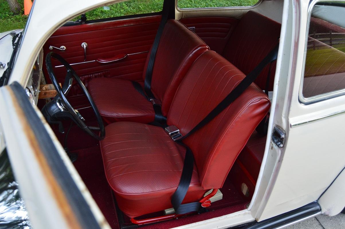

I had been going back and forth about selling the '66 and actually listed it in the classifieds on here for a couple weeks with no replies. After reflecting on it a bit, I realize even though this VW is a rock-solid driver, it is a bit of a hard sell. I'll admit the car has been cobbled and hacked in some ways and the body is fairly rough. Truthfully if you really wanted to restore it to original or even just make it nice and straight, it would require pretty much as much work as a ruined junker. I also doubt there are many VW people out there who really want to run a 40 hp in a daily driver. I've decided that I'm going to keep my VW and run it until the engine is worn out, however long that may be. At that point I'll likely let it go for cheap.
That said, I did take care of a few things that needed attention over these past couple weeks. First, I adjusted the clutch and brakes, which I believe I neglected to do when I took the car out this spring. The brakes engage with much less pedal travel now. Then I bought and installed a set of 3-point seat belts on the front seats. They're non-retracting which took a bit of getting used to, but I've come to like them. The old lap belts slipped loose at the buckle and had to be retightened multiple times on a drive. Honestly, they probably would have slipped all the way out and done nothing in a wreck anyway. The 3-point ones stay tight and seem a bit safer, but the VW is still just a tin can compared to anything else on the road. I also replaced the tail pipes, as the baffles were coming apart and the car was getting a bit noisier than I like. I sprung for stainless steel ones which seem a bit decadent for this car, but the metal they're made of is probably twice as thick as the cheapo ones I had on it. The baffles are much nicer and are actually tack welded to the pipe versus the sloppy press fit of the old ones. This morning, I replaced the tires which were getting thin and starting to slip occasionally in the rain. I got a set of 165/80R15 Nexens. Wow what a difference. The car had all the handling prowess of a wet noodle with the old tires. I had just assumed that the suspension was getting worn from all the miles I've put on the car. It pitched and leaned a lot at speed on winding roads and was a bit bouncy over the rough stuff. Turns out it was probably 80% those crappy old tires. I was never particularly happy with them, but the new Nexens are like night and day in comparison. I've put 10,000 miles on the new-used cylinder head and the engine is still running great. My total mileage is closing in on 108,000.
The 3-point seatbelts installed.

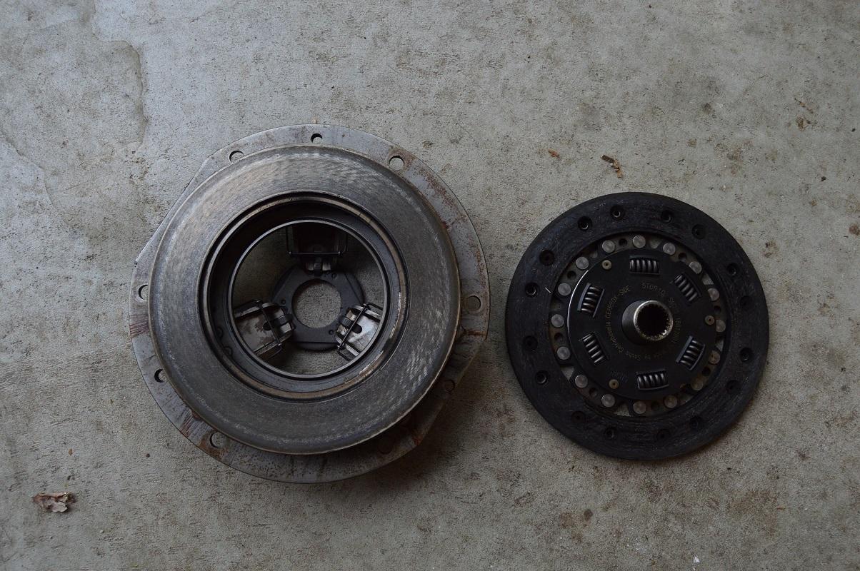

So, I finally got around to replacing the clutch in the VW. Only took about a year of procrastination to build up to it. The clutch disc lining actually was pretty decent and the flywheel surface is good enough yet. I didn't want to spend any money resurfacing this flywheel because the teeth are pretty chewed up in spots from running the 6-volt starter on 12 volts. The pressure plate surface looked like it was primarily engaging on the outer 1/2 inch or so of the plate as if it was a bit higher around the outer circumference than the rest of it. Weird. The new pressure plate is the diaphragm style where the old one was the 3-finger type. I replaced the throwout bearing too since I had it apart. The pedal feel is completely different now. It'll take a bit of getting used to after so many miles with the old setup. It does engage much firmer with no more sliding down into gear when shifting under power.
Engine back out again. I regretted not just going ahead and replacing the clutch when I had the engine out a couple years ago to replace the cylinder head. It was only about 6 months after the engine work that the clutch started to slip when shifting.
Flywheel surface is pretty good yet. No hot spots or deep grooves. I cleaned it up and ran it as-is. Ring gear teeth are chewed up a bit in spots.
Old clutch disc and pressure plate. You can see the outer edge is shiny and smooth on the plate while the machining on the inner part is still visible. Clutch disc has similar wear. Beats me.
