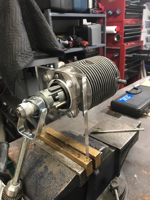

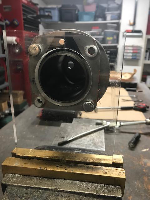

Not a VW cylinder, but a Simplex Servi-Cycle cylinder, which is a little harder to do, as there is no through hole. I made a Lexan plate to hold the cylinder, and use a Lisle hand hone. I've done a bunch of these with really good results. I think it would be easy to do the same for a VW cylinder.
