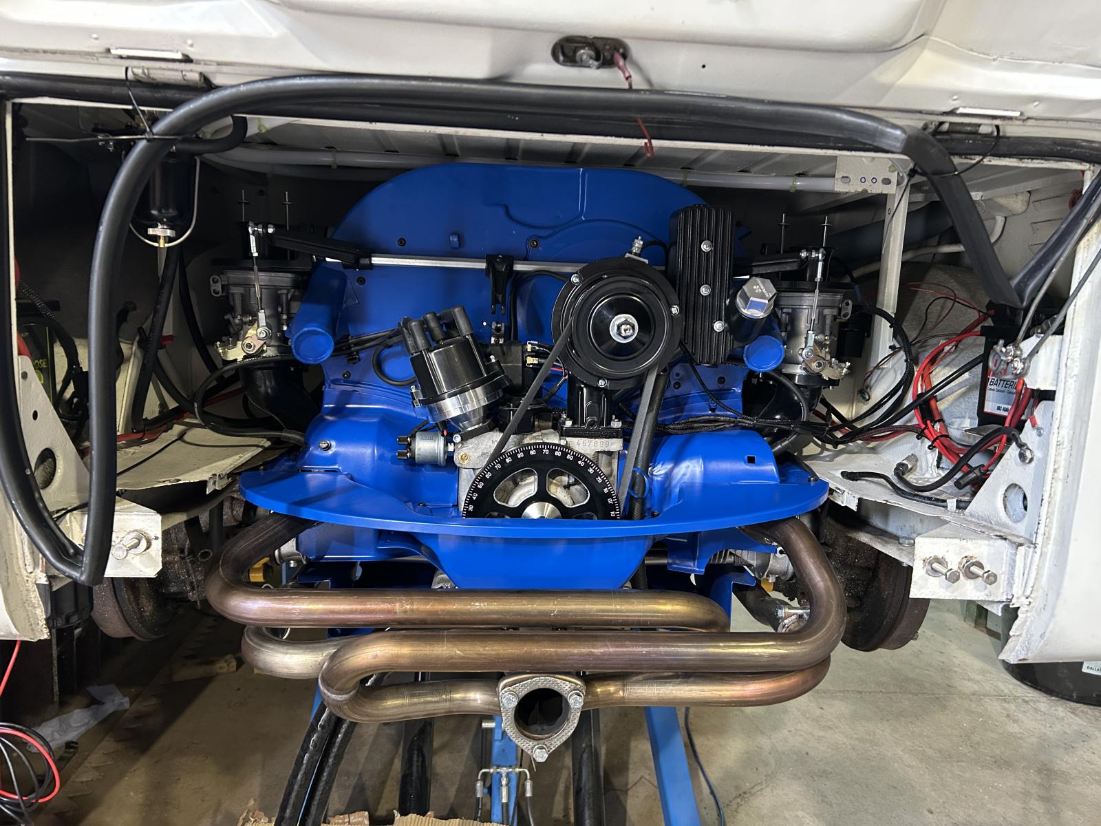

Looking for ideas on throttle spring returns ? I'm sure many of you Bus guys have encountered this ? and hoping that you have some ideas on how to fix my problem ?
I have just built a new 1800cc engine for my 67 Kombi. I have dual weber IDF 36's, and started him up for the first time today. Apart from two small oil weeps from the remote cooler, all is good, I'll probably need some time to get the carbs dialled in, but he started straight off, and is idling about 875/900rpm, and seems happy there. My problem is that my throttle is now all over the show Crying or Very sad it's sticky and unresponsive, and relying on the carb springs, doesn't seem to be doing the business, almost like they're not strong enough ?
Have any of you guys gone through this ? Have any solutions ? Firstly, I'm thinking of getting the new throttle mechanism for up front from Butty's bits here in the UK, as had heard good things about it, but wanted to try some sort of spring arrangement as well to ensure a good return ? How did you guys solve this ? PS : Linkage is new a CB hex bar kit

Murt
Joined: October 01, 2017
Posts: 514
Location: Kent, England
Murt is offline
PostPosted: Mon May 19, 2025 11:39 am    Post subject: Re: Looking for ideas on throttle spring returns ? Reply with quote
Thanks @sled
Yes, the cable is a solid one Crying or Very sad
I made sure the cable entered my roller tube correctly, it's within a flex with a sort of trumpet end ? and that is married up to my roller tube behind the shroud if that makes sense ?
this is what I have through the fan shroud
I will be ordering the Butty's bit mechanism tomorrow, and see how I go.
Desperate to get back on the road now Laughing Laughing

solid wire cable is NOT designed to work with those guide roller tubes, nor is it designed to bend much as it exits through the shroud and hooks to the linkage.
do yourself a huge favor and get a braided cable (and a second to have on hand for spare).
you may need to shorten the cable to make the end line up perfectly in the barrel nut at the linkage, which is easy to do at the front of the bus with some cable crimps.
you don't need any additional springs in the engine bay...lemme ask you this...with the cable disconnected from the linkage and you open the throttles by hand, do the carb springs effectively snap the throttle plates closed? my guess is yes. Then, a small and flexible cable running through a nearly straight conduit from front to back should have very little resistance, meaning the springs on the carbs are only try to raise the throttle pedal back to its "raised" position...and then we run a return spring on the pedal itself which negates this load on the carbs.
dual IDF's in a bus should be buttery smooth and have a soft pedal feel if everything is set up correctly.

PostPosted: Tue May 27, 2025 8:14 am    Post subject: Re: Looking for ideas on throttle spring returns ? Reply with quote
All sorted.
Bought the Butty's Bits throttle linkage, and a universal cable.
Old solid cable pulled out, and believe it or not, I pushed the new braided cable all the way to the back, greasing it as it went, and hey presto !! it actually came out straight into the engine bay Laughing Laughing
I haven't shortened it fully yet, and fitted the pin, as wanted to make sure all is good, so for the moment have just doubled it back, and tightened like that. Pedal is Night and Day better
