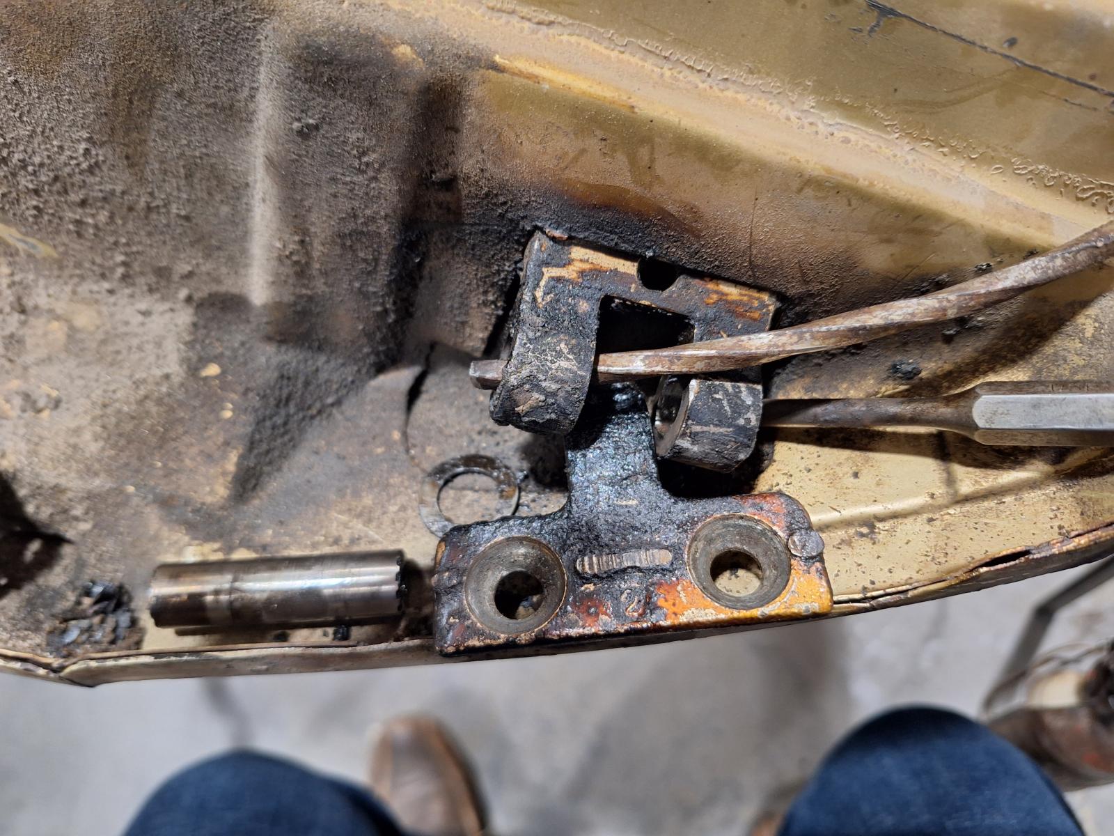

kevw411
Joined: December 30, 2001
Posts: 8
kevw411 is offline
PostPosted: Thu Oct 26, 2023 7:16 pm    Post subject: Re: Door hinges 1974 412 wagon Reply with quote
Let hinges soak overnight with Kano Koil and heated up with propane torch. Tapped with hammer and punch from top down while heating and pins came out from the bottom easier than I thought. Pins do have about a couple thou of an inch of wear where they pivot ( enough to catch your fingernail). Wondering if I can get a machine shop to make new pins if new ones are not available. Wondering how the oil from the under the plastic cap gets to the moving part of the hinge as these pins don't have the helical grooves that I recall seeing on pins from a beetle.
raygreenwood
Joined: November 24, 2008
Posts: 23533
Location: Oklahoma City
raygreenwood is offline
PostPosted: Thu Oct 26, 2023 9:58 pm    Post subject: Re: Door hinges 1974 412 wagon Reply with quote
Looks like you did well!
Just for posterity...can you measure length and diameter in an unworn spot? Its possible that we could just use or modify another pin from another car if we know those numbers!

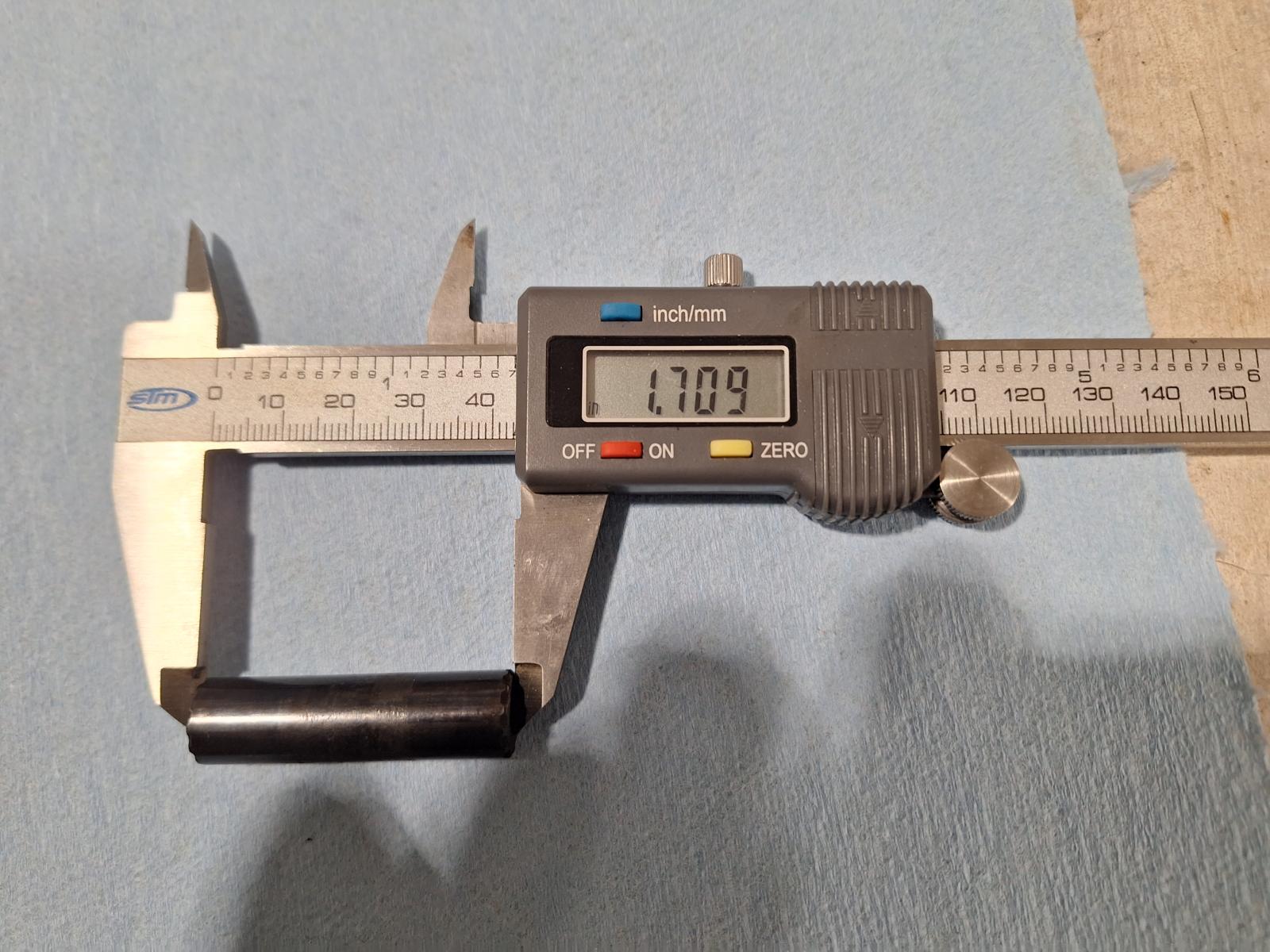

kevw411
Posts: 8
kevw411 is offline
PostPosted: Fri Oct 27, 2023 3:21 pm    Post subject: Re: Door hinges 1974 412 wagon Reply with quote
Measurements in inches
raygreenwood
Posts: 23533
PostPosted: Fri Oct 27, 2023 4:07 pm    Post subject: Re: Door hinges 1974 412 wagon Reply with quote
Thanks for the measurements!

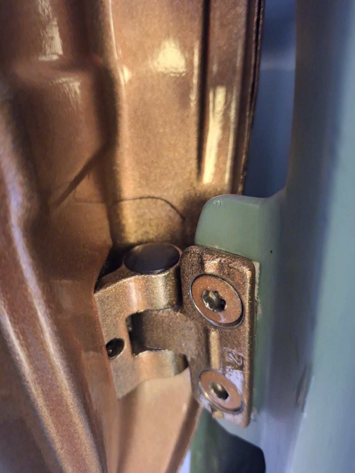

kevw411
Posts: 8
kevw411 is offline
PostPosted: Sat Oct 28, 2023 12:10 pm    Post subject: Re: Door hinges 1974 412 wagon Reply with quote
Took some photos of the inner door area where the hinges are located. Not much to see as the hinges are obstructed by the inner door structure. Assuming this is here to support the federally mandated side impact door beam. As this car is a 1974 makes me wonder if earlier cars on non US spec have this. The black coating is from when the car was Ziebarted when new.

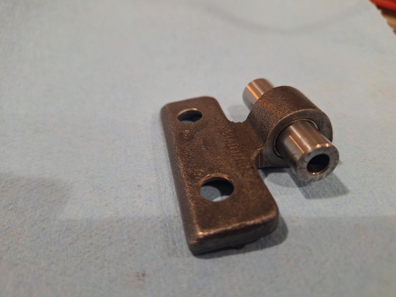

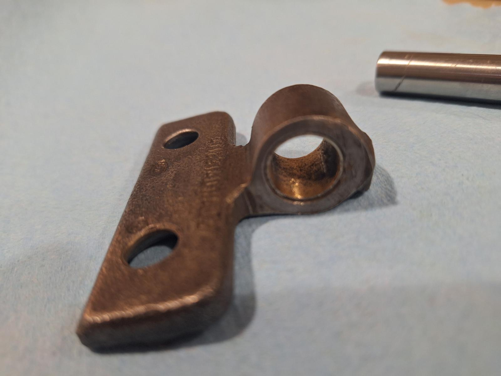

kevw411
Posts: 8
kevw411 is offline
PostPosted: Tue May 20, 2025 9:28 am    Post subject: Re: Door hinges 1974 412 wagon Reply with quote
Sorry for 5he late followup on this, but now the door hinges are installed. The machine shop drilled the hinge out and installed brass bushings. And made new pins out of hardened steel. The old plastic oil caps unfortunately not longer fit because the oil hole diameter was too large. Went and bought some automotive press plugs and used instead. They fit and look good. Best of all, no more door sag. See photos below.
