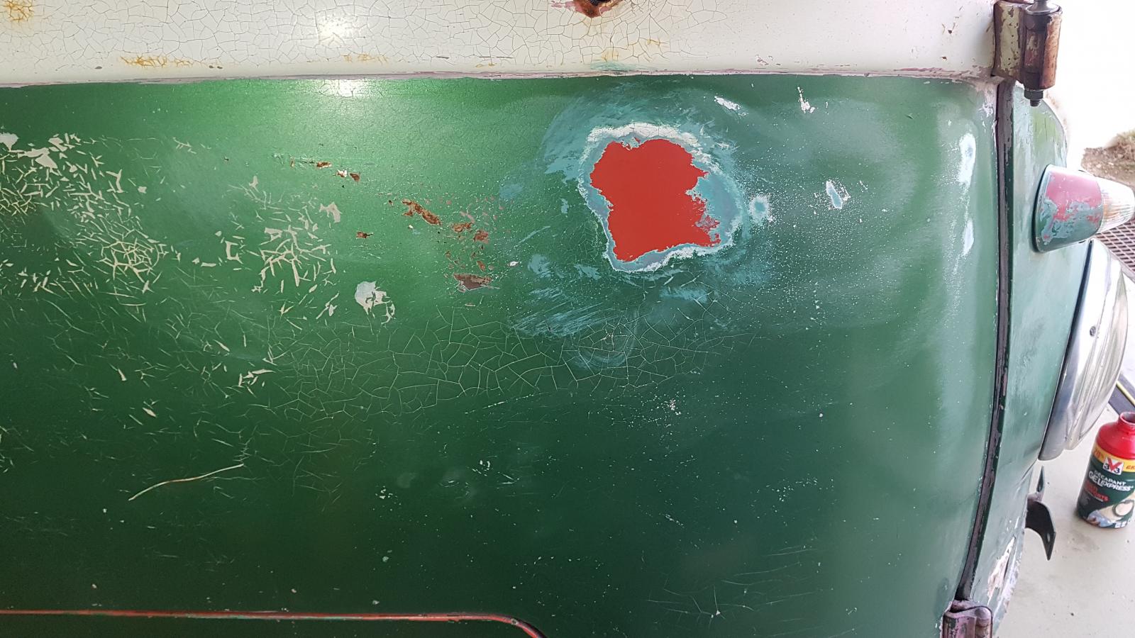

just following thick green paint removal.
Decouraging because it has been a lot of work but the result is not what I expected. Anyway, having good meditation time doing it.
Then I tested passenger's door
and face
Interesting. So I kept on going on face lifting...

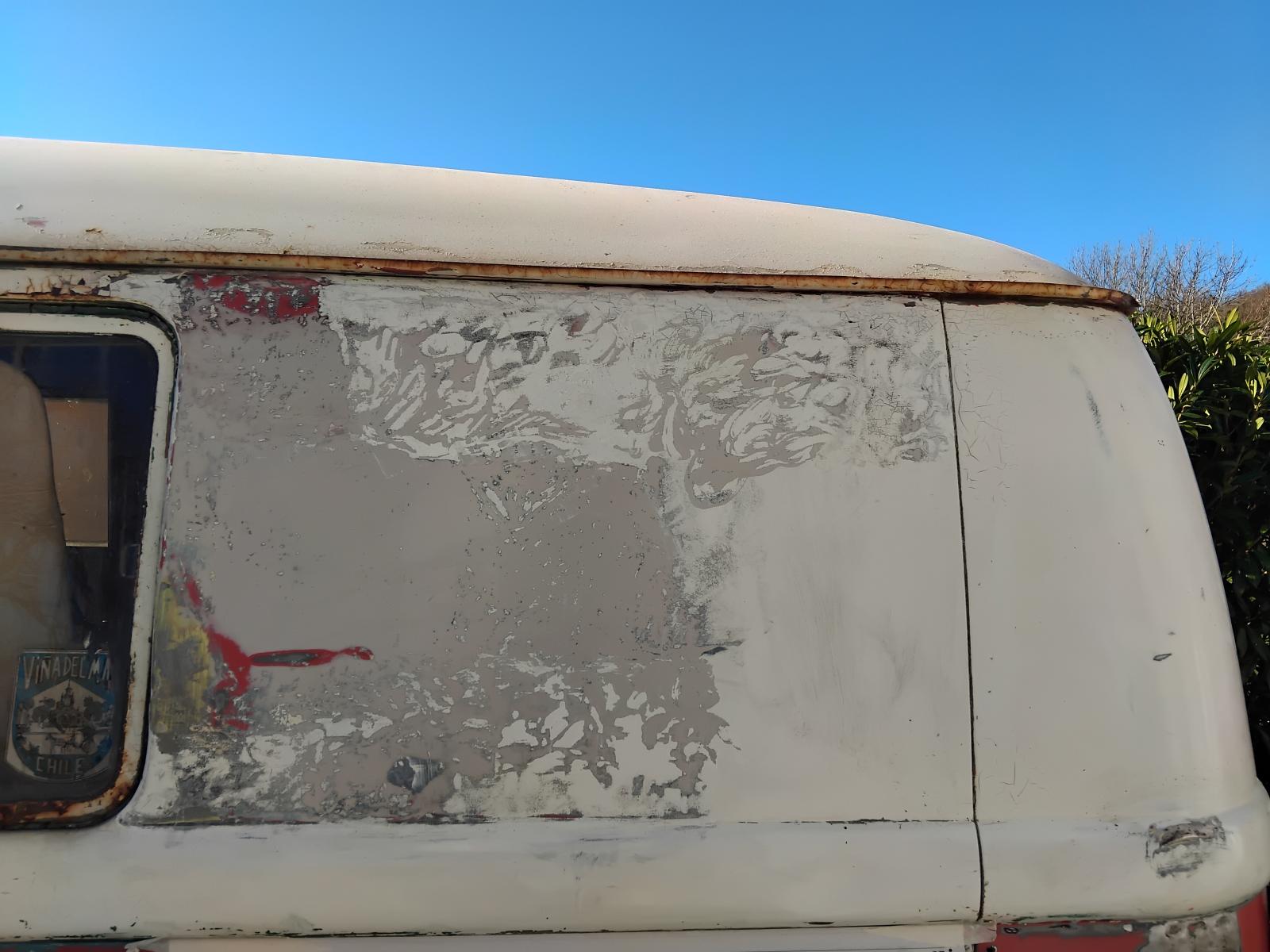

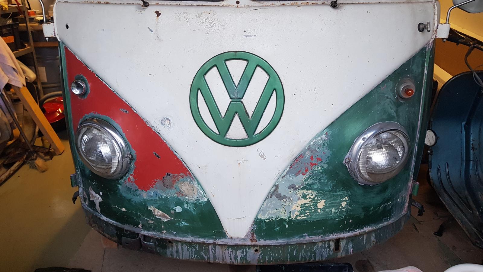

Several months after the las post, some updates:
Green is almost gone. I have to finish details like under belt, around front lights, decklid details… (the longest part!). I realise that I have no pictures. I will post them to show how much bare metal I found Crying or Very sad ! There are some little parts that I will sandblast.
And I did what I should not: I tried the white painting because it was too white to be true and was also cracking as the green one…
I found this nice white pointing out. That look interesting to me.
Is that the original white? It is ‘grayish’.
Thank you.
White paint was easier to remove than green one. So I kept on:
In ‘only’ 2 hours I did this (you might thing that I spent 35’ only for 1 air vent)

The "Grey" looks like Beige Grey, which is the original upper body color for your Bus.
It looks like the White is easier to remove and might come out pretty nice.

In the 'Idiot Book,' John Muir quotes an I Ching proverb: 'Perseverance Furthers.' Removing paint should be used to illustrate this proverb! IImpressive you have kept at it, and you are getting impressive results.
White seems to be the easiest to remove on my bus as well, and you will find the factory paint underneath worth the effort to expose.
Now, when all the old paint is gone, you may decide the end result isn't for you - for every 3 people who tell me my bus looks cool, one asks when I am going to paint it - and that's OK; all this work will have gotten you down to a decent paint layer to start from. All those layers on top of the factory paint would have made good results from a respray difficult.
I like buses that look worn, but not rattty. I also admire a full resto. It's your bus, so you get to decide what's right for the two of you...

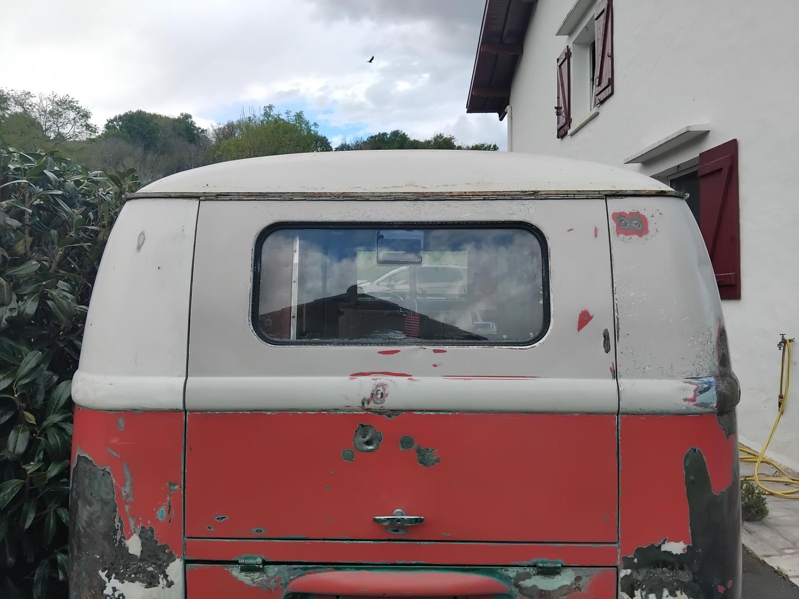

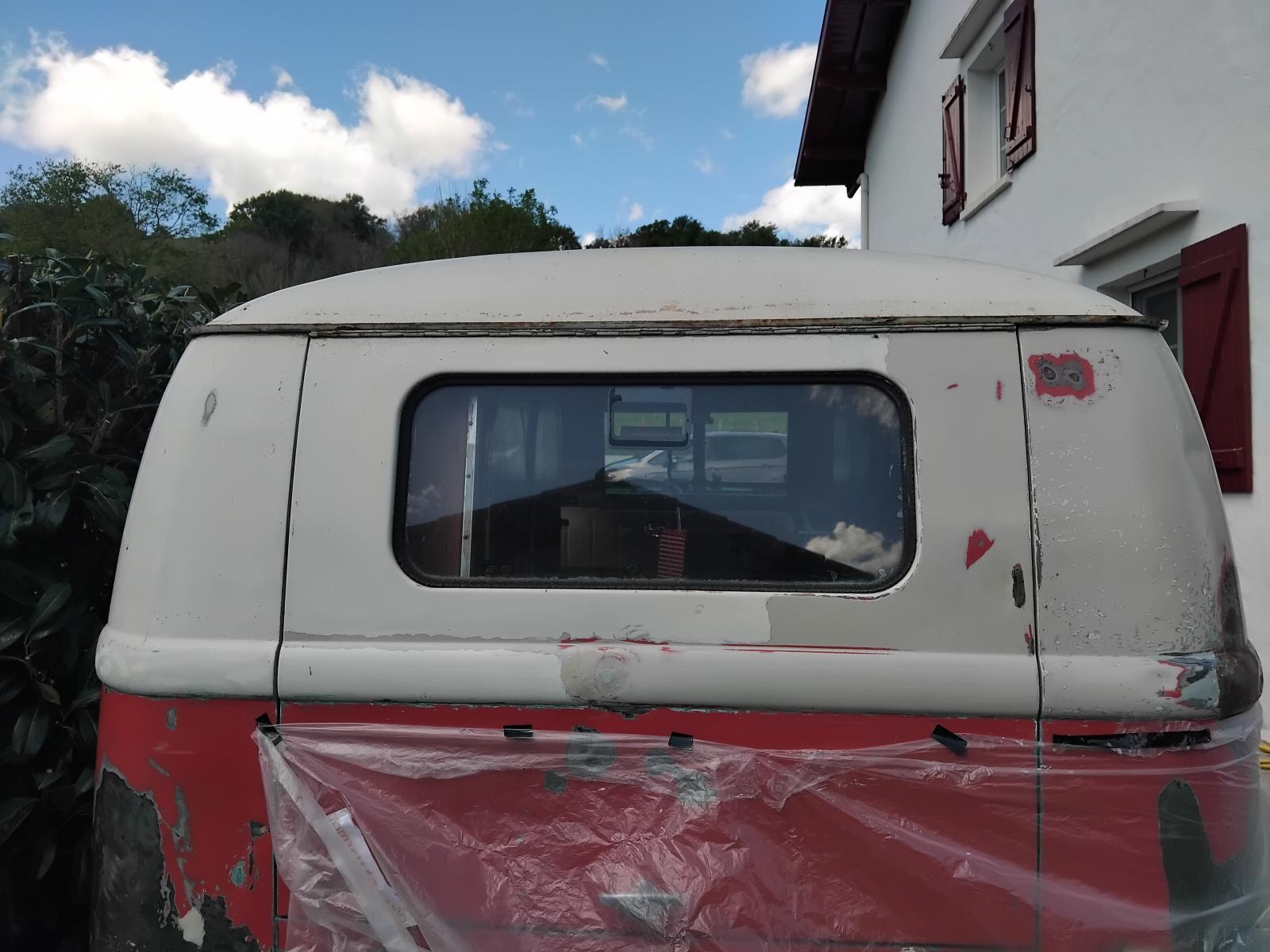

Hello, thank you for your comments.

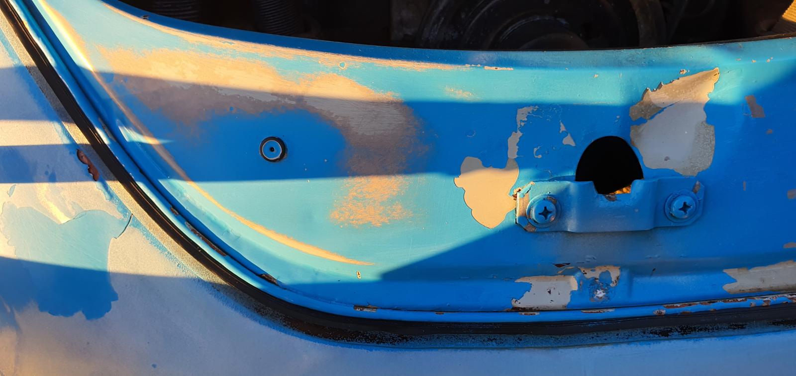

Due to an annoying lack of work, I was able to spend 3 hours with the rear panel. Not disappointed with the result.

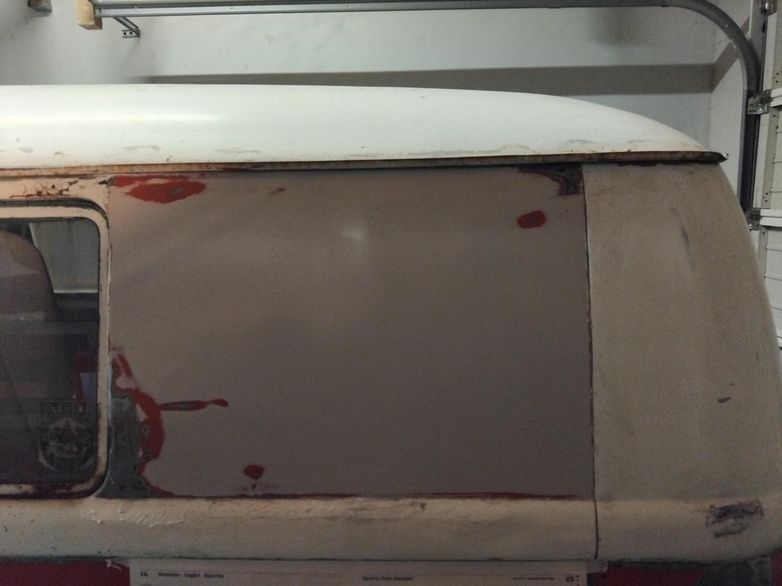

hey, hey, hey!
It's been a while. here you have some more pictures about removing my aftermarket painting.
Surprises here and there, but I start loving its red/beige gray/ raw metal pattern... Laughing
3hours later
in one hour I did only the right corner of the nose.
I keep on going.

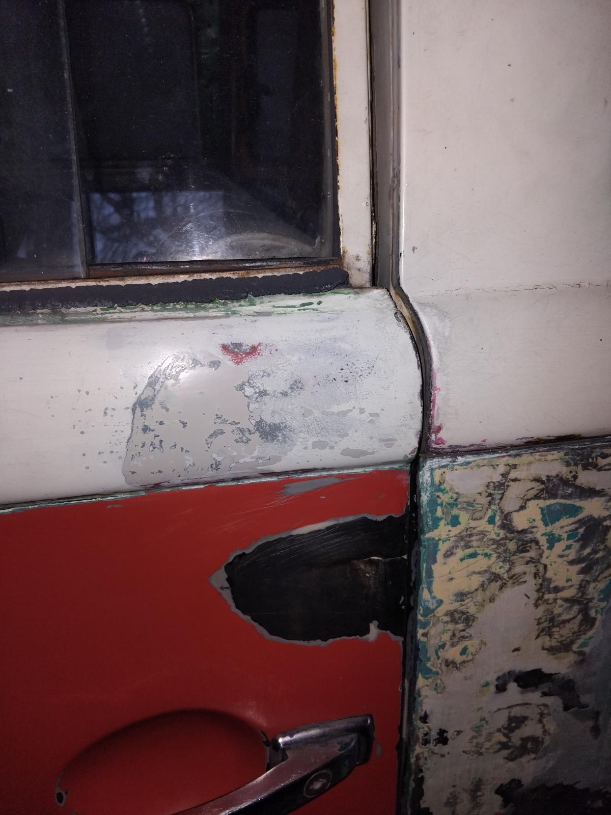

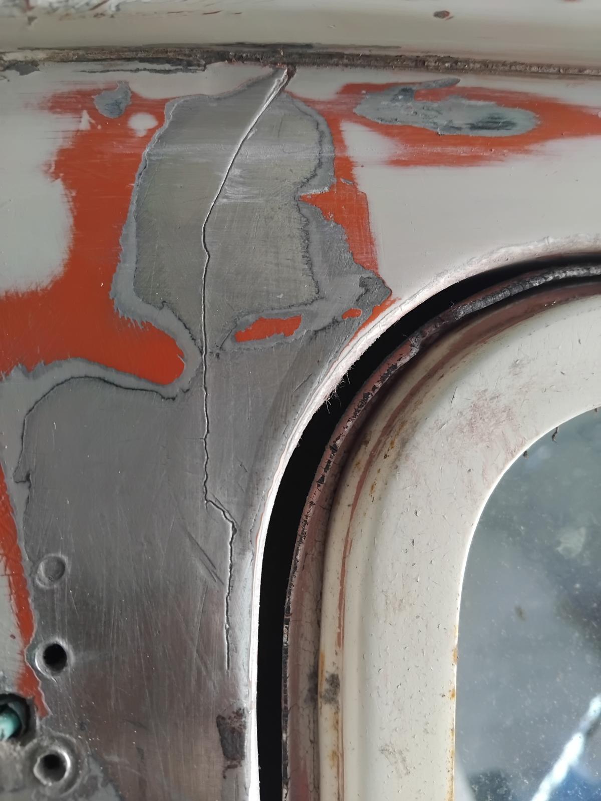

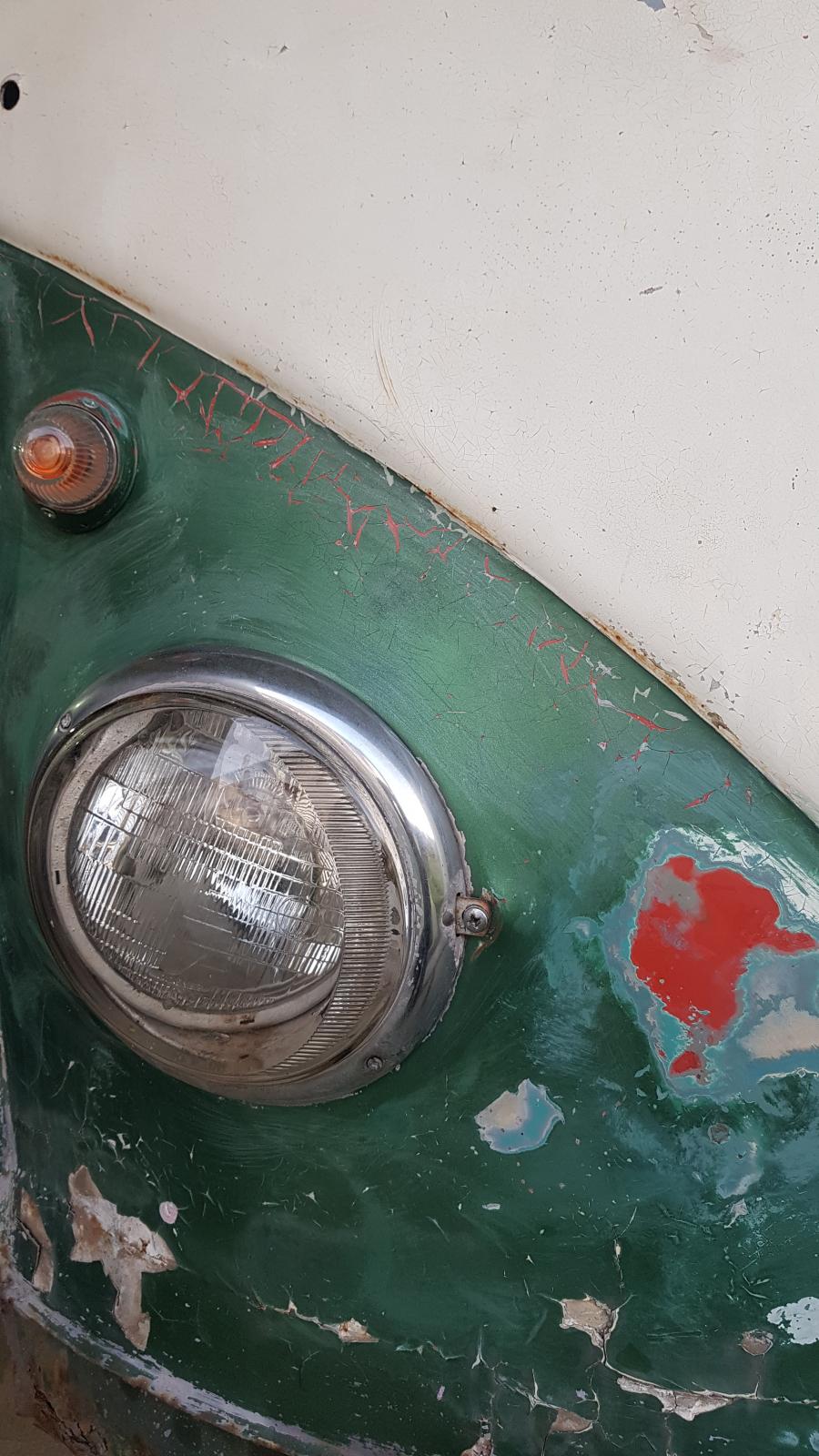

Just keep on removing aftermarket paint. The top part is much easier, but there are much more obstacles ( windows, rubber door stoppers, belt line,...).
The low green paint was uncredibly THICK!!!
And yesterday I got this surprise. On the top of B-pillar, round corner of the passenger’s door window, I found this crack. It had been already stripped to bare metal in the past. No rust seems to be around. How was that possible?

Looks like lead is spread over this entire area and it looks like the metal below and the lead cracked. My guess is there is a bad repair under this area.
