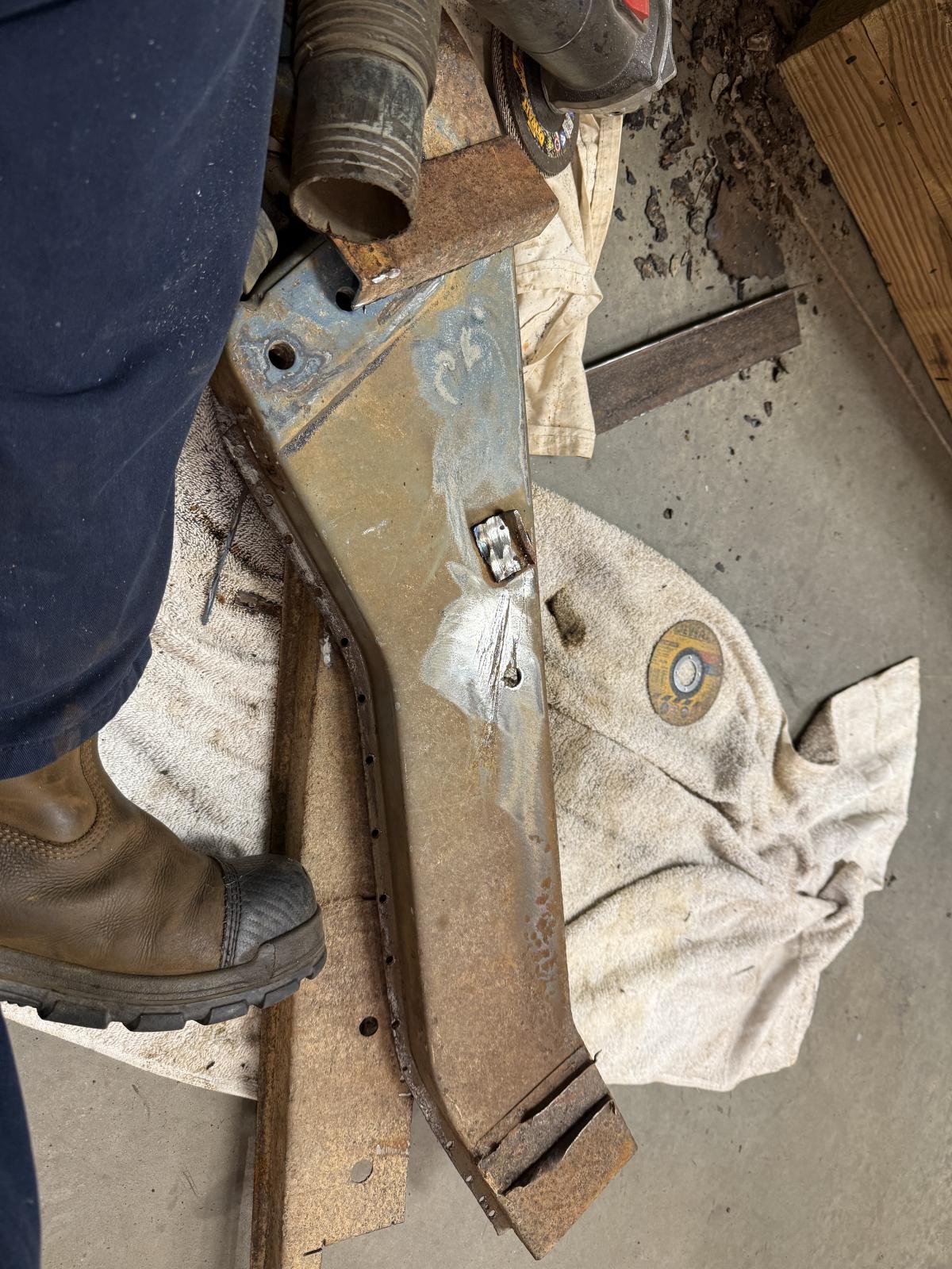

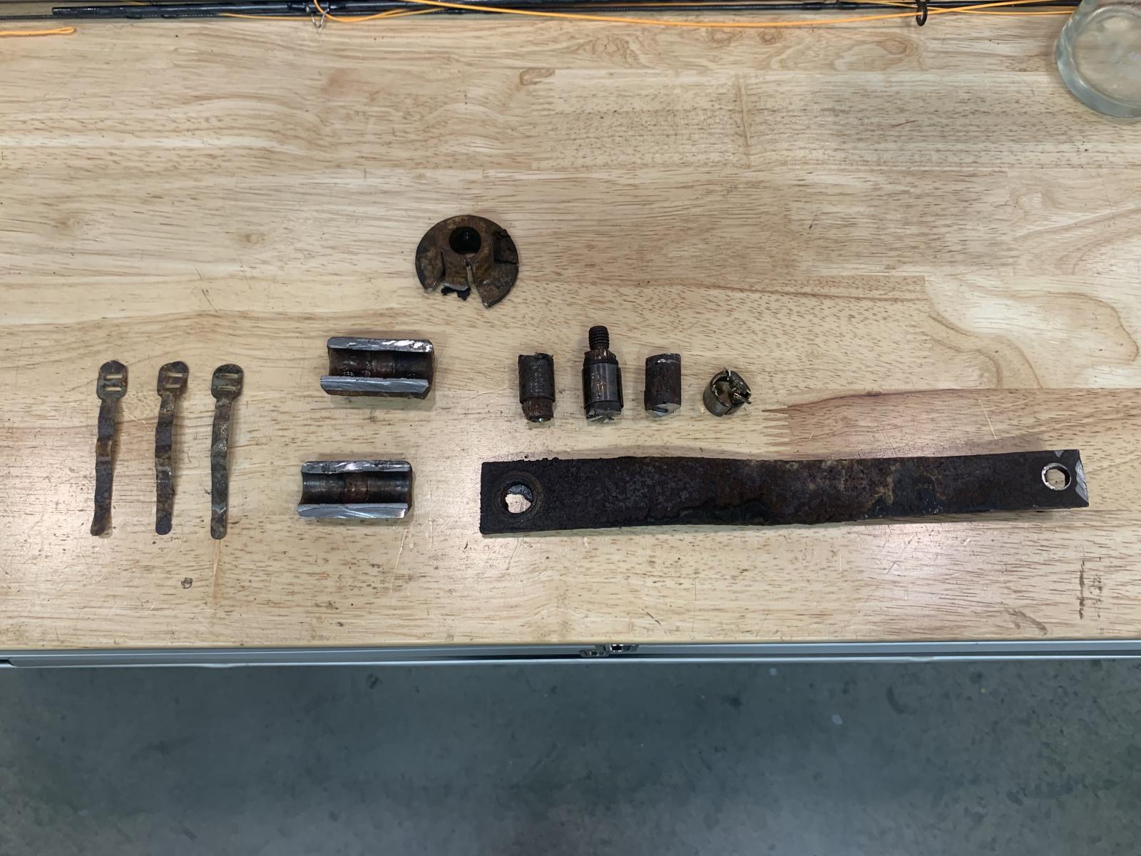

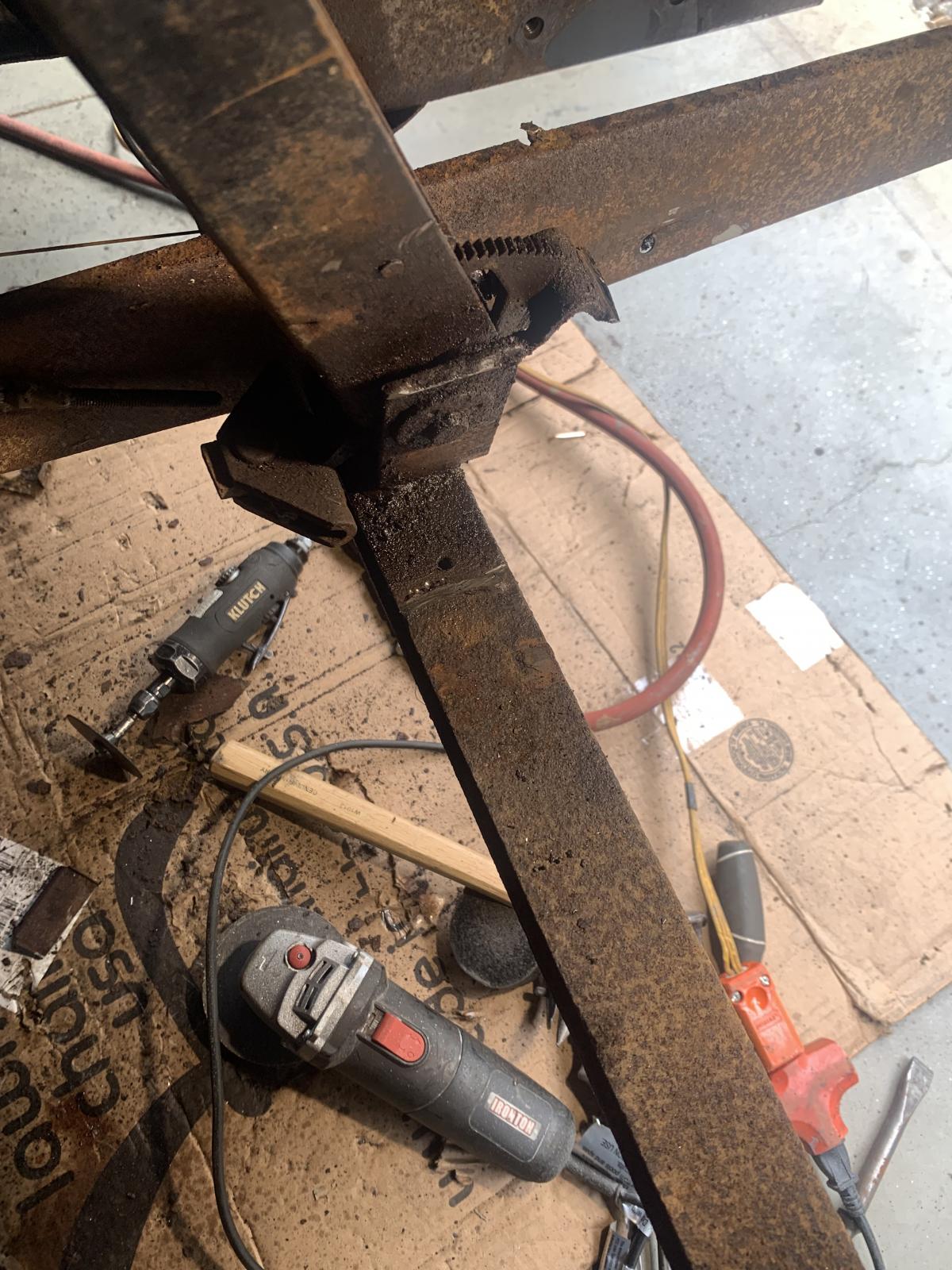

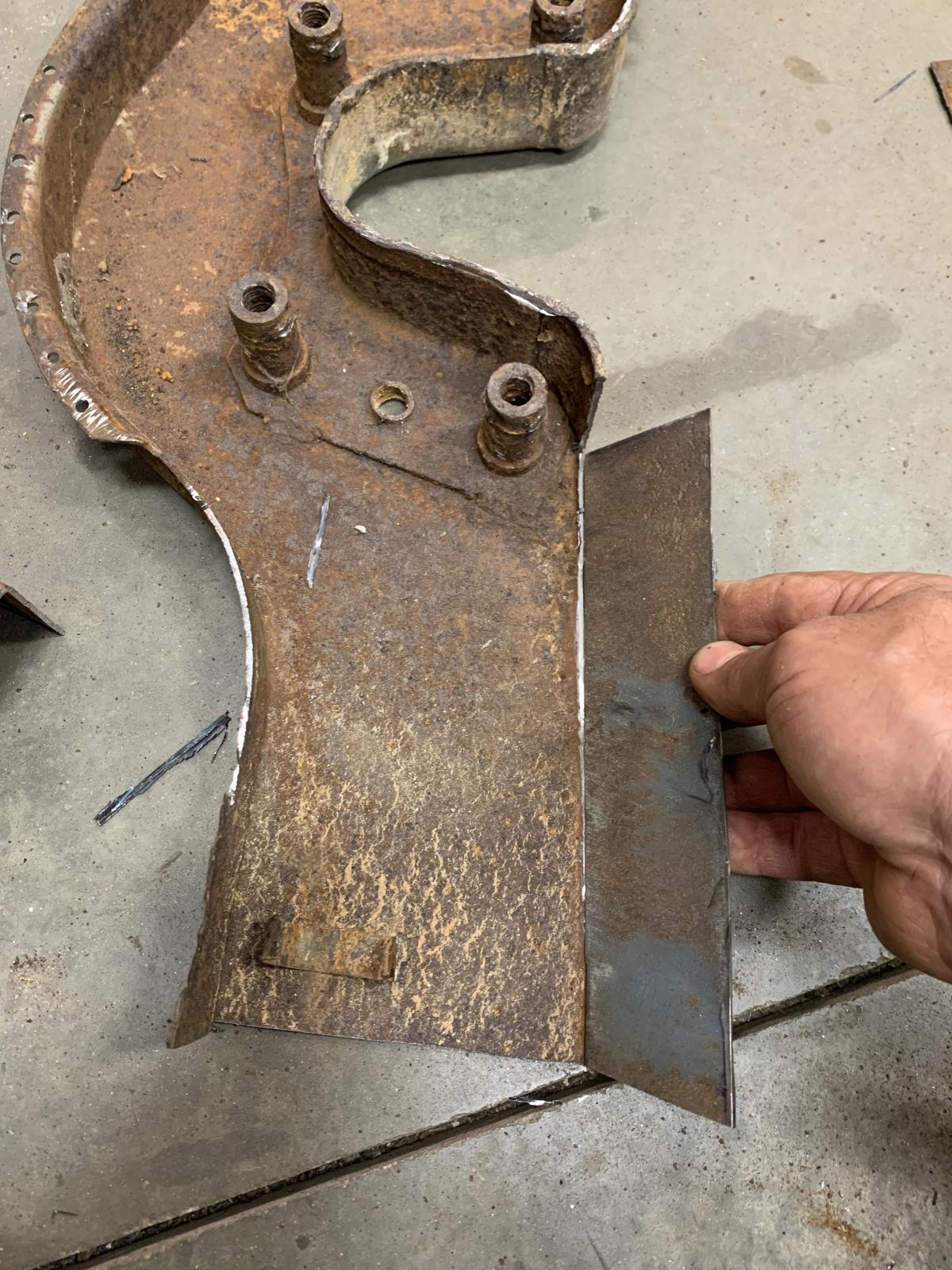

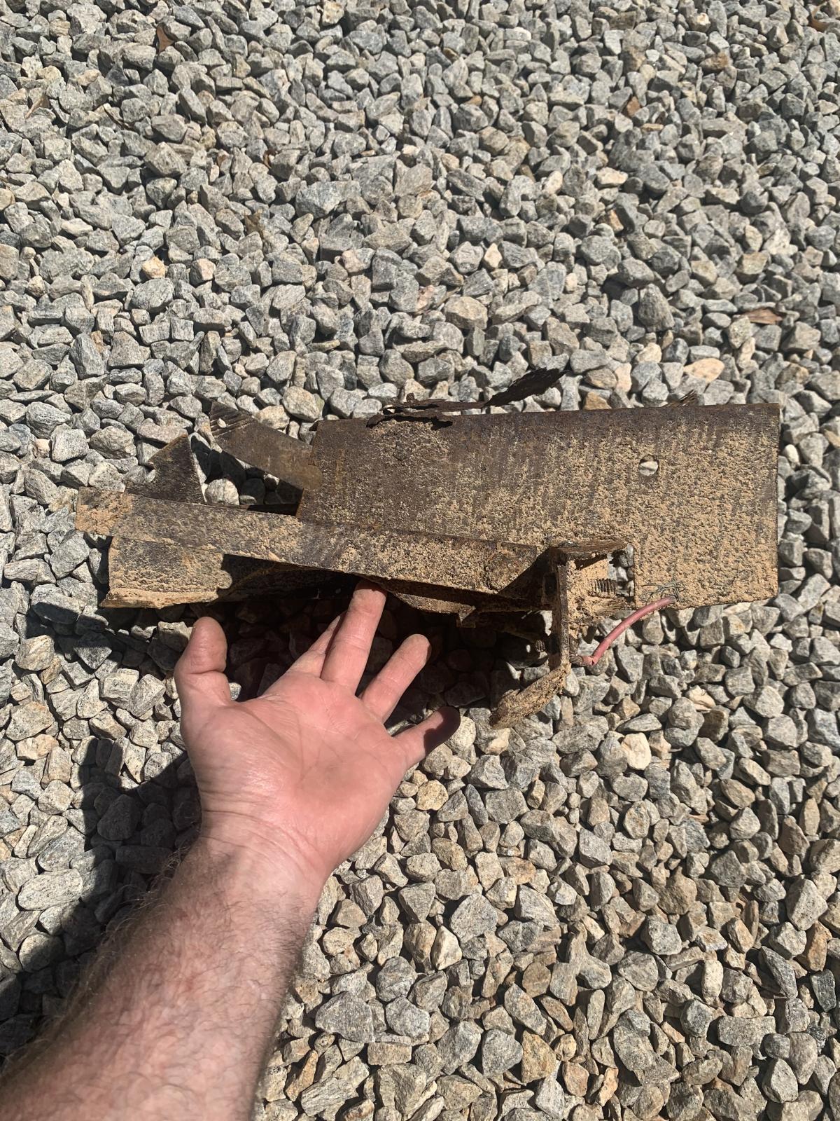

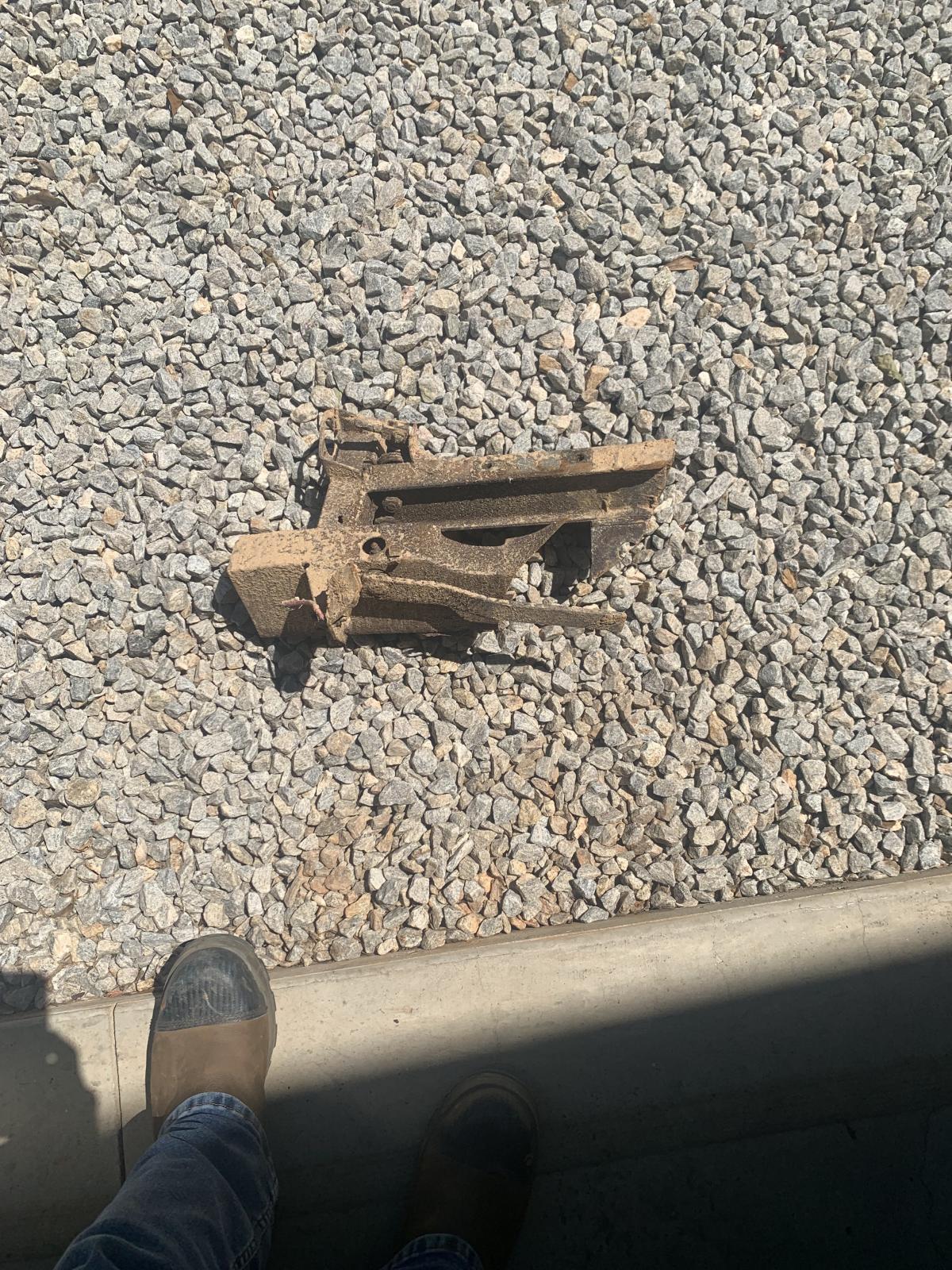

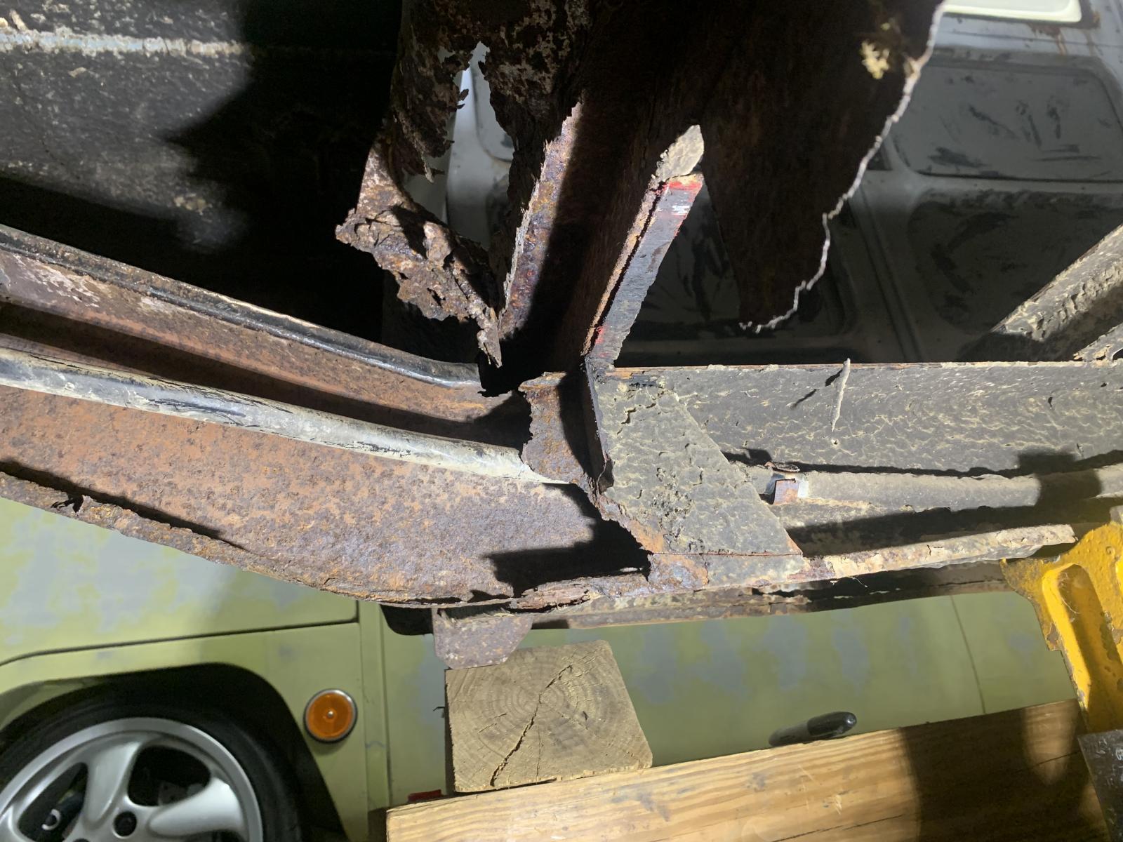

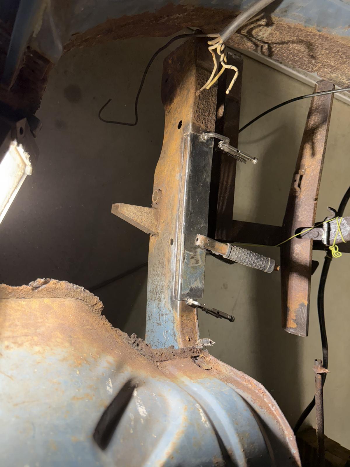

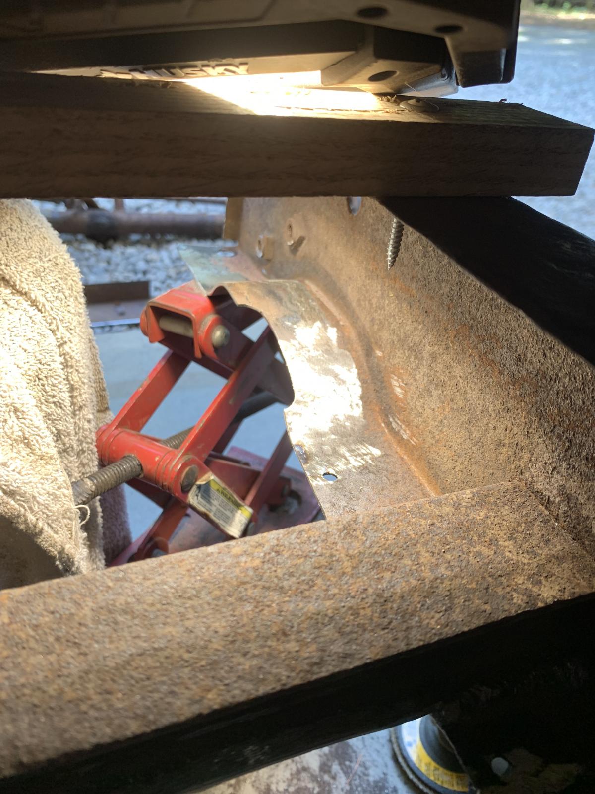

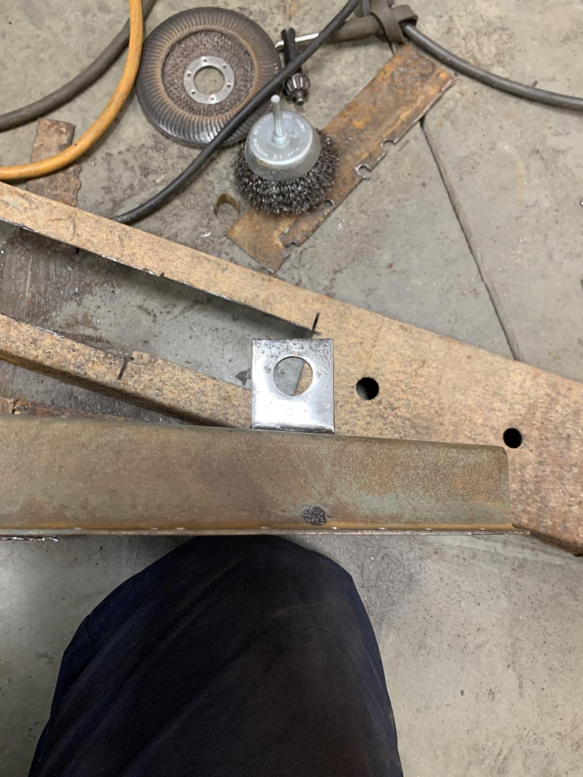

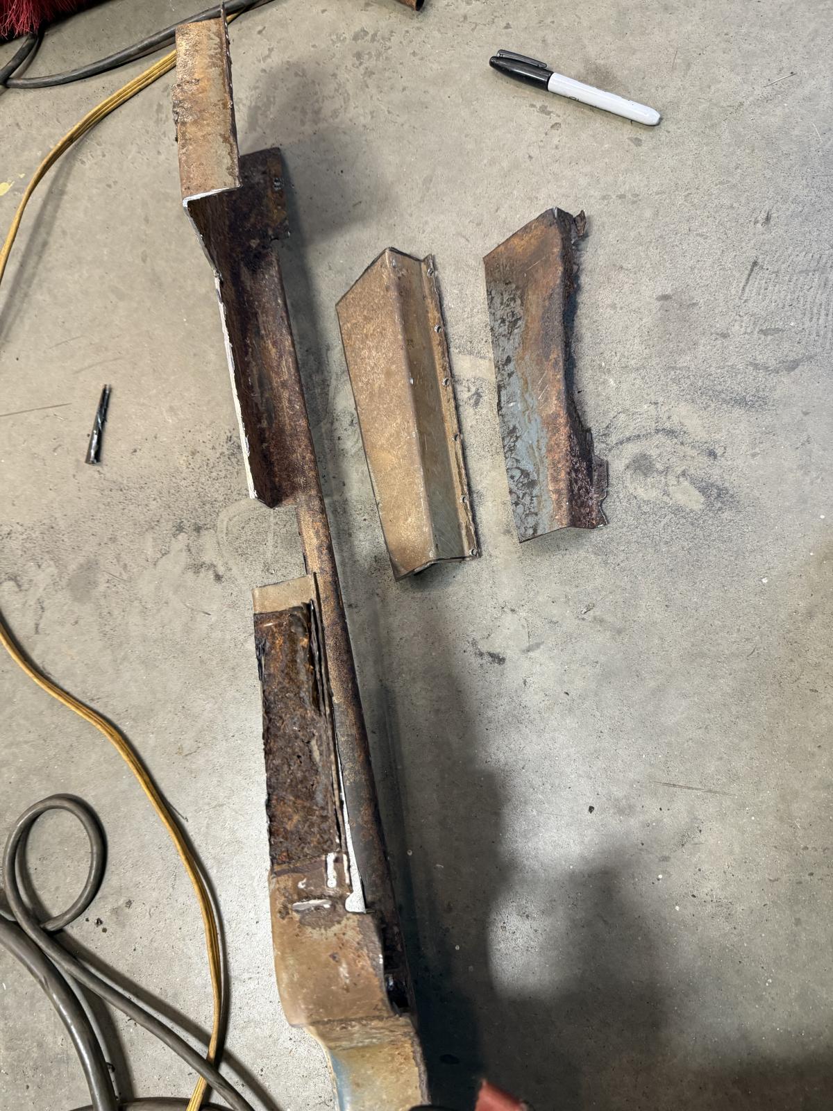

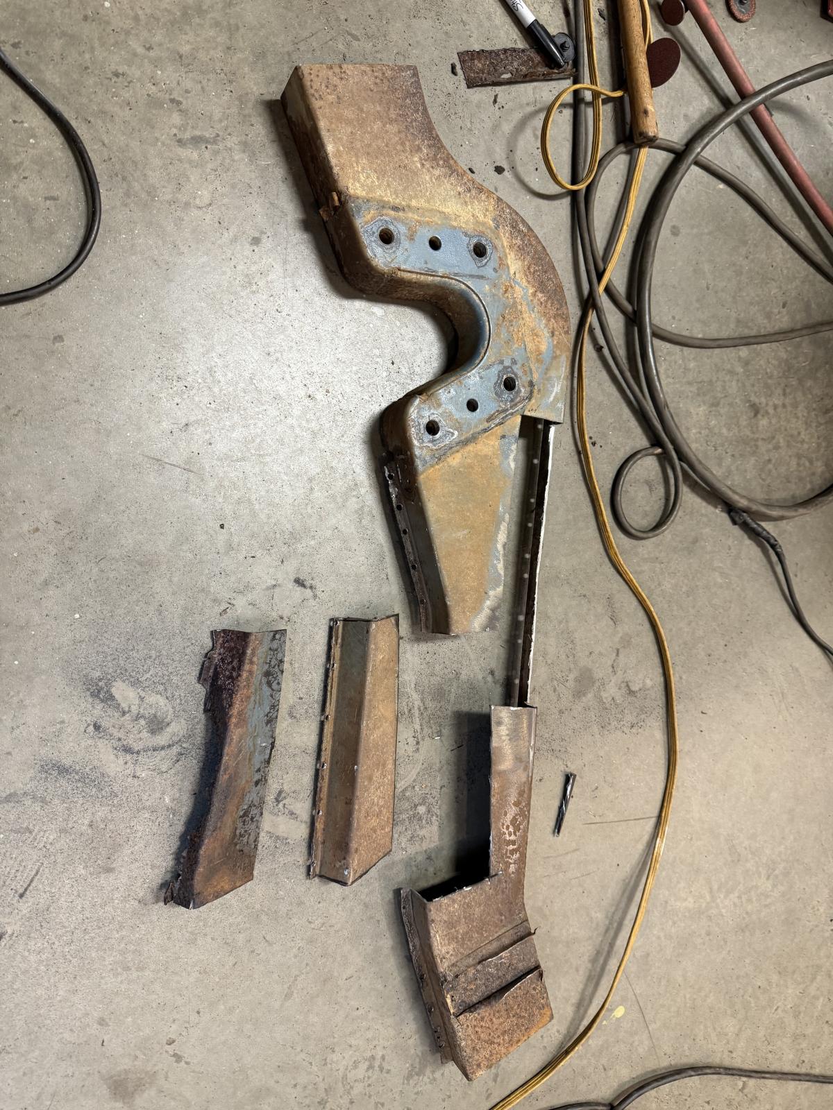

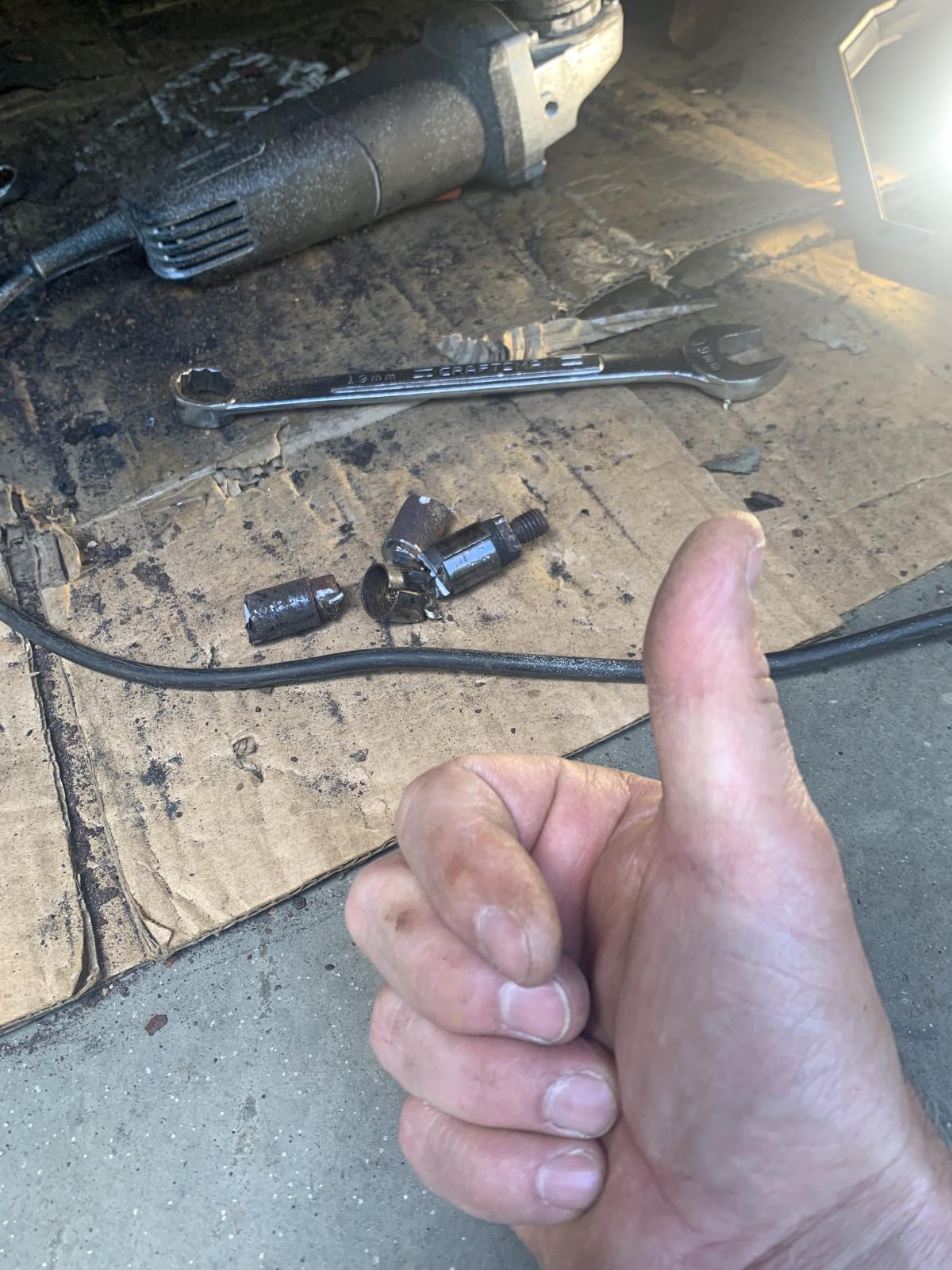

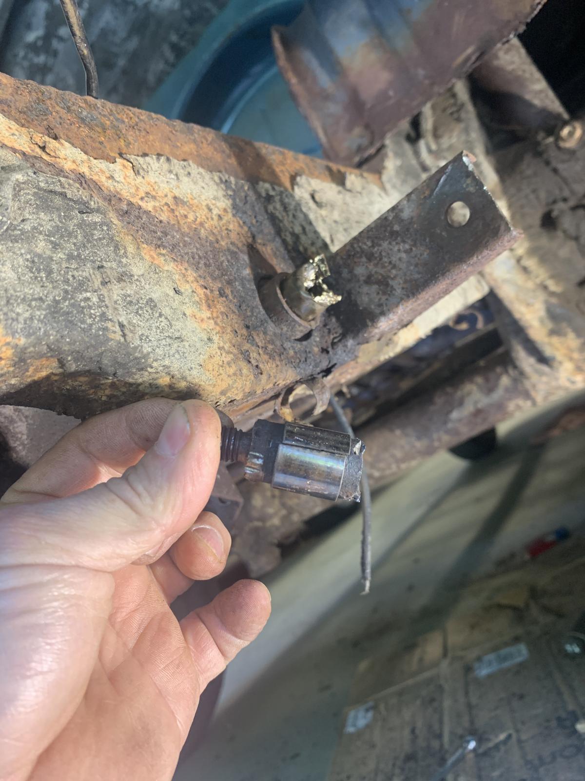

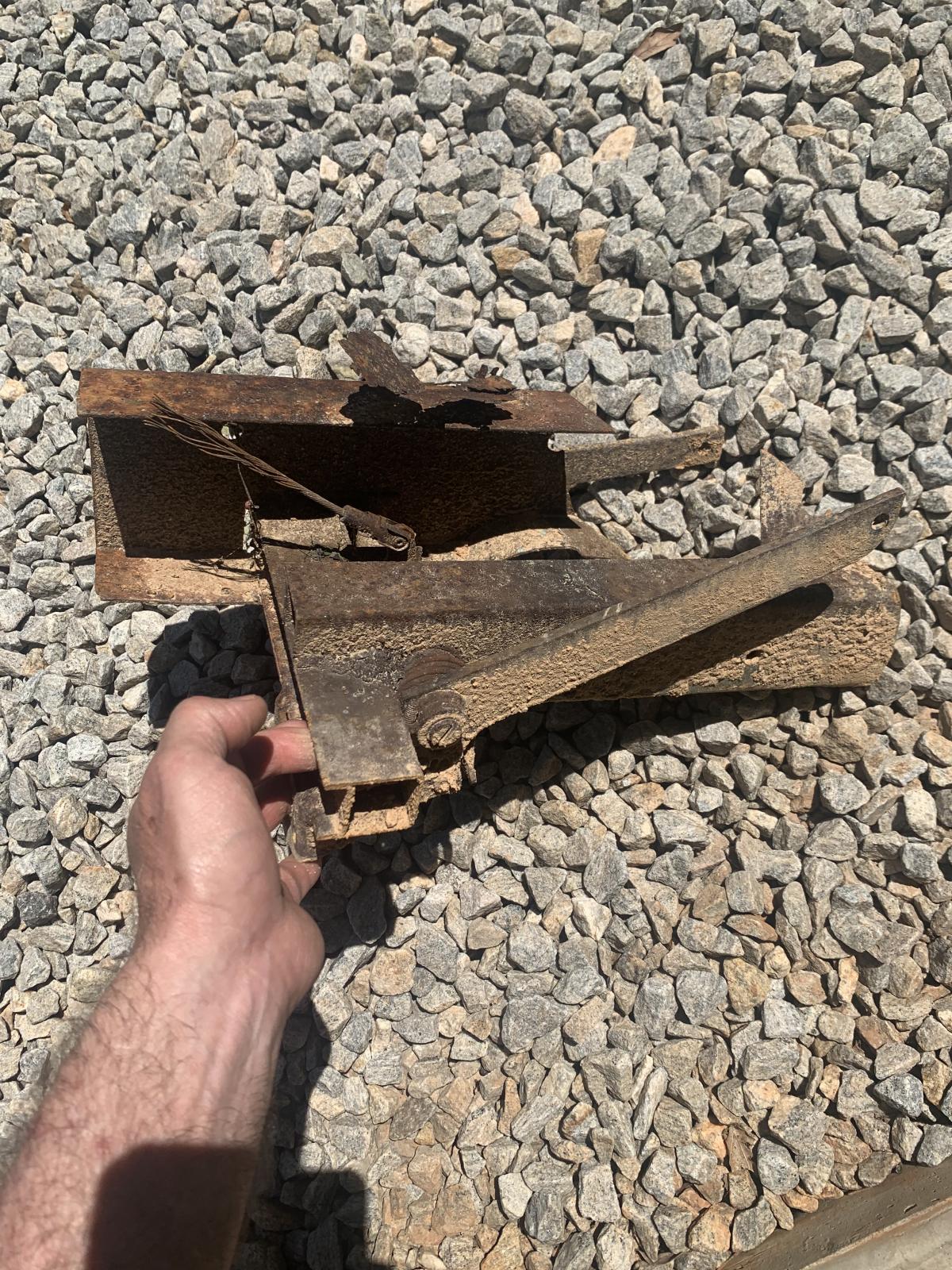

Got some detail work in today and took care of 2 issues I was having! The clutch pedal and lever that was seized and the shifter base plate that was rotted out. I was able to get them both out and even got lucky with a new clutch pedal lever assembly section but will only be using the clutch pedal lever and installing 2 new brass bushings as well. Still cleaning out the chassis framing and about to start with metal replacement. Taking my time to make sure I take care of all this properly for it to last for the next generation of VW keepers!! Wink Thumbs Up
If anyone has a good shifter base plate section for sale, please let me know?
WW nor klassic fab sell this section and would definitely help the project.
Thanks,. Peter

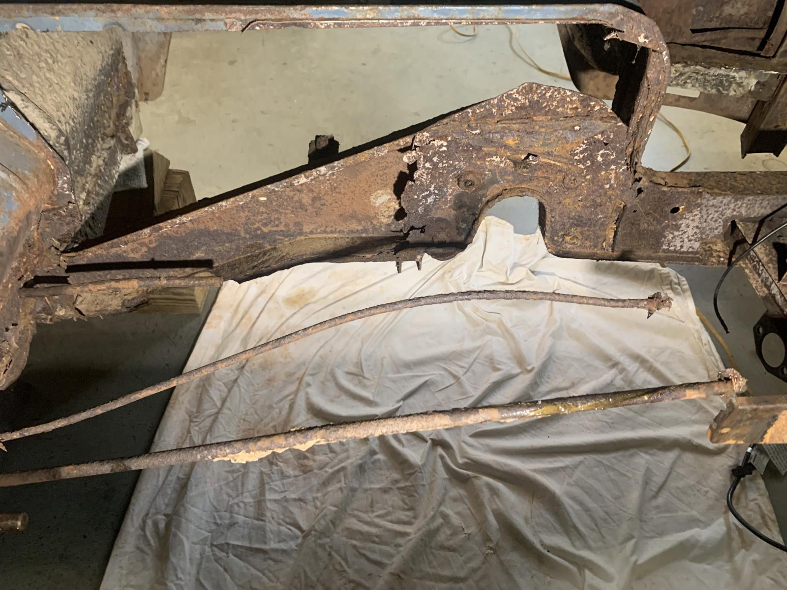

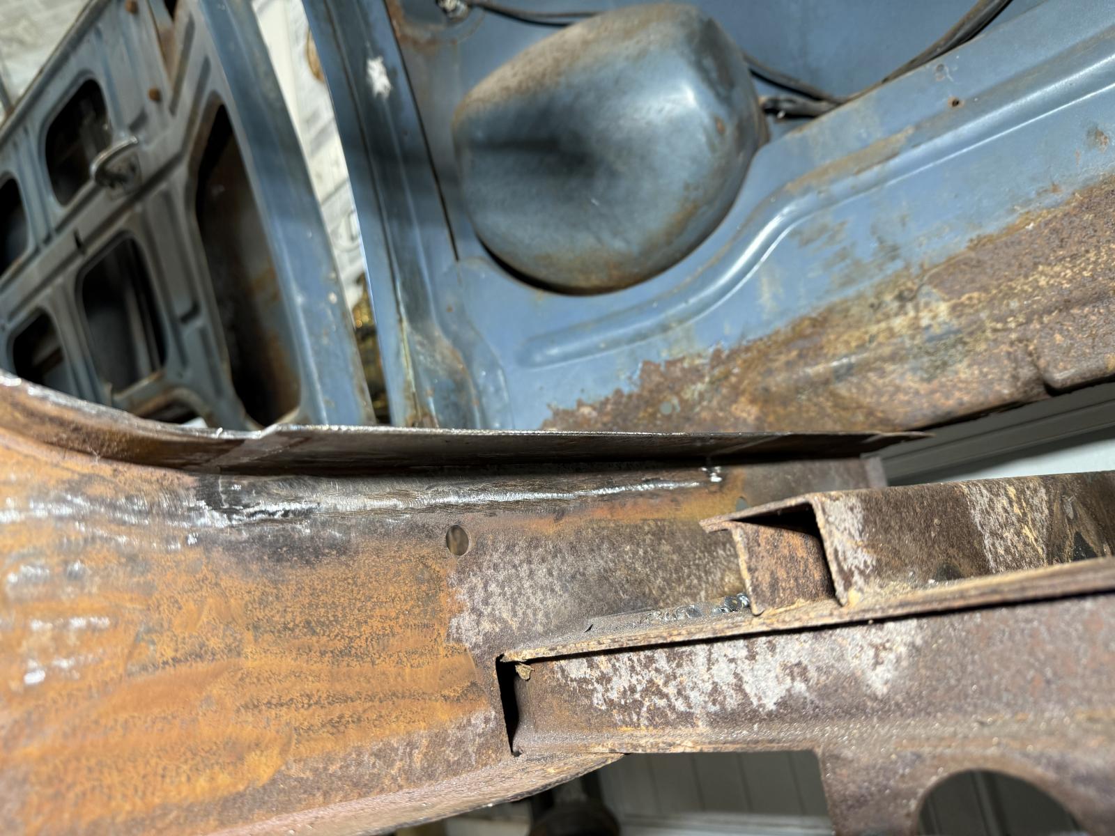

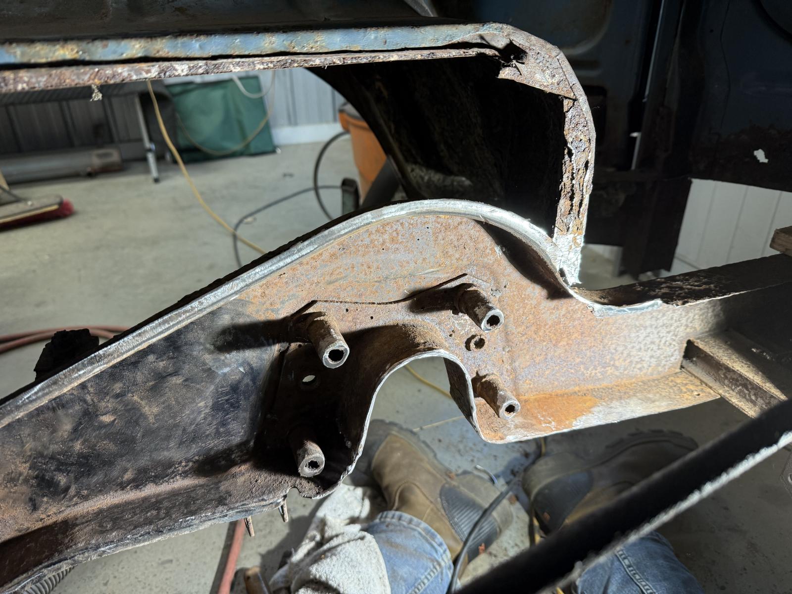

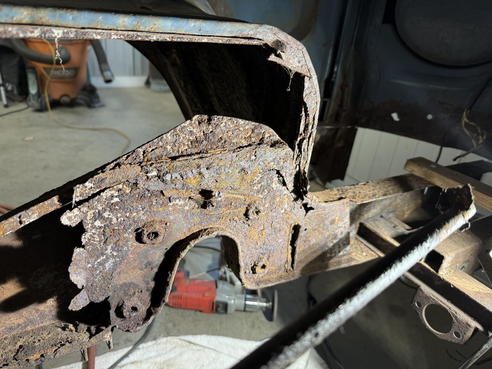

Hello Karl, yes it’s pretty ruff down there but chippin away at it little by little. Trying to clean up the area and then ad a mix of OG, Klassic fab, and Wolfsburgwest metal to get back as solid as possible. It’s definitely gonna take some time but don’t want to cut any corners. Amd my OCD won’t let me do it any other way. I am no professional but I’m gonna give it all I got!! Cool Thumbs Up

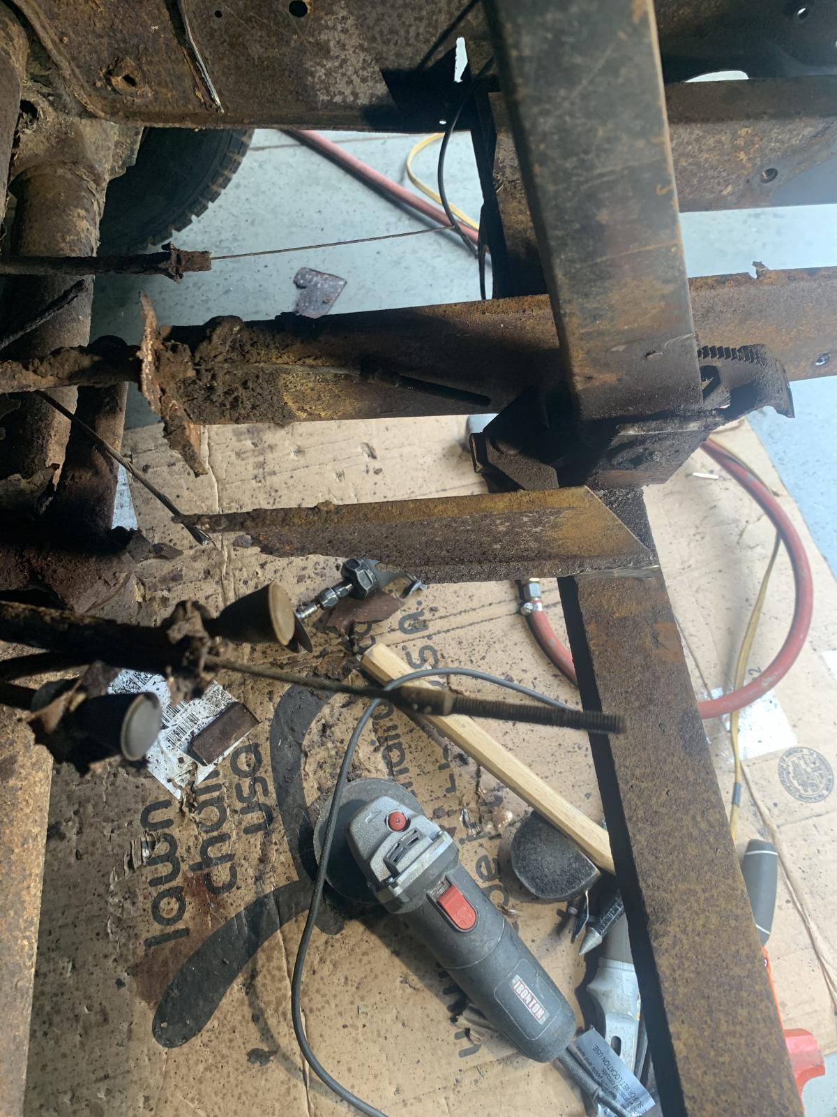

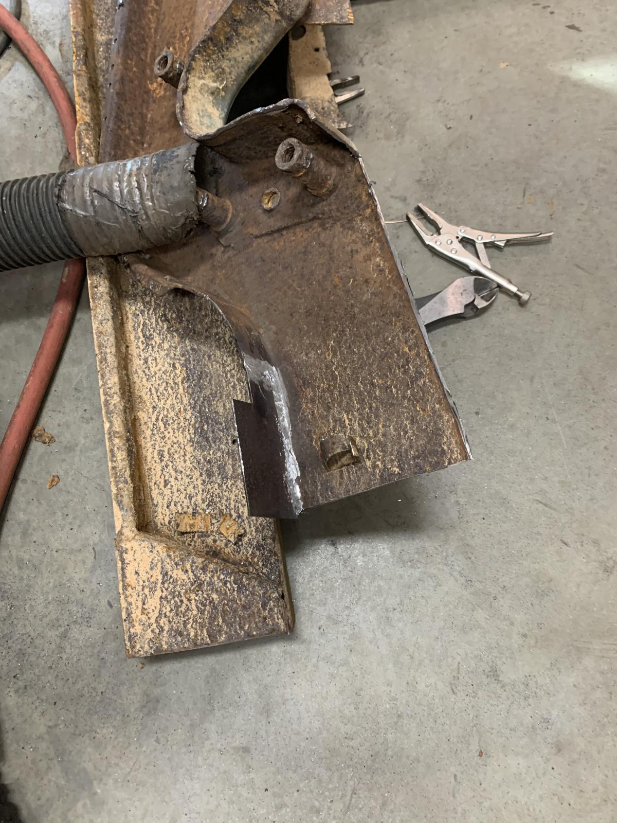

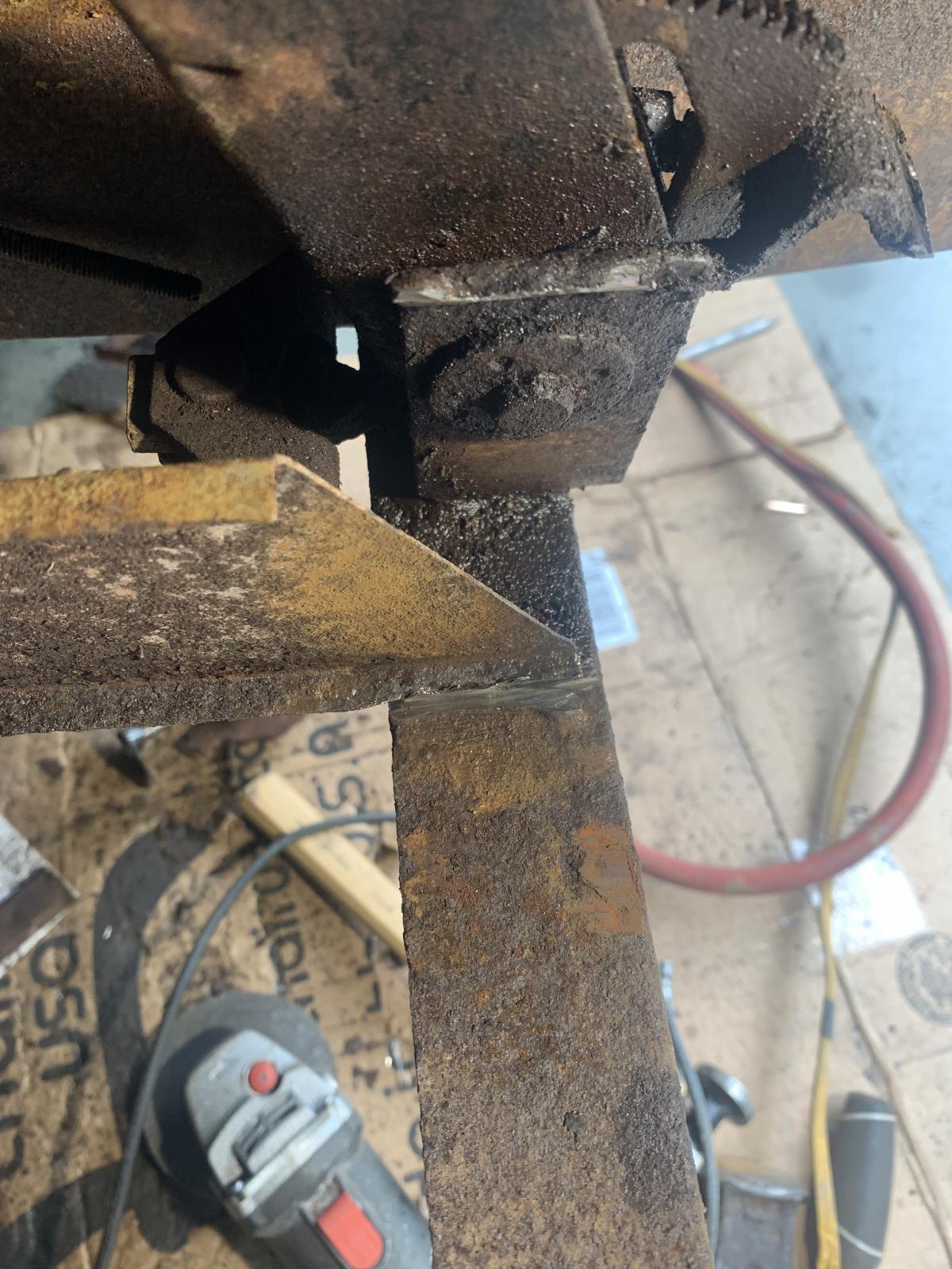

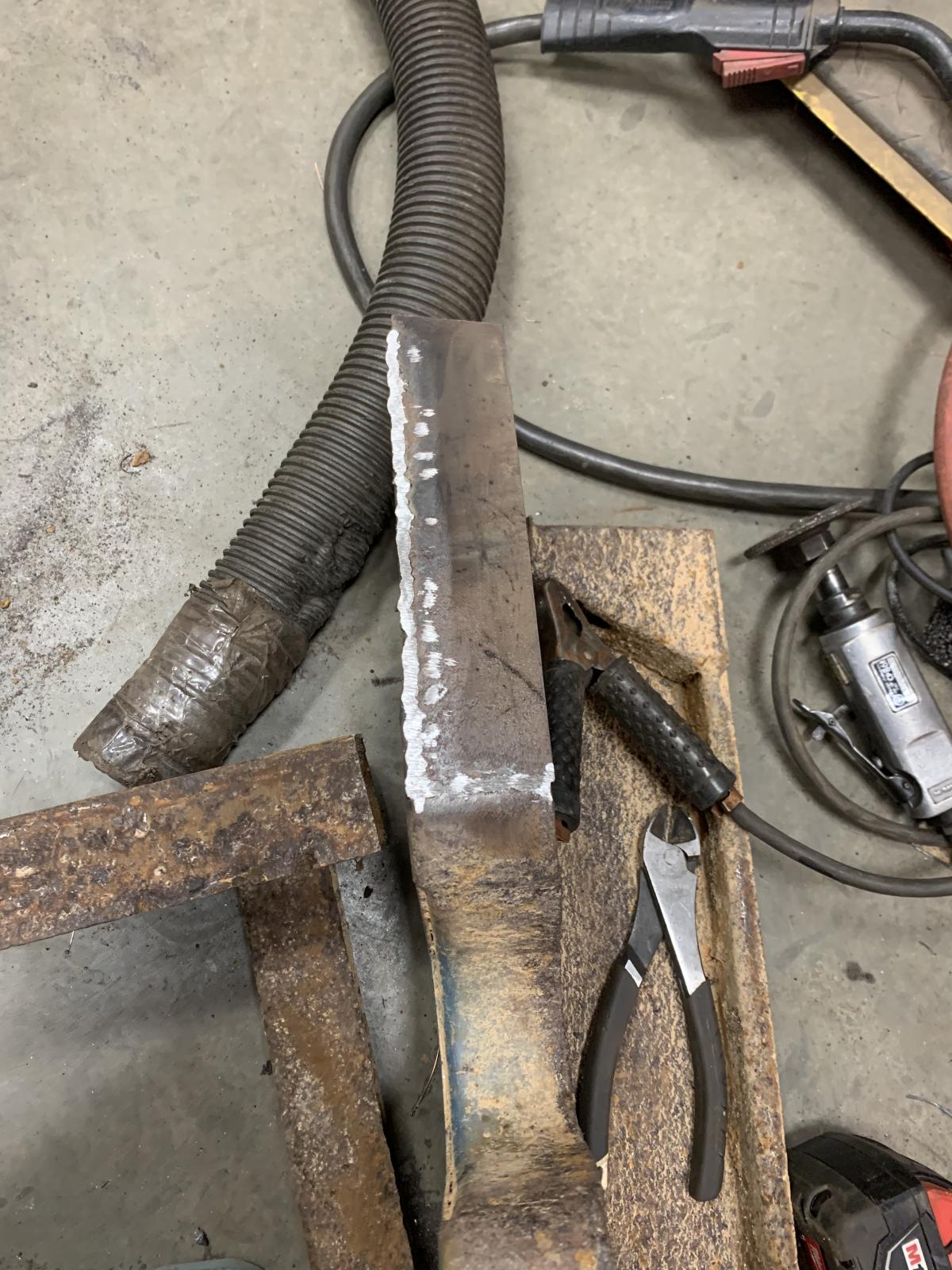

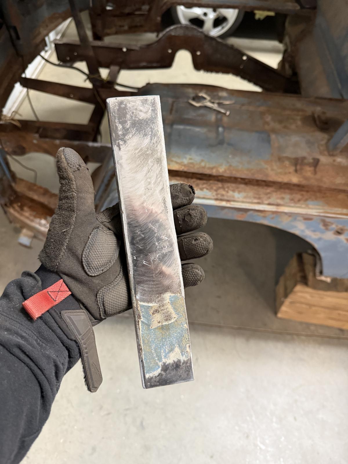

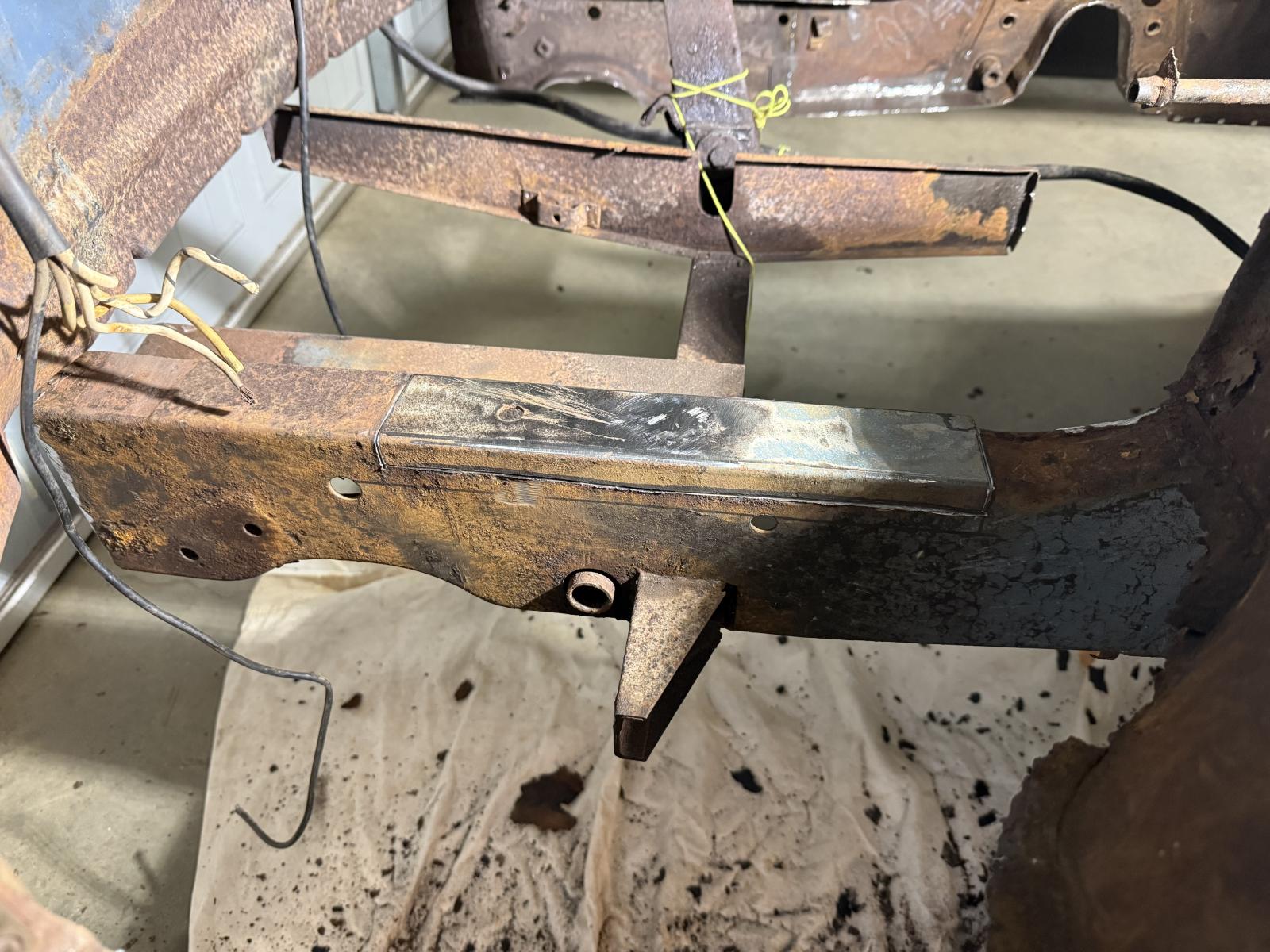

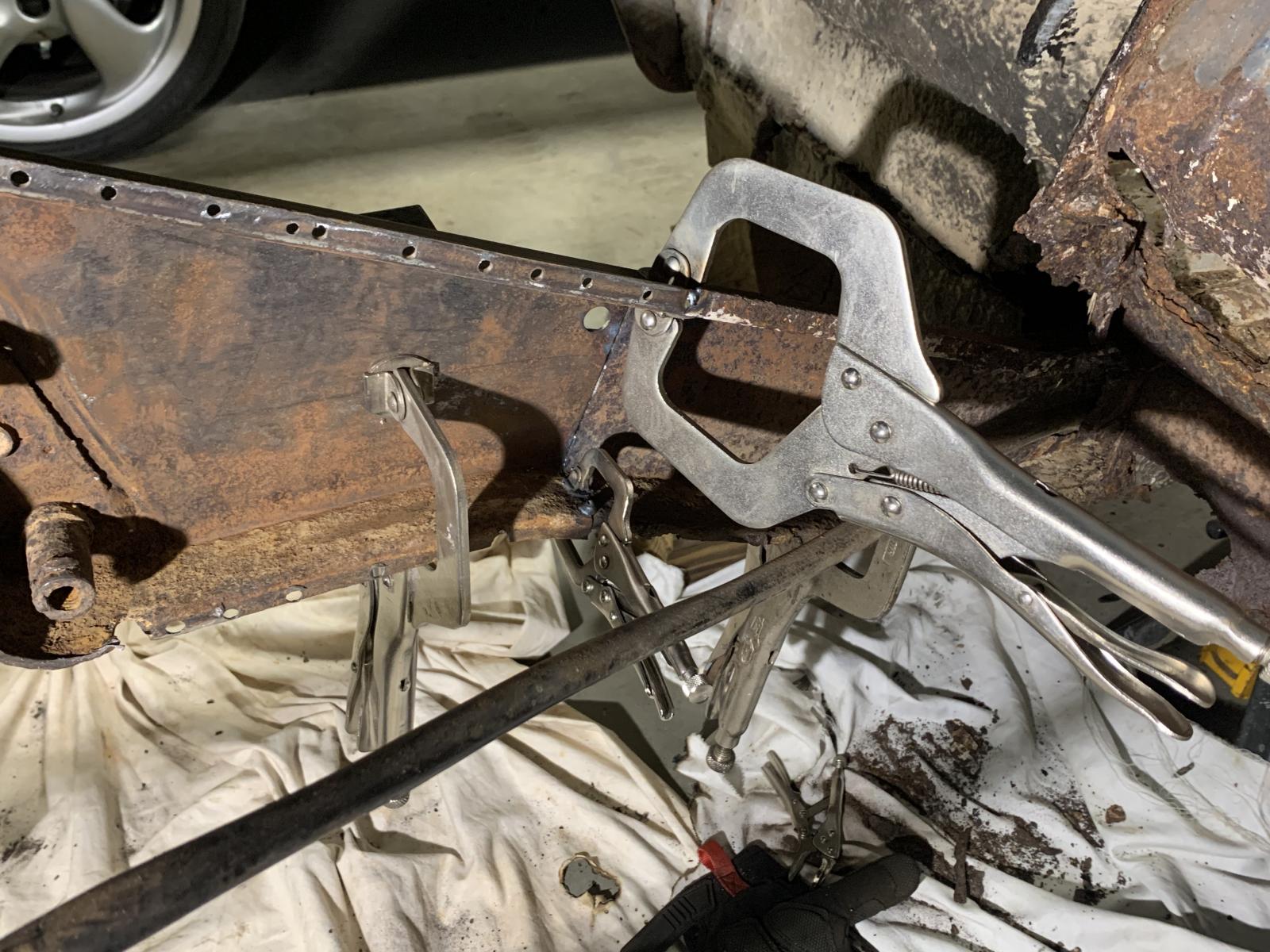

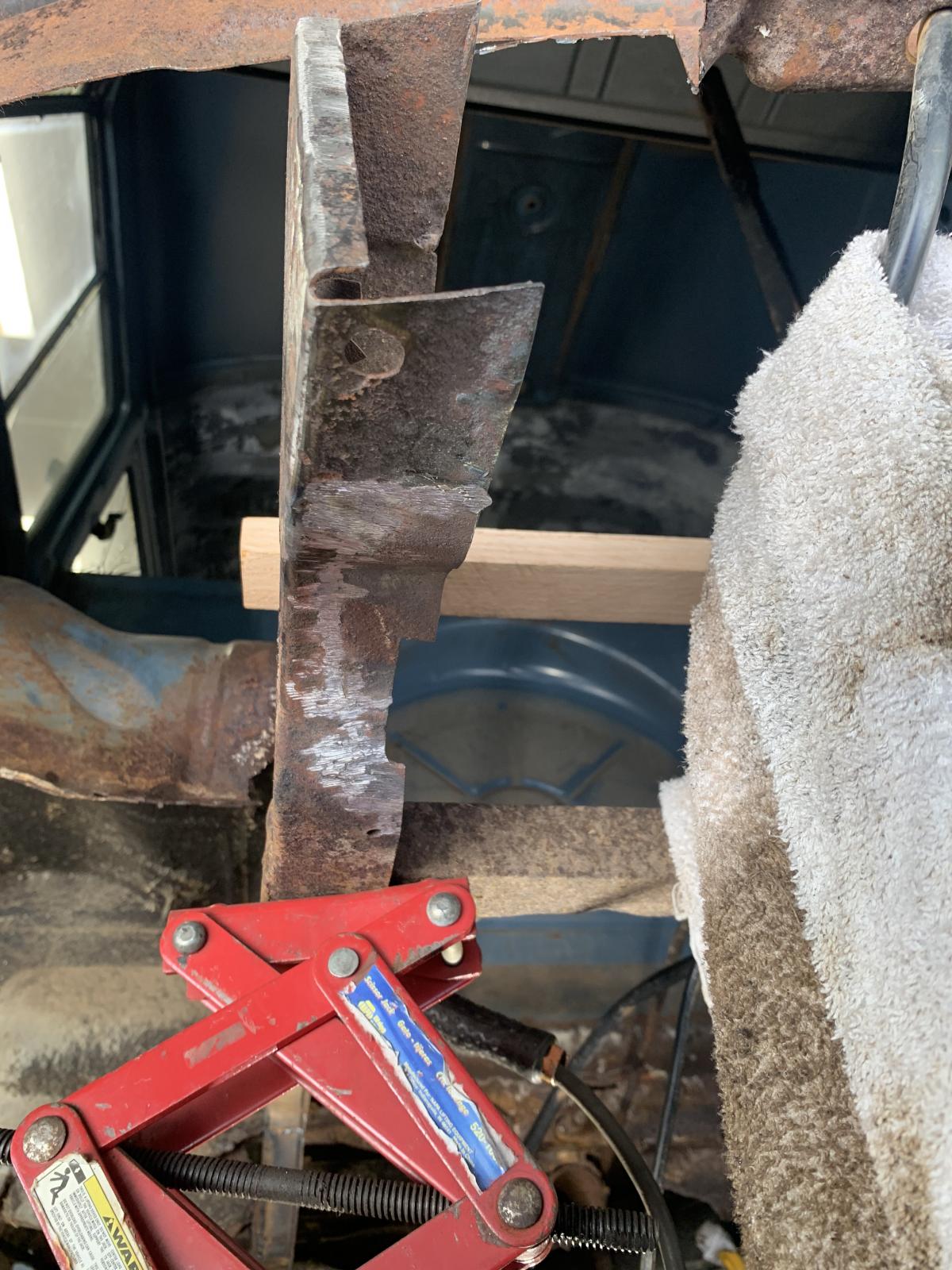

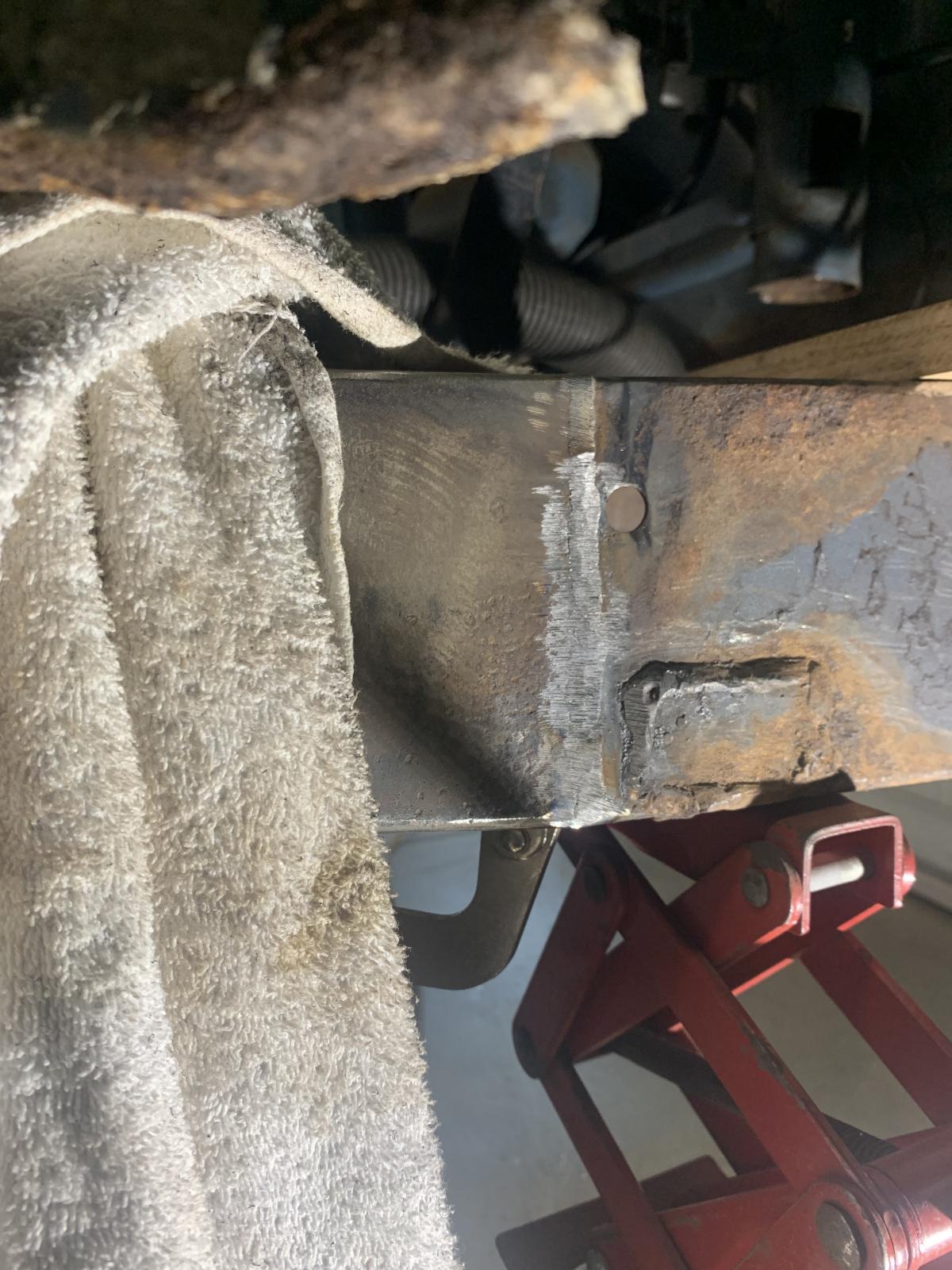

Thank you Bobby! It’s a tricky area to tackle but comin along. Lots of measuring, and I mean lots Laughing and then cutting and fitting. It’s a tedious process but I get in a zone and keep it movin!! Thanks again for the positive comments. Here are some pics of the day comin up! Wink Popcorn

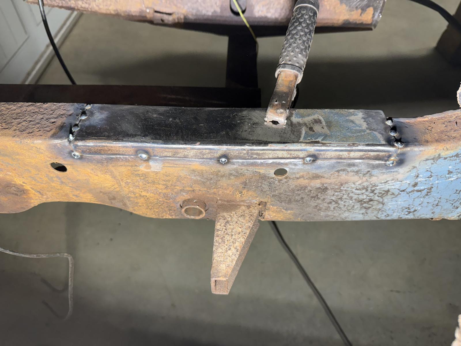

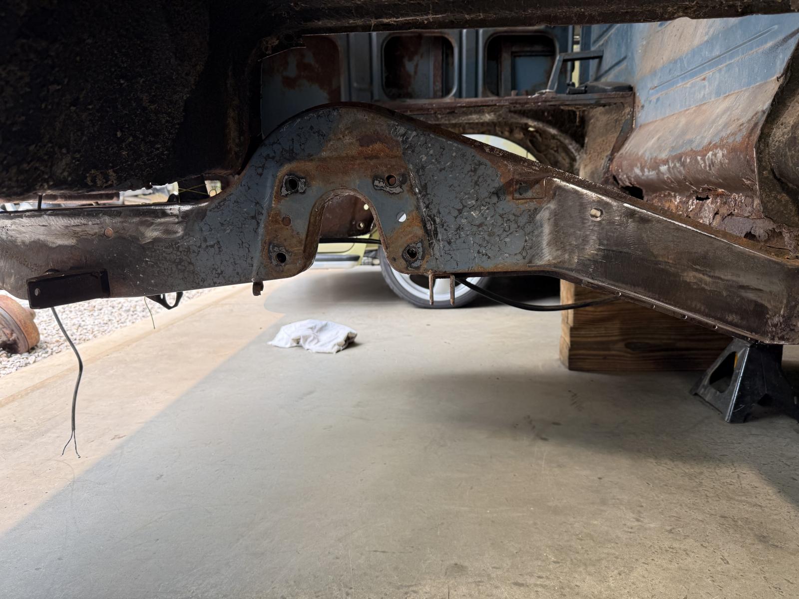

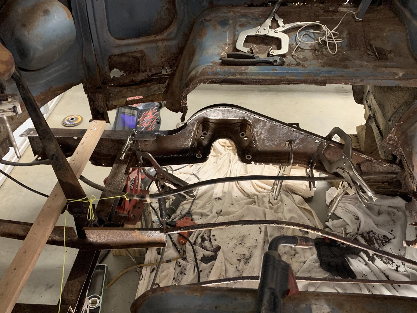

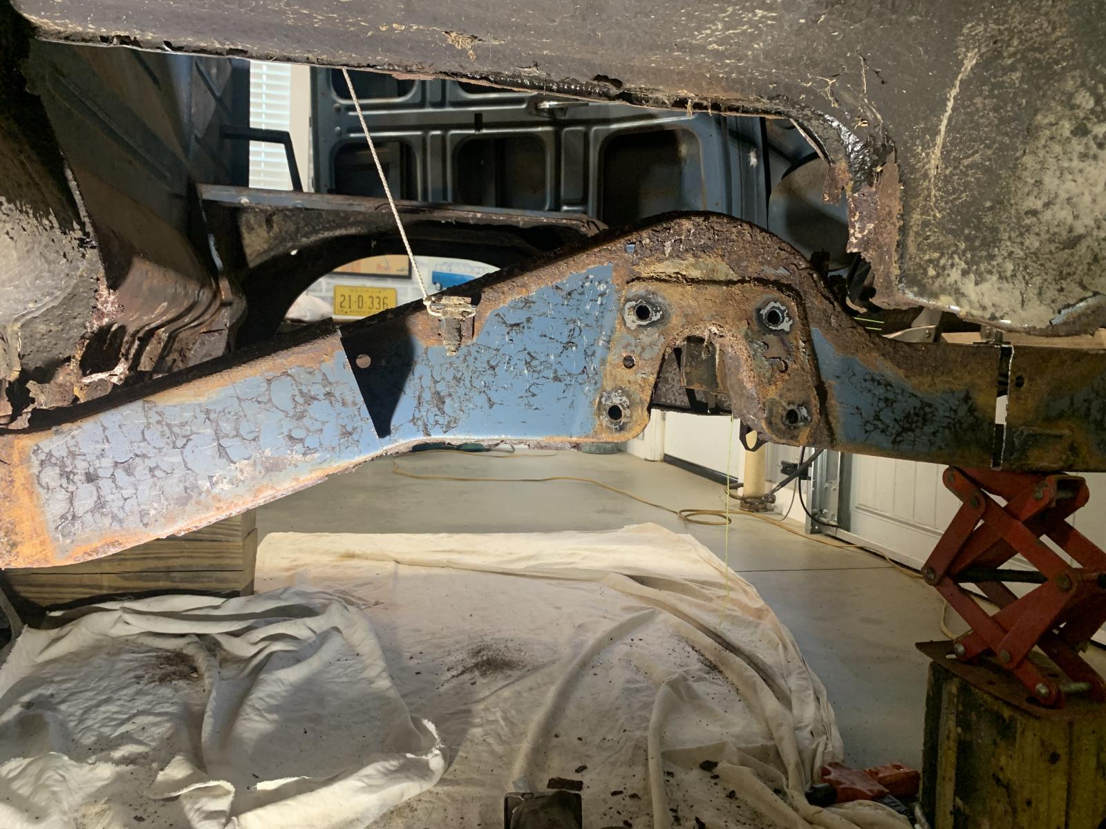

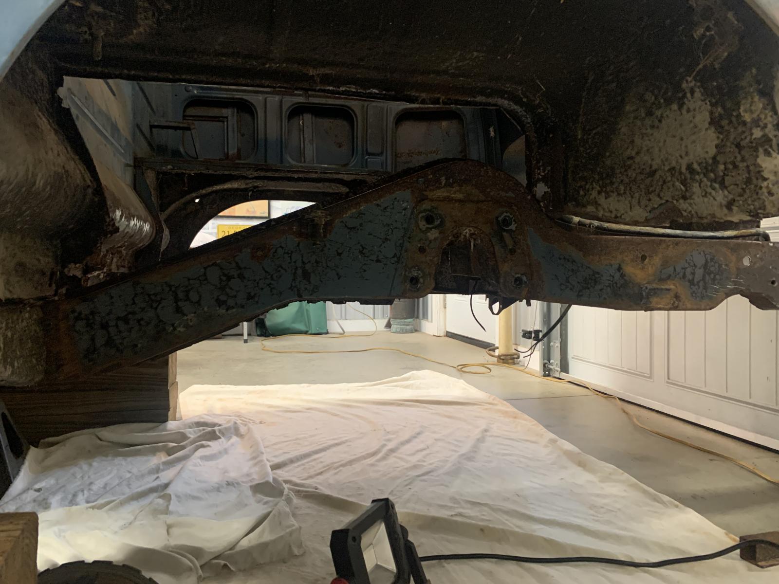

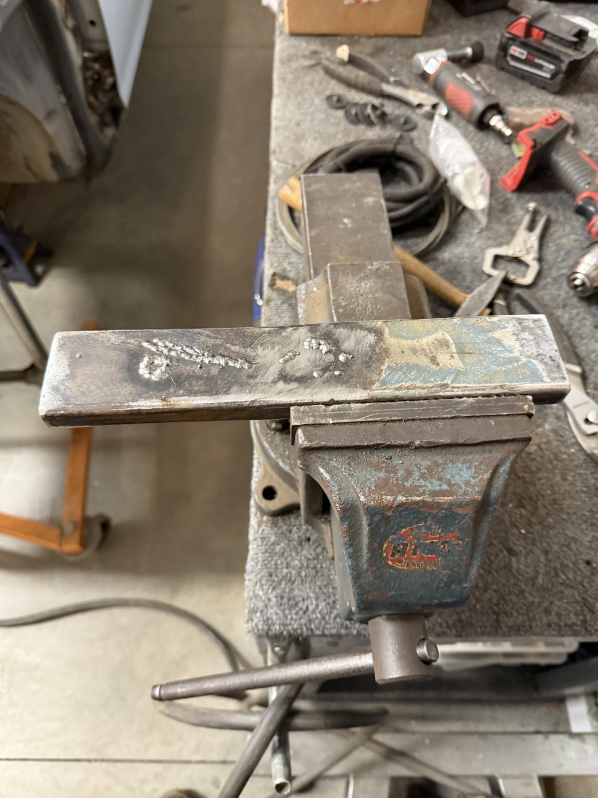

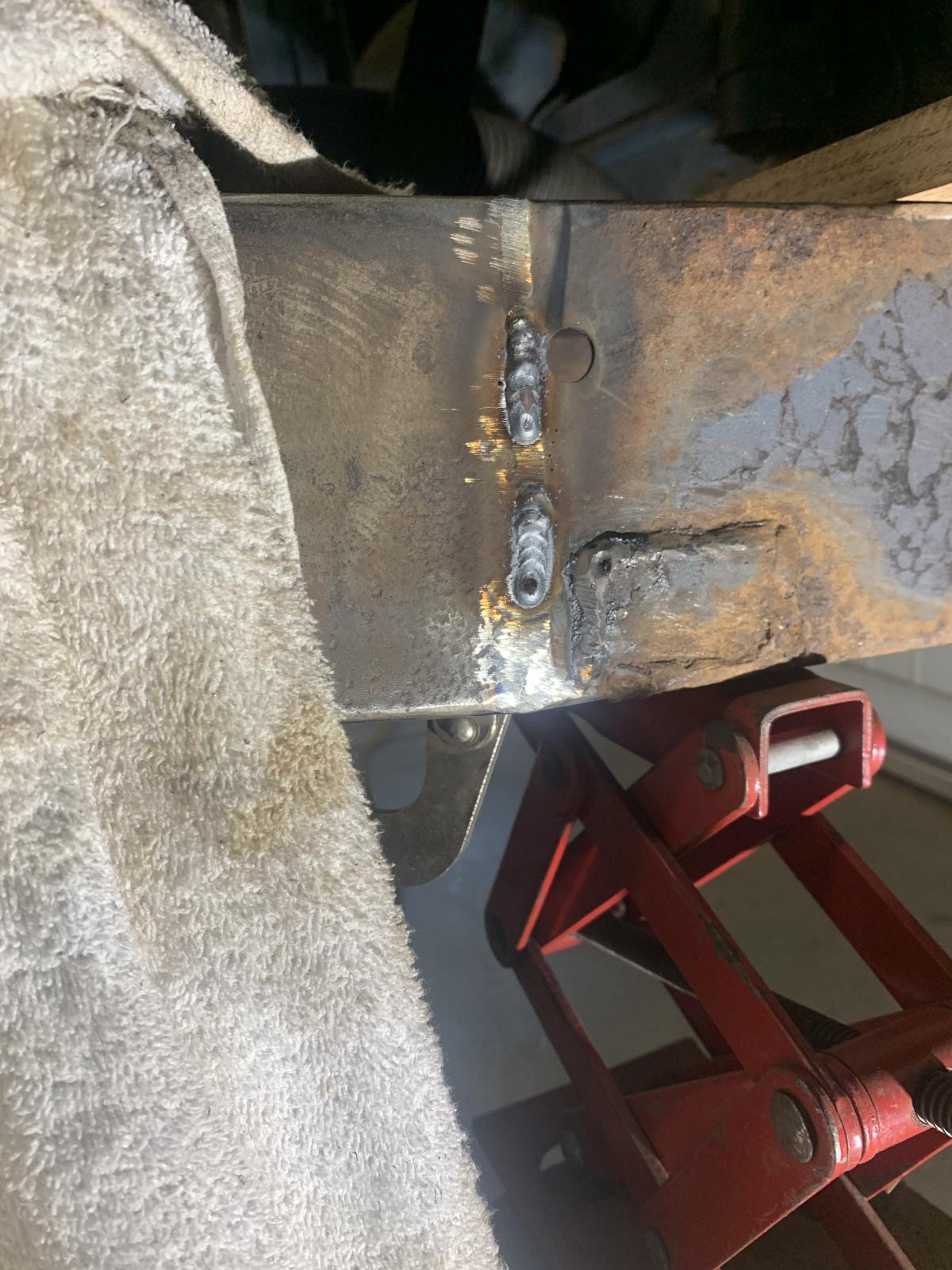

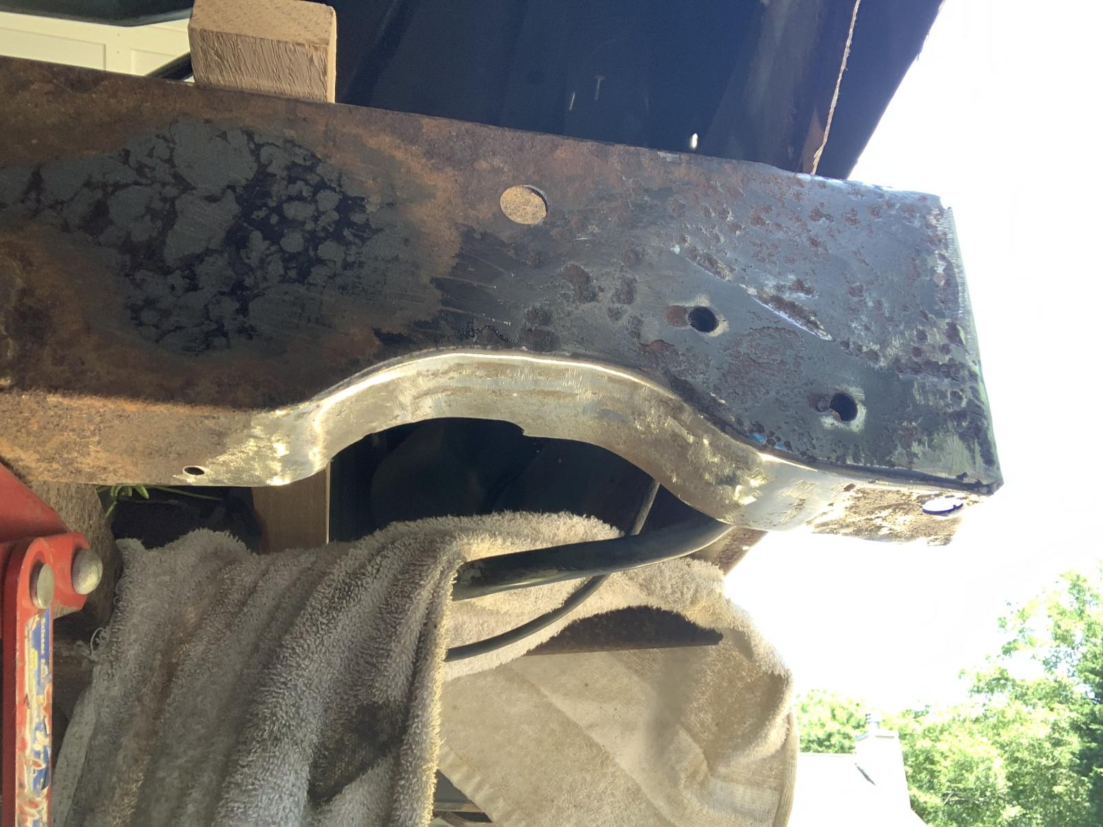

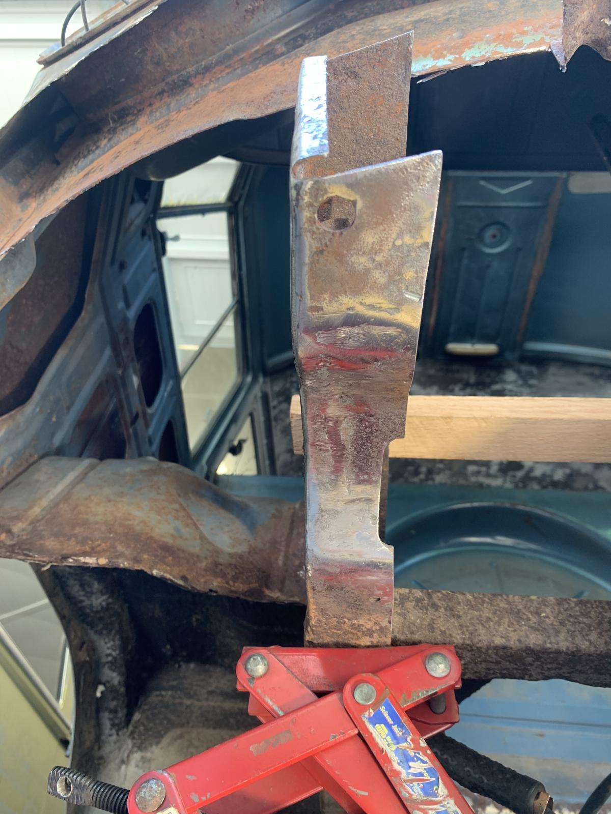

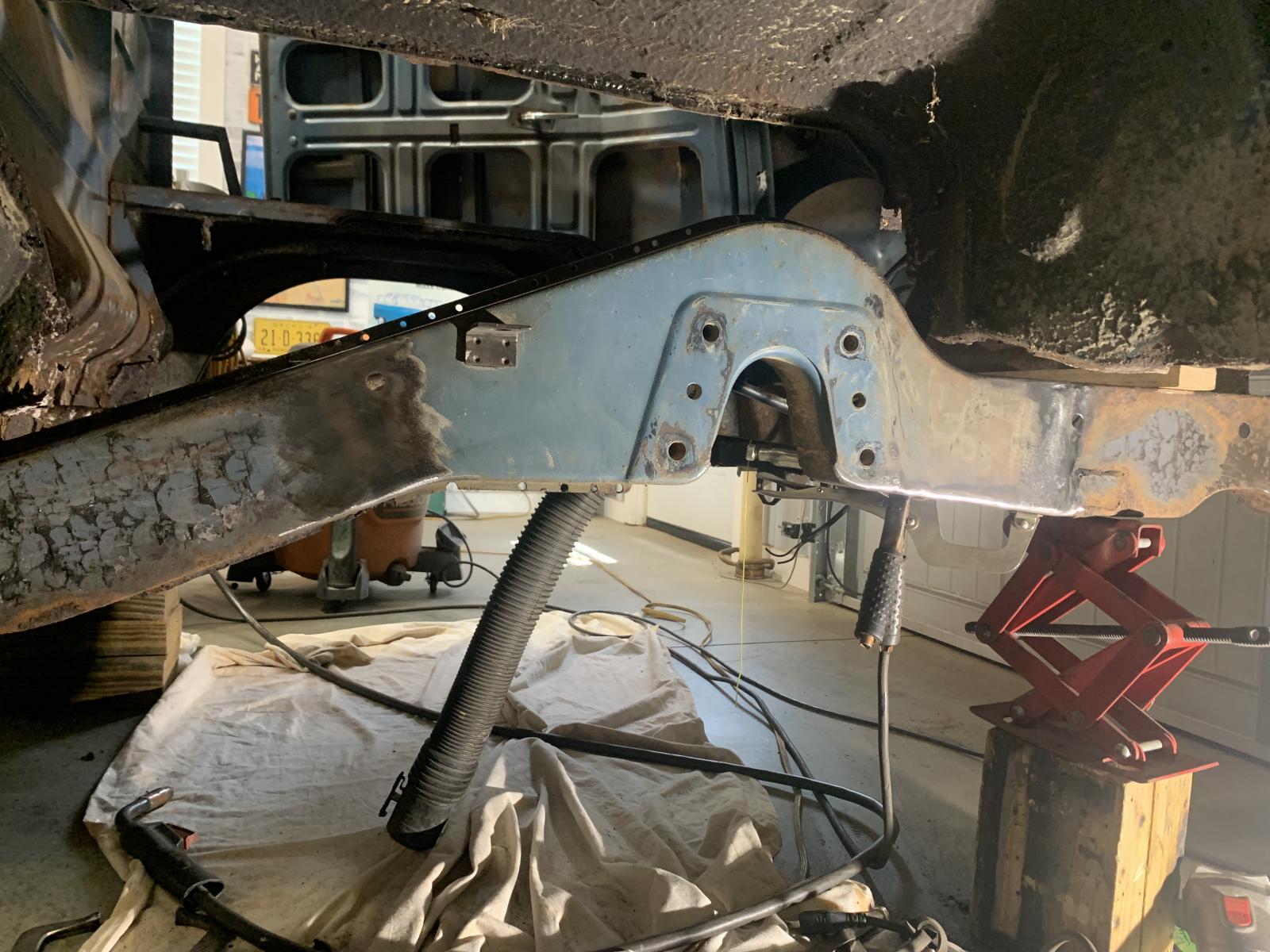

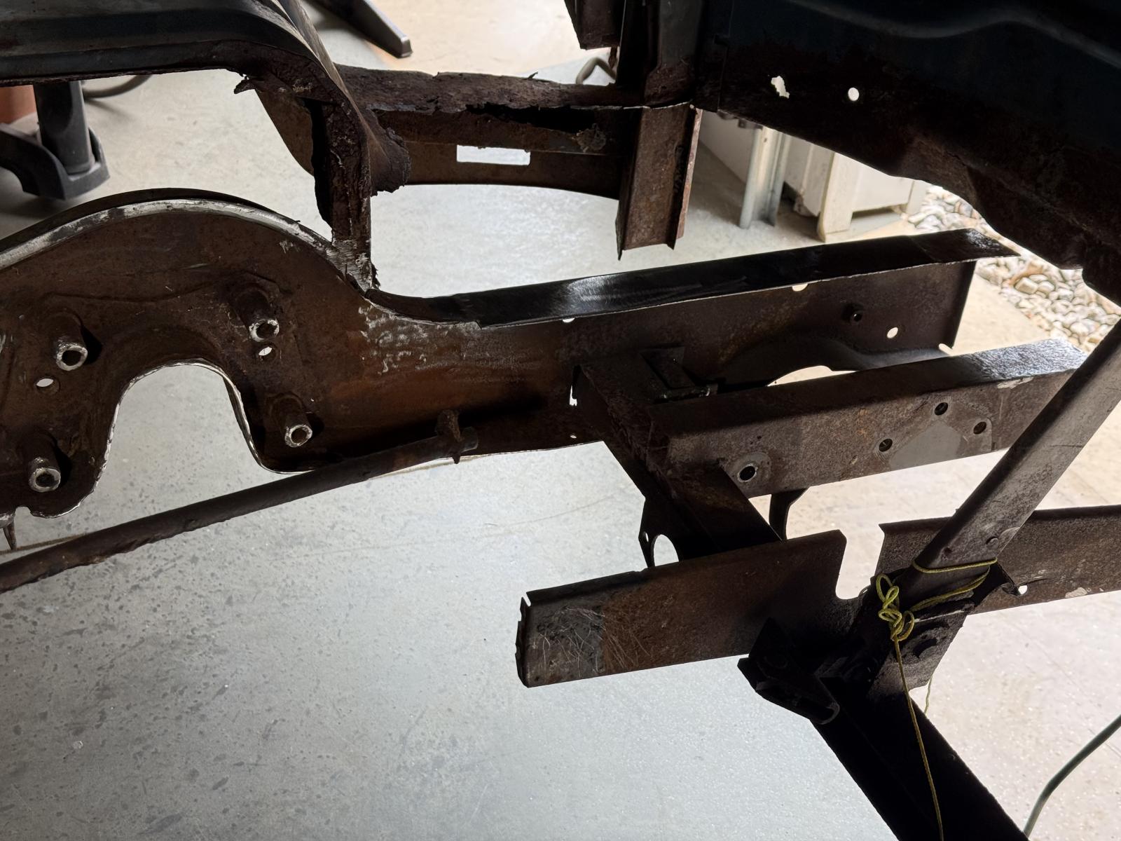

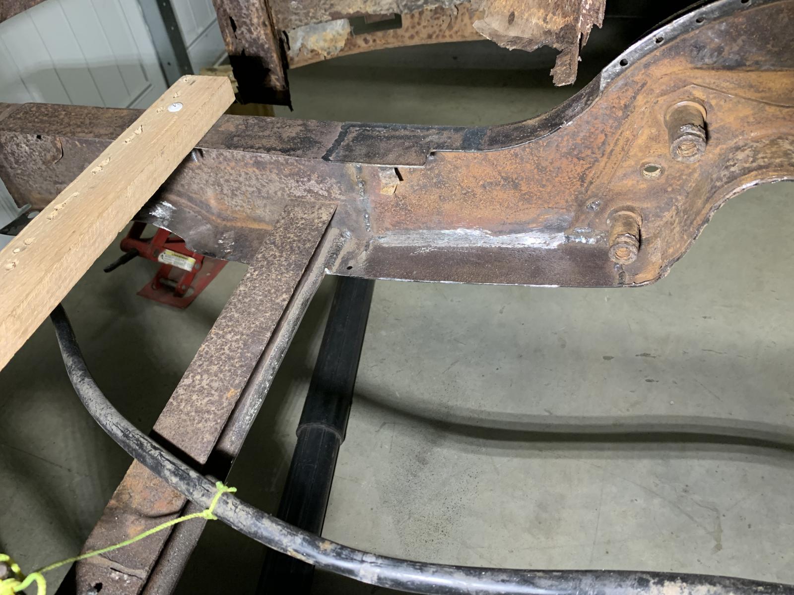

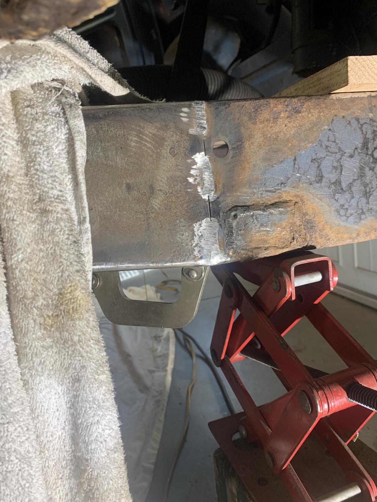

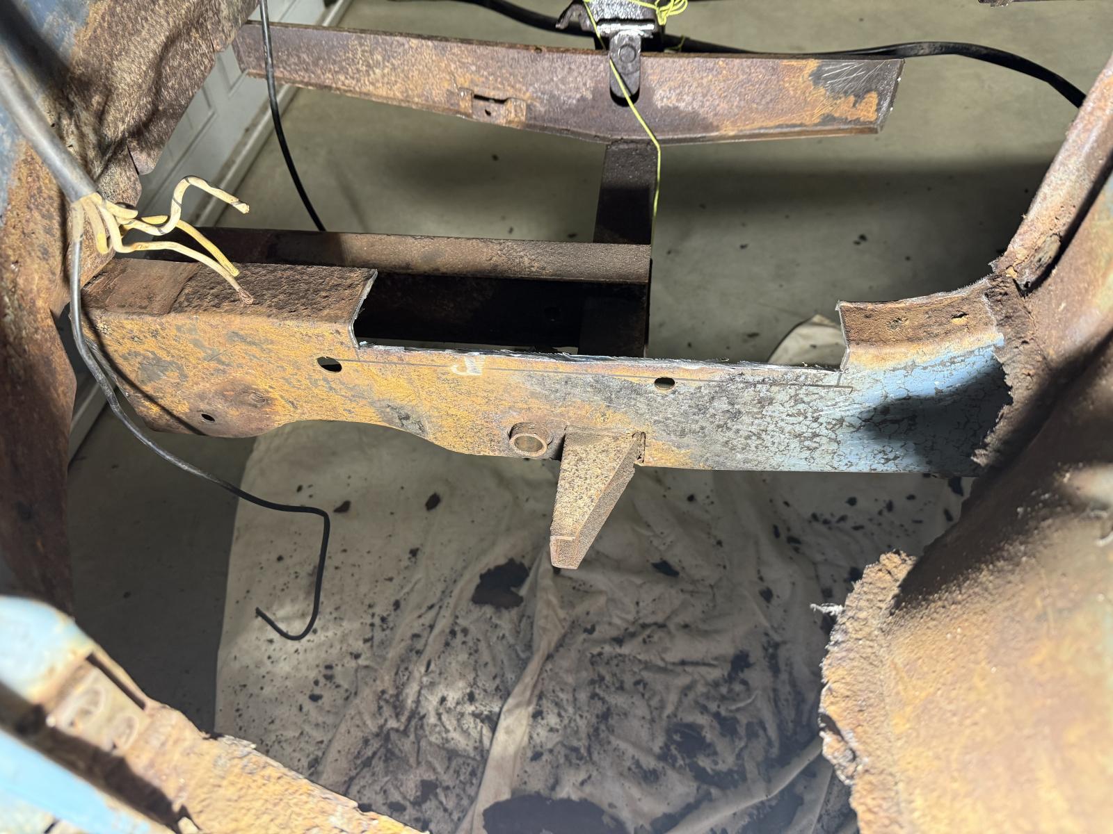

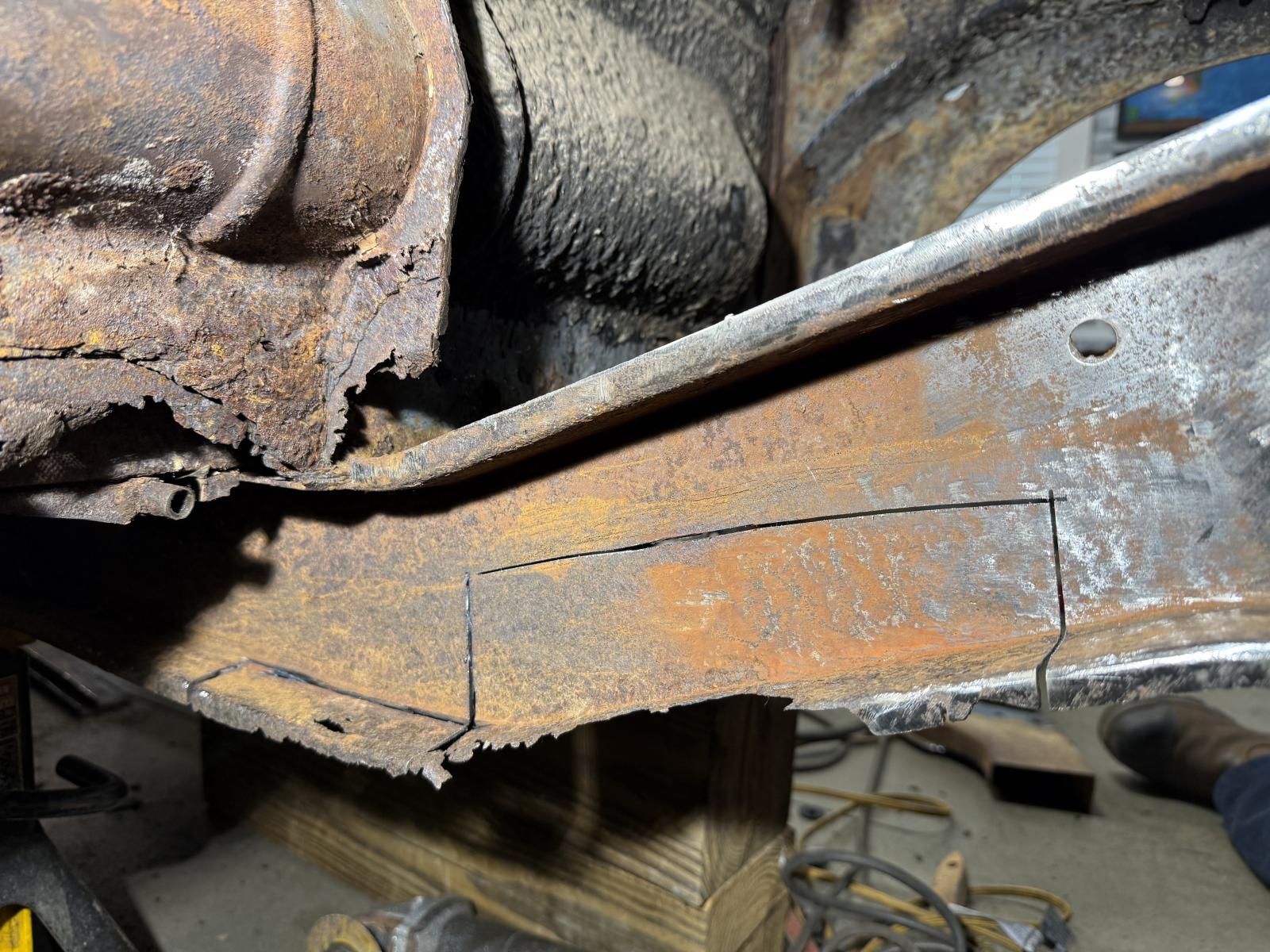

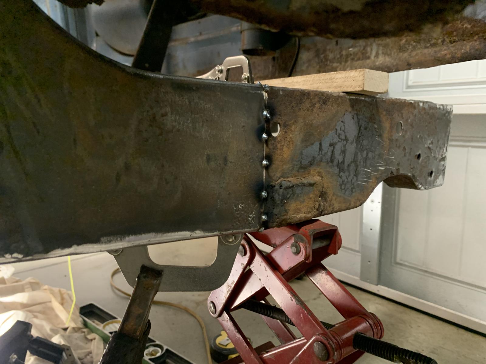

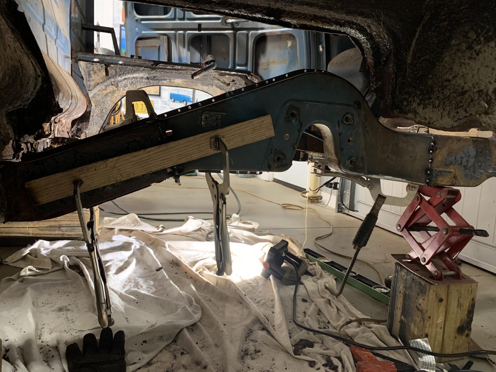

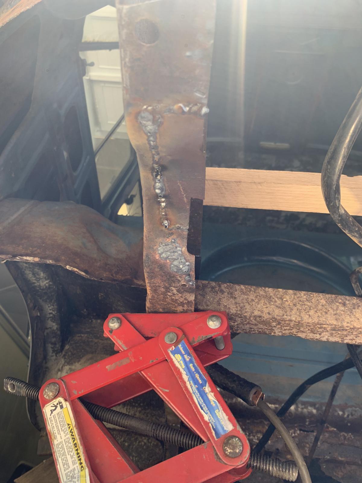

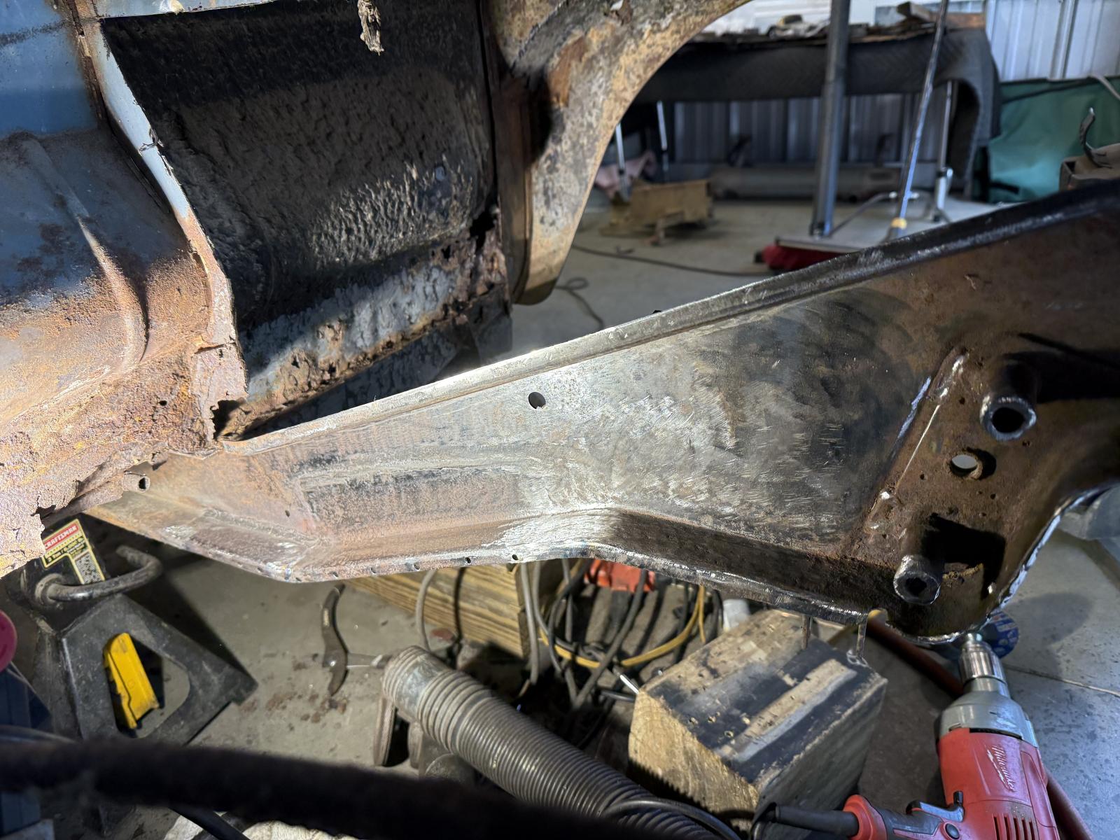

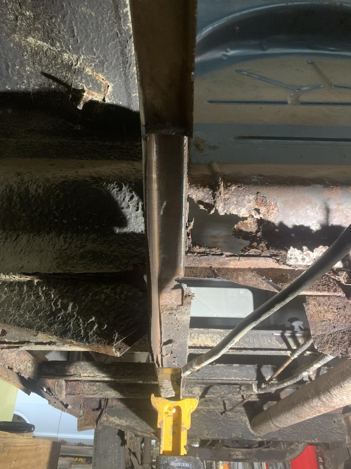

Was able to get some time in the shop today and tackle that passenger side frame. Measured 52 times and cut once!! Shocked Laughing Tedious and time consuming but I am on my time so it’s comin together nicely and correct!!
Should have the passenger side frame buttoned up tomorrow and then the drivers side which is just a couple small sections. After I will be taking care of the lower A-Pillars and Lower Front End Support to square up and stiffen that front end. Can’t wait to have that front end done so it can look like a Bus again!

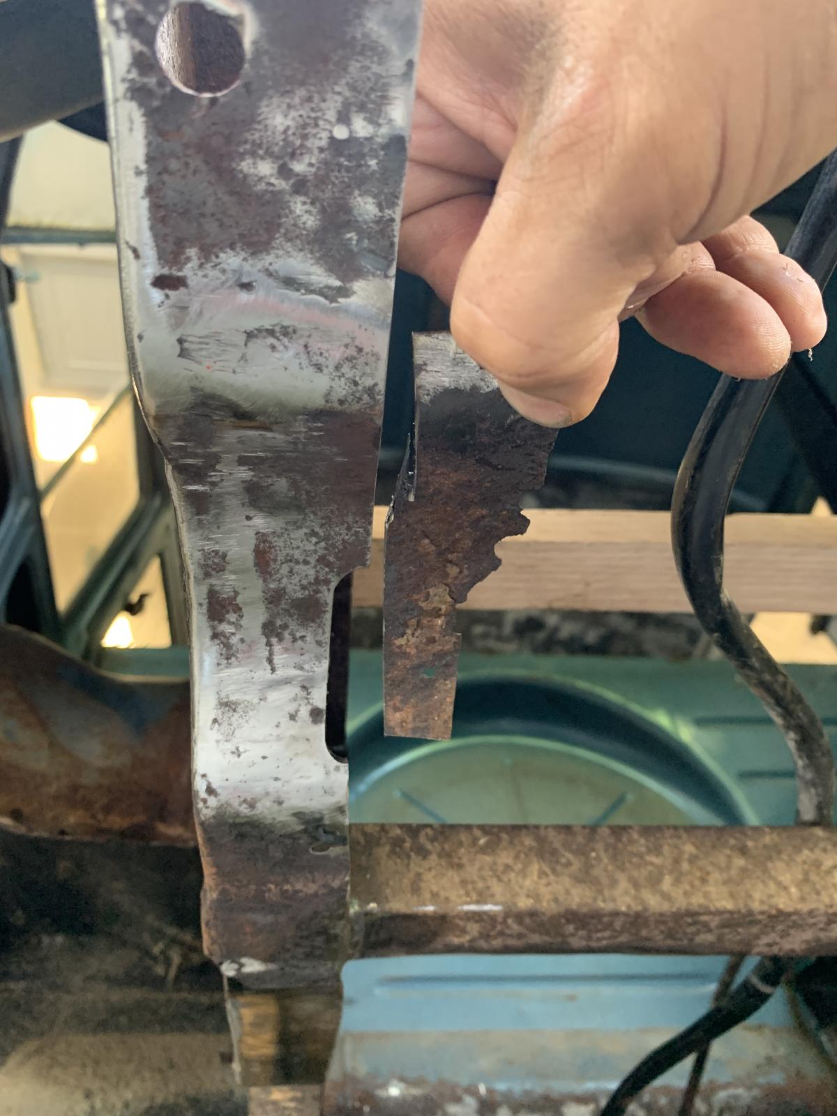

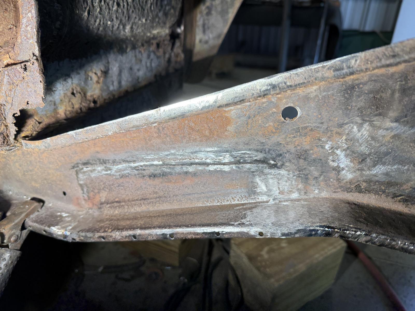

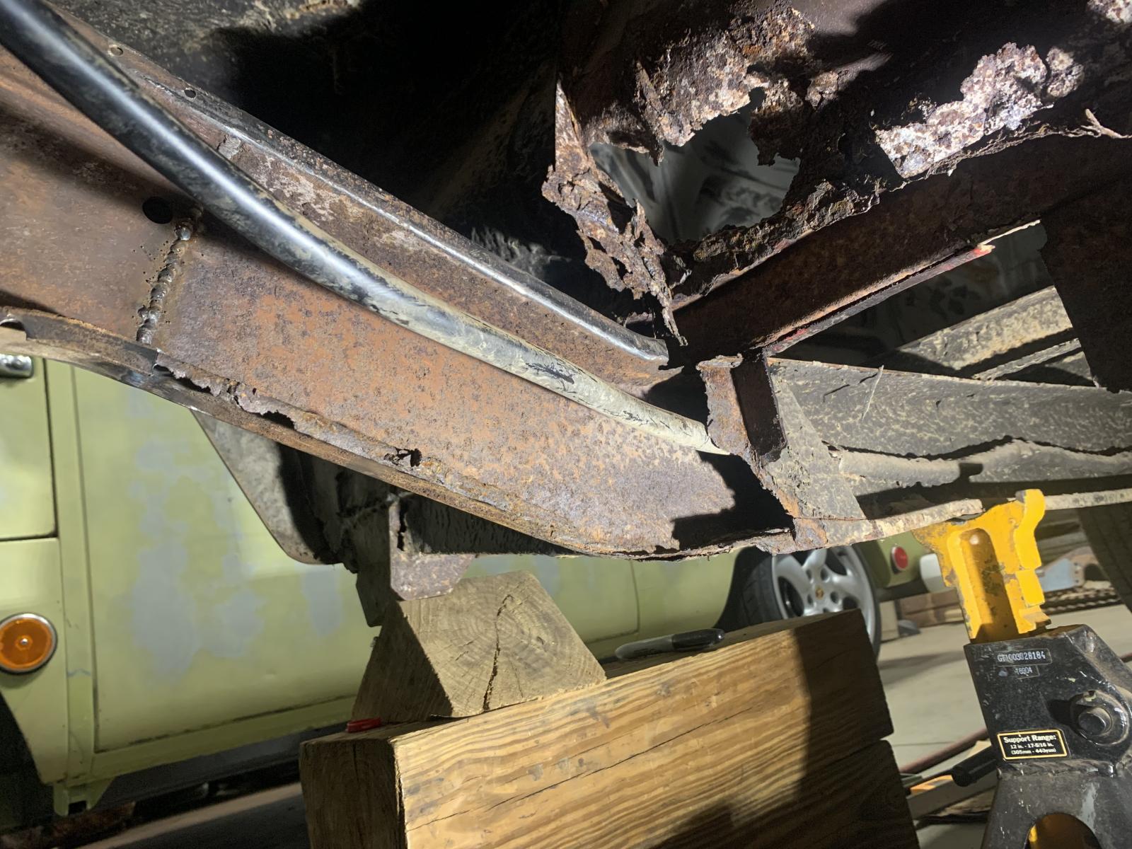

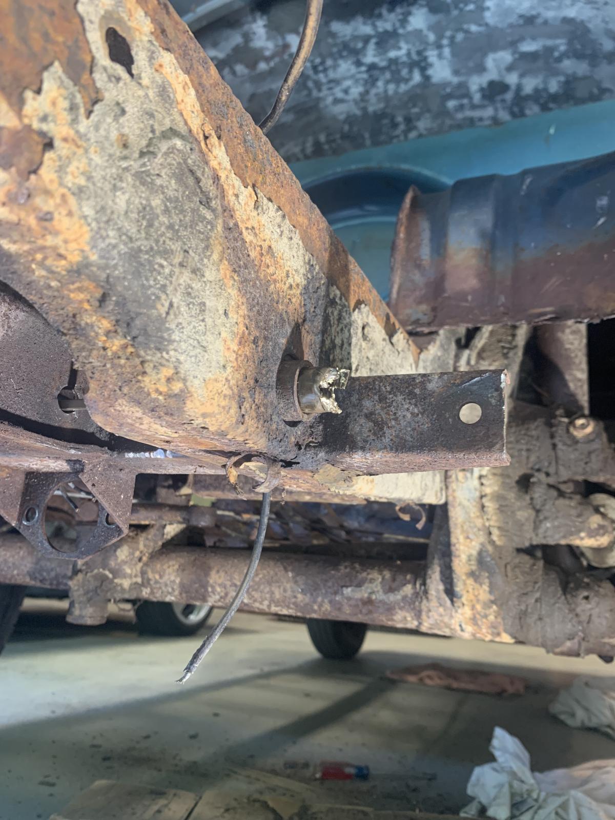

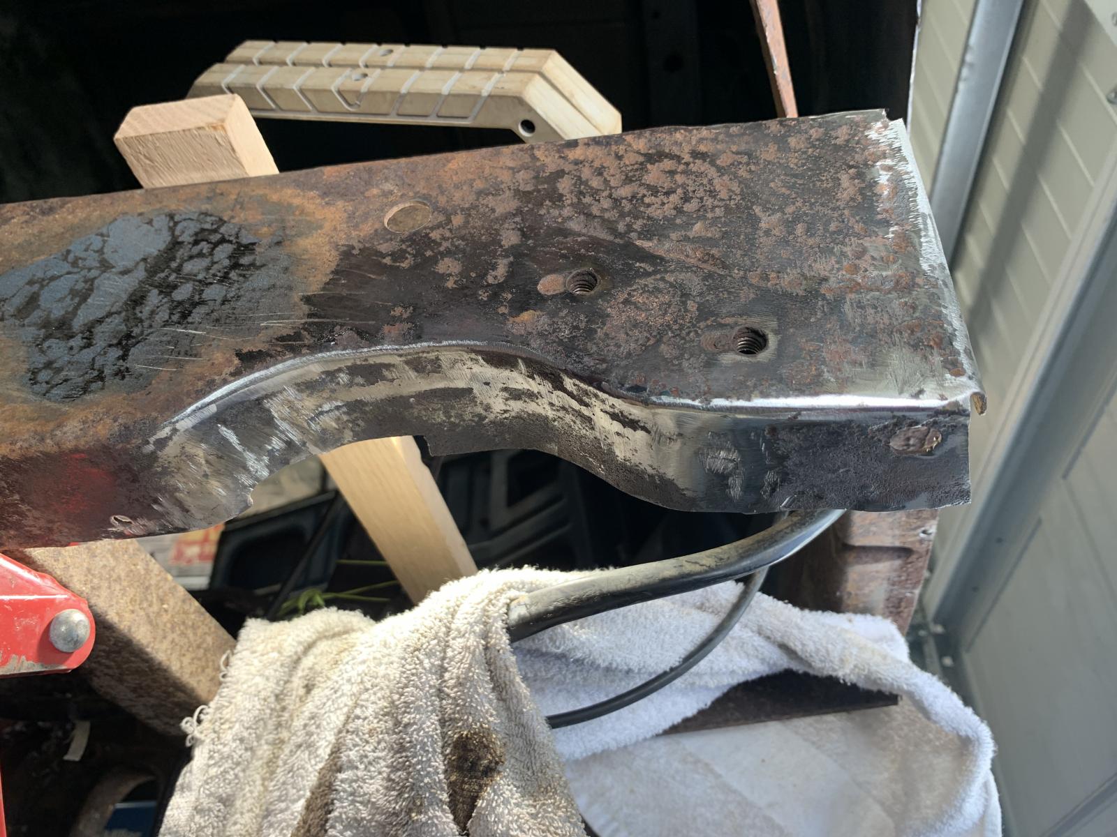

Hello Alan, yes sir this one definitely has rust like I’ve never seen before. But I’m not gonna give up on Blue, I will chip away at it little by little till we get there. Getting closer to finishing up the frame repairs and then can start on building that area back up. I am really looking forward to that!! Cool Thumbs Up
More pics comin up!! Wink

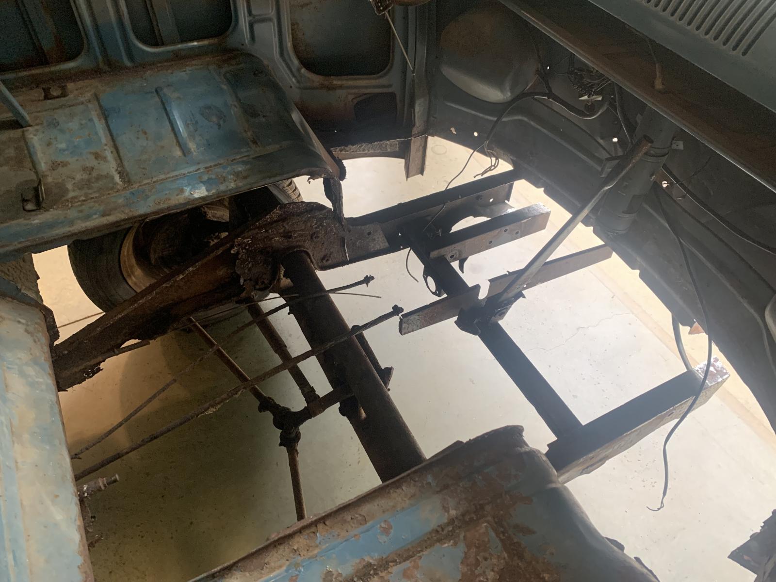

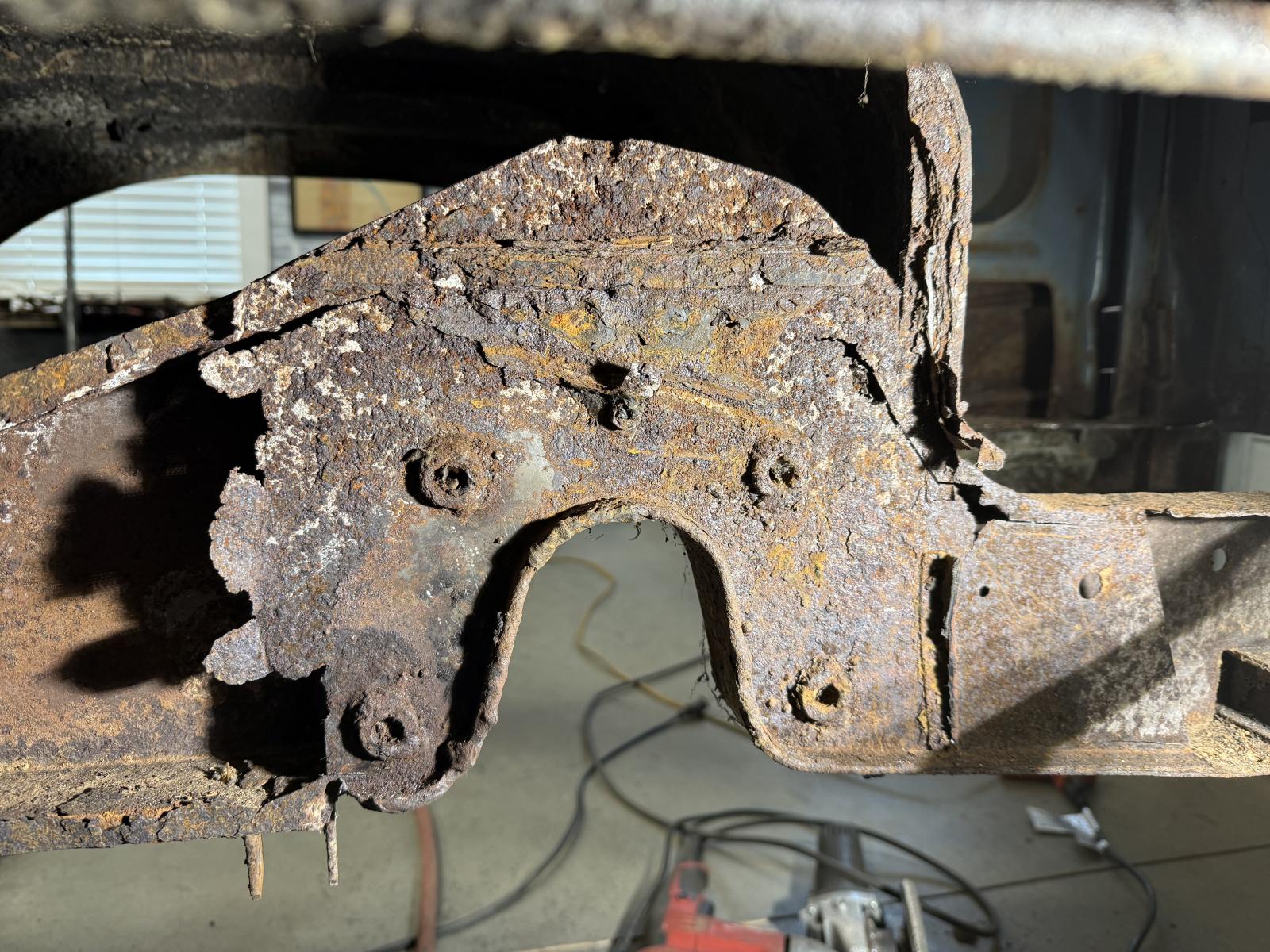

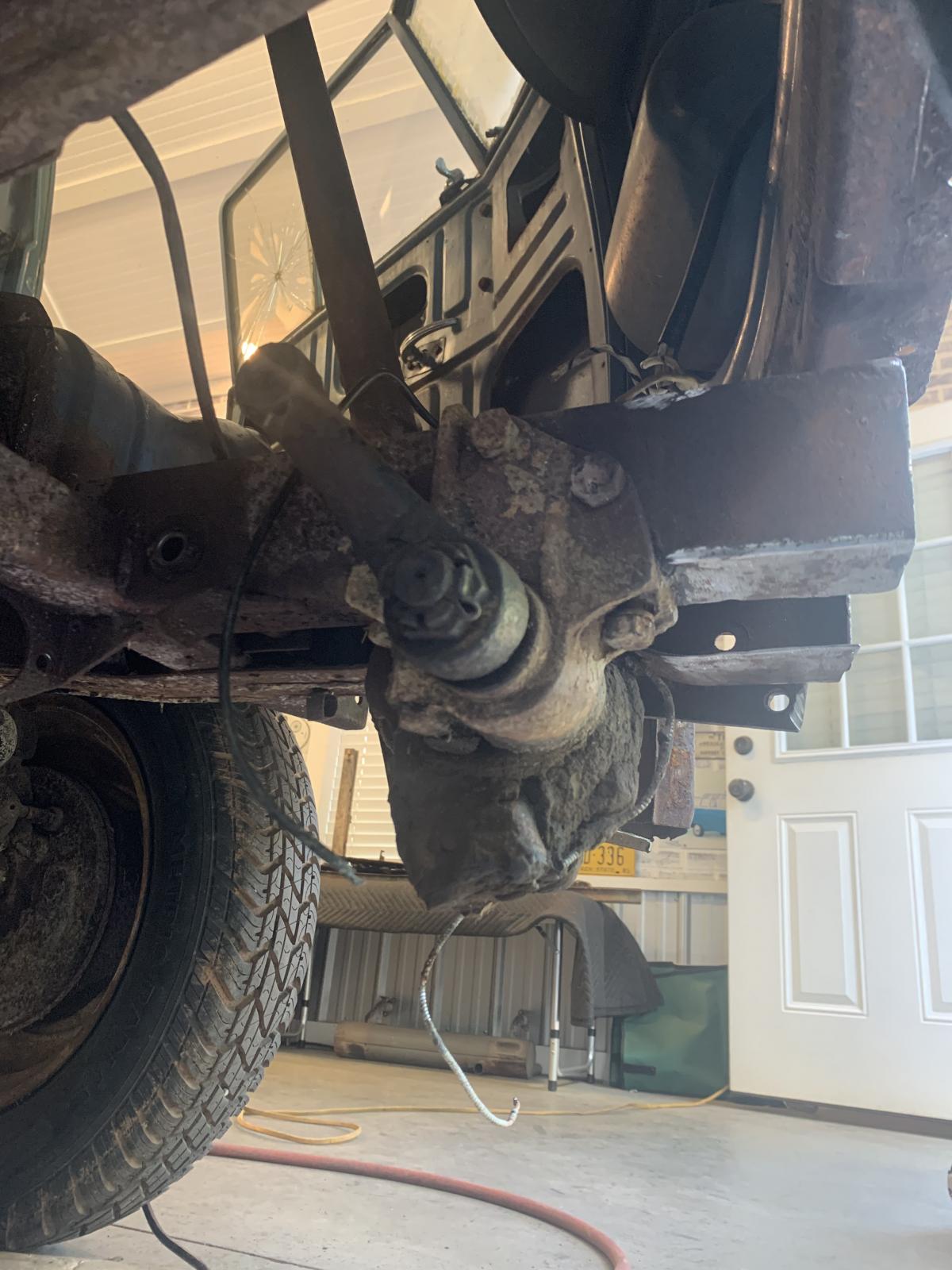

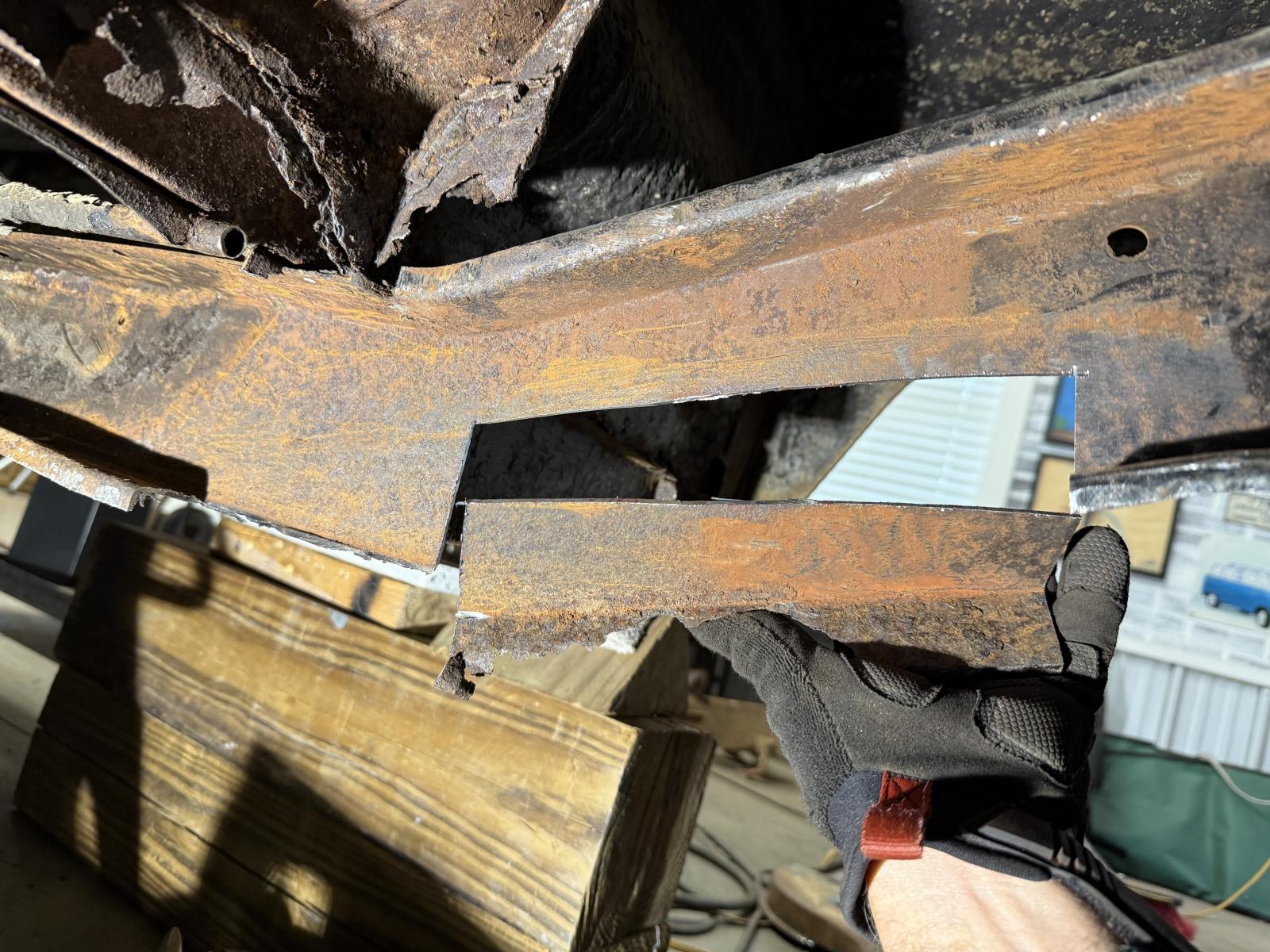

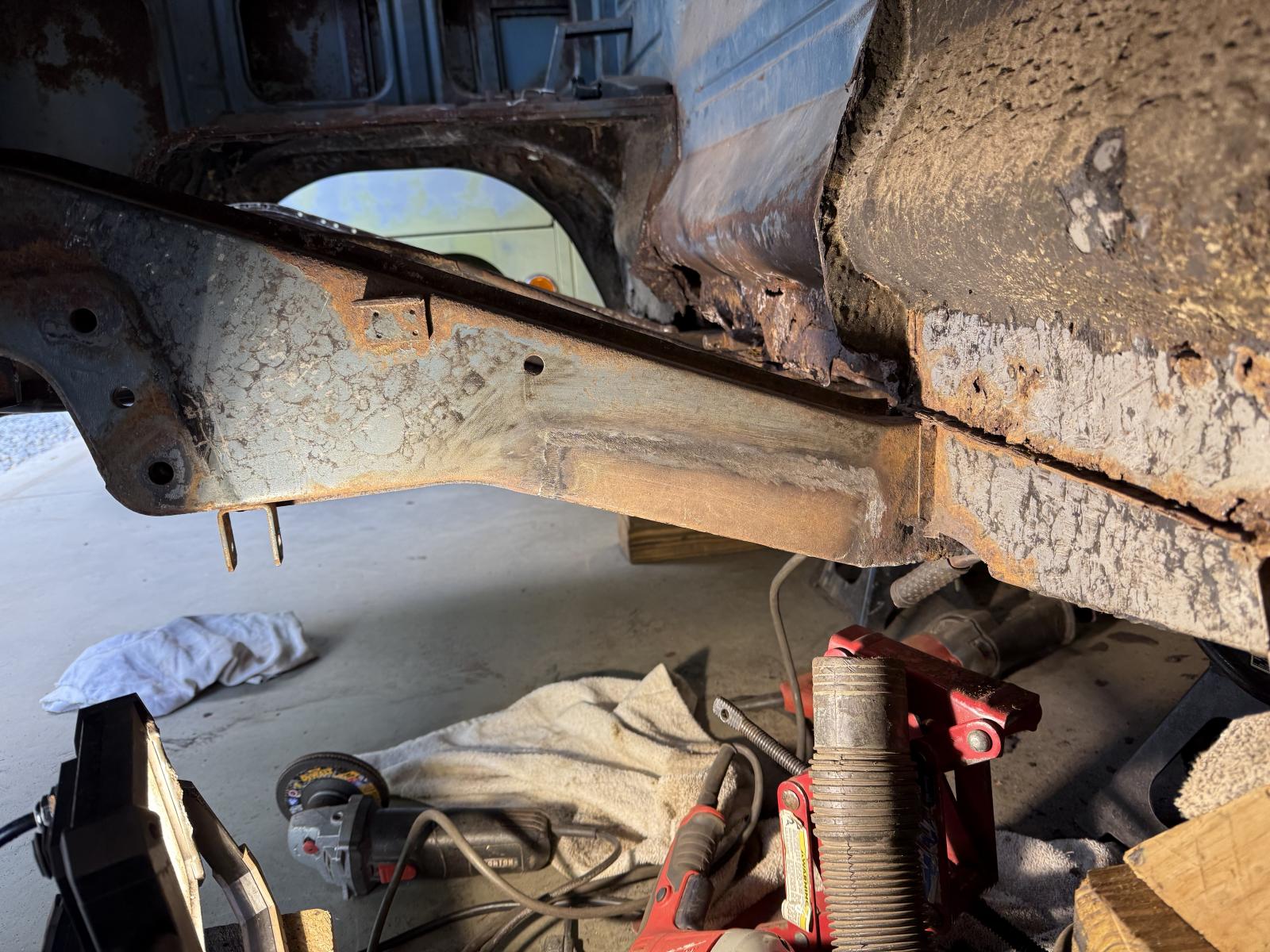

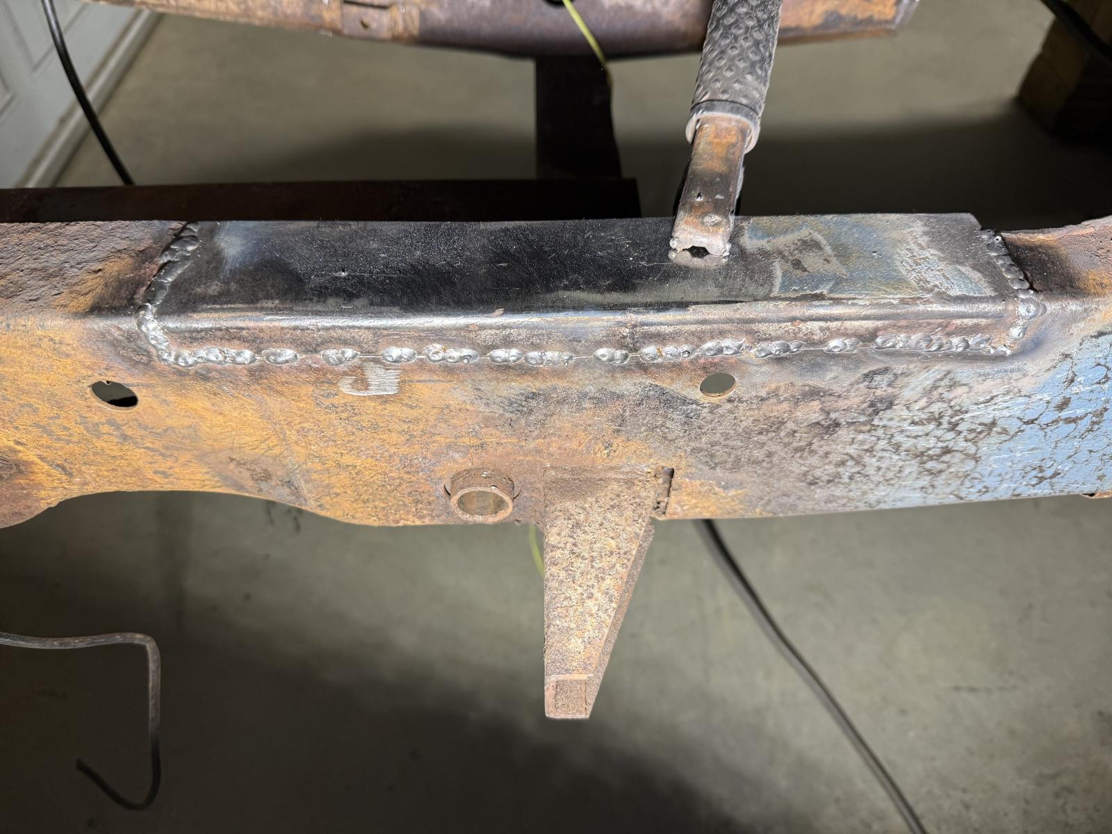

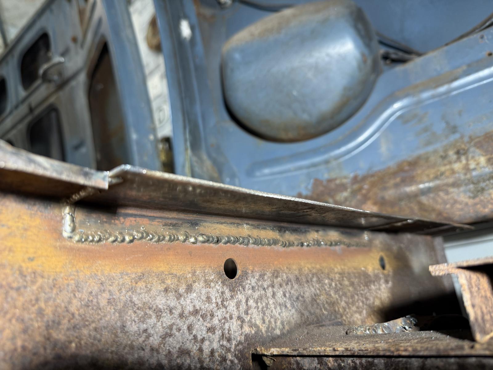

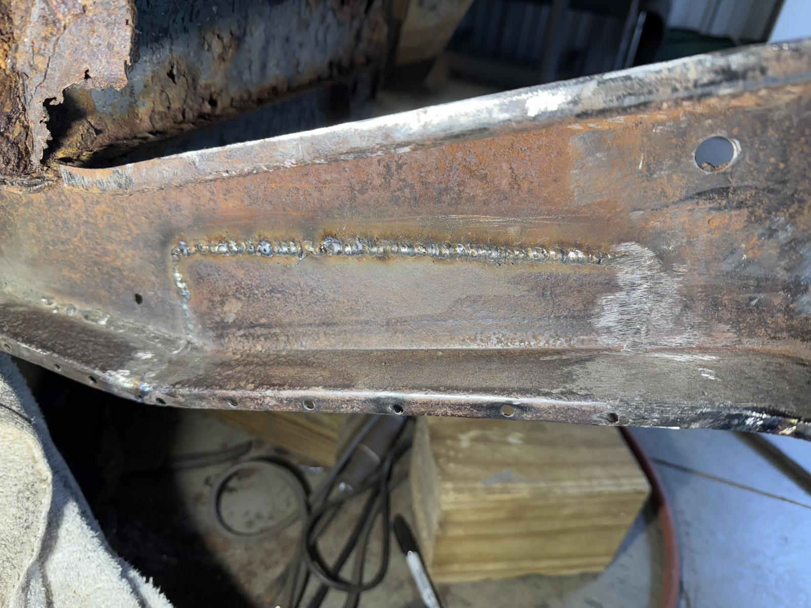

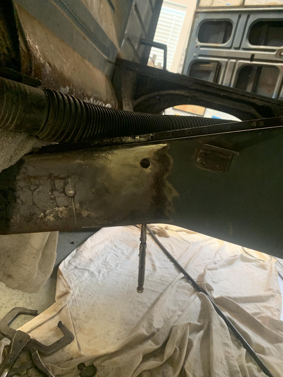

Passenger side comin together nicely!! Taking my time to make sure measurements and fitment is on point so everything lines up and goes back together easily! Should be starting on drivers side soon and should be easier repairs as that side is pretty solid. Can’t wait to start building this area back up, more pics and videos comin soon!! Cool Wink

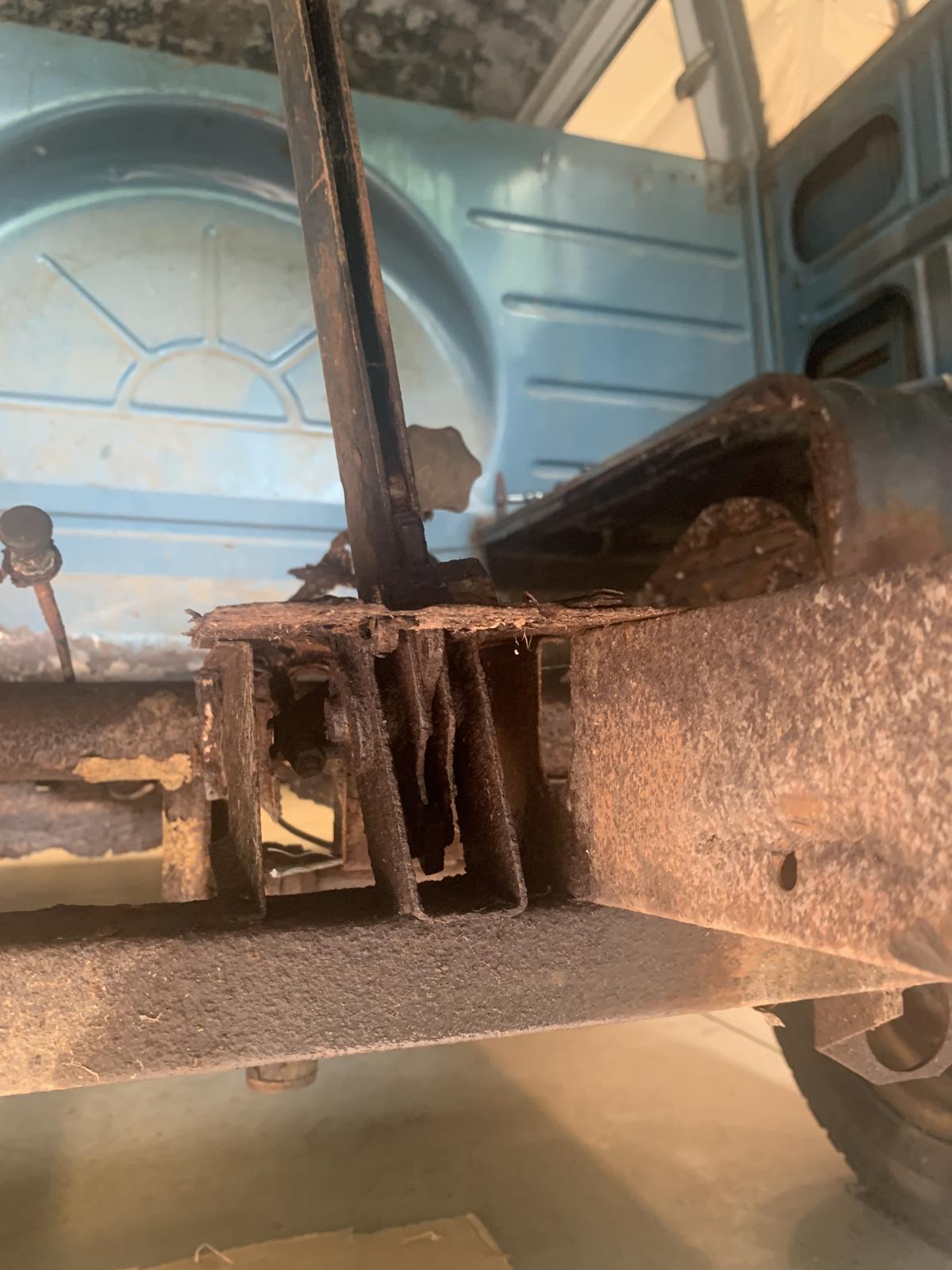

As the owner of a restored bus which had much of the lower six inches replaced, I'd offer some advice:
Make sure you have two straight front doors with untweaked hinges, and none of the dreaded cracked inner cross members.
On my bus, since the A pillars, B pillars, and doglegs were so out of whack, and both door hinges were tweaked, There was no good way to line everything up properly. It was aligned by hope and eyeball, and the door gaps ended up pretty awful.

J.Pickens - Thank you Bud and definitely on the doors!! Gonna purchase a solid OG door to get those gaps and lines right is a must! This preservation will be time consuming but should pay off at the end! Wink
Zuggbug- What’s up Paul!! Yes Brother another preservation that I’m trying to save!! Putting in a few hours here and there while still trying to enjoy family and retirement!! Been doing lots of vacationing so progress has slown, as you know family time is comes first without a doubt!! Wink Thanks for touching base Bud!! Cool Thumbs Up

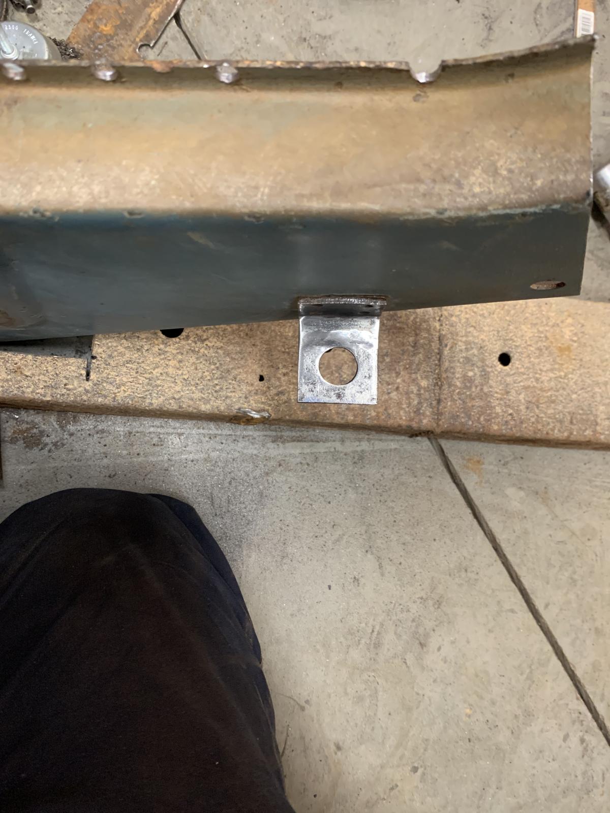

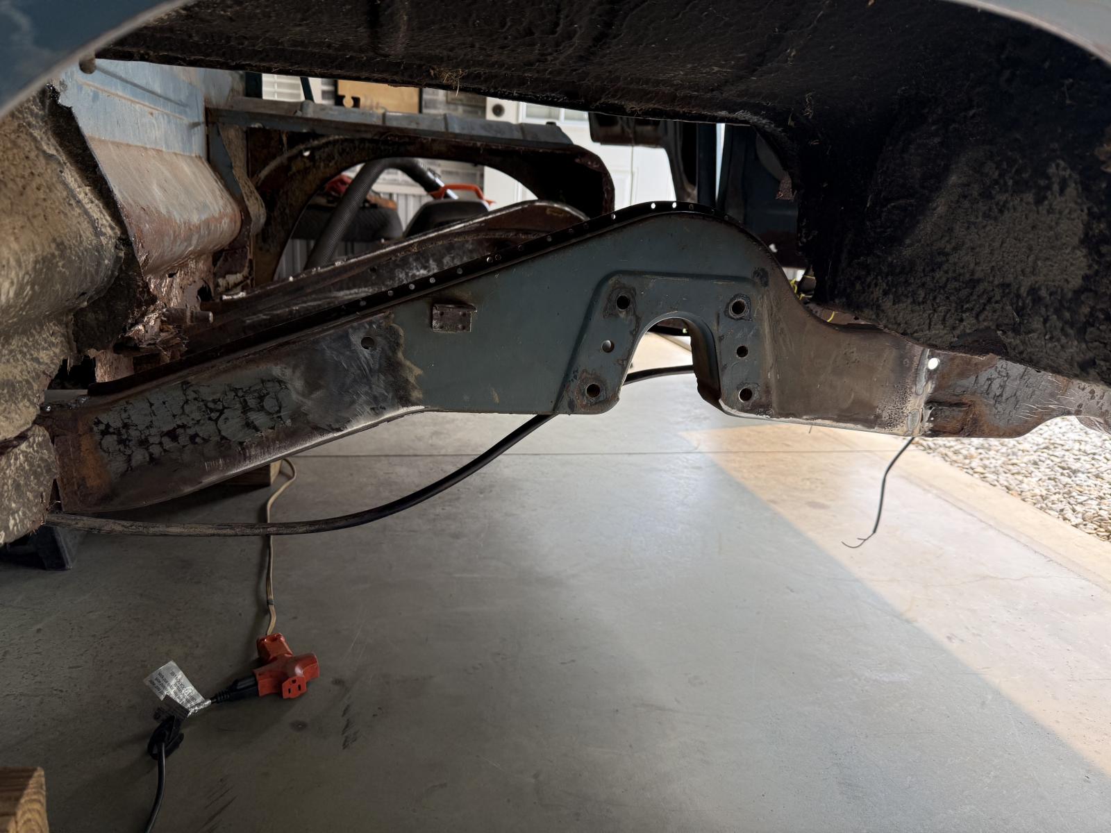

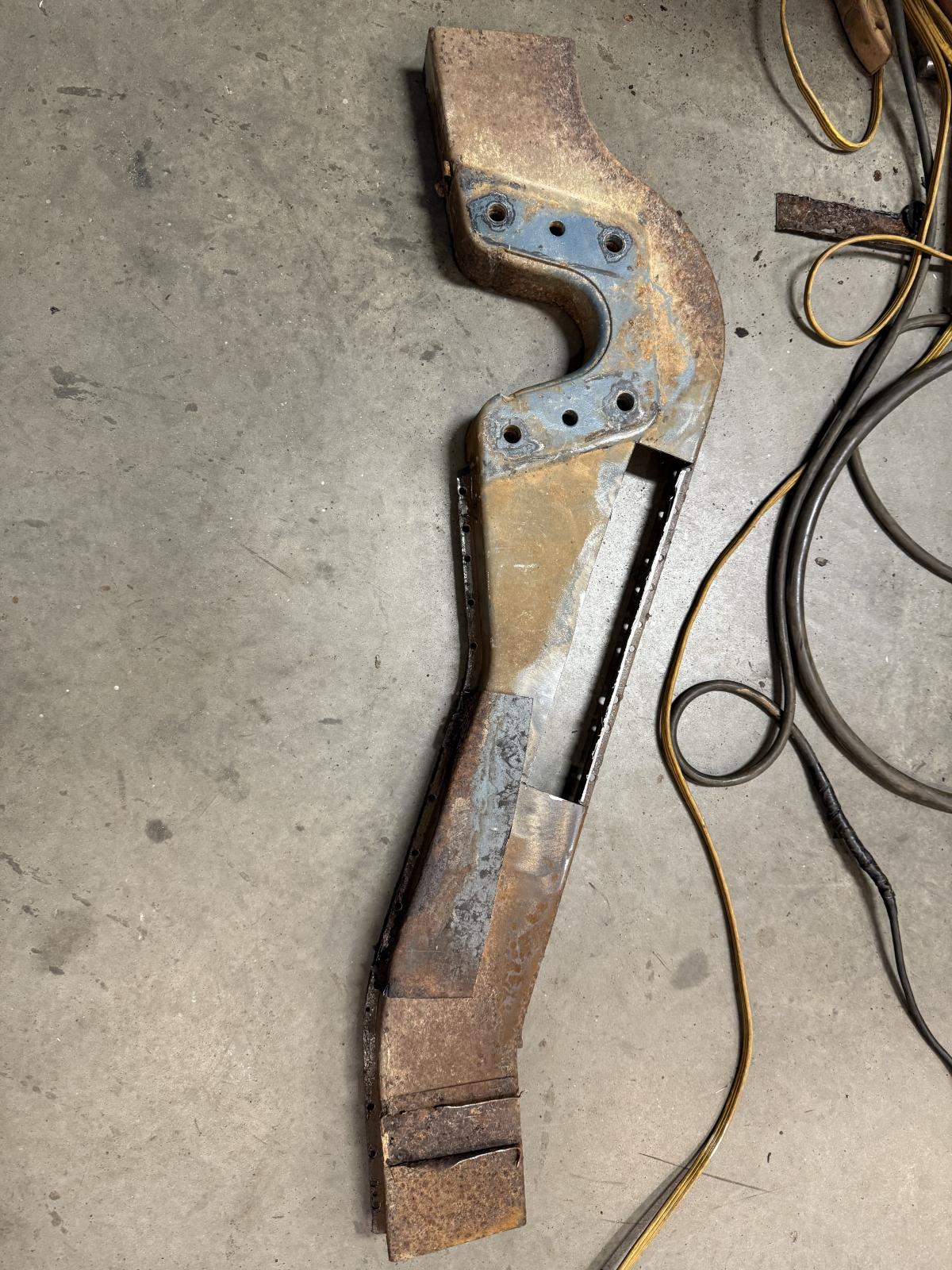

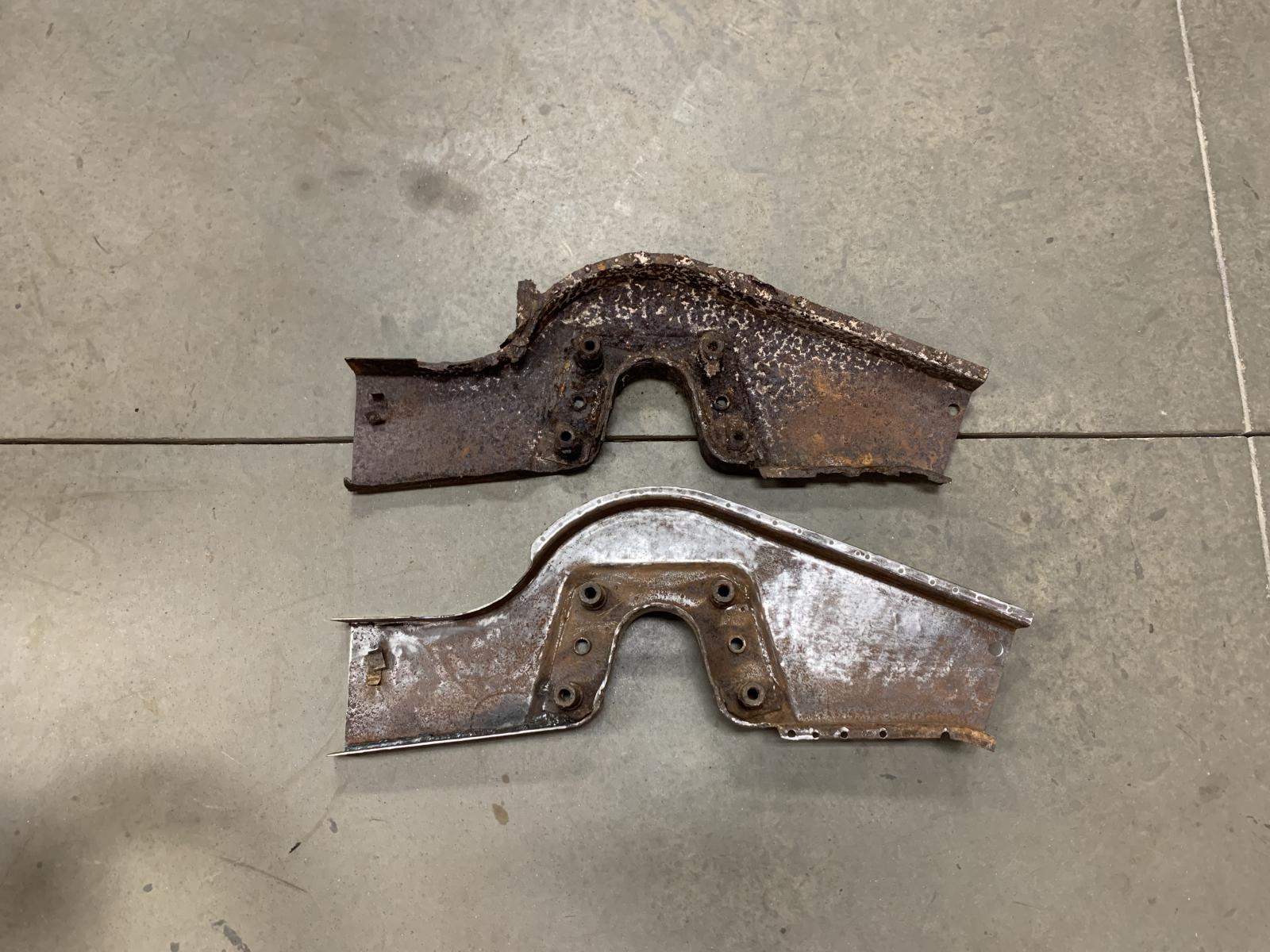

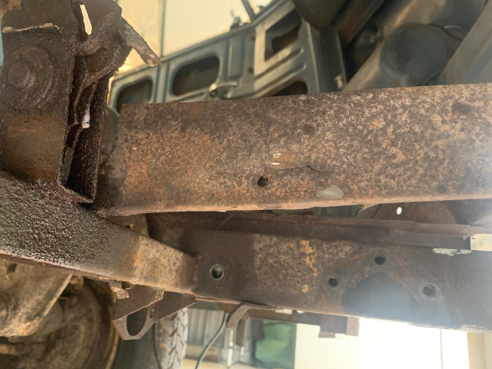

Thought I would post an update on Blue’s progress. Here are some before and afters and a video. More to come soon, as we just got back from enjoying family vacation time!! Cool
