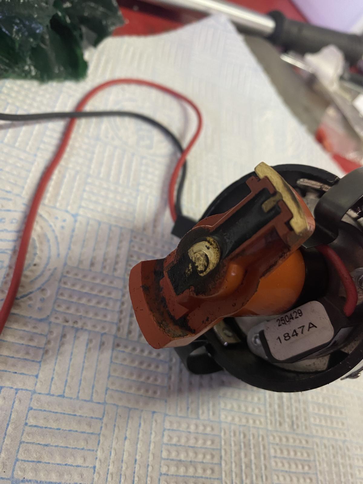

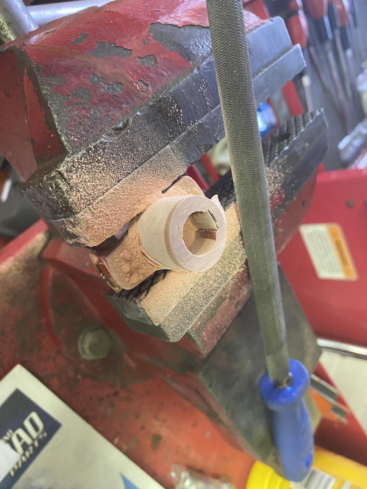

A small update on the car. I have been able to drive it for a couple of weeks now as my knee heals and we have had the sunniest summer in years here in the UK, so I was keen to get some more miles on it and iron out some teething issues. On a local drive though it started misfiring, ran rough, backfired a couple of times and then cut out. A visual check revealed nothing and I had no spare parts with me, so had to call recovery. I lucked out as the truck was with me within an hour, had a flatbed that came right down flat to the road for low cars and the driver was into old cars, so that all worked out well. It was also a chance to prove my hazard light system worked! It did look lovely while I waited ...
Back at home I tested that it was getting fuel at the engine end and it was. I switched the coil out and that made no difference. It would start now it was cold, but ran rough and didn't accelerate smoothly. My spare 009 was useless: the condensor had failed and the new condensor I had bought had also failed immediately. So I borrowed a 009 which a friend took off a driving car and the engine fired right up and revved nicely. The points on the distributor I had taken off were fine, with the correct gap, so it could only be the condensor. Again. That is the fourth one I have had fail in the last year and I deliberately bought them from different places.
So I finally gave up on points and condensors, which saddens me. I bought a Petronix module and put it in the distributor that had been in the car. Setting it up I found it was reluctant to advance and then advanced to 30 degrees all at once. I test drove it round the block and it didn't accelerate nicely. When I got back I noticed that when the engine was running the distributor cap was wobbling. I took the cap off anf ound lots of black dust on the rotor arm.
I measured the depth of the hole in the rotor arm and found it was 3mm deeper than the shaft sticking out above the Pertronix magnetic "collar". The rotor arm being too high was creating too much pressure on the distributor cap, creating resistance to the advance mechanism and wearing down the carbon tip in the cap.
The answer was to file 3mm off the bottom of the rotor arm, after which the advance worked properly and the cap was no longer wobbling.
A couple of test drives later all is well and I have bought the working 009 off my mate to keep with me as a spare, alongside the spare coil and leads I had. Next up, why does the oil temperature gauge not work?
