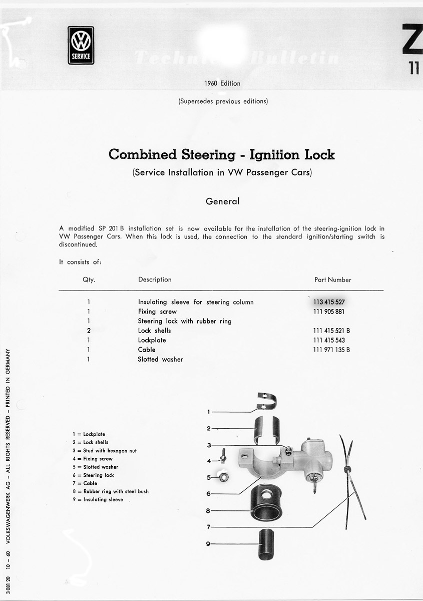

I think this means 58 model year up uses the SP 201C
Here is a pic of the oval version with the integrated start button
This looks like a transitional or replacement part with no button for starter and looks shorter to fit the square dash better
