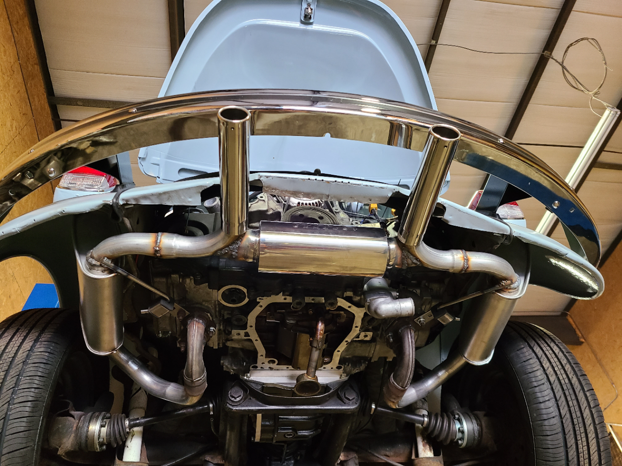

PostPosted: Sat May 24, 2025 10:02 am    Post subject: Re: Anyone make repro/custom mufflers in US Reply with quote
Spain's Complete Muffler Service in Portland, OR
This is a custom muffler for my 1969 Beetle with an EJ 22 engine.
[email protected]

PostPosted: Mon May 26, 2025 8:46 pm    Post subject: Re: Anyone make repro/custom mufflers in US Reply with quote
Nice ...but your post/ pictures/ questions/ anwsers belong in the performance fourm not vintage speed do to the fact it ain't vintage ej 22 and mufflers don't fit or belong in the vintage speed fourm ...
