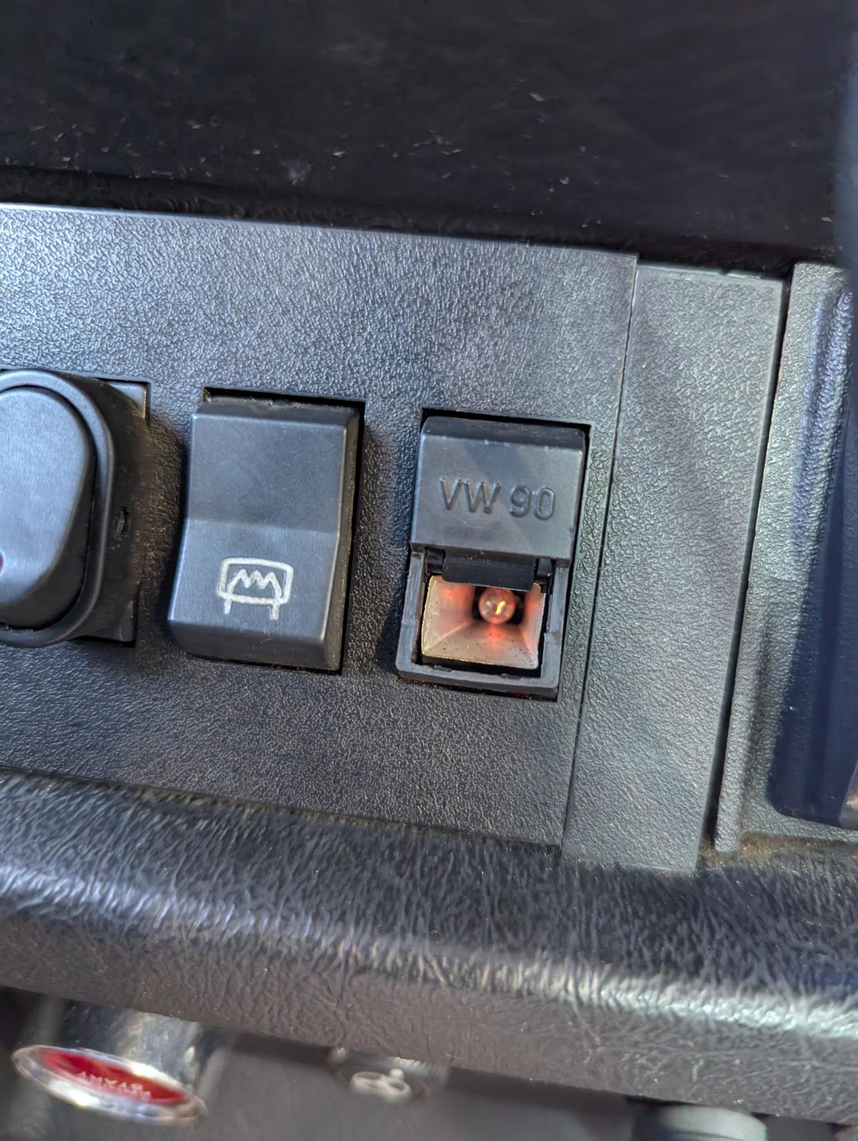

Oh and I noticed that the flasher switch bulb is dimly lit with the parking/headlights on. I'm thinking this is normal, but not sure since I've never really paid attention to it before all this.
This is not normal. There is some kind of short somewhere
The cover broke off at some point today. Here it is dimly lit w/the parking lights on.

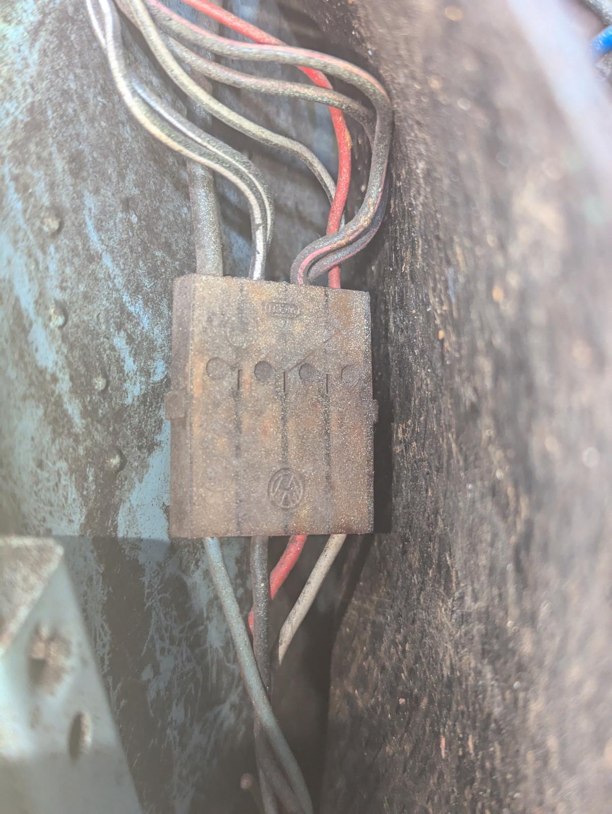

SB, Tomorrow I'll go thru the junctions on the front wiring and report back what I find.

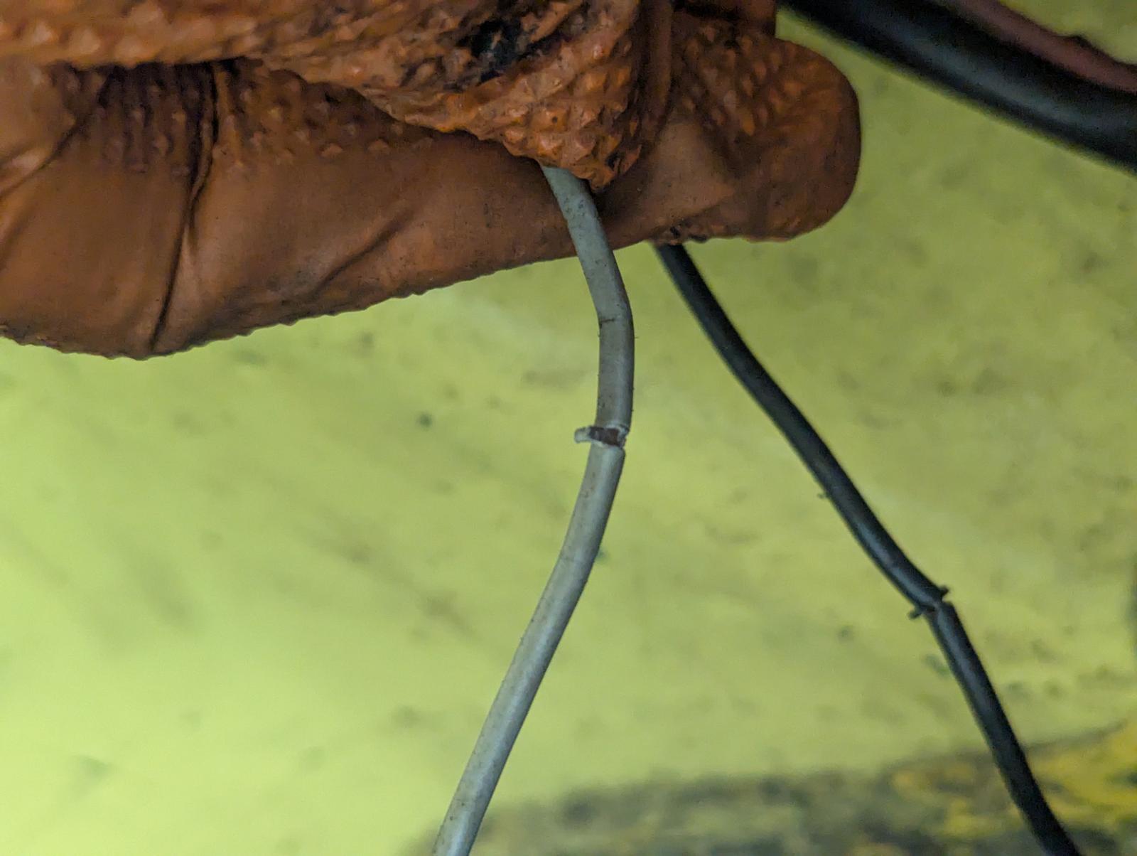

SB, the junctions were good and clean. They're the four-wire ones that are split, so one pair can't contact the other. However, my driver-side wiring may have been an issue. I had remnants of my old headlight ring signal and driving lights wiring still in place, even though they're cut back in the head light bucket.
An ugly mess. I took it apart, eliminated the "retired" wires, and fixed this issue - Cuts in the cladding of the signal and parking light wires.
Everything works fine sitting and parked. We'll see on this afternoon's drive if there's any improvement. I did notice that the flasher switch bulb still lights up very dimly when I turn on the parking lights, car off. Jordan says this is a short. Can anyone else confirm this? My '74 is non-op at the moment so I can't compare to this car.

PostPosted: Thu Jun 05, 2025 9:32 am    Post subject: Re: '73 Super HL Switch ON, No RTurn Signal or Flashers Reply with quote
Heimlich - I just tried this. The flasher is on the output side of fuse #8. It works as expected - flashes when I turn it on, dies when I pull #8. However, w/the HL switch ON, flashers OFF, the flasher switch stays dimly lit, EVEN if I remove ALL 12 fuses! So, i'm guessing the HL switch is getting power from the input side of one of the fuses and is daisy-chained to the flasher...?
Just a wild guess. I've never learned to read those '73+ wiring diagrams.
Click to view image
Save the Supers!!
heimlich Premium Member
VWNOS.com
Joined: November 20, 2016
Posts: 7502
Location: Houston, Texas
heimlich is offline
PostPosted: Thu Jun 05, 2025 9:38 am    Post subject: Re: '73 Super HL Switch ON, No RTurn Signal or Flashers Reply with quote
You don't need the wiring diagrams. It helps for a little reference but my car was so modified that I just had to trace everything.
What does your flasher switch do? If it does nothing except indicate the flashers are on you might just unplug it. Just label the wires when you do. You can also put a meter on the ground coming out of that to see if it is live.
I have a 56 that the high beam indicator on the speedometer stays on no matter what. When I press the floor button to switch it and the lights go off. I just leave it alone. It works.
