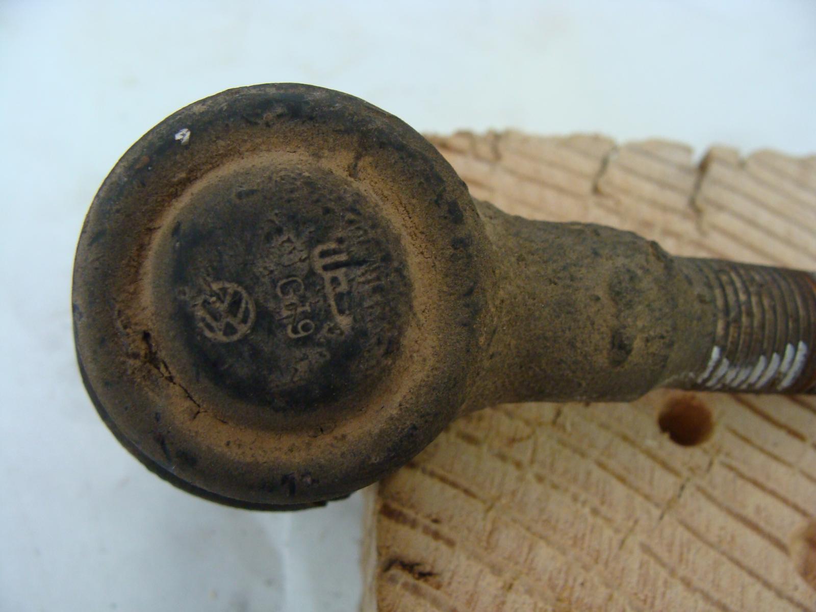

I replaced a factory driver side inner tie rod end on my 1970, only had 261,331 miles on the odometer (but the speedometer/odometer was broken for a while). Original had the factory VW stamping; replacement was through Autozone, made in Belgium and lifetime warrantied. Then I adjusted the toe-in.

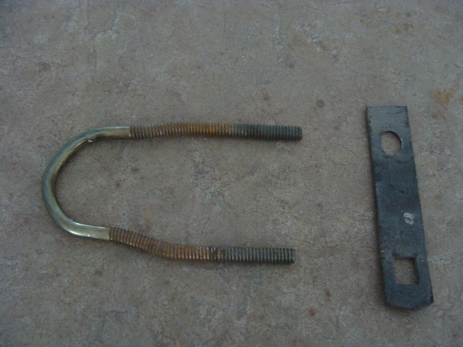

Also, I'd used two hose clamps to support the end of my quiet muffler, and the clamps broke. So I bent a U-bolt to fit and used that.

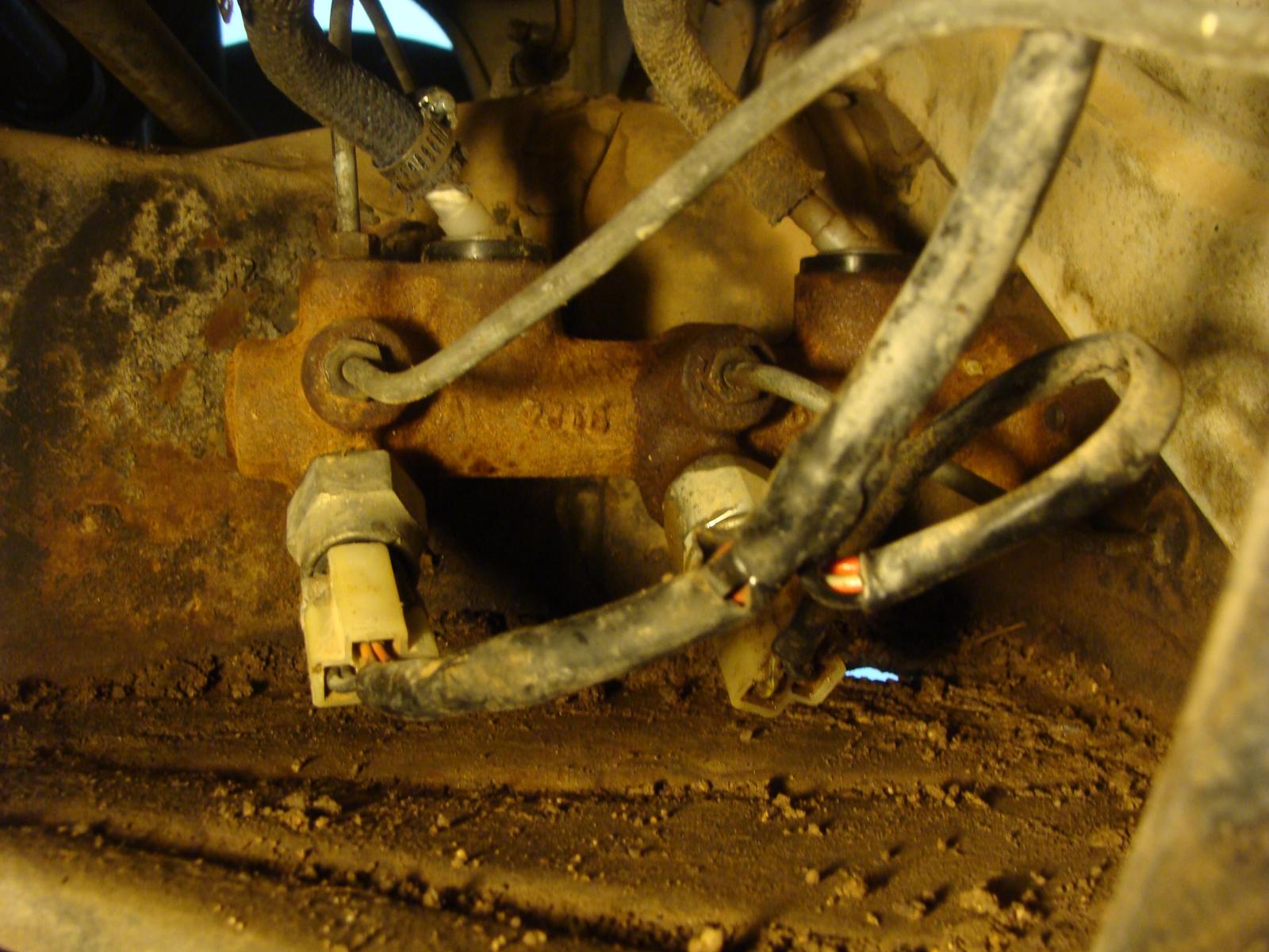

I brought my dwell/tach up from Phoenix to adjust the points/dwell on the 1970 VW, but too cold/windy/hail today to do that. When I went out to see if I had a brand-new set of points in its trunk - just in case - I noticed that my brake reservoir is empty - ALWAYS SOMETHING !!! I'd just driven it into town last Saturday and on a drive last Sunday, and didn't notice any issues with the brakes.
The master cylinder, all four wheel cylinders, the four flexible brake lines, and the two brake fluid fill hoses to the master cylinder were all new back in 2017. Will take a look-see tomorrow if weather is better (not likely). But always something !!

Sunny but cold today, about 45F at 9am, but I moved the VW into the garage and took a look. Apparently the short blue brake hose to the front plastic elbow on the master cylinder was leaking, and practically fell off in my hand when I touched it. Maybe I didn't get it over the plastic hose barb on that elbow enough, or it vibrated loose. The ends of the blue hose looked cracked too, guess they don't make that stuff very good any more, was only 7.5 years old.
Anyway, I did not have any of that blue brake hose up here, so I just cut away the damaged part and (somewhat difficult/awkward) got the hose over the plastic barb enough, and this time I added hose clamps. I didn't do anything to the short hose for the rear side of the master cylinder. I also did not see any evidence of the master cylinder leaking at its rear, or at the wheel cylinders. So maybe this will do for now; I'll bring some blue hose up from Phx or buy some new to have around.
I may also have had a tad of leakage from the rear line fitting, only evident after I had cleaned up the MC with brake cleaner, so I tightened that up a tiny tad too. Or that leak could've come from the front brake hose just above it....

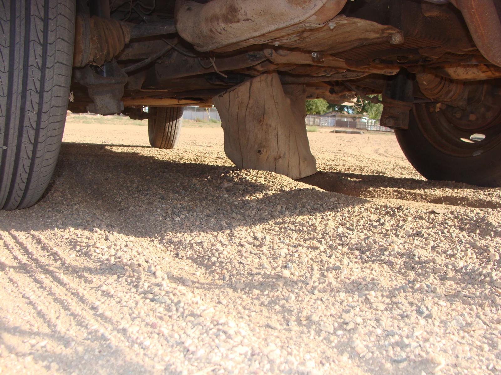

We use my 1970 VW sedan primarily for dragging the horse arena; it's dusty, but mainly rear of the VW. Today I did its yearly oil change service (STP 10W-40), new STP S16 oil filter (CB Maxi2 pump/filter), and service the stock type air cleaner.
I also stuffed some heat-resistant fiberglass tape into the crevice on left side of engine. That tin had been mangled by dealer-installed AC when VW was new, I bought it in 1972.
I also noticed that the big rubber stopper I had used to plug the hole in the rear tin had disappeared.
So I flattened a scrap piece of galvanized roof flashing I had, and cut a patch for that tin.
