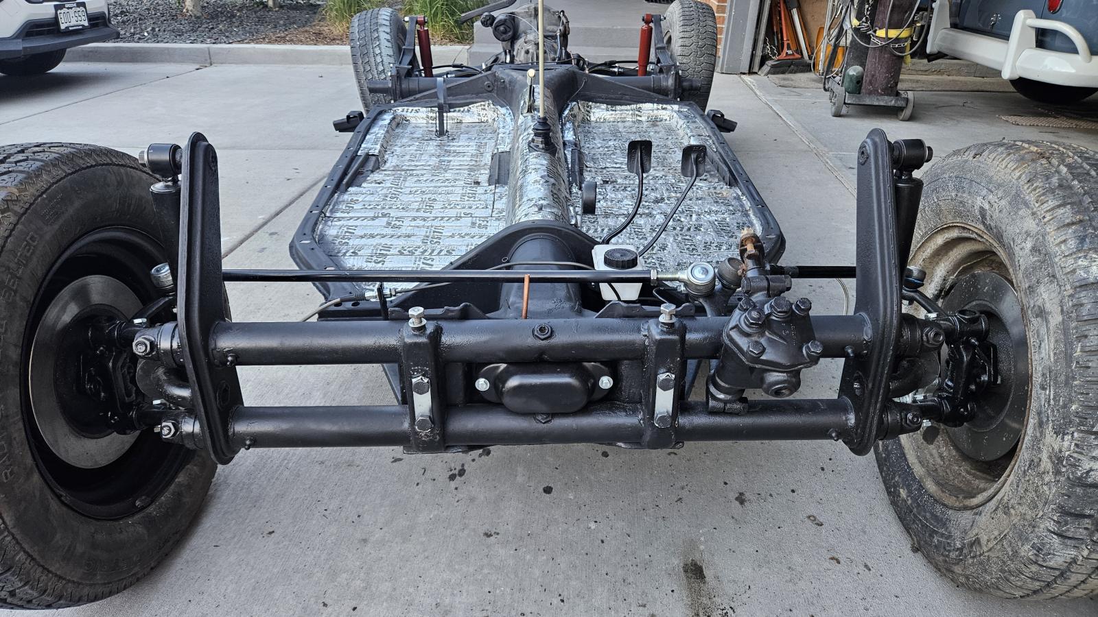

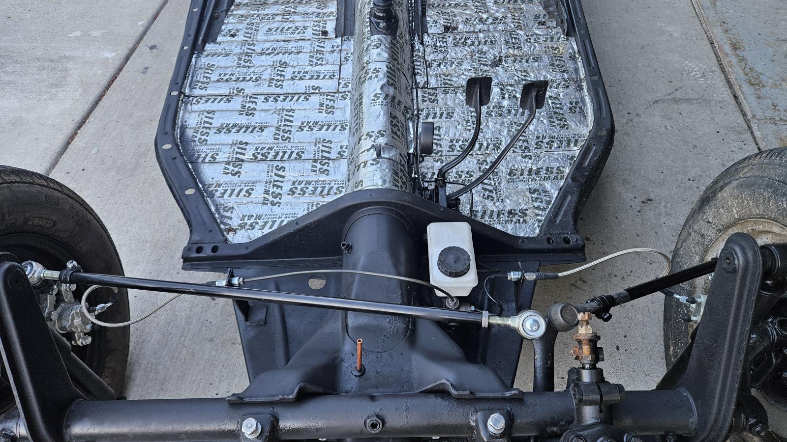

Body is off the pan. Today I took the front axle and transmission out and scrubbed the pan w degreaser. If it ever stops raining here I'll apply phosphoric acid and then por15 the whole thing ... After I replace the rear pan halves and weld up a few small holes on the driver's front.

This week I'll be replacing the rear pan quarters on both sides, then hitting the frame and floors with Eastwood encapsulator.

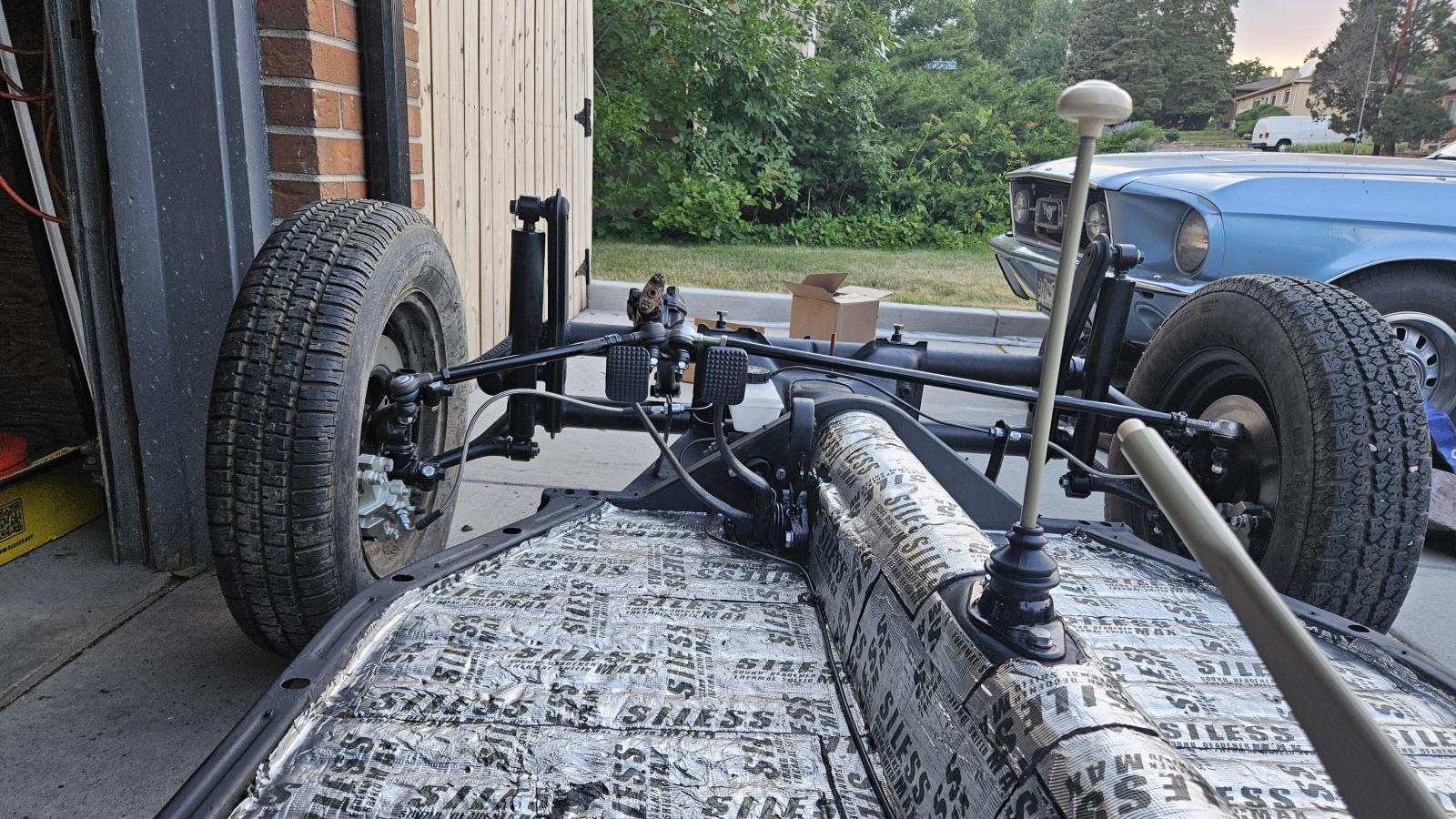

One thing I've learned from this hobby over the last 25 years is that sometimes you just need to see a small victory... In this case it meant painting the shifter and base L75 beige after some rust treatment. Although I think the base gets painted black ...

Finished up work on the floors today. Pretty happy with how they came out.

As my summer break comes to an end, I finished up the chassis on the 55.
All that's left to do is fill and bleed the brakes and clear out one of the heater cable tubes which feels like it has cement in it.
Overall, I'm happy with it.
Next up is to build the engine, mount it and see if it runs. It's a case from 36hp dated in 57.
