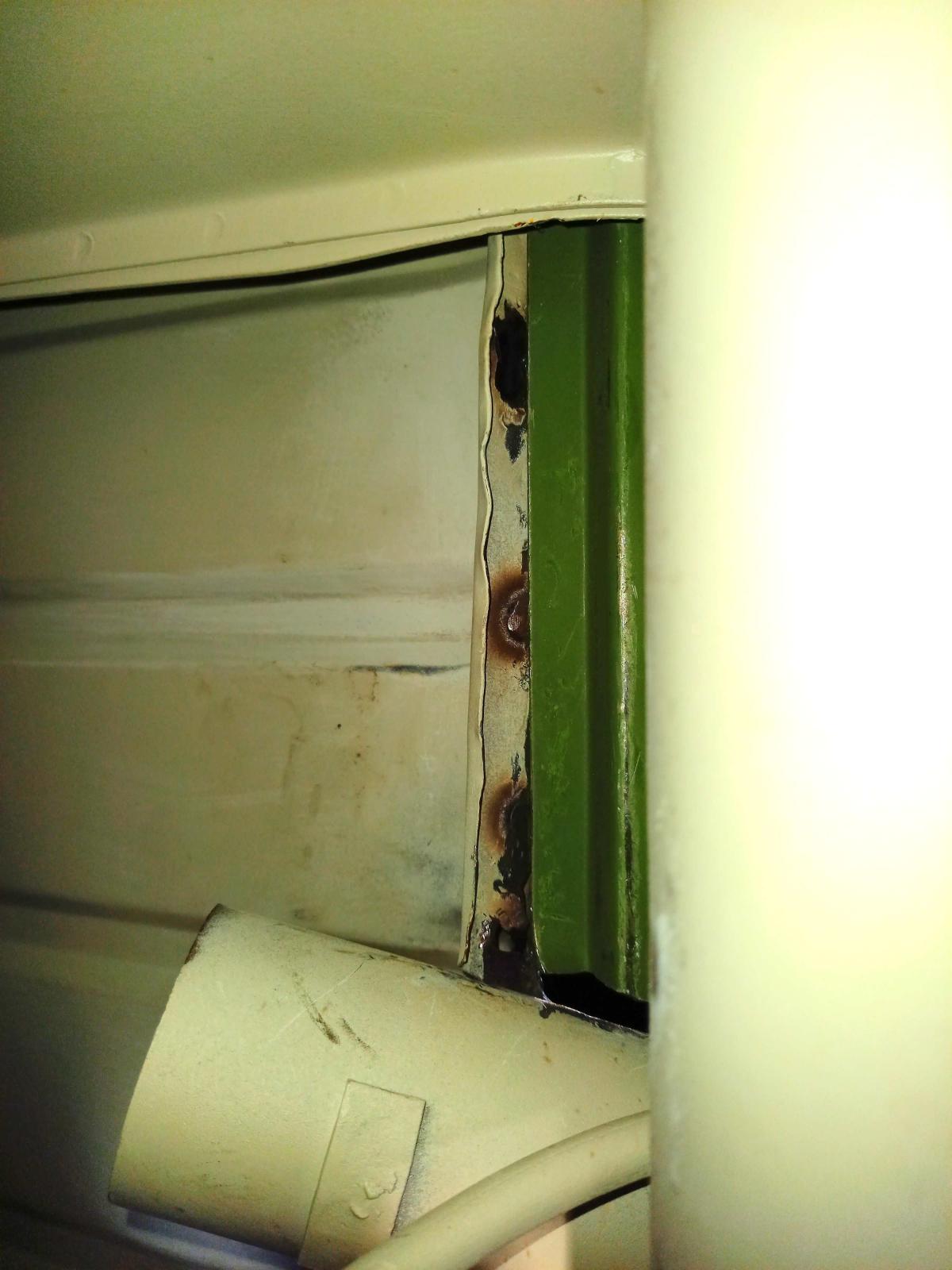

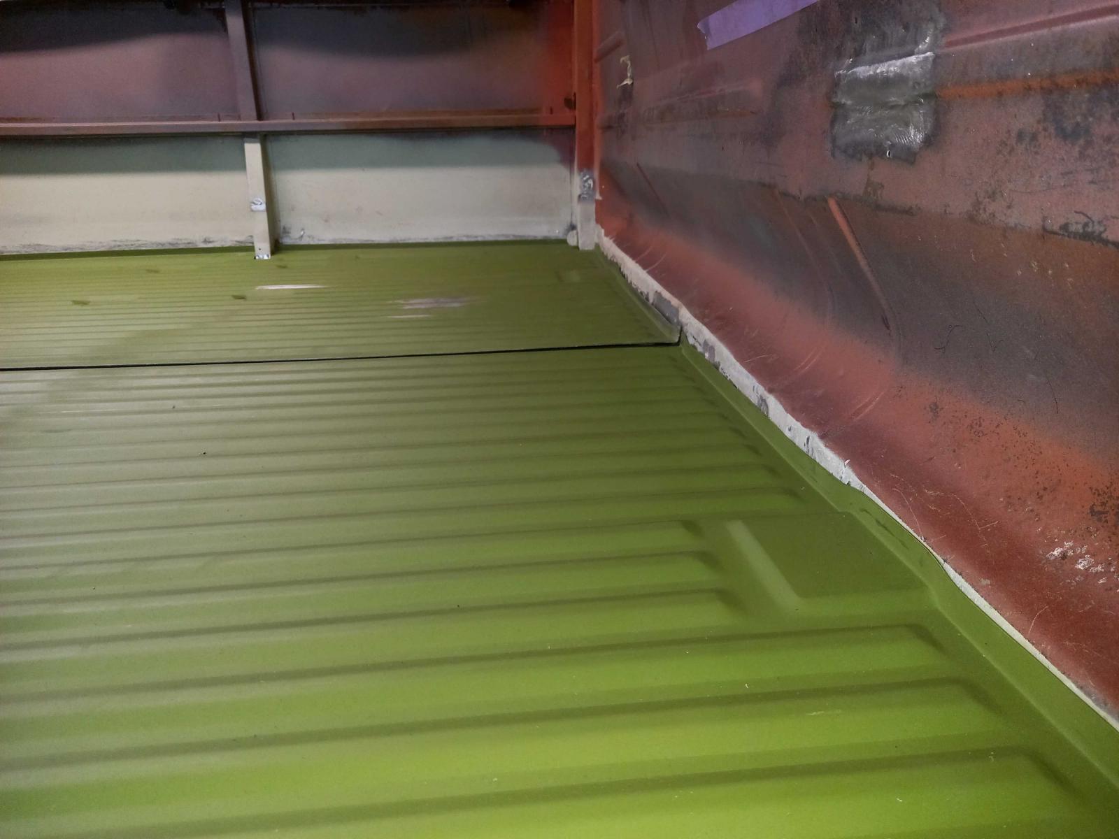

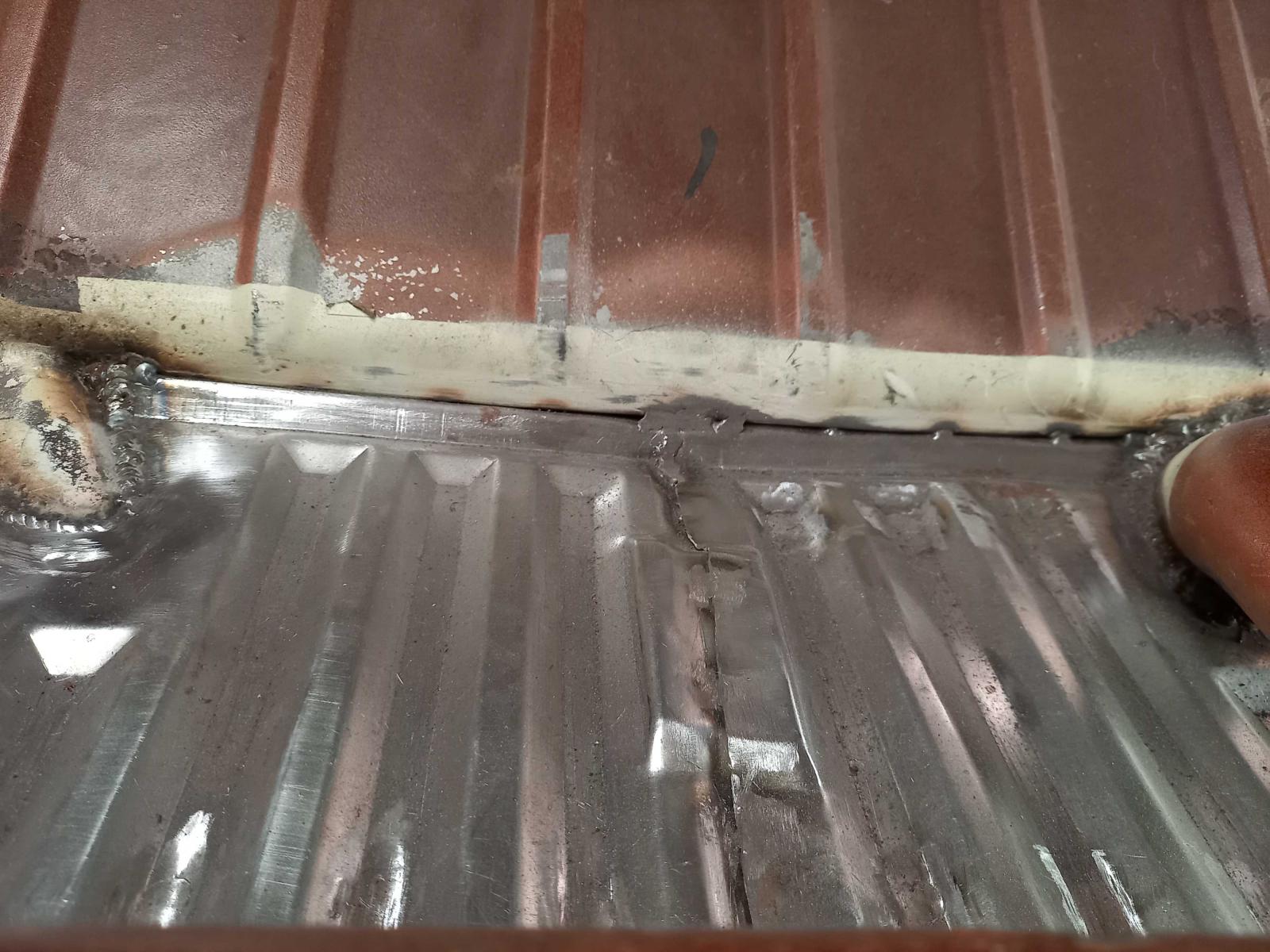

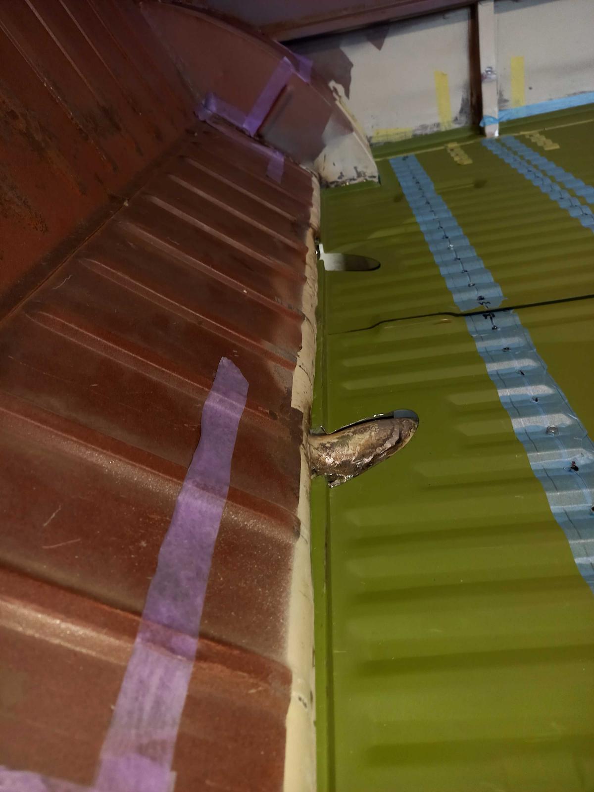

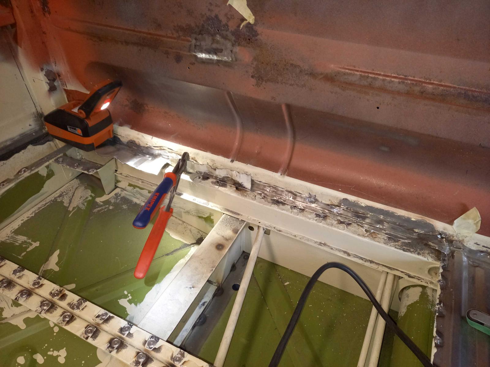

O.k., coming back again to the unattractive cargo-floor Rolling Eyes
The most annoying points were ...
- wavy floor
- waves at the driver-site-wall
- because the coachbuilder fixed the 2 floor halves in the wrong order, the middle seam was not smooth and the welding points were done from underneath
- the locking-rod of the left double-door scratched over the floor and ‘plops’ into the hole of the reinforcement plate
- the floor-panels rises up towards the engine-compartment-wall
- the Z-jump at the bottom of the engine-compartment-wall was not rectangular
For the last 2 point seems to be the too short cargo-floor-panels responsible.
These issues caused me a headache and bad mood each time I saw it Confused
(unfortunately about 10 months because of a longer pause without any progress)

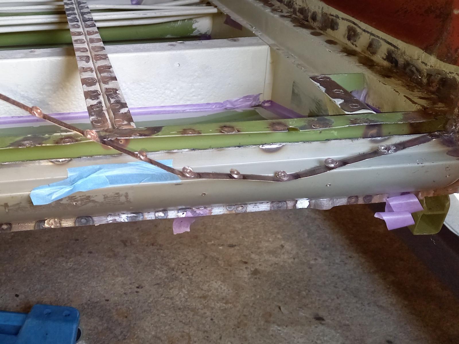

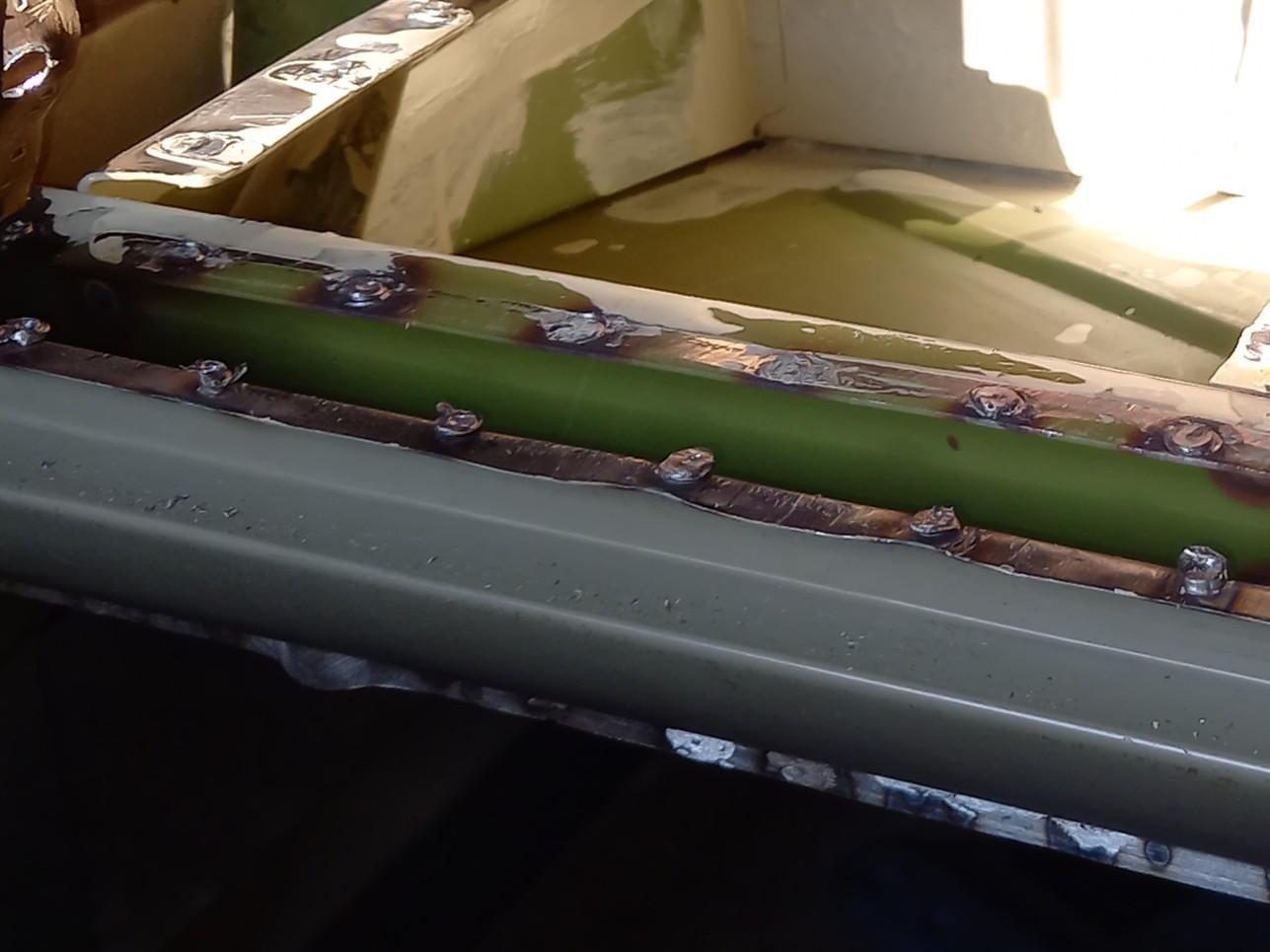

So after that pause I tried first to improve the height of the reinforcement plate to avoid shortening the double door lock-rod.
The reinforcement plate could be lowered by approx. 1 to 2 mm through countless hammer blows.
But this was not enough.
It seemed that the outer-rocker was about 5mm too high (even if the measurements of the original and the WW-part are identical).
Unfortunately the coachbuilder removed the original outer-rocker without having marked its original position.
During installation of the new part, we concentrated exclusively on the correct position and accuracy of fit to the outer shell …
Some sleepless nights followed … Sad

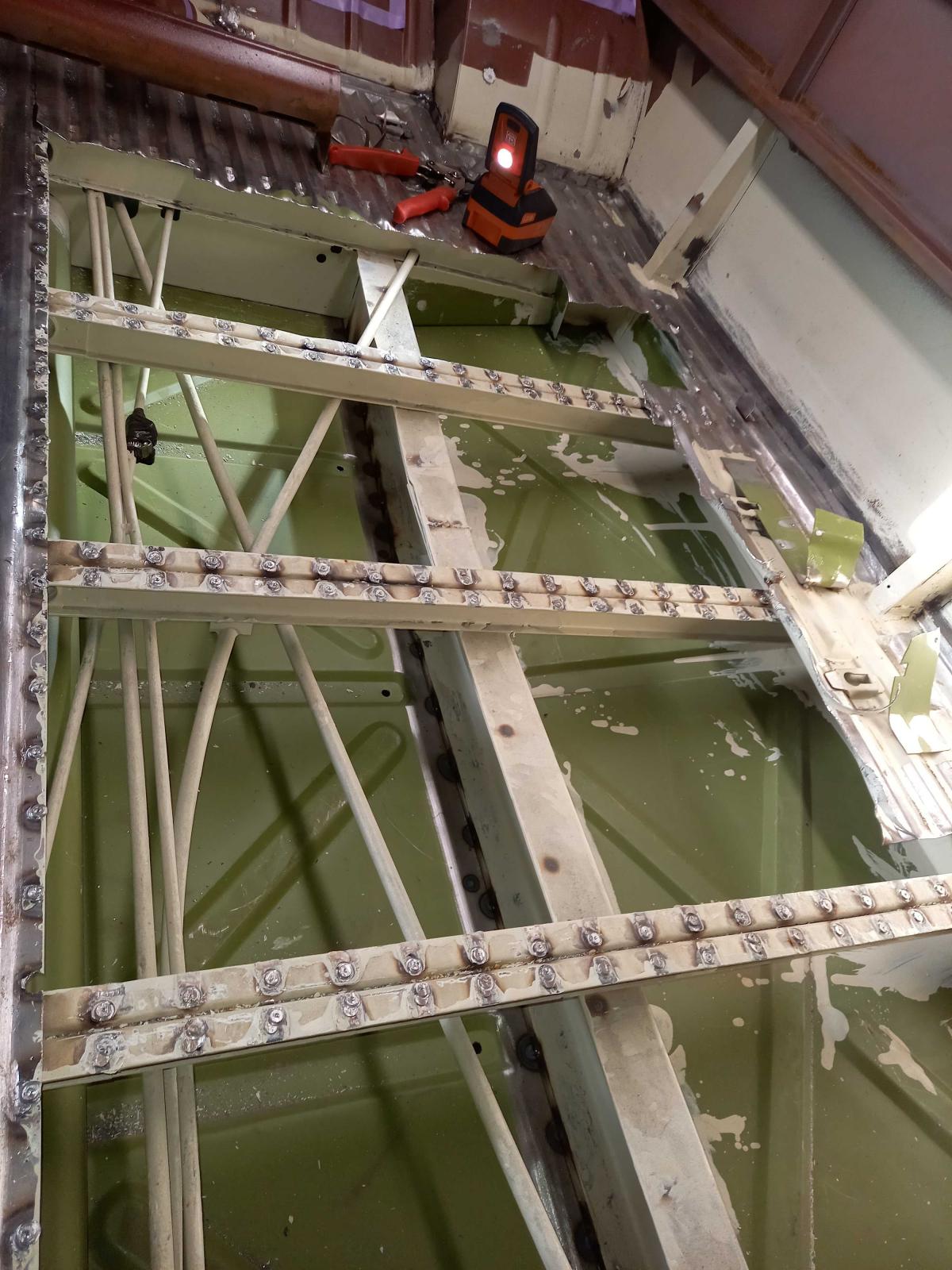

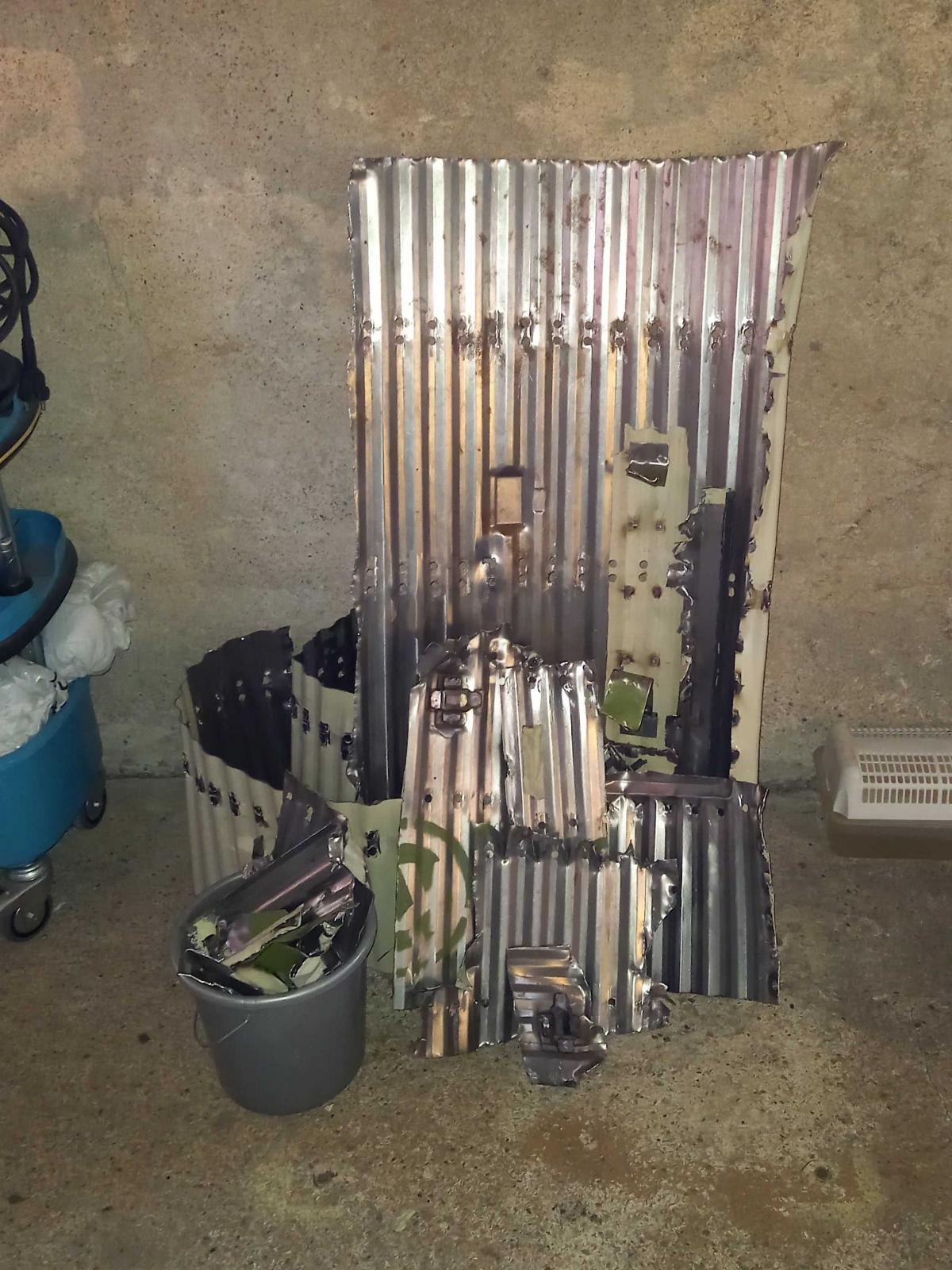

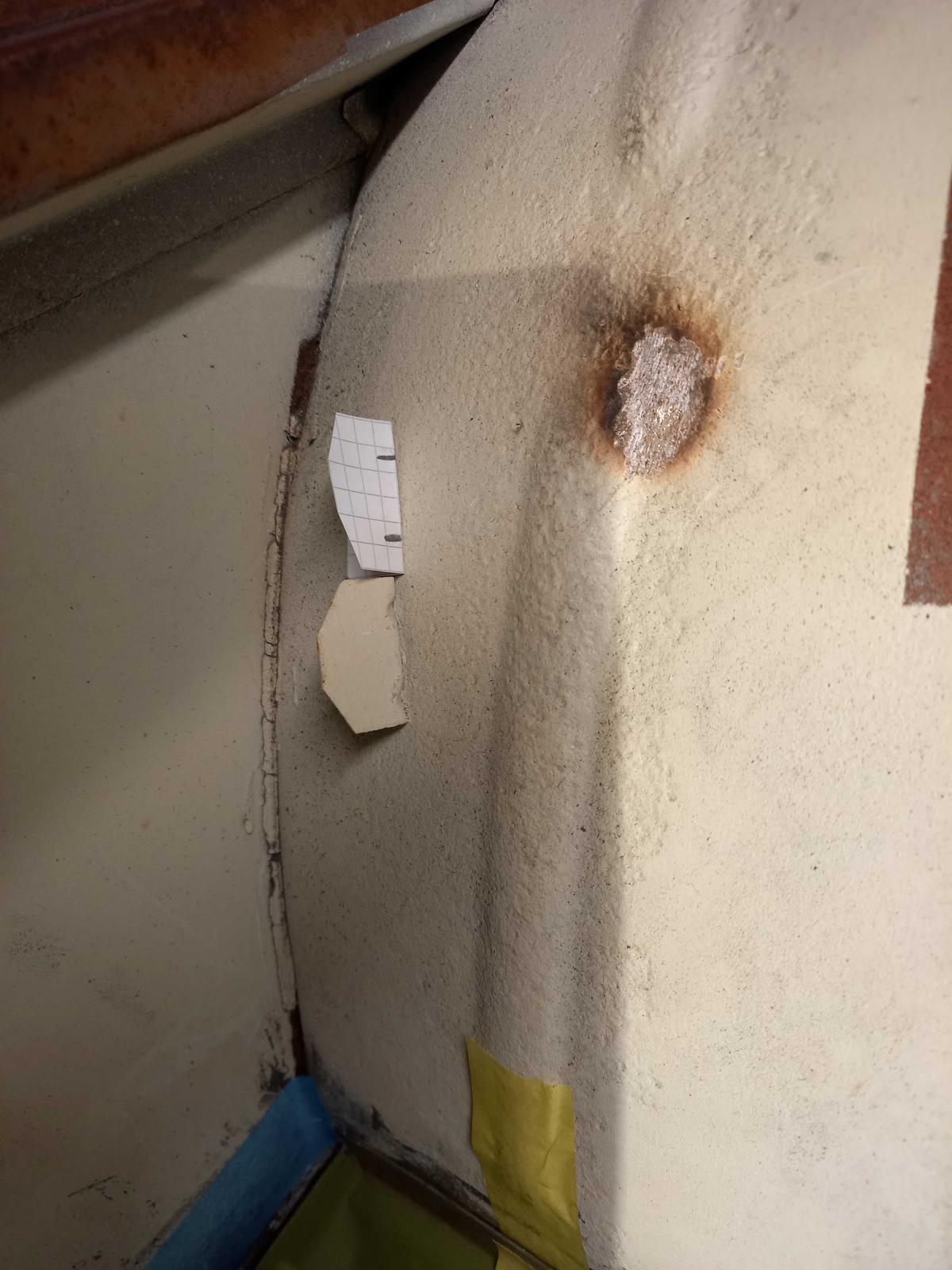

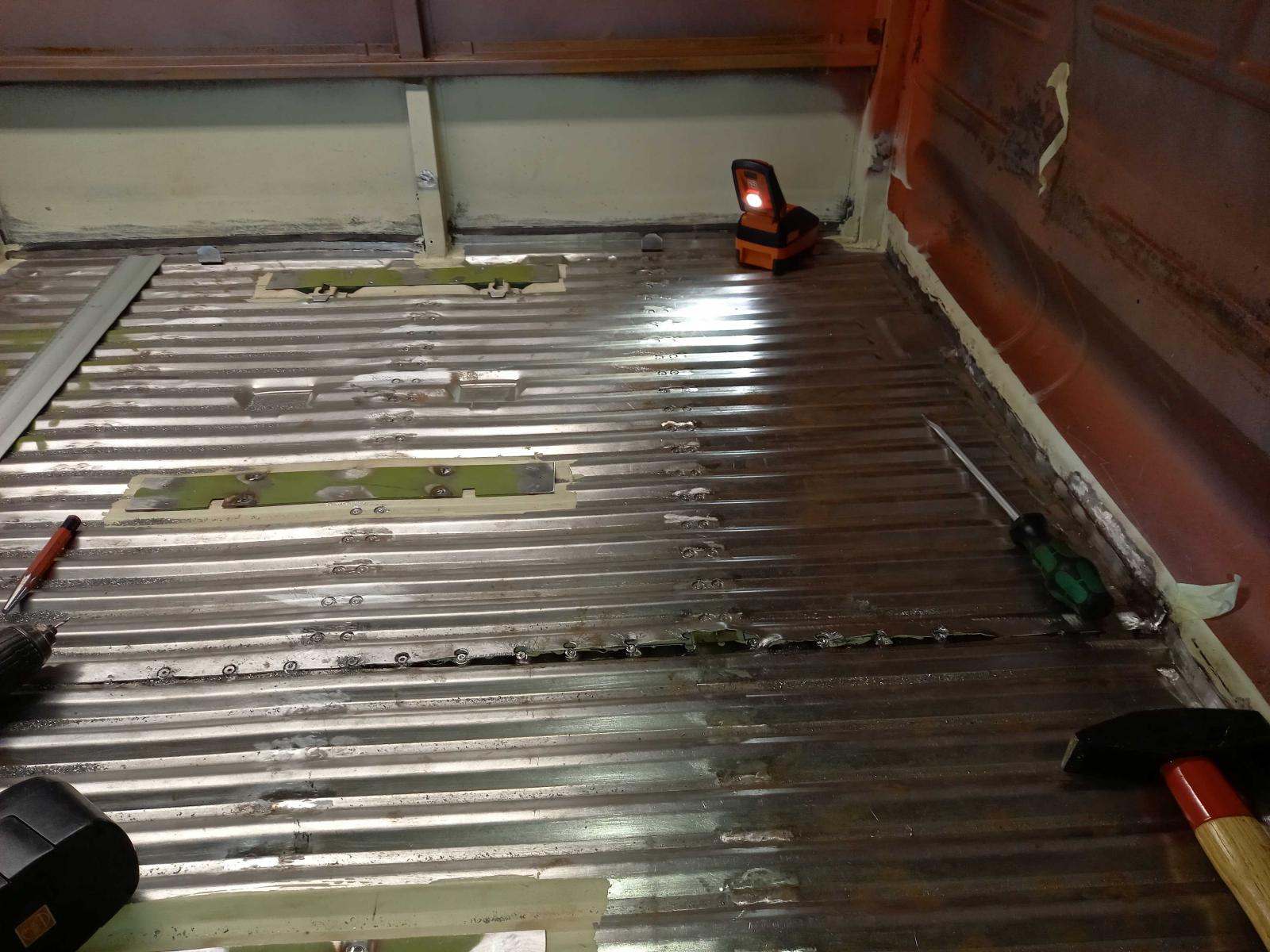

... some sleepless nights and days of deliberation about all the points of the unattractive cargo-floor passed by Confused
My first approach of trying to gloss over the different points didn't help.
Even if a large part of the areas will be covered up later (with rubber mats, interior panels, etc.) I know that the mess is still there.
And the voice inside my head wouldn't stop reminding me Smile
So it was not the right basis for further work.

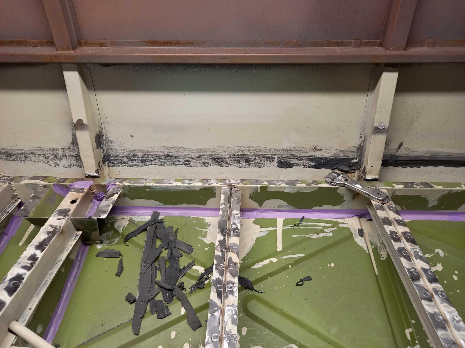

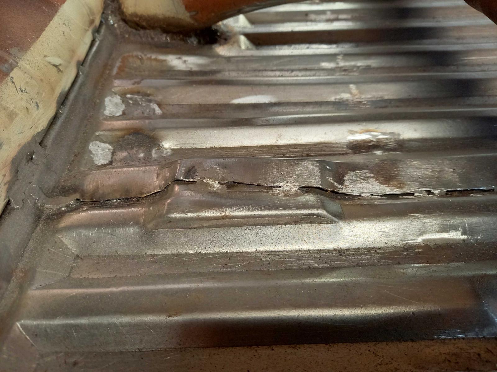

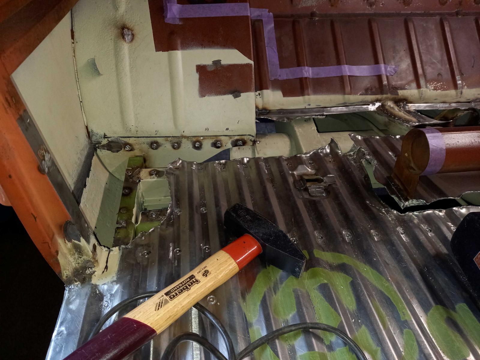

I have to confess, that this was one of the hardest decisions during this project: Removing the new cargo-floor.
It took a little bit time to do the first cut, but afterwards I felt relived and on the right way Smile
… unfortunately, I had grinded the welding-points so smooth, that it was a challenge to find each center to mark it up correctly for the welding-point-driller…
… expensive scrap metal …
… it was very time-consuming to remove the remaining sheet metal underneath the partition wall to the engine compartment …
Finally, the remaining body adhesive was removed …
Now it was time to order new floors-halves Very Happy

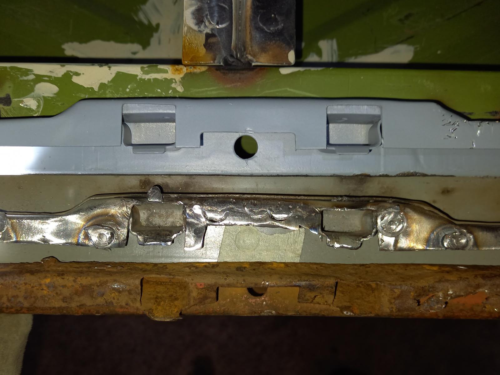

PostPosted: Sat Jun 14, 2025 11:15 am    Post subject: Re: Nice bus, even nicer sister Reply with quote
… until the new floor-halves arrived, the time was used to prepare the new angles for the interior-panels and record all measurements in my project-diary …

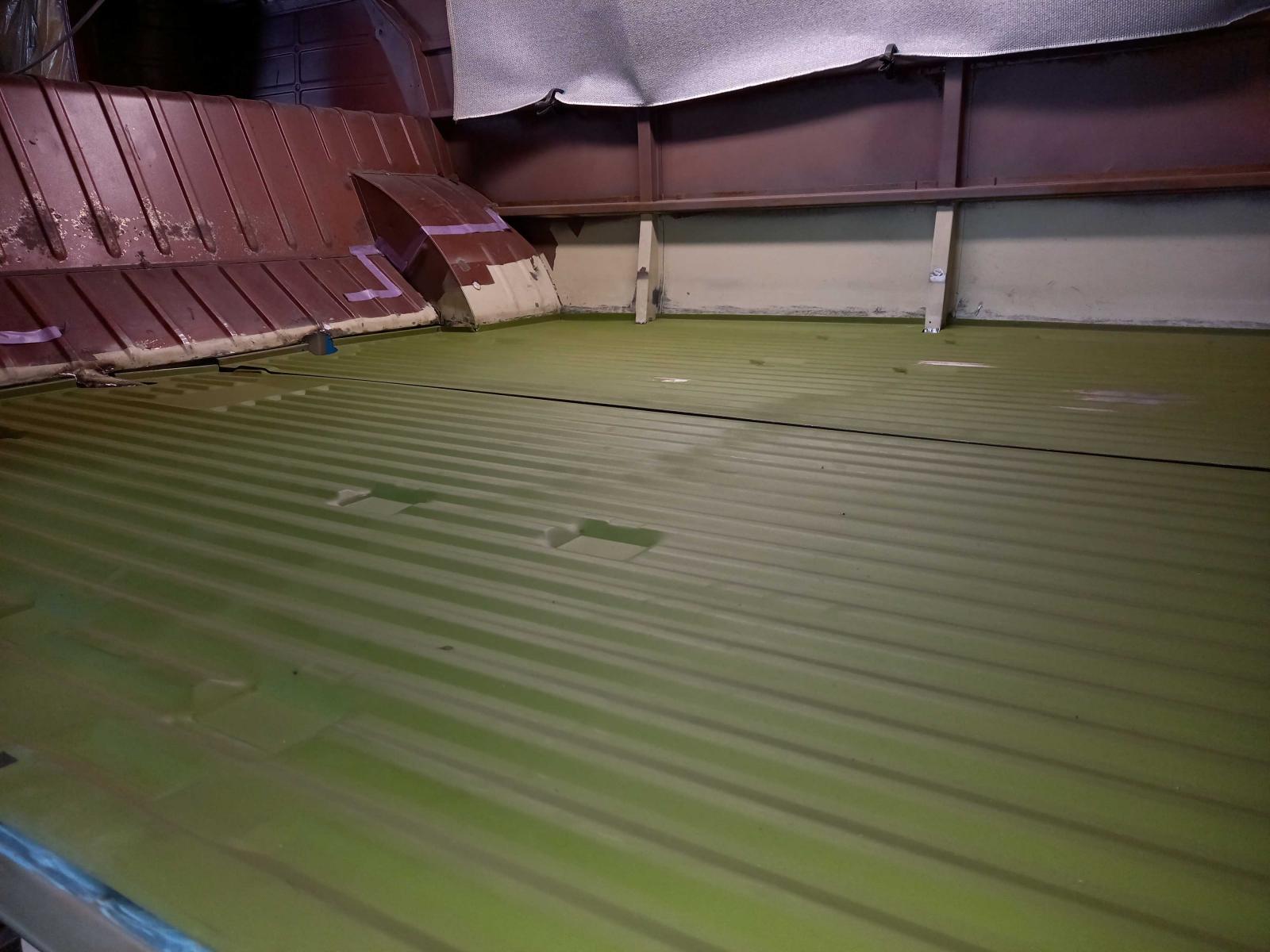

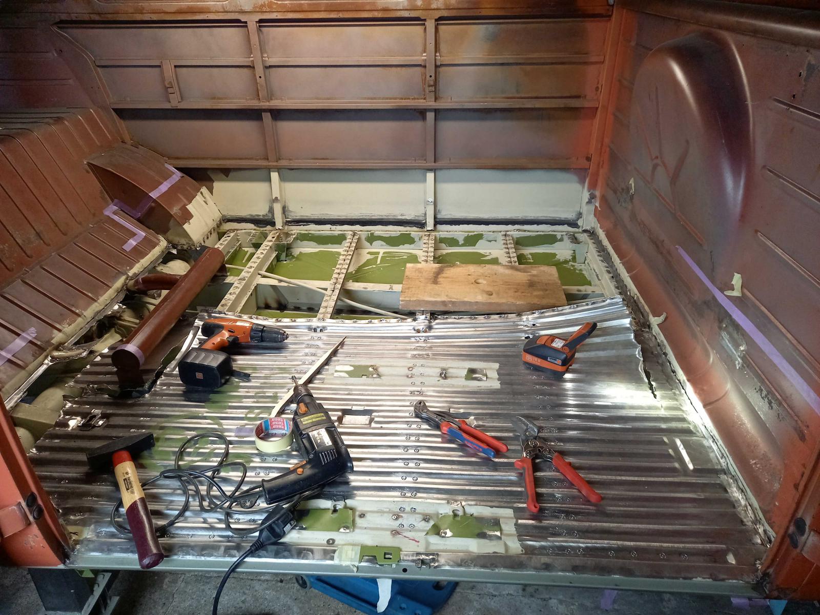

PostPosted: Thu Jun 19, 2025 5:18 am    Post subject: Re: Nice bus, even nicer sister Reply with quote

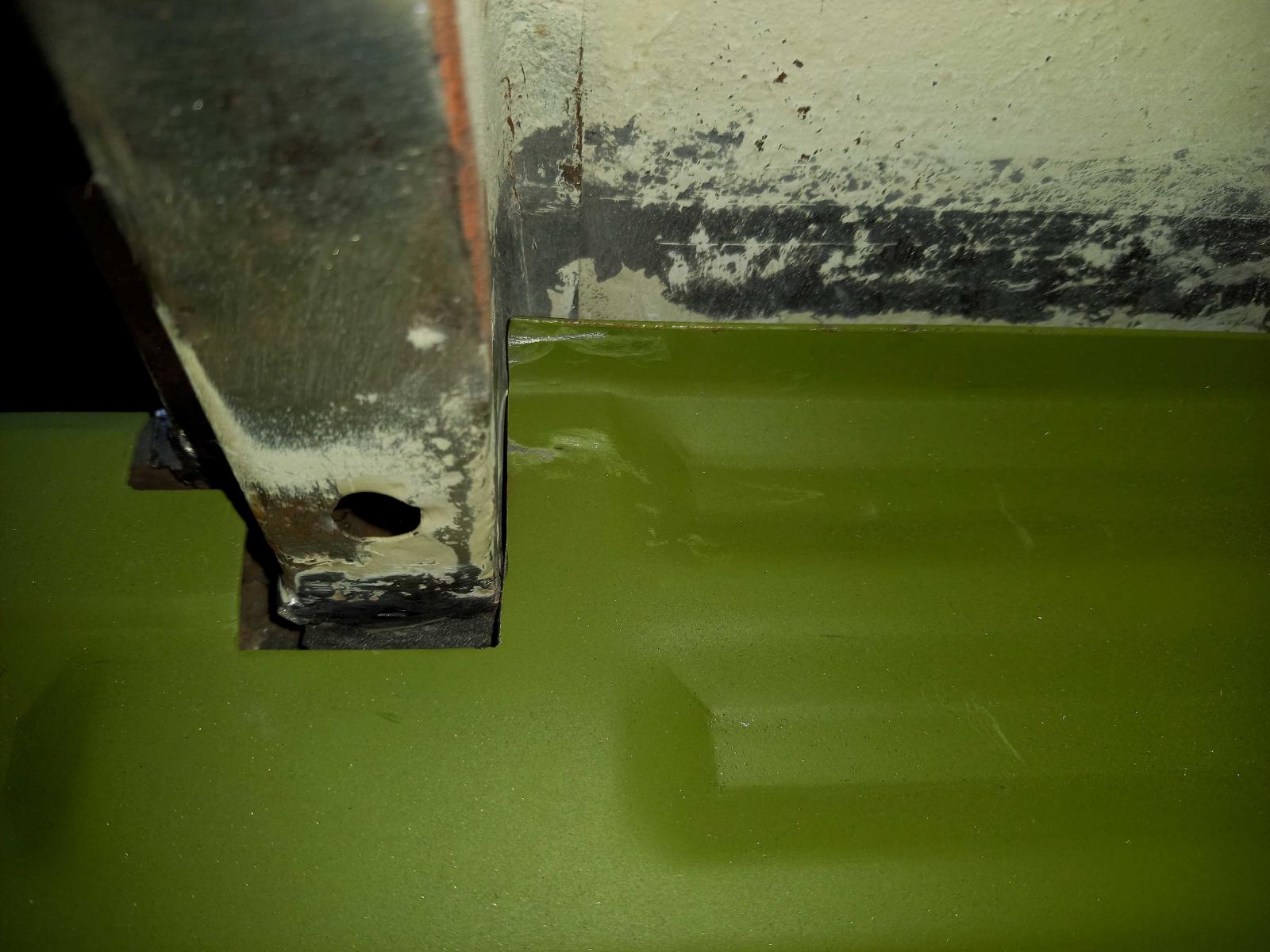

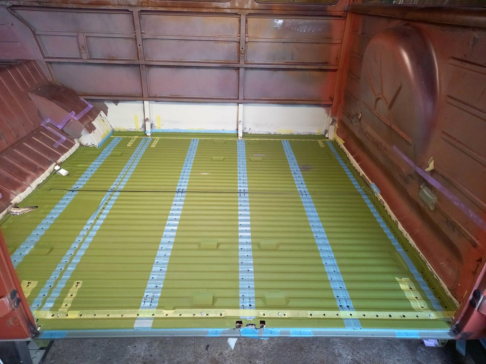

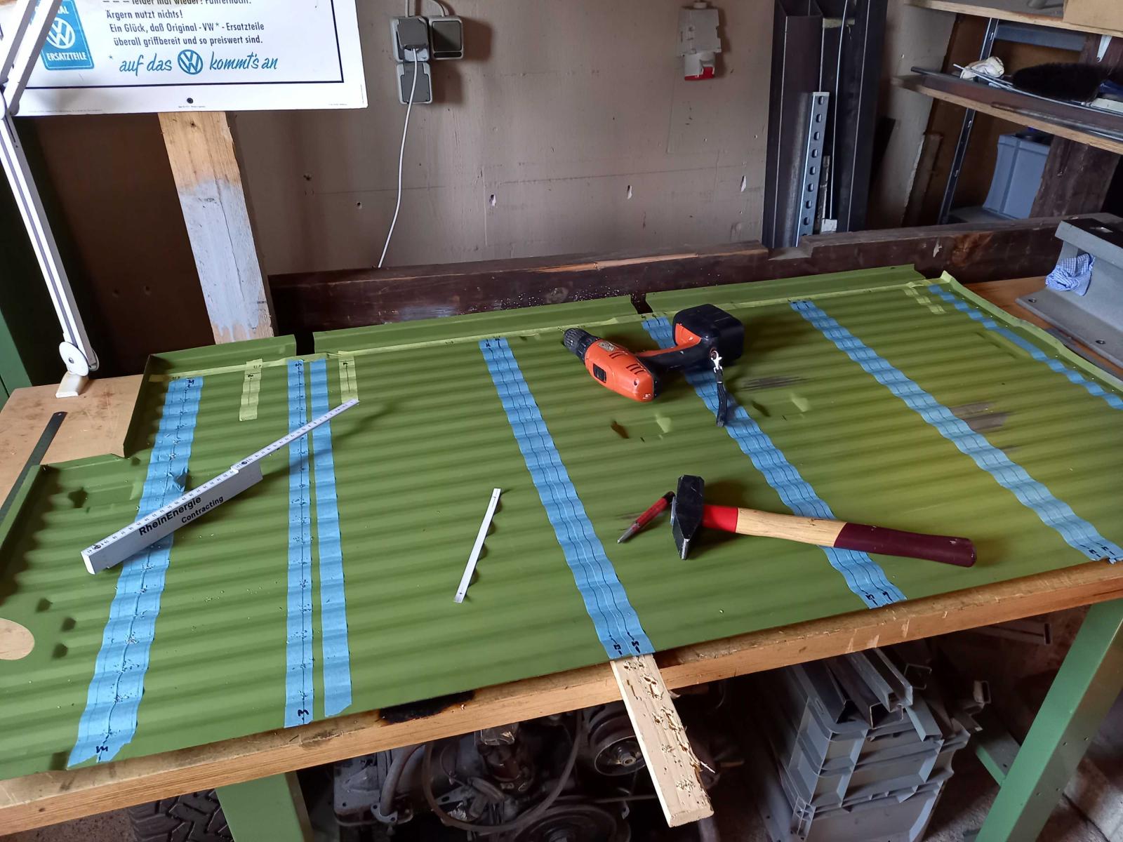

... the new cargo-floor-halves arrived Very Happy
Fortunately, this version was painted completely with primer
(… don’t know why my first version was not primed …)
The first fitting to check which areas have to be adjusted.
… it seems, that the sheets are not long enough, because in the end a few millimeters are missing …
… the cut-out at the heating pipe had to be enlarged a little bit …
What a beautifully smooth surface Very Happy

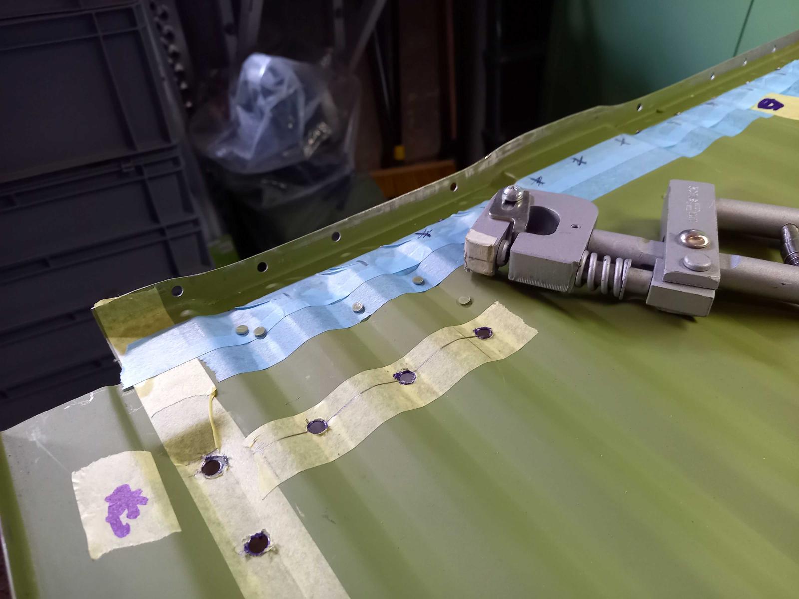

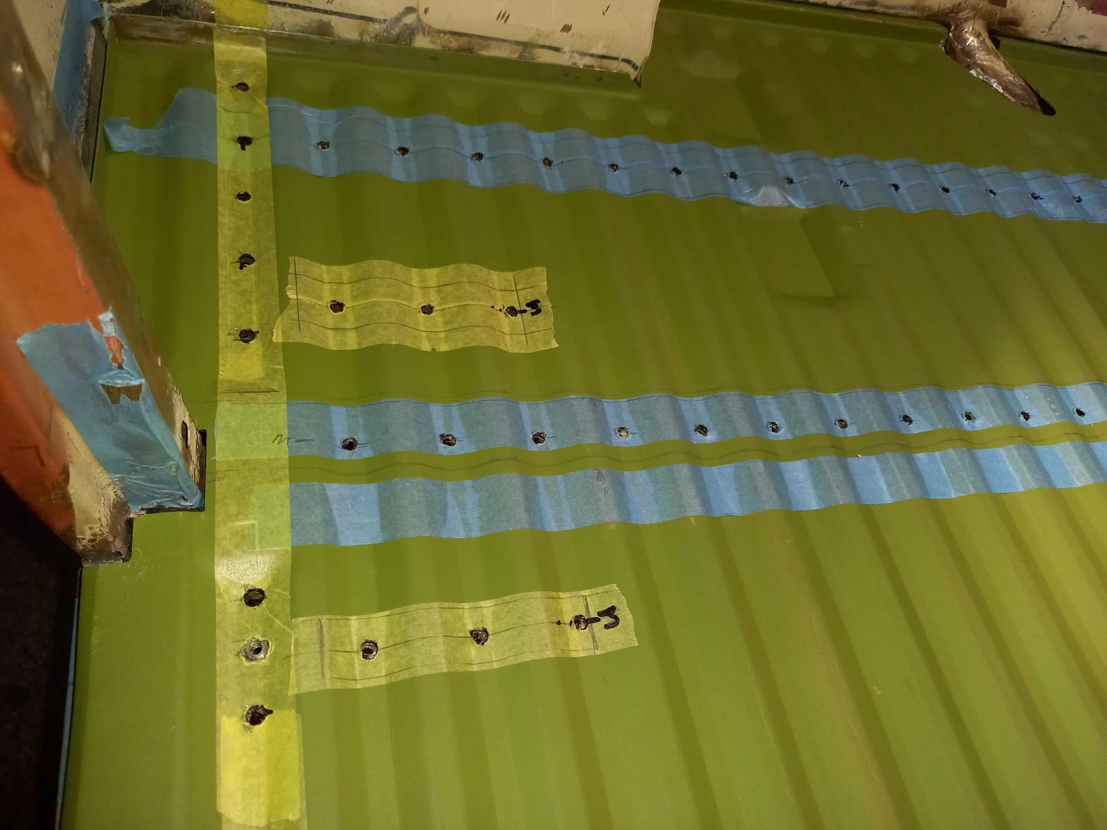

Now it’s time to drill all the holes for the welding-points.
The removed first floor-halves got very wavy during the welding.
Maybe one reason for this could be the large number of spot welds, which have now been reduced for this floor:
Only one welding point for each cross-brace mounting-point.

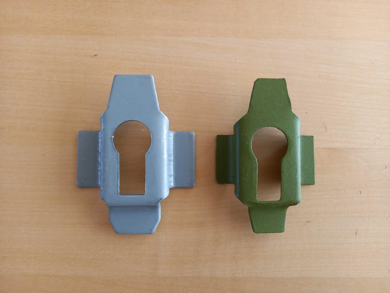

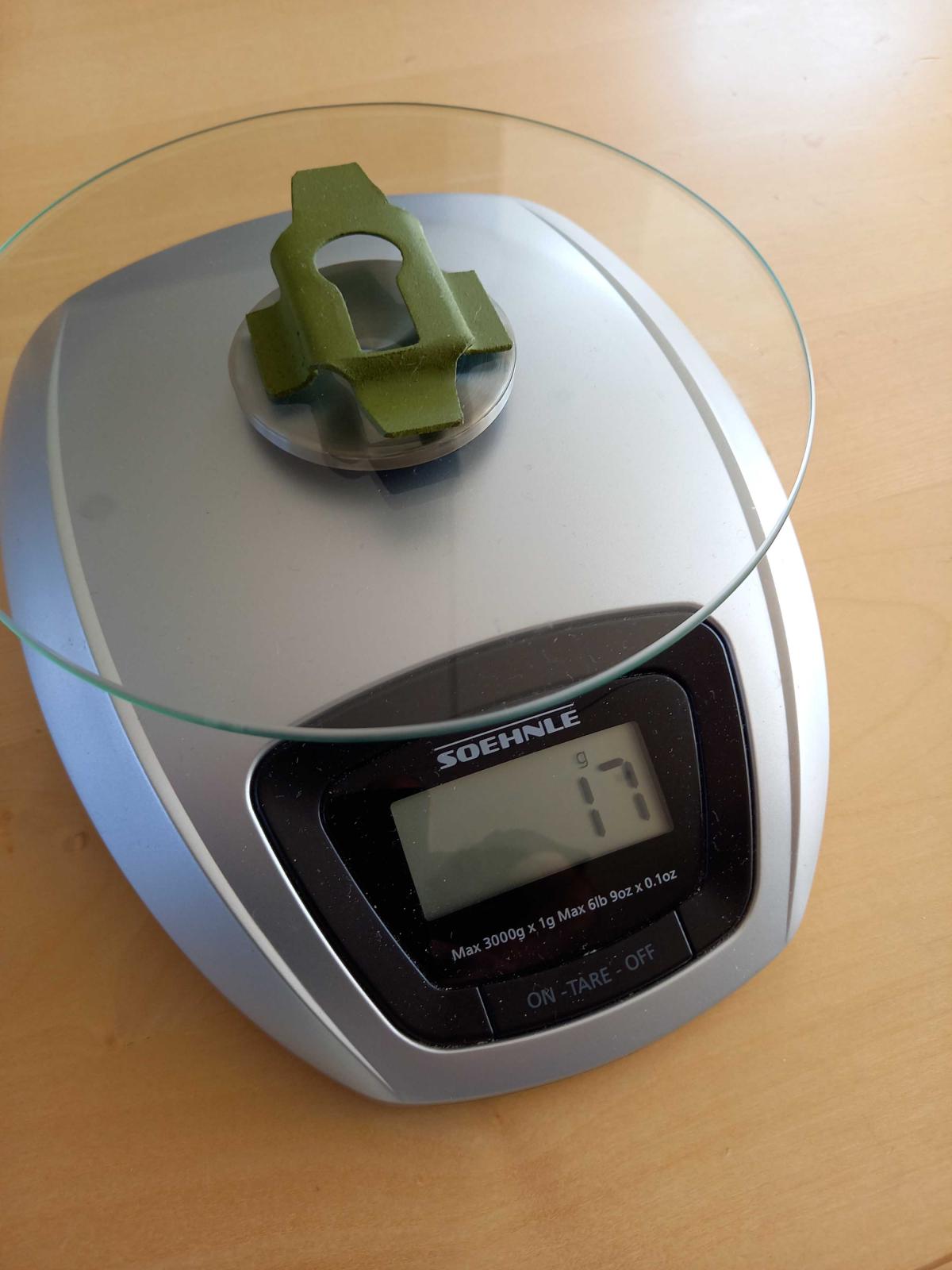

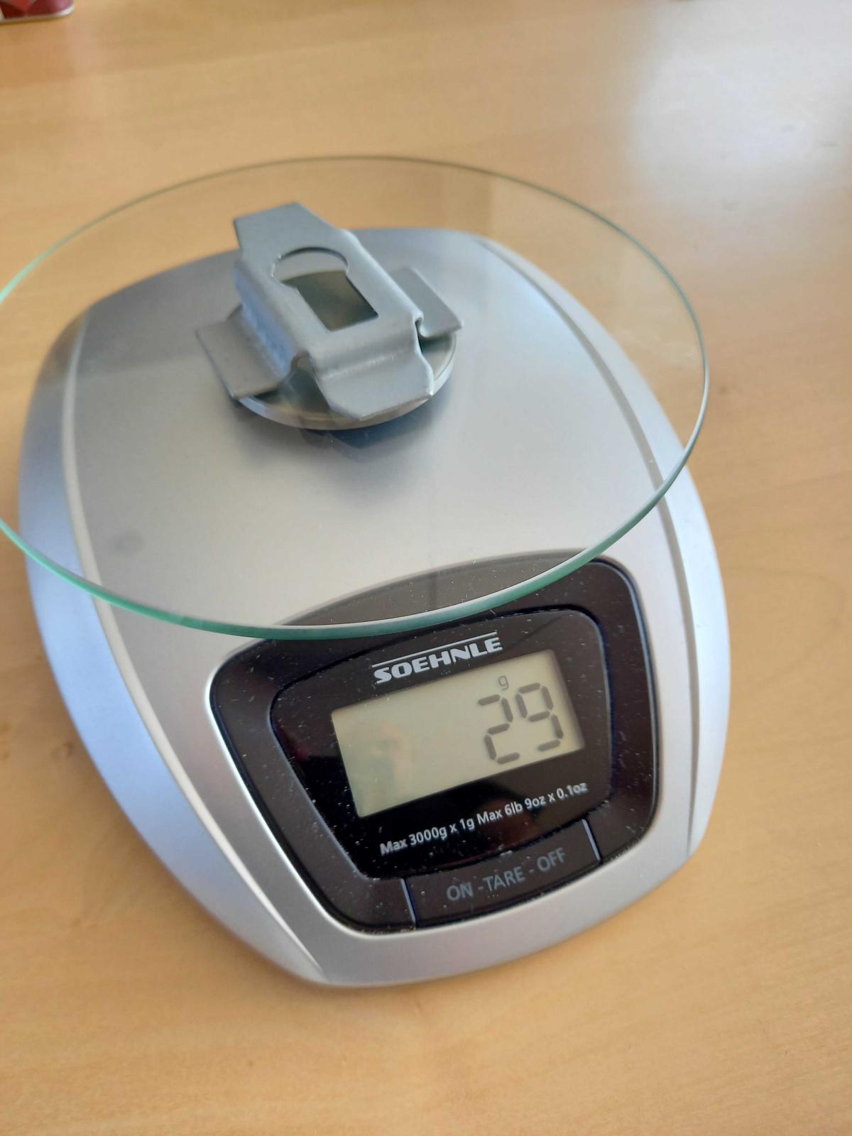

As a precaution I bought 2 different seatbench-mount-brackets.
Both versions were weighed …
… and the preference was given to the ‘heavier’ version Wink

After the 2 floor-halves had been prepared, it was time to adjust the top of the outer cargo-door-rocker.
The upper edge was approx. 4 ... 5 mm too high.
So first of all the top strip was cut off …
Because of my first adjustment-tries, both holes for the door-locking-rod were no longer useable.
To have a new part including top-strip, the needed section was cut off from a new disassembled cargo-door-rocker ...
The last Millimeters of the vertical section were cut off to have the correct height ...
After that there is now enough space and the door-locking-rod does not scratch over the floor anymore ... Very Happy
