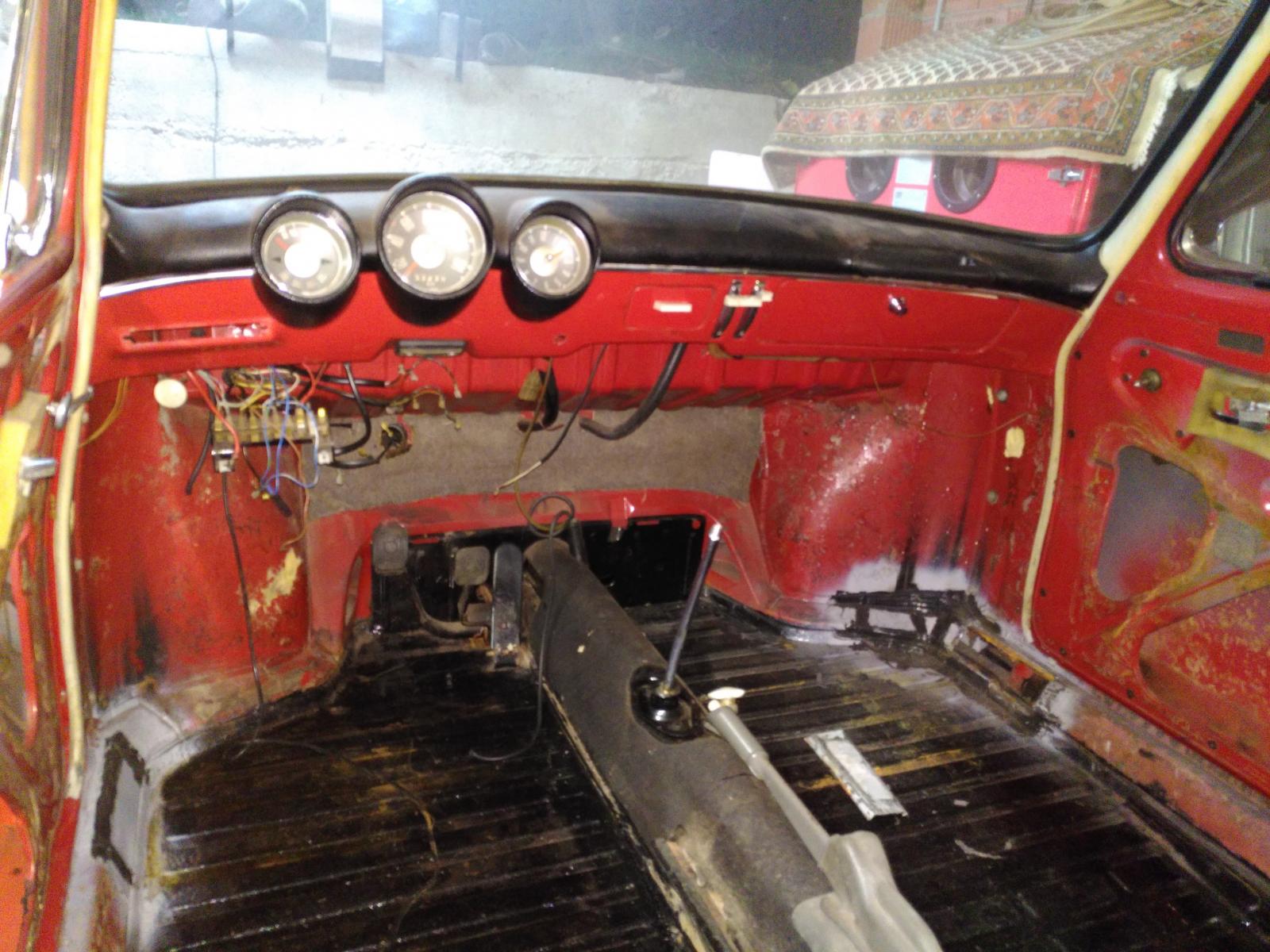

I picked up my notchback yesterday. What I got is a big puzzle with some extra and some missing pieces.
Most of it is actually quite nice, but I have decided I will need to replace the heater channels, inner rockers and probably also the outer rockers which are new but not well done.
Once I am at it I might also decide to replace the floor pans on both sides.
It looks like I will have to make the inner rockers and heater channels my self because all I can find are replacements for the later style. I will need some measurements of the front heater vent. The PO welded them shut Shocked

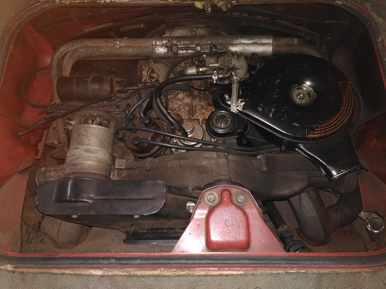

PostPosted: Sat Nov 14, 2020 2:23 pm    Post subject: Re: New project: 63 sunroof notch Reply with quote
Here is a picture of the engine compartment. I haven't done anything to it yet. Haven't even removed the hazelnut shells, that some rodent left there.
It looks like it is the original motor. The number fits to the chassis number and it has not been rebuilt. The fuel pump is not original but I am getting the correct one probably next week. I already have new bellows and the air intake is also in the parts stash.

Jason37
Joined: April 21, 2004
Posts: 1049
Jason37 is offline
PostPosted: Sat Nov 14, 2020 3:14 pm    Post subject: Re: New project: 63 sunroof notch Reply with quote
Looks like the right motor for the smaller early engine bay. I found rebuild kits for the PHN carb on eBay, iirc, user was alfa1750.
mdege
Joined: January 16, 2018
Posts: 1101
mdege is offline
PostPosted: Sun Nov 15, 2020 3:16 am    Post subject: Re: New project: 63 sunroof notch Reply with quote
Thanks for the hint with the rebuild kit. I ordered one, I am sure I will need it.

PostPosted: Thu Nov 19, 2020 1:06 pm    Post subject: Re: New project: 63 sunroof notch Reply with quote

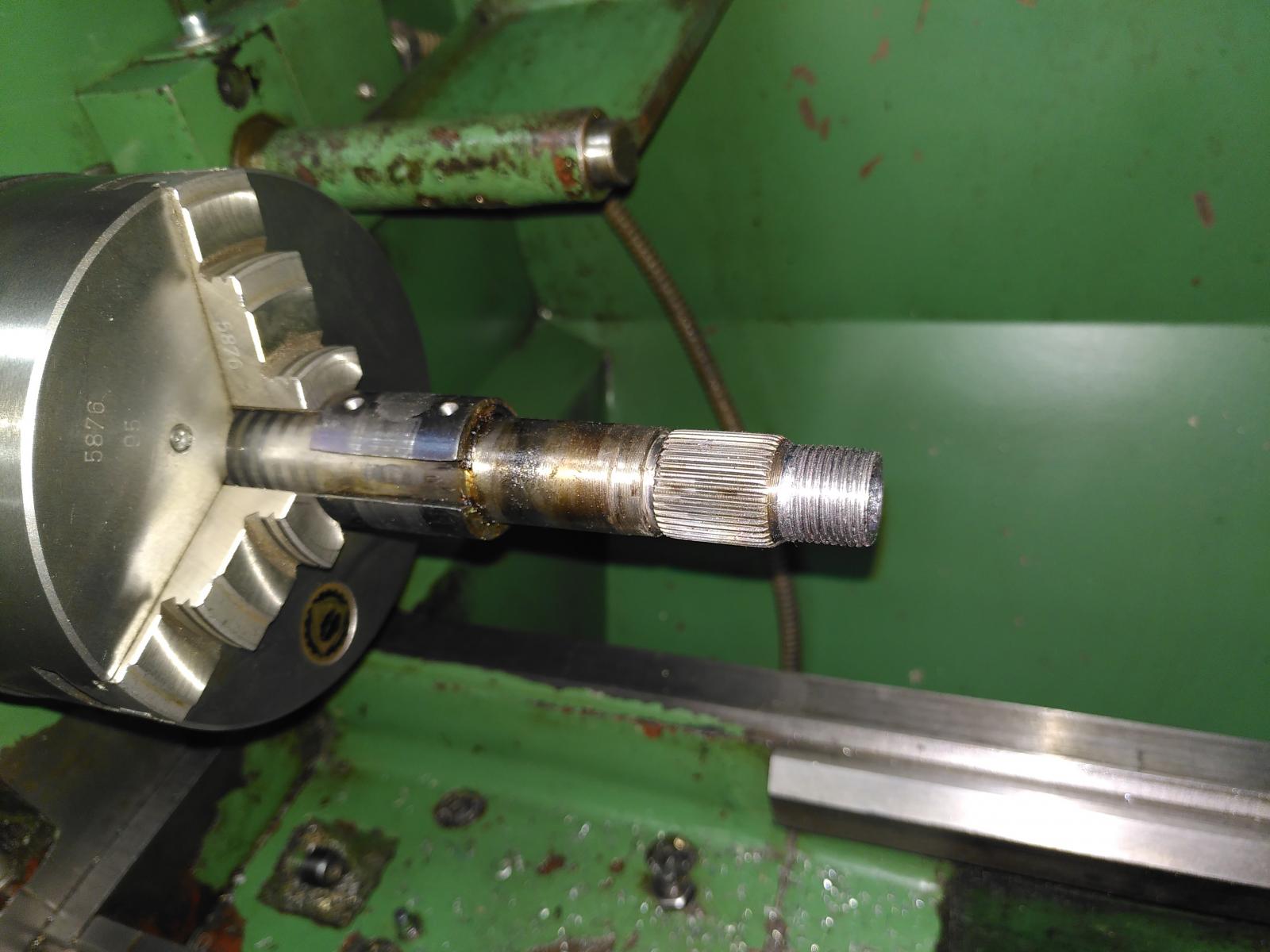

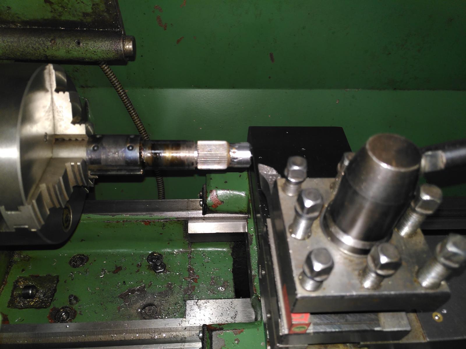

I started to do some minor work on my new project. First goal is to get all of the windows back in, because I need to be able to move it out side without the inside getting wet when it rains.
I disassembled and cleaned the door locks and reinstalled the window regulators.
I sanded down the rust on the rear window frame and treated it with Owatrol and Branthokorrux for rust prevention. This will need sometime to really dry toughly, then I reinstall the rear window temporarily.

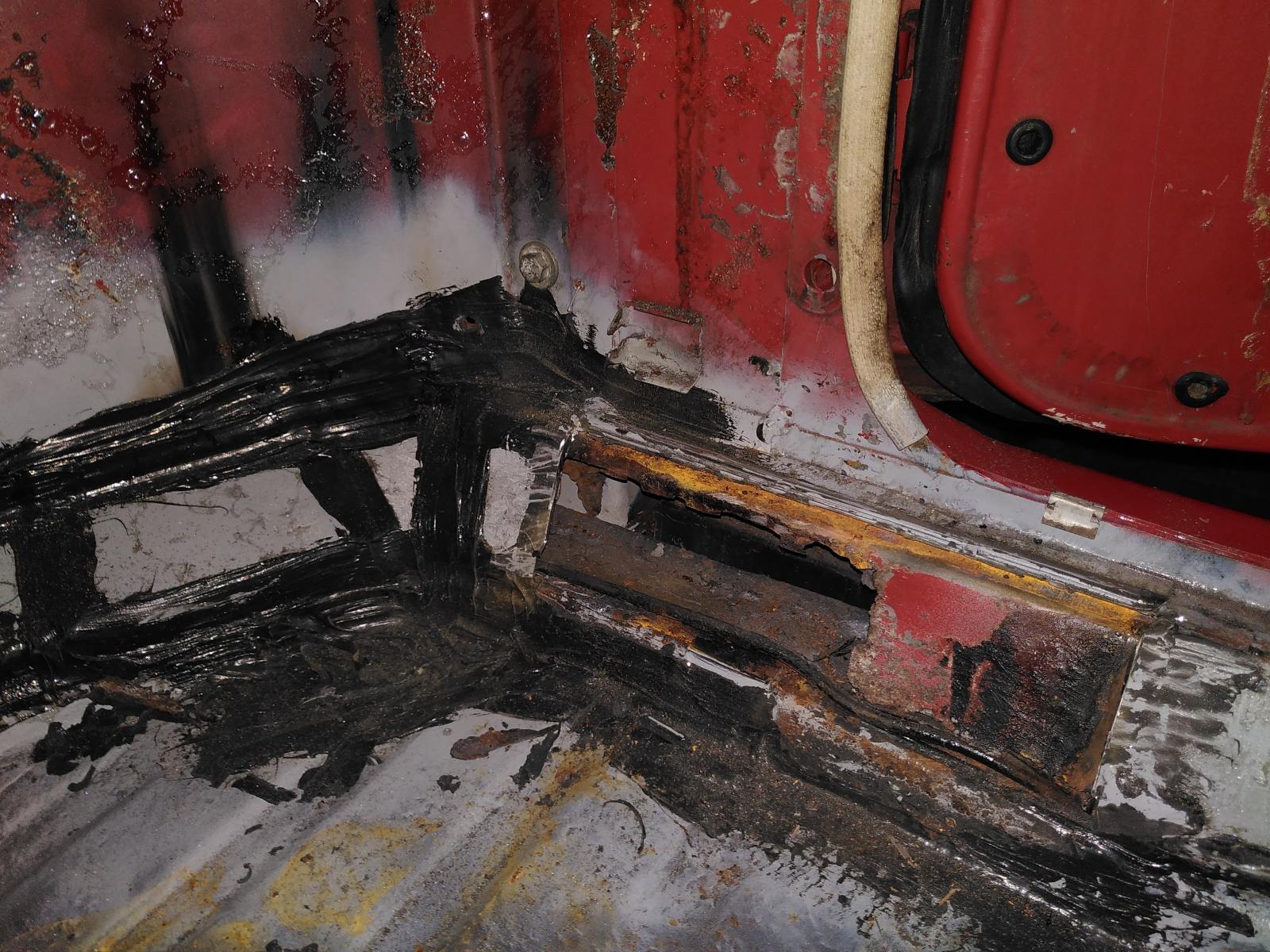

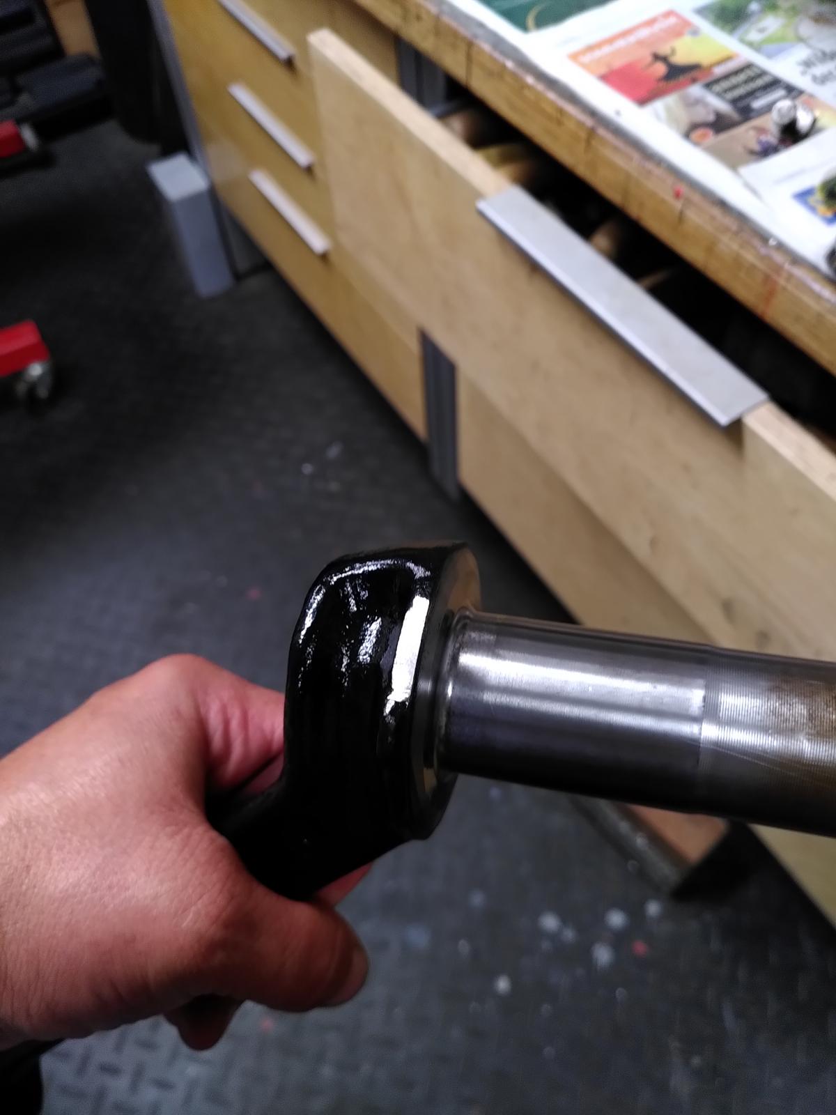

I removed the steering column because some one had stripped the threads. Welded new material to the column and then turned it down to the right size on my lathe and used a M18 x 1.5 dye to cut the new threads.
I also did some exploration into one of the POs patches. Unfortunately it looked worse than I had hoped for. I have a complete left rocker clip but I will have to rebuild the right side myself.
On the positive side, my dash looks really clean, even the original pad is un-cracked.
