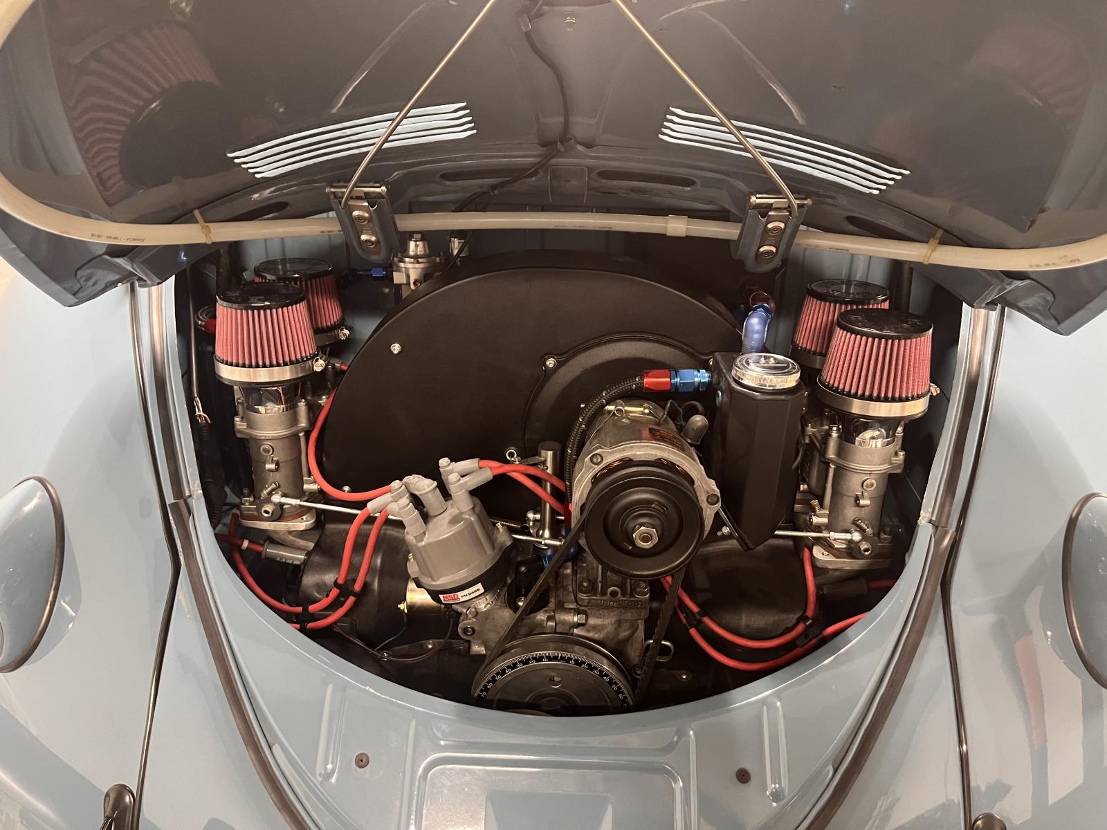

European style centre mount air cleaner from BAS etc with built-in runners or alfa romeo drla factory 90 degree alloy carb castings to some cotton gauze or foam filters or centre air box as alfa.
No ram pipes needed for them.

booties are ok for trailering. They keep the big pieces out and don't cause condensation underneath. I would not use them if I was trying to make any kind of HP, especially on an engine I had invested a considerable amount of money in. Something used in racing gets constantly torn down and rebuilt. Something on the street is a must to have an air filter, even if you have to build a custom one.

Yes, I use the Outerwears I bought just to avoid anything falling in the carb throats when I do maintenance work on the engine. I did a one to one test with and without booties and you can clearly see that it messes up the AFR as they don't breathe enough.
I am now using Gene Berg's stacks with the matching small air cleaners. Fits under the hood and give a relatively good filtration. In addition they are very easy to take off for carb adjustements.
