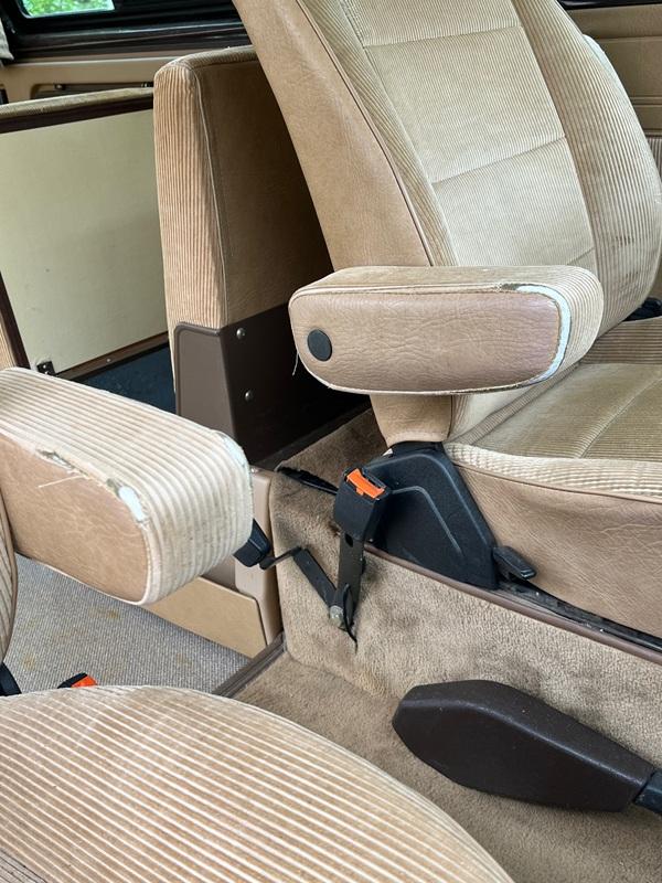

I got a closer look at the interior today and I will definitely be swapping in the seats and smaller bed from my Syncro, which is still a work in progress. The original fabric is pretty "delicate" and I am afraid more use would only make it worse. I will store them away for any future owner/need. The syncro's material is in great condition, so an easy decision.
Syncro door panels are also in better condition, and I swapped them too so the material of the seats and door panels all match.
I also ordered a new carpet set in the original caramel color.

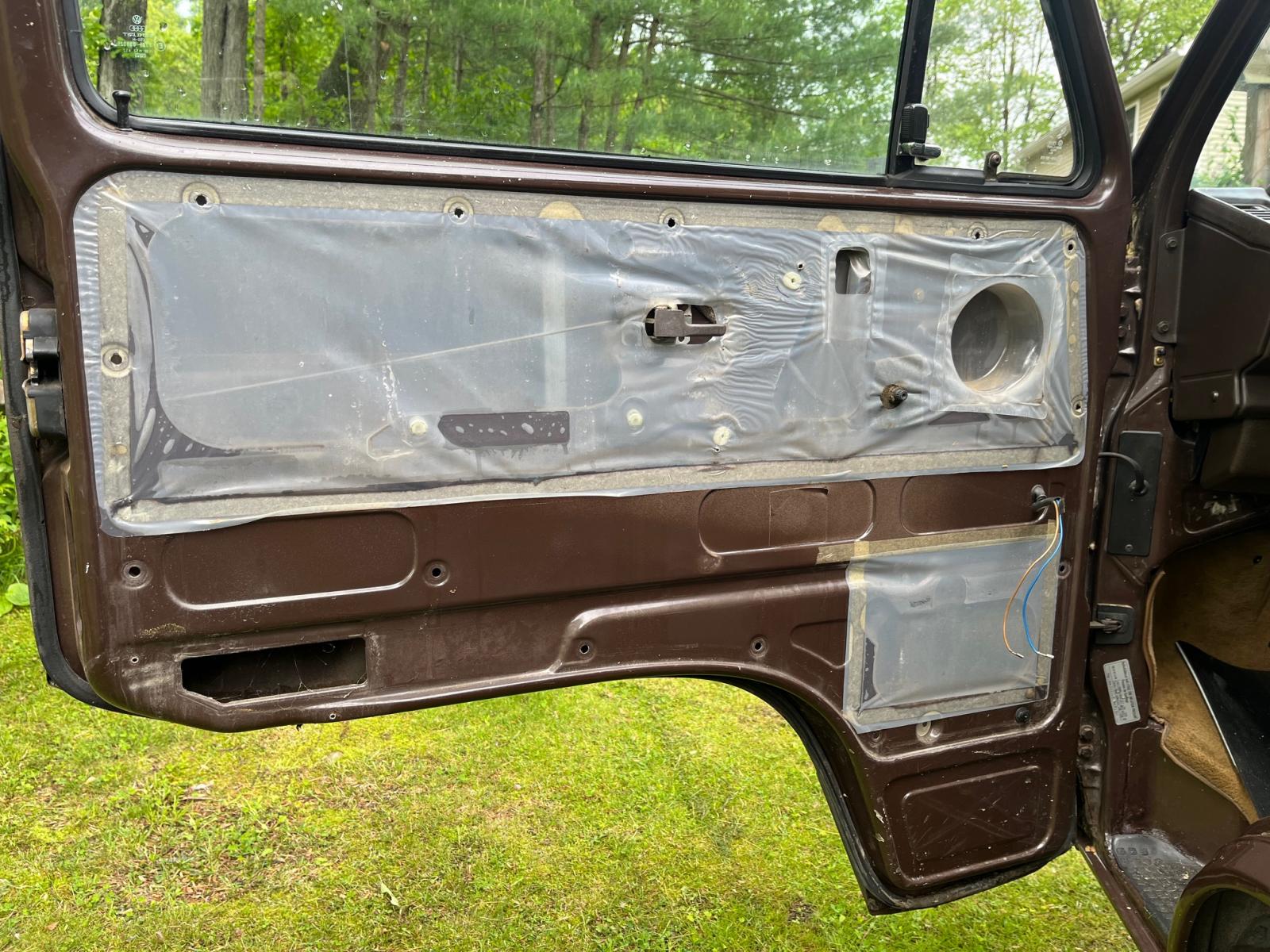

PostPosted: Sat May 24, 2025 9:38 am    Post subject: Re: 1986 Wolfsburg Weekender Intro and Chronical Reply with quote
Door panels and seats swapped. Nice to see an intact vapor barrier.

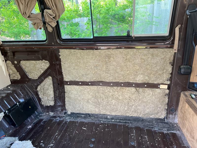

PostPosted: Sat May 24, 2025 9:48 am    Post subject: Re: 1986 Wolfsburg Weekender Intro and Chronical Reply with quote
Removed the weekender interior. Now I need to do some cleaning and a bit of rust treatment. I'm sure the ground to the ECU would have eventually given me issues. The rust will be removed and the metal treated with 3M's 3513 mar-hyde. I used to use POR15 but have found I like mar-hyde better. Once the mar-hyde dries I coat with Rustoleum oil based paint.
The fiberglass insulation will be replaced with HaveLock wool or something similar.

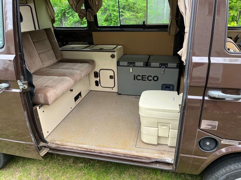

Started building out the interior, and yes, I will save all of the weekender pieces.
Swapped in the smaller bed from my Syncro project. Also swapping out the passenger's side trim panel. I like the smaller bed as it gives me more room f cabinet space, my Iceco frig/freezer, a cooktop and a portable toilet.
I chose to remove the fiberglass mat insulation and replaced it with Rockwool. I did some research, but searching for the best van insulation is like asking what is the best oil. In the end I feel the Rockwool will work just fine.
On the driver's side I used the side reinforcing rib to mount a piece of wood that I dado's a slot into. I feel between this and the floor I will have a solid place to build some cabinets.
Lowe's was able to color match some paint for the hardboard panel I made as a backdrop.

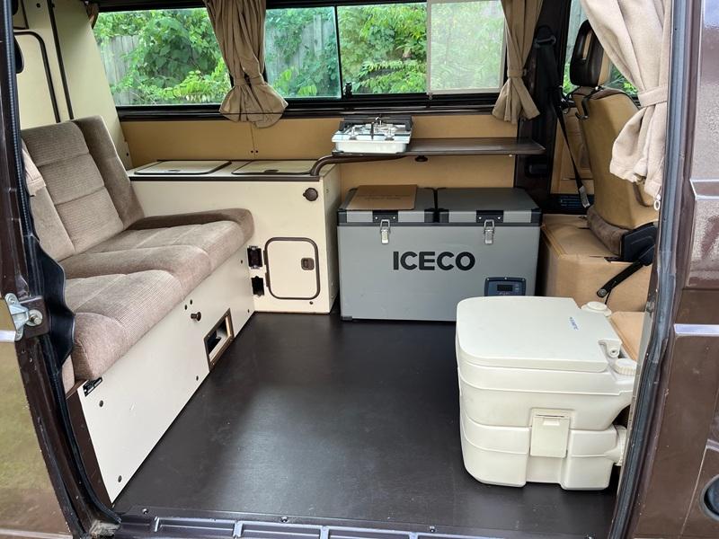

One difference I found between the weekender and the Westfalia camper interior is the rear locker. The weekender is smaller and doesn't have the wardrobe, but I like the better use of space of the weekender locker. I plan on using the extra space to build more cabinet storage or shelves of some sort.
Just mocking things up and seeing how everything will fit. The Westfalia camper cabinets are a great design, but I was looking for a better frig/freezer with more space, so that means modifications. I originally thought I would want a three-burner stove, but going this route will not leave me room for a sink. And I feel ultimately a two burner (front to back vs side by side) will be sufficient. Of course, the stove will be raised on a custom cabinet to a more manageable height. The frig will be mounted on sliders so I can pull it out when I need to get something out of it.
Still a lot to think about regarding wiring, my diesel heater location, plumbing for propane, running solar (300 watts on the roof), and long-term a roof mounted Dometic AC.

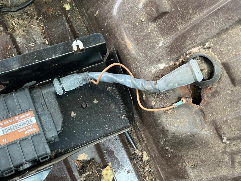

Ready for the new carpet from GW. I was happy to find no rust anywhere except a little bit of surface rust in the battery box behind the driver's seat. Any reason this battery would have been eliminated?
For those of you who have installed new carpet, have you put a layer of padding over the factory front rigid pad?

MSGGrunt wrote:
…Any reason this battery would have been eliminated?
Indeed…any reason at all. Wink
In this model van, this battery only powered the original small electric cooler.
If the cooler was not used, the battery was not needed.
It certainly could have been rewired to power lights, radio while parked, etc.
(search for posts regarding “fuse #3”) but that’s not what your OP did.

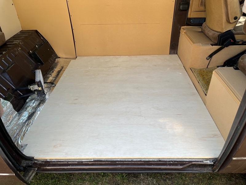

PostPosted: Sun Jul 20, 2025 11:26 am    Post subject: Re: 1986 Wolfsburg Weekender Intro and Chronical Reply with quote
The floor got a treatment of sound deadener and then foil backed insulation over that. The floor is 3/8" plywood. I had my local hardware store color match a quart of porch and patio paint to match the dark brown interior. Now I have to build cabinets for the Iceco Frig/freezer/stovetop and the Dometic toilet. The Frig/freezer will be built on a slide out so I can open the top compartments and then slide it back into place.
