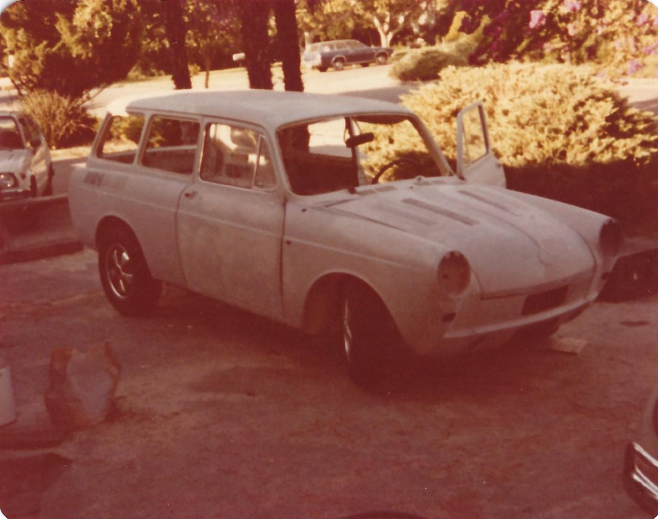

If you have so much torque that 3 gears are enough then simply choose whatever 2nd gear you want to use as your low gear, whether it’s a stock or aftermarket ratio and just skip first gear.

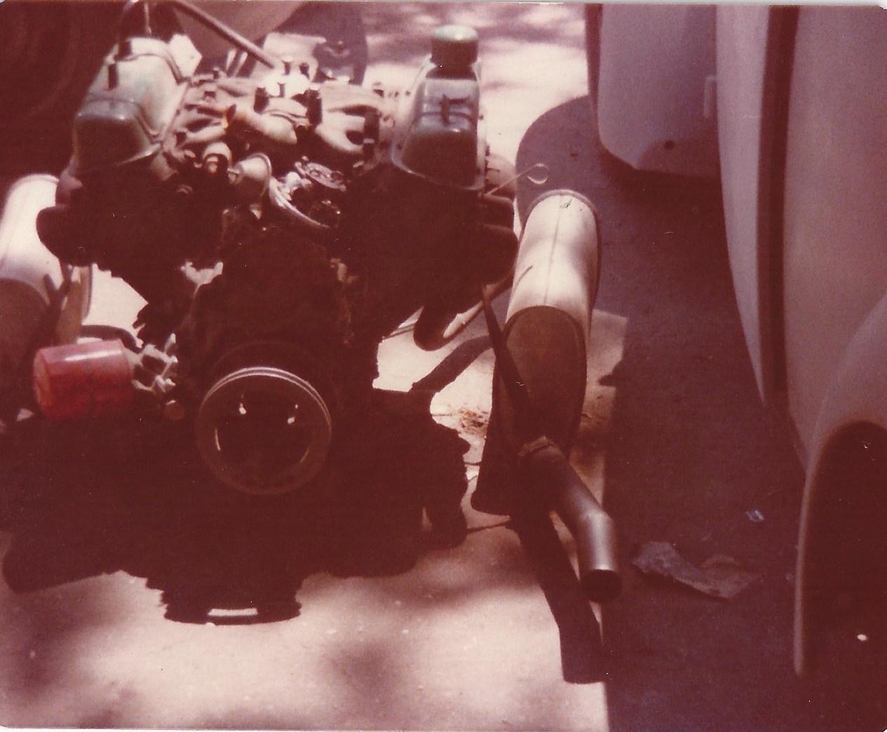

In 1979 I built a 1969 Squareback with a 1964 Buick V6 (225ci 155hp), the transaxle had a 3.88 R&P and .82 4th, otherwise all stock gearing. I would regularly drive it using 2nd and 4th only while driving around town.

I put quite a few miles on the ol’ Fireball V6 and it wasn’t particularly rough running at all. It was a good running engine out of a wreck I bought for $350 back when V6 engines were few. All the engine needed was a new timing chain set. My car wasn’t featured in the KEP catalog.
If you respected the transaxle it was plenty durable, mine had a Super Diff and an aluminum side cover along with welded 3rd and 4th gears. The KEP 1700 clutch was more than up to the task.
I learned a lot about engine swaps and body work, it was as a fun project and a great freeway cruiser.
