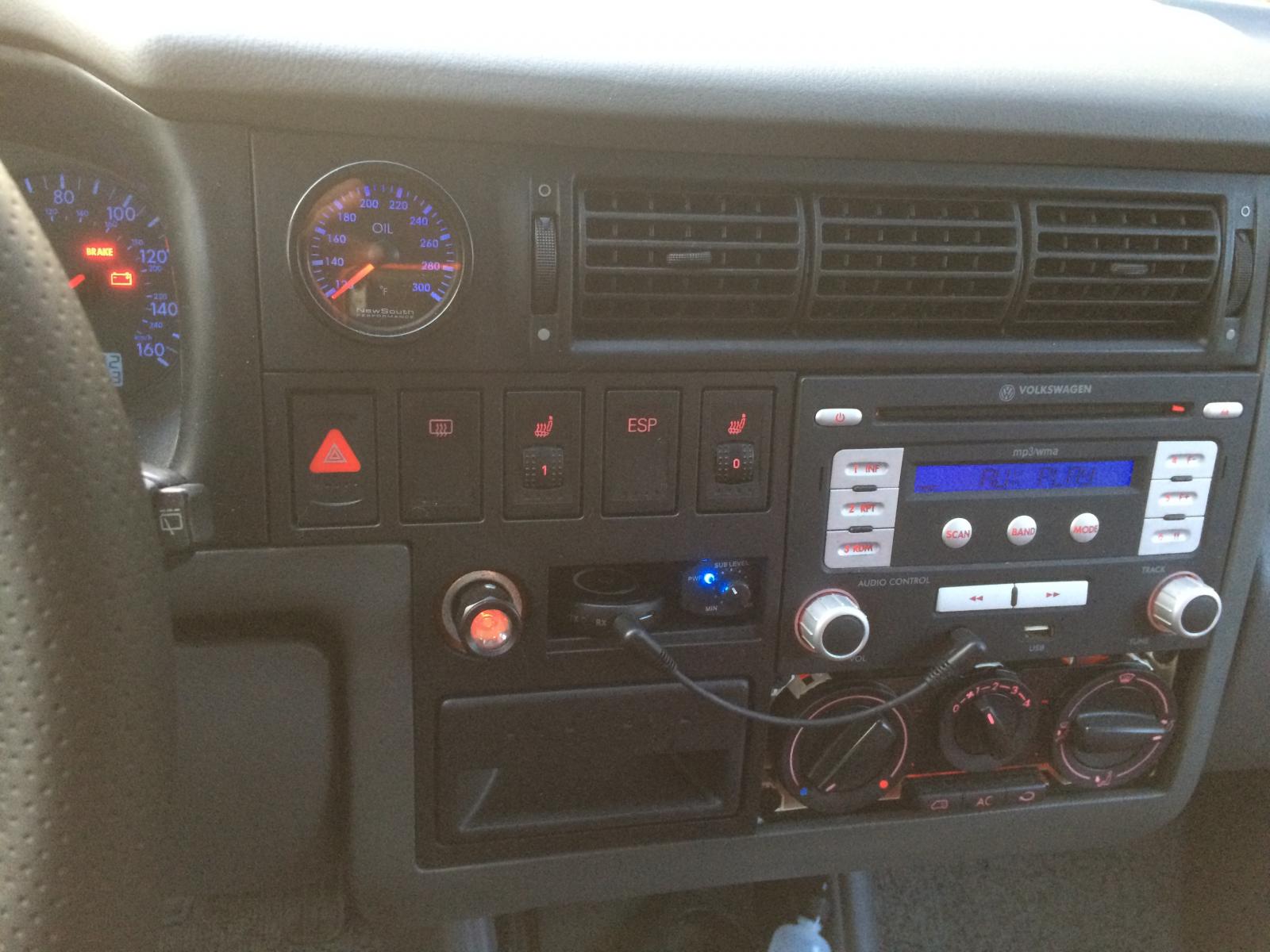

This year I installed a Nakamichi sub under the passenger seat (which is now a swivel seat by CNC in the UK). All new speakers (infinity brand) in the doors, dash and rear. I picked up a used golf City headunit for almost nothing and ran a GREAT ebay harness. I mounted the volume control for the sub in the otherwise useless pocket above the cigarette lighter and the bluetooth adapter is there, too. The sub is powered by the house battery.
One thing, the blue LED on the sub volume control is very bright so I put a drop of black paint on it so now it more of a halo. If I could do it again, I'd swap out the blue LED for a dimmer red one.
Since the photos were taken, the trim piece under the radio has been installed and a cubby installed, too. Many thanks to the folks on the forums who routinely post great, helpful information.

I like your hazard relocation to add the oil gauge, that is color matched no less. They do that over in Europe to add a boost gauge there.

Thanks. The added trans temp gauge is one of the many mods I stole from more knowledgeable forum posters. Here the thread on that mod:

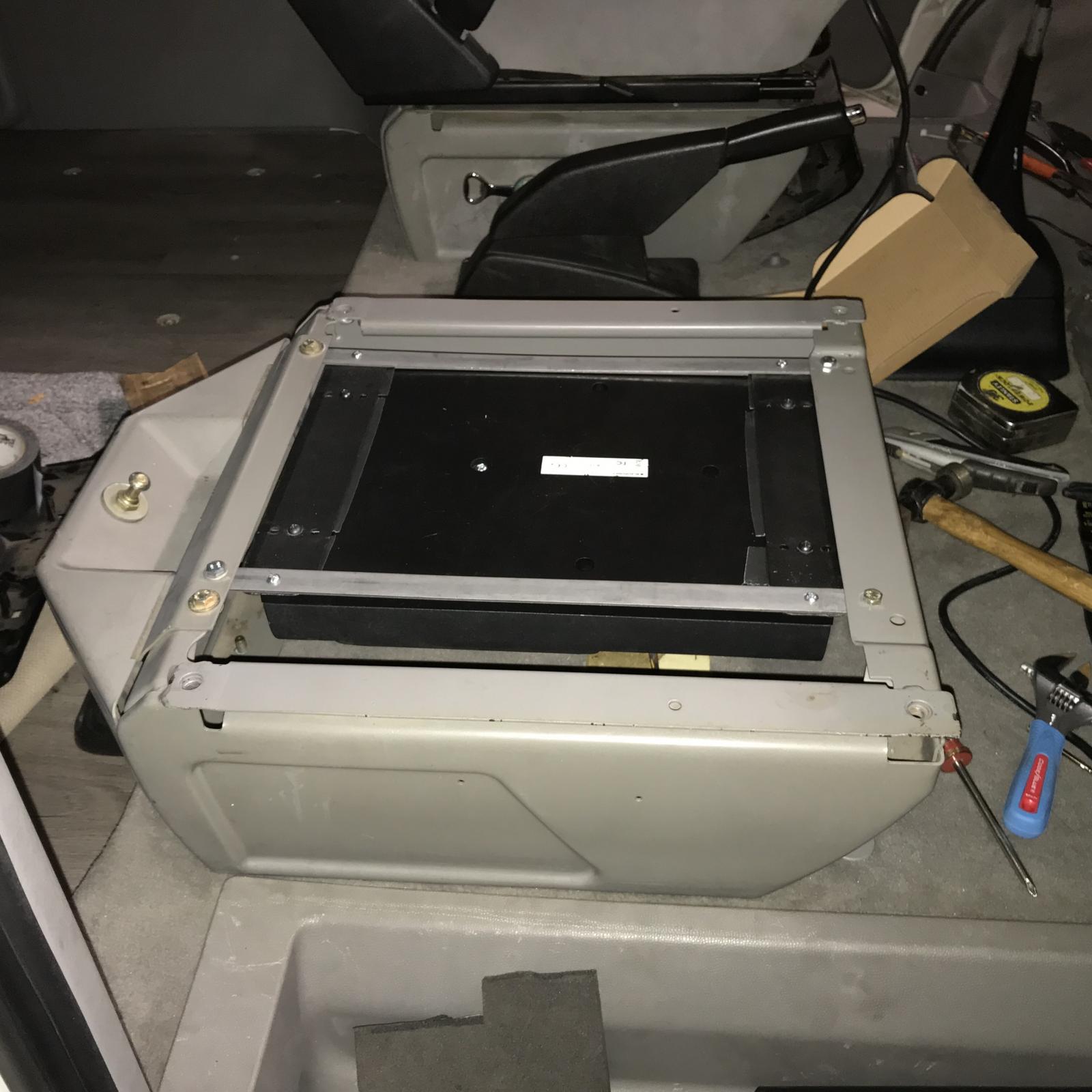

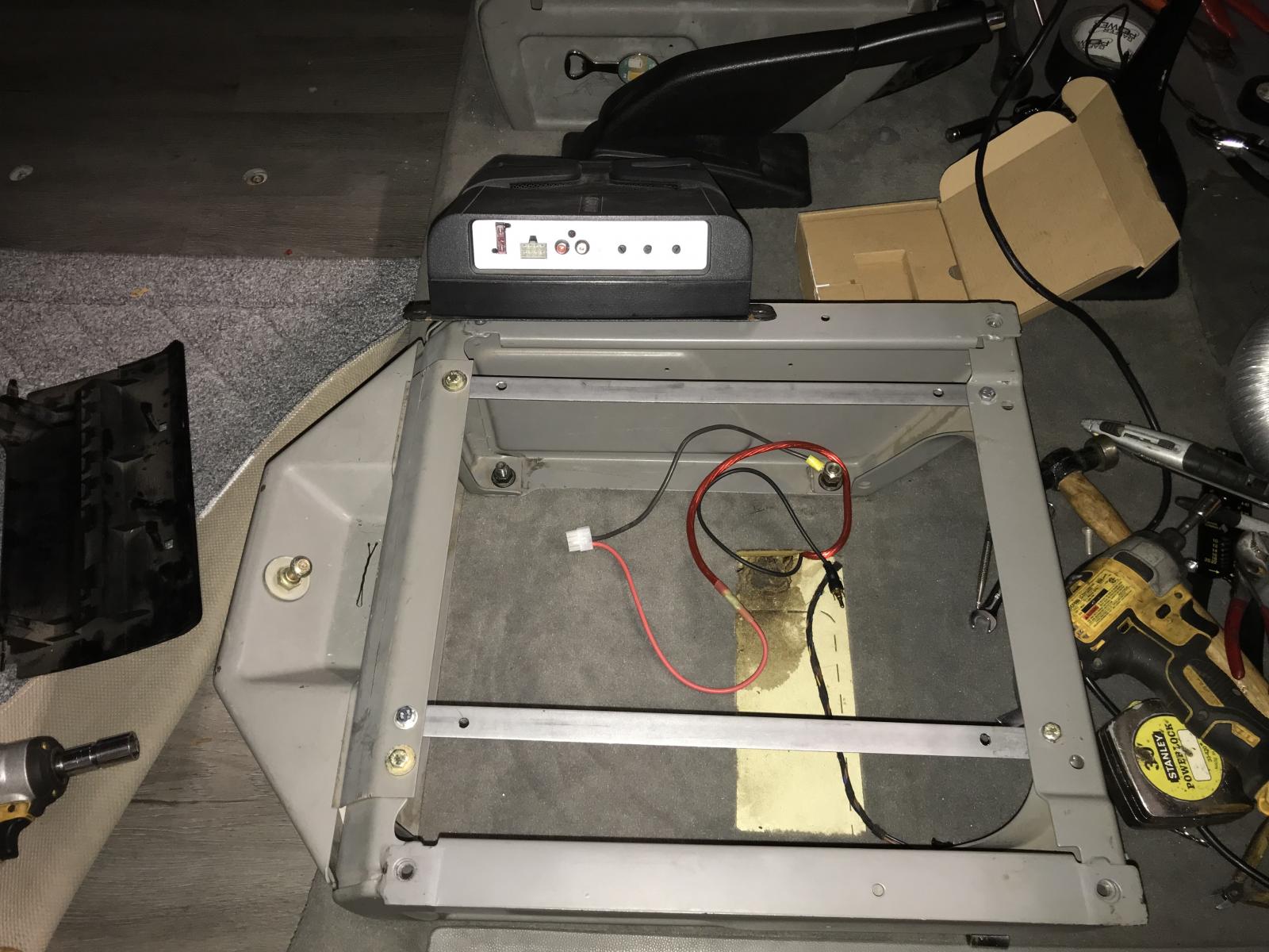

While installing my webasto heater I had the front seats out so, it was time to install the powered subwoofer in the passenger seat base. Here's an outline of my steps:
1) I routed the power with the other wires under the carpet from the Driver's seat base where my AUX battery resides, over to the passenger seat base. This was the easiest part.
2) Next I routed a single RCA cable from the headunit down to the floor, I had the console out already. I lifted the carpet up from the rear the best I could although it is glued down and this was a real pain in the ass. Then I fished a straightened out coat hanger from the console back, taped the RCA cable to the coat hanger and pulled it through.
3) The blaupunkt sub is auto power switching so no remote power was needed, just the main power and the audio signal ; I tapped a ground off a seat base bolt.
4) I suspended the amp with a few straps, 1/16" x 3/4" steel from Lowes.
5) Made a few adjustments to prevent rattles and then put the seat back on.
The sound is noticeably fuller, there is definitely more bump in the passenger seat but the whole thing is pretty tame still. All in all, this was an awesome $35 ebay investment. Here are a few pictures to save on the million words:

Hi Mark - really appreciate all your posts on your stereo install. Working to slowly get my van updated after purchasing a couple of months ago. Got a Sony XA100 installed last night and now just have the subwoofer and backup camera to finish. My sub is an aluminum body Blaupunkt GTHS81 which has some heft to it. I'm a bit nervous about the "feet" that mounted to the sub with tiny screws holding up in that configuration.
Was there a reason you suspended the sub instead of mounting it to a piece of plywood or similar on the floor? Was thinking I could secure the plywood using the same bolts that hold the seat to the floor, similar to the battery tray under the driver's seat.
Thanks in advance!

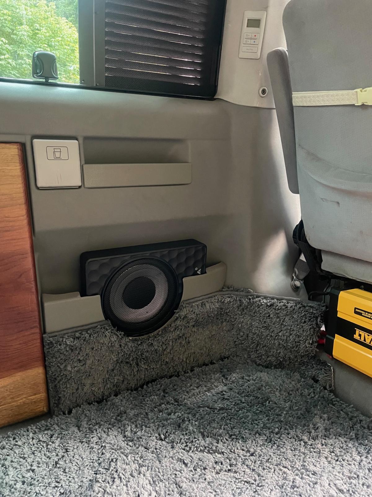

It's true the EV doesn't have a spare well or enough room in the rear 1/4's.
I thought this side pocket was damn near useless, so I took a sub I got off Amazon for the boat, and it fit in there.
Powered direct from the Lithium house battery, it has snappy response as a result. Previous owner had a shop do audio, so there is a decent amp under the pass seat, and speakers are upgraded too. Sounds great with Apple Carplay, wifi fidelity.
