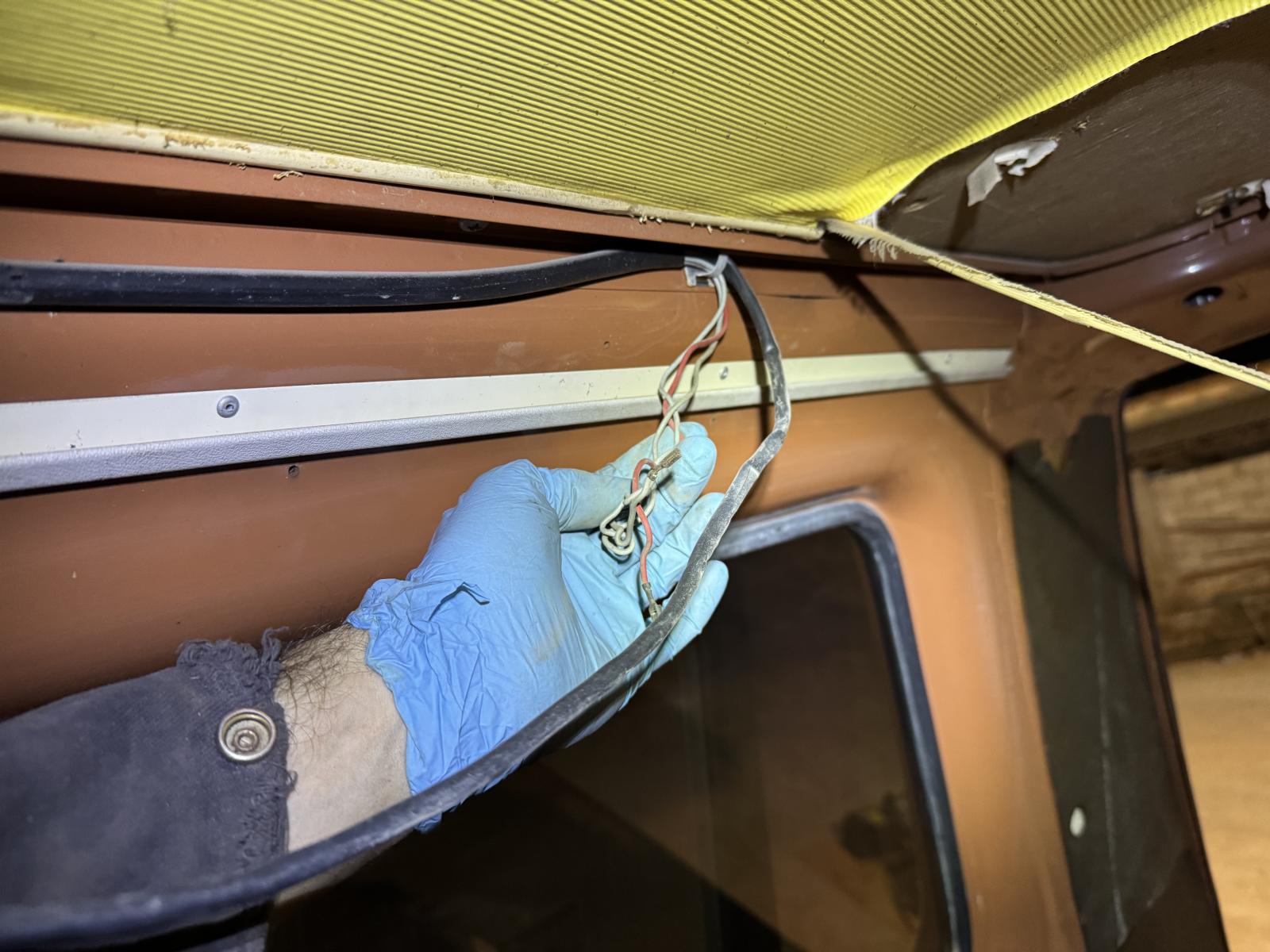

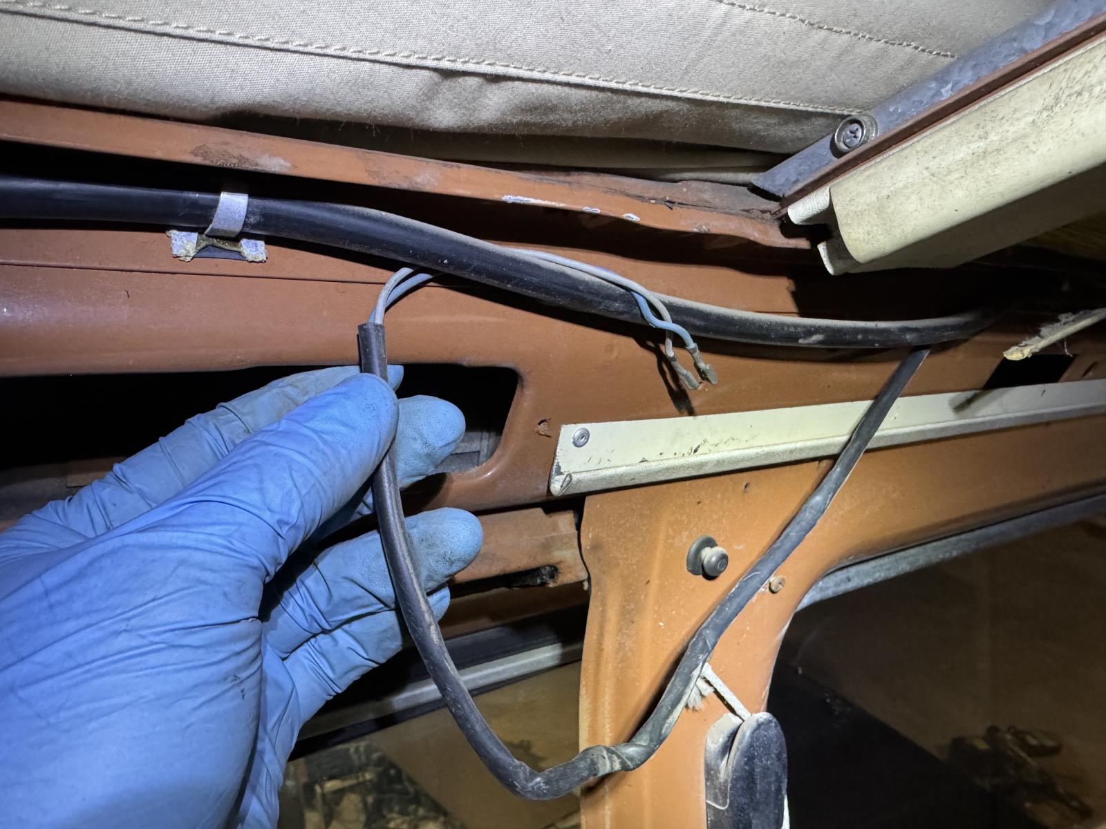

Hi, there.
I took out the Dash to fix the heat core, meanwhile I found a 3 cable loom going from the dash, going up the A pilar, and back to rear cabinet area. Seems to me they were courtesy light? Does someone have any knowledge about them? Where should I connect them?
I would appreciate any help, thank you!
Adel

PostPosted: Sat Jun 21, 2025 4:34 am    Post subject: Re: Mysterious lonely cables Vanagon Westfalia 1982 Reply with quote
97% those are rear speaker wires.

PostPosted: Sat Jun 21, 2025 5:26 pm    Post subject: Re: Mysterious lonely cables Vanagon Westfalia 1982 Reply with quote
Seriously? Brick wall
Mark, huge thanks! I was braking my head trying to figure out what they were for. Never went through my mind that they could be speaker wires but now that you mention it, makes a lot of sense; distance, position. Etc
I appreciate it!

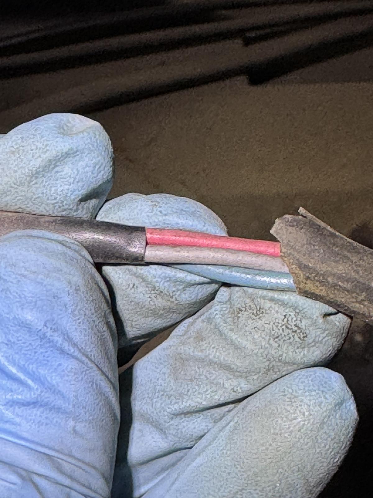

PostPosted: Sat Jun 21, 2025 5:36 pm    Post subject: Re: Mysterious lonely cables Vanagon Westfalia 1982 Reply with quote
I’m not a stereo person, but VW originally shared the ground between both rear speakers, hence only 3. My understanding and newer stereo heads use separate grounds for L and R. There are ground splitters I recall reading, but running new good quality speaker wire now would be easy.

PostPosted: Sat Jun 21, 2025 5:48 pm    Post subject: Re: Mysterious lonely cables Vanagon Westfalia 1982 Reply with quote
Very interesting, I wasn’t aware that is better to have separate grounds for speakers.
As you, I have never given much interest in stereos or music, but since my wife loves music; I rather give the extra mile, add new cables and let those ones for extra illustration.
