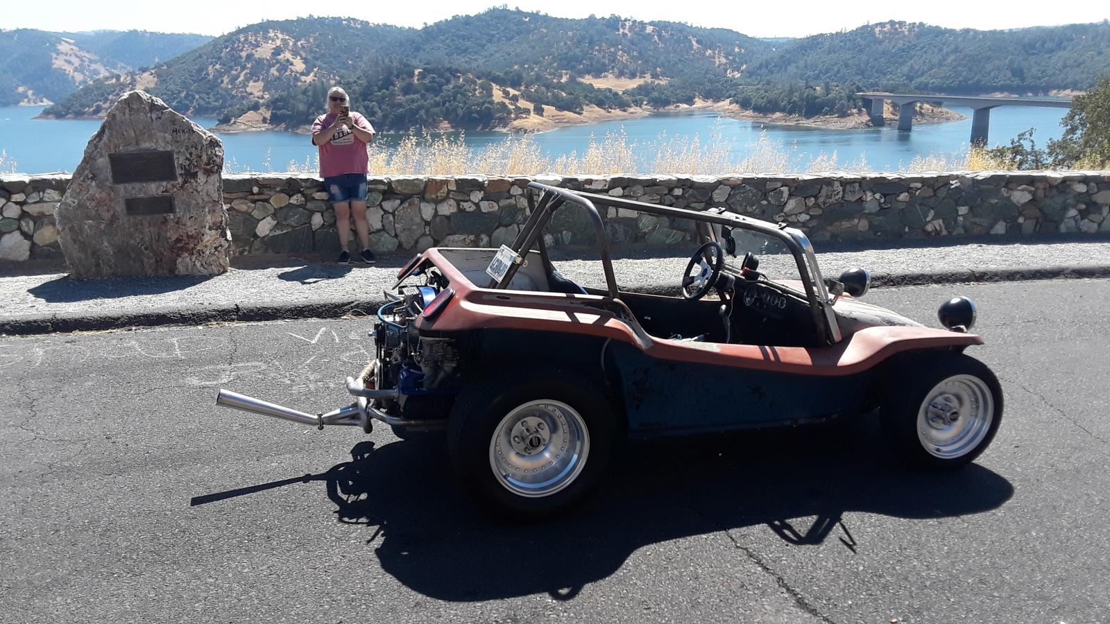

I have 165 80 15s on the front of my Buggy. Very happy with the improvement in handling and directional stability at speed and the decreased steering effort in parking lots. I just wish my rims were a bit narrower, I worry about curb scuffing these ones.
I went front 215 50 14's to 165 80 15's so taller and narrow. The ride quality is much better too.

My 165 80 15s are on 7" rims. I was told it could not be done but my tire guy said no problem and there they are... in full living color. I wish as I said before that the rims were 5.5 or 6" but they are not.
Do you have a tube in those? Crap man, the rim is wider than the tires’s designed section width!
I once had P135R15 tires on 5 inch rims, that’s just under the section width, and they looked stretched out at the bead. My current rear tires are 225/70 on 8 inch rims, I told the shop they were 7.5 inch wide and they didn’t check.

Do you have a tube in those? Crap man, the rim is wider than the tires’ designed section width!
I know eh?! That is why I am concerned about curb damage. I really want to stick with genuine Fuchs wheels on this Buggy and those were the narrowest I had. I would be happier with 5.5 or 6" and I am keeping an eye out for a pair in my price range.
No tubes. They look a bit like those rice burners you see now days with the fart can mufflers, extreme negative camber and the rims that stick way out past the tires and fenders. Kind of ugly actually... but not quite as bad.
