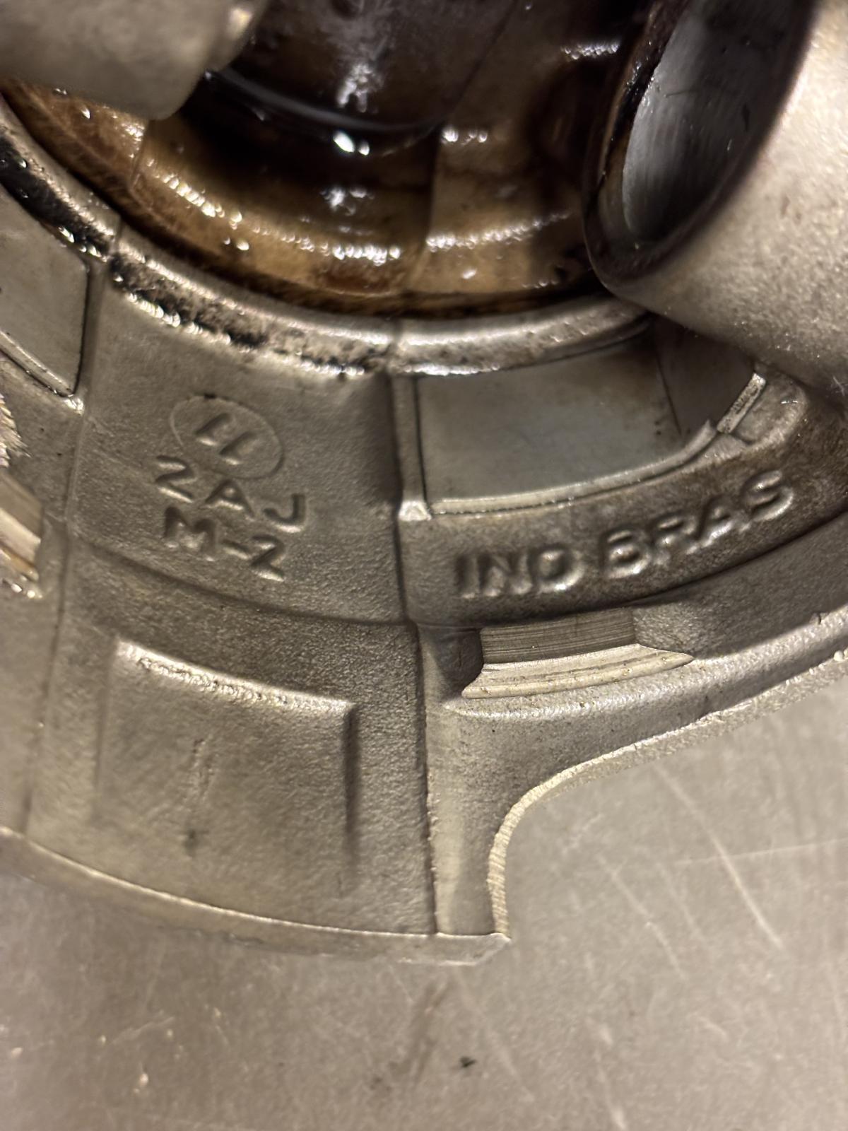

Came a cross a used set of 88mm slip in P&C
These seems to be thicker than the normal slip ins i have seen before.
If they have been machined down at the head register or designed that way i do not know.
Anyone have some info or seen these before
There is an old post on this forum about "VICSA" piston and cylinders.
Maybe this is what was used in the OEM Brasil 1679cc engines??

Looks like regular old slip in 88's to me
I've seen that U shape logo a thousand times before but for some reason I can't remember what it means
Do they use 1.5mm rings?

Isn't that a Mahle stamping?

AHA! it's METAL LEVE

bcrazy wrote:
Those are cast pistons. See the 2 metal tabs between the wrist pin bosses.

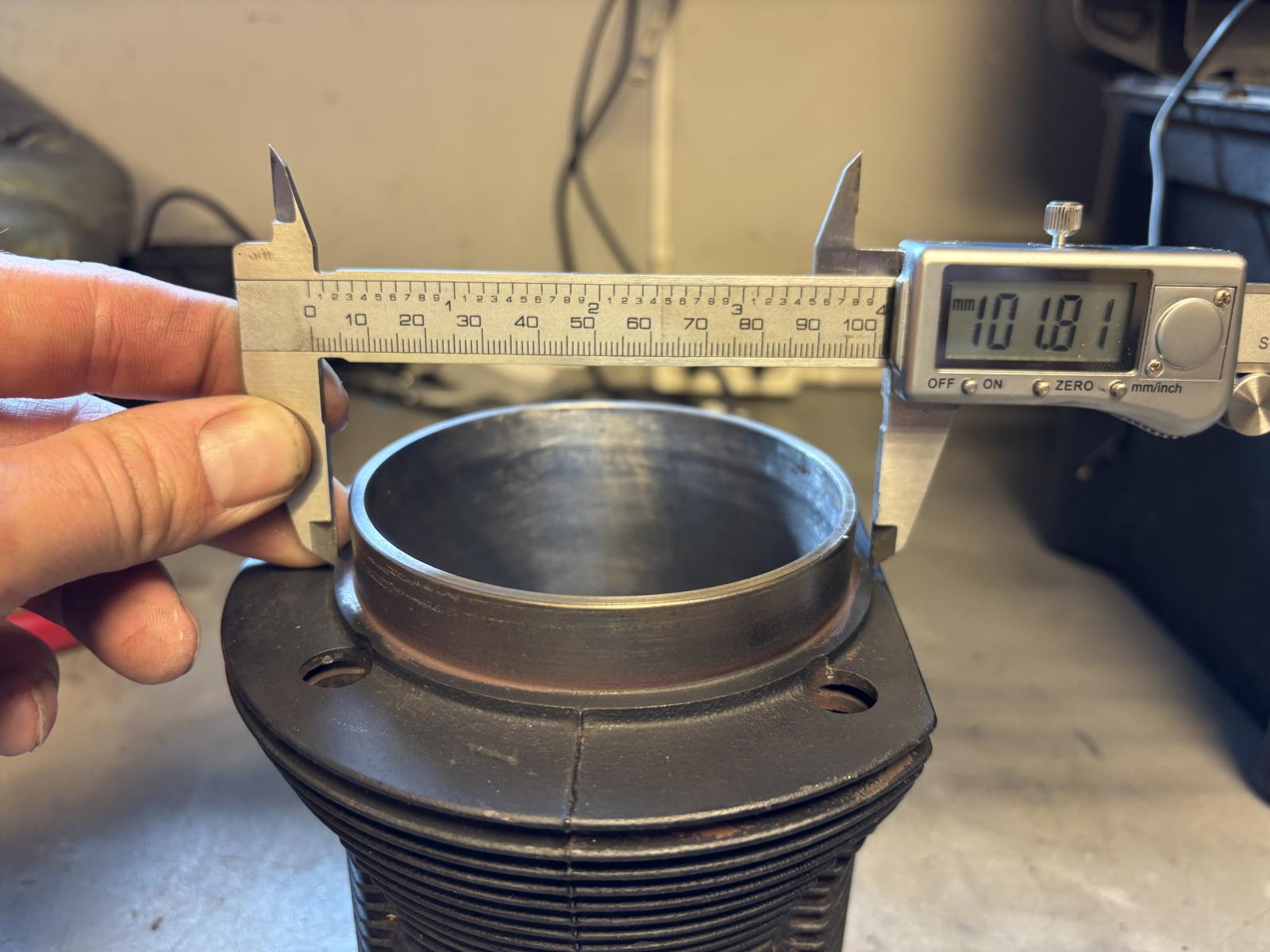

If someone has a 88mm slip in cylinder on the shelf, and could measure the thickness at the fin area, that would be great

The machine in AA's I have are not machined centred to the area you are talking about . varies from 9.5mm to about 7mm .

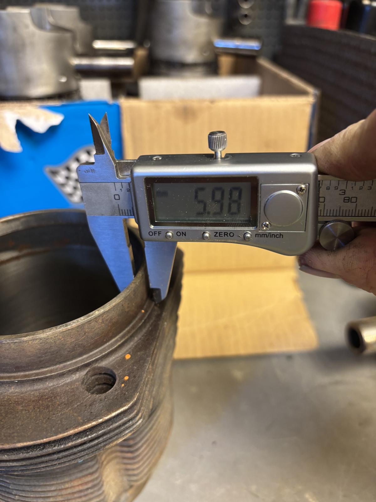

Got hold of another set of 88mm. No markings to suggest what brand.
The wall thickness of this set is about 0.6mm less than the one from Brasil
This suggest there might be some different spec 88mm slip in variants.
Would be interesting to see what wall thickness in the fin area 85.5mm cylinders have.

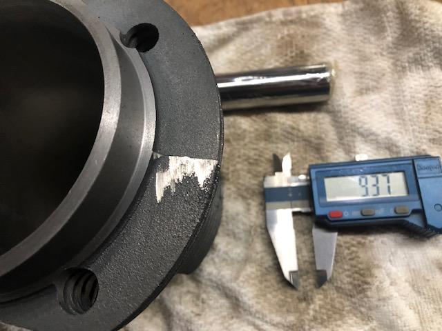

Here’s a coma set of slip-ins for sale for pic reference. The thick top 88’s are 5.25mm thick on top.
https://www.thesamba.com/vw/classifieds/detail.php?id=2656981
