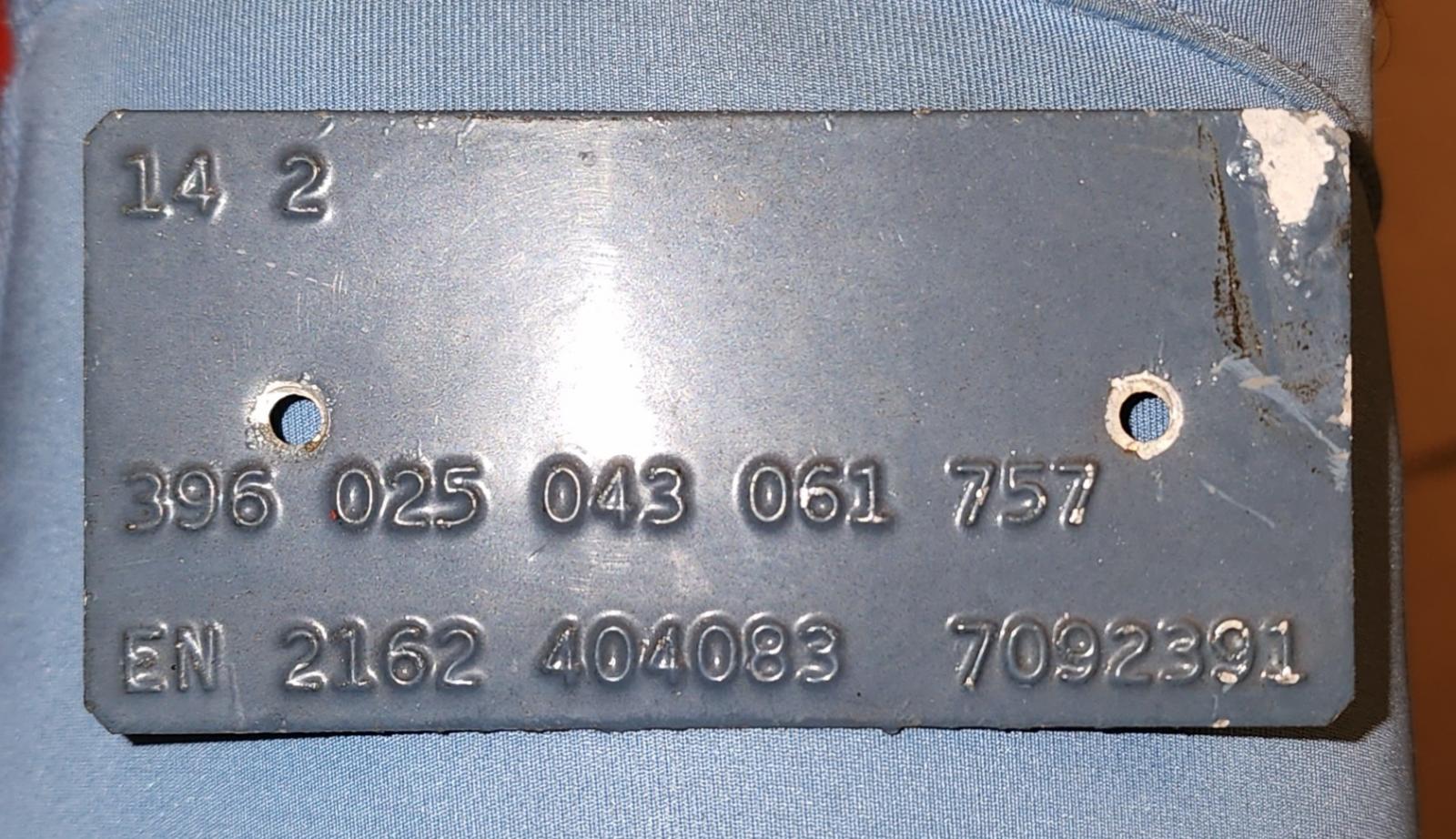

I have just started restoration of a 67 Double Door Panel Van.
M Plate shows 757 and cannot find info on this.
Anyone any ideas please?
Cheers Len

PostPosted: Thu Jul 03, 2025 11:03 am    Post subject: Re: M Plate help Reply with quote
Information on this site shows it limited to 1966-7 but found on Kombi’s, Deluxe, High roofs and even a single cab. Sounds like something common to many models of 1966-67 Bus’. All appear to be European model delivery.

PostPosted: Thu Jul 03, 2025 4:18 pm    Post subject: Re: M Plate help Reply with quote
Yes, it looks like it's unknown but seen on various Buses.
It appears that a ton of the 700 series M-codes are unknown so perhaps those are not well documented by VW

PostPosted: Thu Jul 03, 2025 5:22 pm    Post subject: Re: M Plate help Reply with quote
700s look like a lot of things governments, agencies or commercial customers would want.. lots of high roofs, ambulances, trucks.
Look at your bus for anything that seems interesting or different than other examples online, or that feels 'government' (tho original tires like in M710 are no doubt long gone).

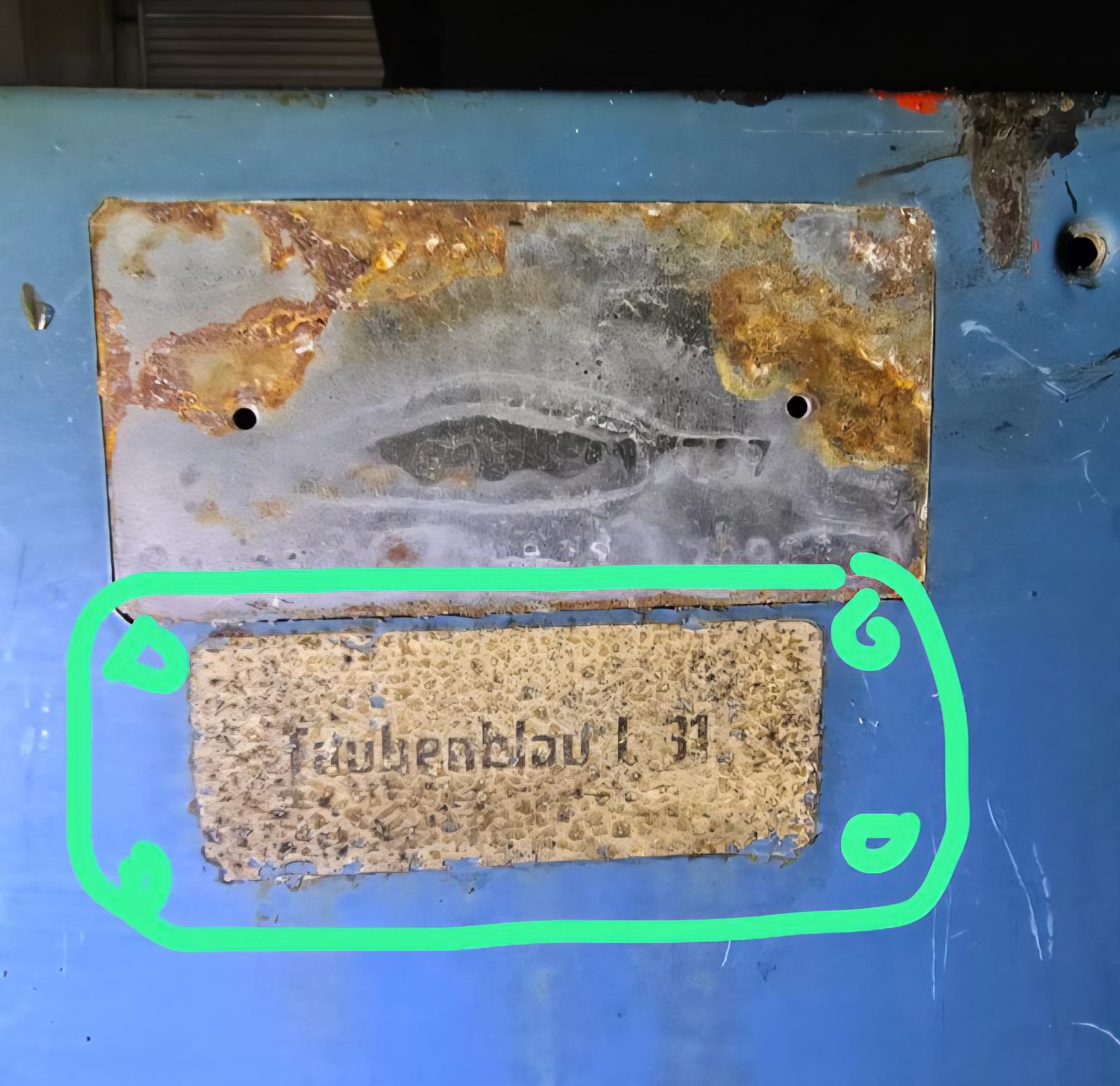

It's a UK delivered Van.

tasb
The Distributor Distributor
Joined: April 27, 2002
Posts: 6854
Location: Pentwater, Michigan
tasb is offline
PostPosted: Sat Jul 05, 2025 4:46 am    Post subject: Re: M Plate help Reply with quote
Taubenblau= L 31 Dove Blue. It’s obvious that the color sticker is applied to that same body color. Most two tone Buses have a sticker that lists both colors. Yours lists just the one. So if the Bus has just white on the top then perhaps the unknown M code indeed signifies the white roof. Proof would be finding the other 757 Buses and determining their original roof color.

PostPosted: Sat Jul 05, 2025 9:22 am    Post subject: Re: M Plate help Reply with quote
396- prepared for Great Britain
025 - safety belts
043 - swiss license requirements
061 - Seen on '67 RHD Kombi and '67 RHD Deluxe, both delivered to England. Seen on '67 RHD Canterbury Pitt Camper
En - England
2162 - double doors left and right
404083 - not an expert, but that looks like dove blue sides and top, and mesh grey upholstery
So apparently the roof should be blue, and it may have been sent to England for a camper conversion (or camper company liked using that variation?). Maybe the 757 is 'buyer changed mind on roof color...'
