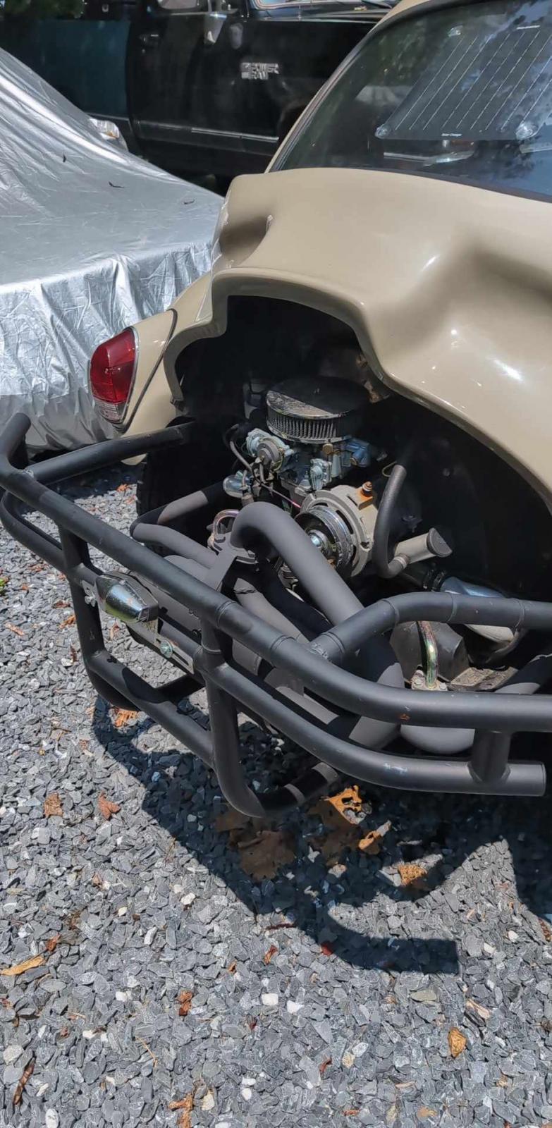

Good morning everyone! Thanks for letting me join the community here.
Never had a Volkswagen before. I have some classic Datsuns, Toyotas, and I've spent years around old Land Rovers. Recently somebody offered me this 1969 Baja bug as a trade for something I've been selling on marketplace. I think it looks awesome. I'm going to go up and have a look at it this week, but I was hoping to get some advice on what to look for... Trouble areas... Things that stand out to you guys as good or bad... And try to ultimately determine the value on this thing to see if it's a good trade.
I have a couple photos. The seller sent a video and it sounds like it does all the right things from a cold startup. Thanks in advance for any feedback or suggestions!
Cheers

Well, it's a later-than-1969 dual port engine, so I'd say at least 1600cc. Has alternator, and looks like a progressive Weber carburetor.

That's a nice looking Baja build there. It has an alternator which is considered by many to be an upgrade over a generator. It also has a Weber carb either a 32 36 or a 38. I have one of these on an old bmw 2002 I have and they are easy to work on and parts are available. Some say they do not work well with a stock VW motor and are better suited to a built up motor. I can't say as I have never run one on a bug. I would check transaxle operation and cv joints condition as big tires and off road operation can be tough on those. As for value, it is worth some money and I would search the samba classifieds to establish a base value for a build as nice as this one. Good luck Bob

Thank you both. I'm grateful for the insight, suggestions, and observations. Always wanted a bug. Never considered a Baja bug. Sort of excited about this one.
Trying to learn here. Are the inboard bug eye lights desirable or original or classic? I see some that have inboard bug eye lights. I see some that have outboard fender lights. I imagine it's different kit makers, etc, but I'm curious if anyone could shed light on the headlight differences.

The headlight placement is by kit design. My 69 Baja had the headlights in the fenders by design.
Both of the above design headlights work well. It's just a matter of taste IMO.
69 is a desirable year for a Baja as it has the IRS rear suspension.

The limited views in the photos also portray a decently done car. All visible panels are painted in body color, no obvious smashed panels nor rust. This Beetle has 5-bolt aftermarket wheels known as "BRMs". Normally a 5-bolt wheel ended with the '67 model year, and '68+ went to 4-bolt steel design for US-spec Beetles. This was a decisive effort to make the Beetle appear older but it works well. 5-bolt wheel vehicles were never offered from factory with front disc brakes, but in the last ca. 2 decades aftermarket suppliers have sold disc brake kits for these "wide 5" style wheels.
4-bolt steel wheels were used by the factory on '67+ Karmann Ghias which received front disc brakes. The axle spindles from a disc brake Ghia bolt directly to a '68+ Beetle, but this '69 would not have a Ghia front disc brake setup unless the PO installed "4 to 5" converter plates to the disc brake hubs.
This "narrow eyed" Baja kit is the original style, whereby one of the first, if not the original kit was developed by and sold by Miller-Havens
Enterprises in the late '60's or early '70's. The company was headed by successful offroad racer and race car fabricator Drino Miller and with Sanford Havens. I don't think your rear fenders are from an original kit, as yours extend farther downward. Original Baja kit rear fenders tended to be cut higher up, with a "spoiler" type upward lip. Regardless, the kit on this '69 looks to be nicely done.
The narrow eye design may have been forced to go to a "wide eye" possibly due to some states enforcing road laws about minimum headlamp separation distance. Seen at night and from a distance, an observer would not be able to discern if the vehicle coming at him/her are two motorcycles riding close to each other, or that the vehicle is actually farther away than actual. The wide eye Baja kits utilized near-stock factory headlamp separation width to ensure conformance to such road laws.
The front seats are also not factory stock. You can see a separate headrest and 2 support posts. Factory seats had headrests flowing into/integrated into the seatback with no separate posts.
If you inspect the car in person and take more photos as advised above, also of the interior, we can provide pertinent comments for your benefit to help with your decision of the trade.

Thank you all for the tips and insight. We were able to make a deal which included some cash on top of the Beetle to make things equal. She's home and I'm proud to have already had the privilege of wrenching on the carb. Looking forward to giving you all a rundown and we can see how we did. Happy 4th!!

I really like that bug eye baja. Baja is a niche, and the bug eye is a niche within that. From the few pictures you posted it looks like a clean and tasteful build by someone who cared about the car and the esthetics. From the reflections in the paint it looks like the paintwork was cut and buffed, which is not common for a Baja built for abuse. The chrome is clean. The BRMs are a really nice street wheel to see on a baja. The tires are a reasonable proportion. I bet this one has seen nothing but pavement. Good find. Enjoy!
p.s. further gawking I see the fiberglass panels are very well aligned, and there is fender welting between the fenders and the body, like a street build. Lots of baja are built for playing and dont show this attention to detail. A very nice street baja. My suspicion is the interior is nice too. I think you got the better part of the deal, this is a bug worthy of the focus a Landrover fan will give it.
