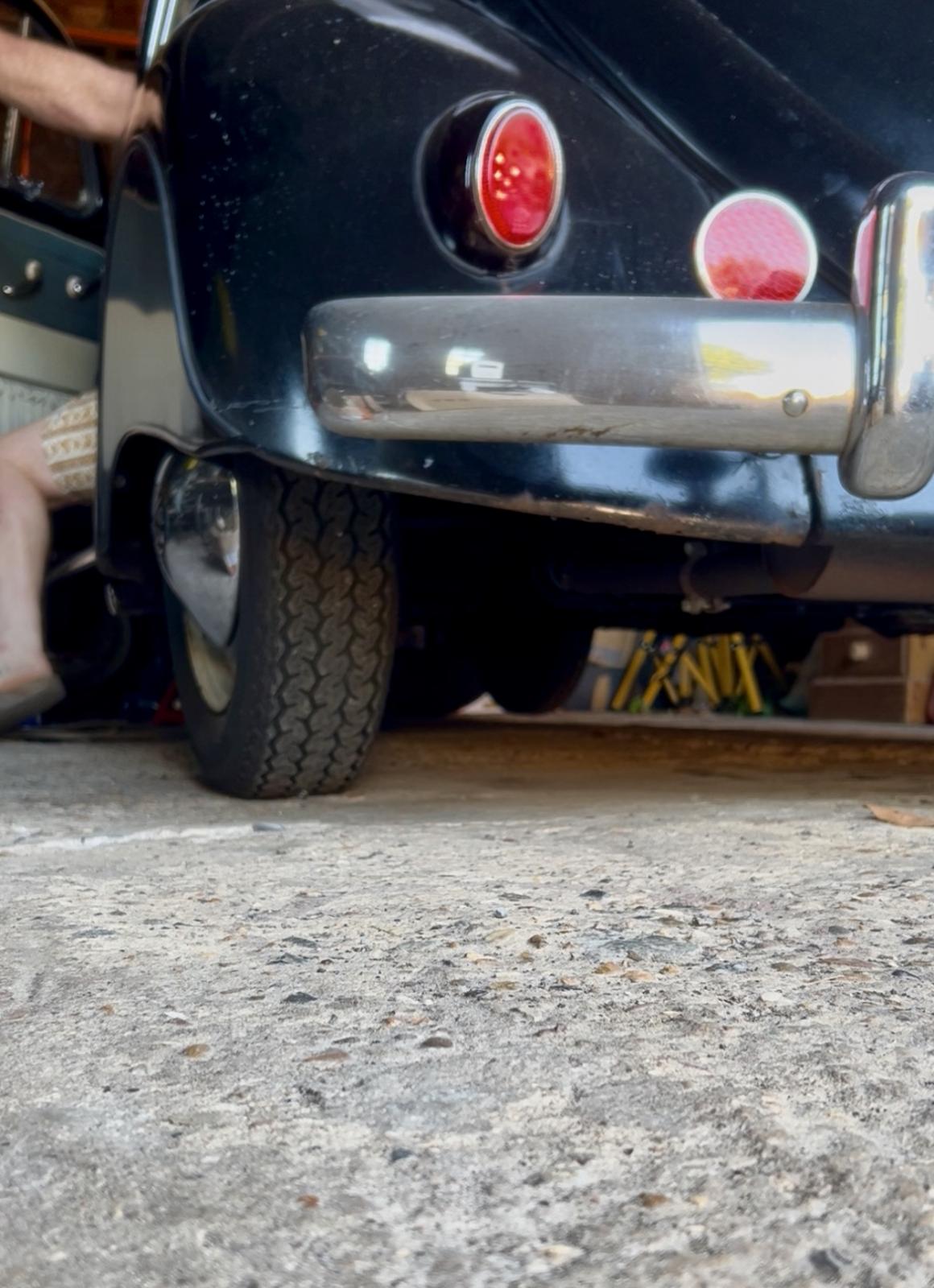

For a lot of early Swedish beetle's it was mandatory to have 2 reflectors on the back of the car. It is something my beetle has been missing. I was lucky enough to source some from the Netherlands recently.
I was basing the mount off a few pictures I have seen online and phots i have taken of other Swedish import cars.
I managed to knock up a few brackets this evening. I am yet to drill as I am waiting on the reflectors to gauge the height. The gauge is a bit thinner but seems to be quiet stiff.
If any one has some more information on them that would be greatly appreciated. |

Did South Africa have the same rules as Sweden in the 50s for the twin reflectors? It would be great to see some photos. `
I had been searching for the Swedish (mid-late50s) specific reflectors for the last 8 months and had not found any that were the same in UK & EU. Id id see some in the US but they were priced much higher.
Some of the early split beetles had them mounted on the rear fenders near the tail lights.

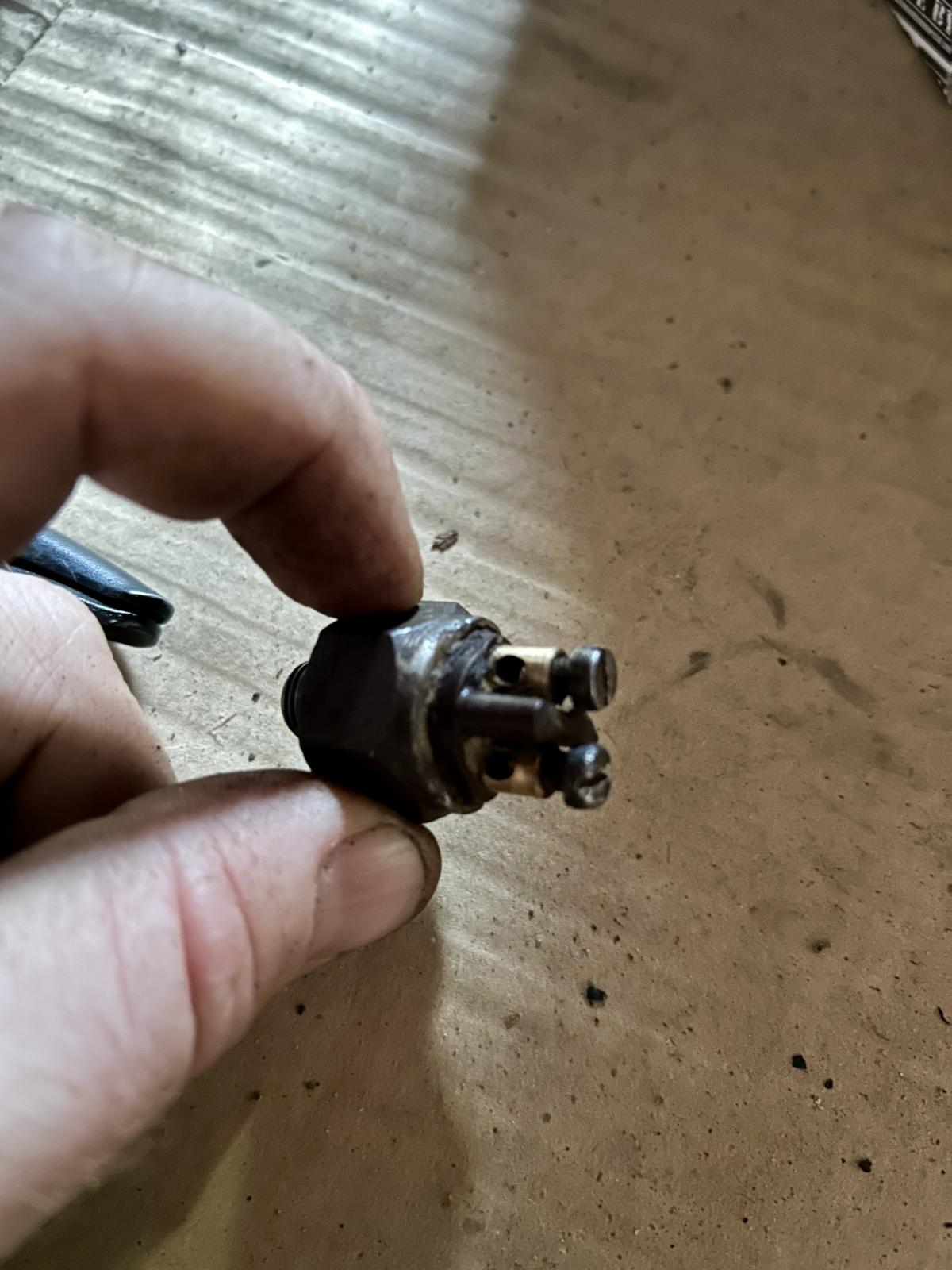

After a long day of driving I noticed that my brake lights were not working. not a good thing. This week I ordered the parts and replaced the brake light switch.
The one that came out seems to be an original or super old. I had to re pin the ends as the new one needed spade terminals.
Back working again.
I've never seen that e-brake switch boot, I wonder how many car are missing that _________________ How to Post Photos

| EverettB wrote: |
| I've never seen that e-brake switch boot, I wonder how many car are missing that |
Probably most are, but new ones are available: https://www.wolfsburgwest.com/cart/DetailsList.cfm?ID=113945521 _________________ 1960 Ragtop w/Semaphores "Inga" |

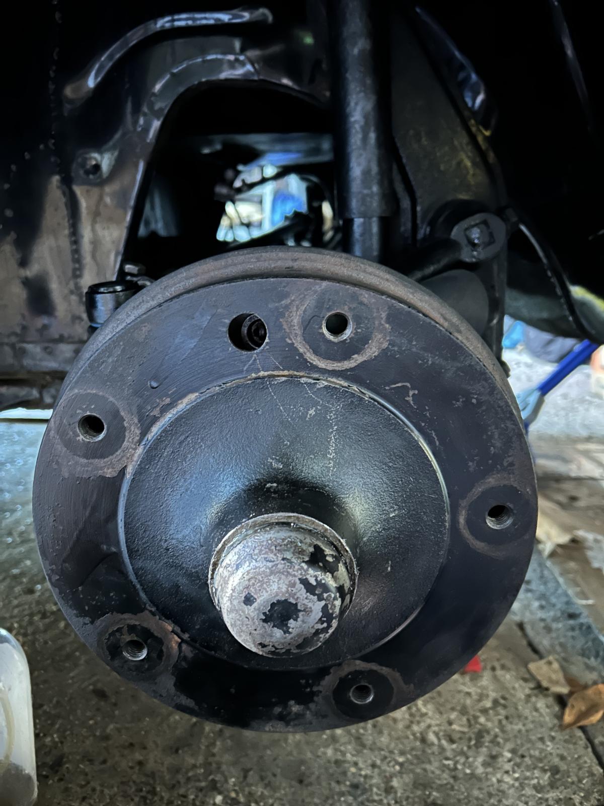

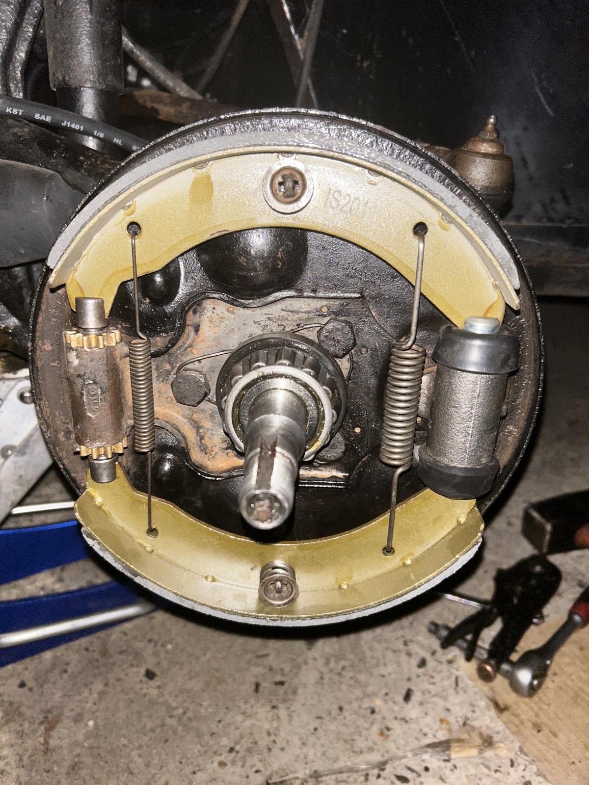

I had some time this afternoon to work on the front drums, I replaced the brake pads, one cylinder and both soft lines. I opted to keep the hardware as there was nothing wrong with it just needed a clean and re greasing.
I had one issue with the drivers side inner bearing staying on when I pulled the drum off. The use of heat and persuasion will get it removed and replaced in the near future.
Front Passenger:
Front Driver:
Still yet to get on to the hardlines this will be done with months paycheck. I have ordered some tie rod ends to get it steering a bit better. |

Tonight I removed the wheel bearing with a little bit of fire. It wasn't damaged, just a small amount of corrosion on the spindle. Using some scotchbrite it was easily removed and good to go. I bent the wire back to stop it from rubbing on the inner seal before assembly.
All back together, brakes bled and adjusted.

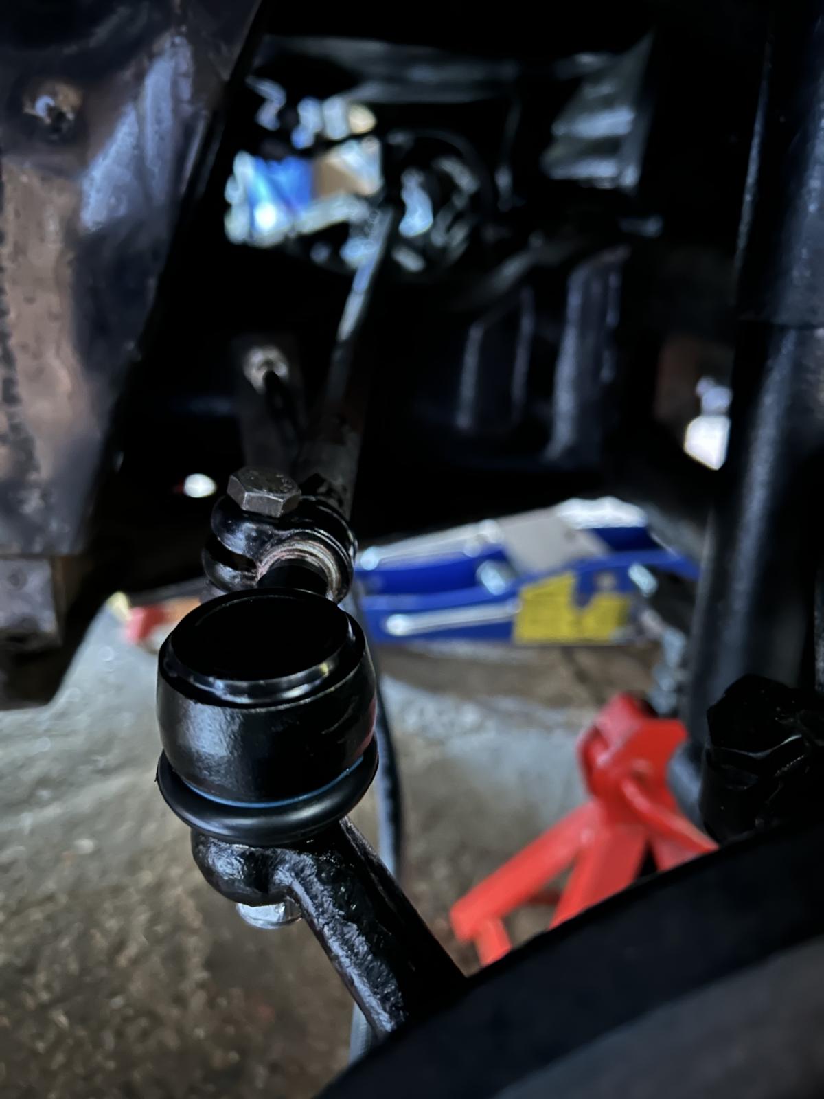

I am in the process of replacing the tie rod Outer and it seems like they have a longer distance between the center point and where the thread starts. I then had to remove the whole arm to adjust for the extra 1cm of length. All good cleaned the arm and the inner tie rod was serviceable. It was cool to uncover a VW logo on the steering arm. Left the arm unpainted just coated it in some linseed oil.
I am about to start the other side but noticed the driver side has a more pressed style arm, is this common to see? |

Front Driver:
Looks good, except what are roller bearings doing in there?  _________________

hahah Yeah it is a strange place for it to be stuck. I used some heat to remove the bearing and cleaned the spindle so it dosen't happen again. |
