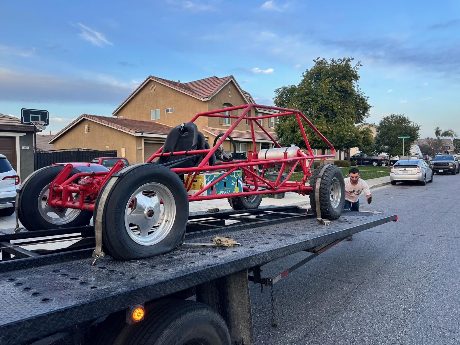

I recently purchased this sandrail and would like to get it titled and street legal. First step is a chassis ID which is turning into a monumental task here in Missouri.
Ive been told by Highway Patrol inspectors that if the chassis ID is not present that the best path is to build it up and then file court paperwork for a Declatory Judgement where a Judge will grant me ownership and a title. Major PITA Mad
Can anyone possible help me ID this chassis and maybe direct me to a spot where the manufacturer may have stamped a chassis number? Ive looked for a tag on the rear tube, and stampings near the front frame horn. Any other suggestions are welcome.

Could that be an Invader or maybe a Fugitive frame? It looks a lot like mine.

The first thing that came into my mind was Hijumper, but I don't know anything.
