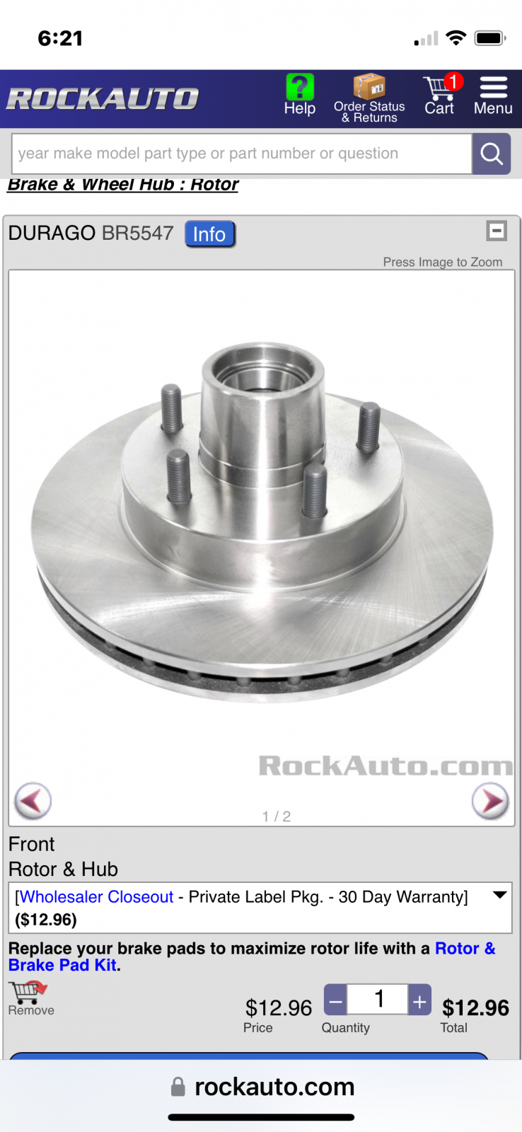

PostPosted: Wed Feb 12, 2025 8:48 am    Post subject: Re: Type e motorsports disc brake review Reply with quote
Just wanted to pass along Rock Auto has a closeout on the
Durago BR5547 Brake rotors, I think 19/20.00 each.
These are the rotors I ordered for my install.
Just go to rock auto and type in the search at top
DURAGO BR5547 and it should pop up.

Brian_e wrote:
I was poking around on rockauto.com, and they have wholesale close out on the rotors needed for the Type E brake kit for $12.96. They are the good Durago brand. I tried to add 100 of them to my cart, and it showed they had 57 in stock.
Here is the link if anyone wants extras, or is thinking about swapping to disks on their 64-70 bus.
https://www.rockauto.com/en/catalog/chevrolet,1986...rotor,1896
Brian
Thanks Brian for the tip on the Rock Auto price drop!
After verifying that these were indeed the same parts that I initially ordered, I just went back and ordered two extra rotors (now sale priced at $19.73 each as well as one extra set (also clearance reduced!) of four brake pads at $11.76. Taxed and shipped to my door for a total of $83.34 so that I can have a back-up set of parts that'll last way past my life time...
I love these Splitty disc brakes Brian!
