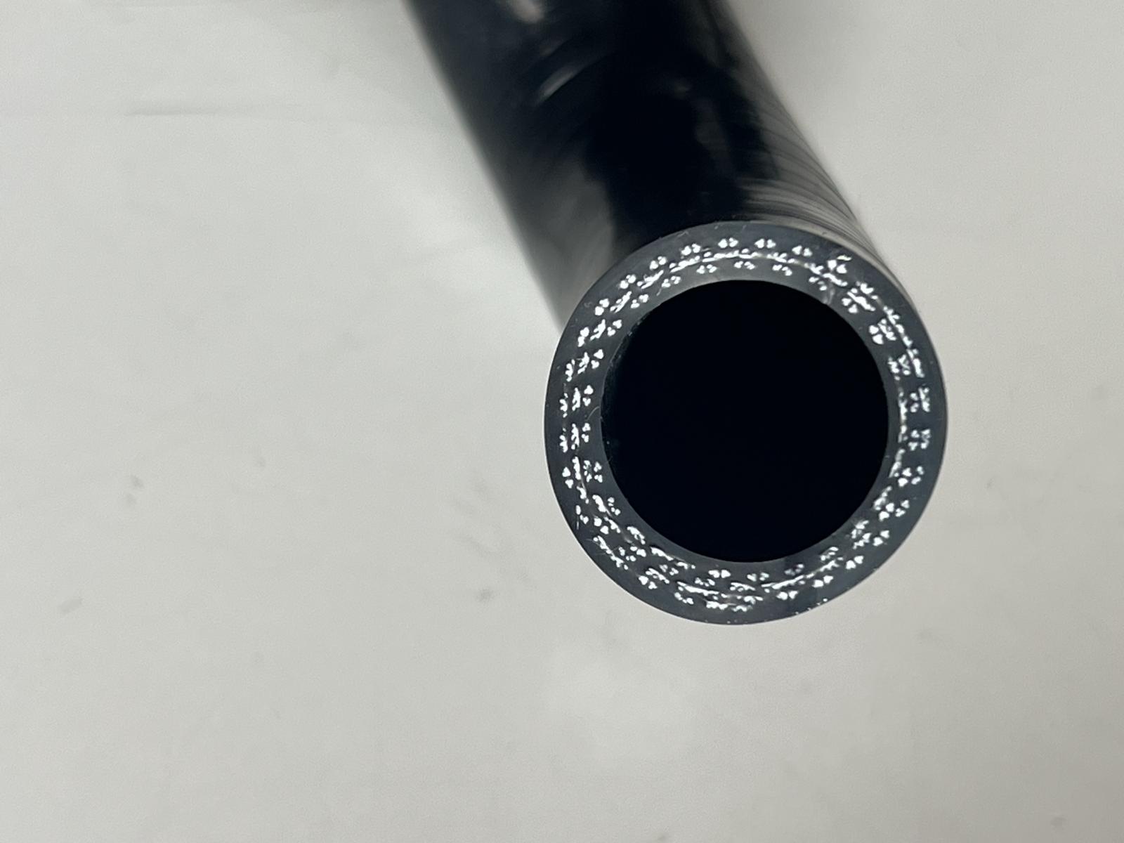

PostPosted: Sun Jul 20, 2025 5:54 pm    Post subject: Re: T4 vr6 coolant hose kit Urotuning Reply with quote
I took the plunge. Thought to share the up close and personal pics. Curious as to folks observationsโ€ฆ.
edit to add that Iโ€™m clearly all in on an outfit that acknowledges the need.
Old stable: '63 Baja, '69 Square, '72 Bug, '65 & '67 Samba, '73 412 wagon & 2dr 4spd
Current: '04 Golf TDI, '03 Weekender
Abscate Premium Member
Joined: October 05, 2014
Posts: 23790
Location: NYC/Upstate/ROW
Abscate is offline
PostPosted: Mon Jul 21, 2025 3:15 am    Post subject: Re: T4 vr6 coolant hose kit Urotuning Reply with quote
Iโ€™m sure Ray will chime in but pictures donโ€™t help here. Itโ€™s all about the formulation of the polymer which will determine function and life.
