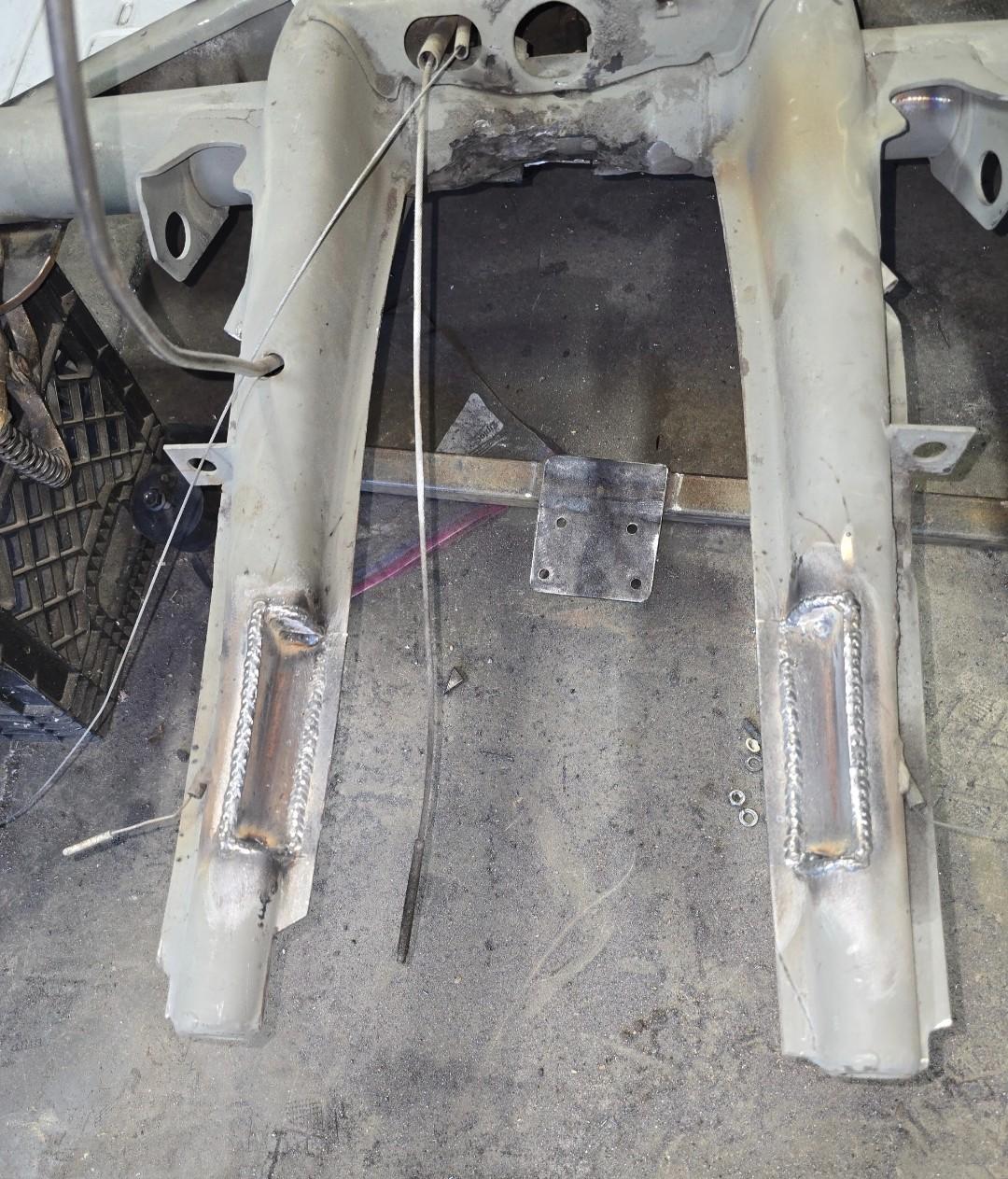

I have a 1963 double door panel bus that somebody cut the entire rear torsion and suspension out of. So now I am thinking I would like to replace it with IRS.
But I do not know if I should use:
A- Beetle IRS complete torsion assembly.
B- '68-'71 Bus complete assembly.
C- '72-'79 Bus complete assembly.
Plan is to build a lowered daily driver that can be driven anywhere reliably, and only haul light loads. I do want 4 wheel disc brakes, either 944, CSP or CoolRydes. I do preffer porsche bolt pattern.
Not going to be slammed. Probably only lowered 3-4". My '63 single cab has just removed gear boxes, then dropped spindles and it drives great.
I would consider air bags though. I like seeing buses parked on the ground! I just have never tried this before.
I plan to convert to walk through so I can add a little leg room moving the seat back some. I know I will have to add belly pans.
Back end of this bus is very rough, but I have bought all new metal for the outsides and a donor clip from a walk through bus to repair the area above the motor. And I have bought clips for frame parts from different years of buses just in case too.
Wheels will be 17x7. Tires will be 205/40 fronts and 225/45 rears.
I am open to ideas on transaxle to use. I have bus 3 rib and beetle irs to use and plan on getting one rebuilt just for this build. Or I know where I can get a 914 5 speed and I already have bug@5speed conversion kit.
I have 7 different welding machines all from Miller. I weld for a living. I'm just not a bus expert yet. I spent most of my vw obsession with 1950's and '60's bugs. I do have several buses for parts.
Sorry I wrote so much. I just am hoping to be clear on exactly what I'd like to build before the comments start.
Thank Y'all in advance!
This ^^^! Converted Both the '65 Dormy and the '68 Plump Truck to narrow 5 late bay suspension! Cool

To be sure, got yourself quite the serious project! Fabrication and McGyvering will have to happen! Shocked
I preferred to go with type 2 suspension for better components like brakes and such instead of type 1. Cool
For some reason my pictures are no showing in my IRS thread, so this link should take you to them. Confused

be careful of the position and width of the torsion bar.
i think late bay is wider. the springplates are definitely longer on the newer setups (with 5x112 pattern). your wheel will not be centered in the rear arch. it works, but it looks odd
i have a stock torsion/early bay setup in my panel (see my thread) and it works ok

Just in case you missed it... I used the '65 torsion plates and cut them to match the IRS ones, but almost screwed up because they are shorter that the early ones! Confused
Measure multiple times!!! Wink

Thank You pyrOman. I did not know what year these are, and I assumed they were bay. Now I know. Thank You.
I'm thinking I should go 1" behind the factory frame connections in the middle and use the bay complete rear frame to the torsion. Then mid torsion tube back use early bus donor framing? I have these bought and on site just in case.

You'll have to re-position the upper shock mount too! Wink

Thanks guys. I am surprised to see the early bay trailing arms had to be mounted inside the framing like this. I like how it looks and can see this is a good way to go.
My '63 has zero rear torsion tube in it, so I can use whatever. It is cut about 6-8" in front of the torsion tube.
I have irs beetle transaxles, and 3 rib bay transaxles. Plan to have one rebuilt at Benco.

I posted this thread looking for the best option to go with on this bus for a reliable daily driver. Really leaning towards beetle IRS or bus 3 rib, definitely wanting to go with IRS.
Is a beetle rear torsion strong enough? Or am I better with a bus torsion? I am new to this specific situation and hoping to do it once and not have any regrets or " I wish I had.." thoughts when done.
I do plan on making the frame still look original again, just with a different torsion tube and transaxle.
