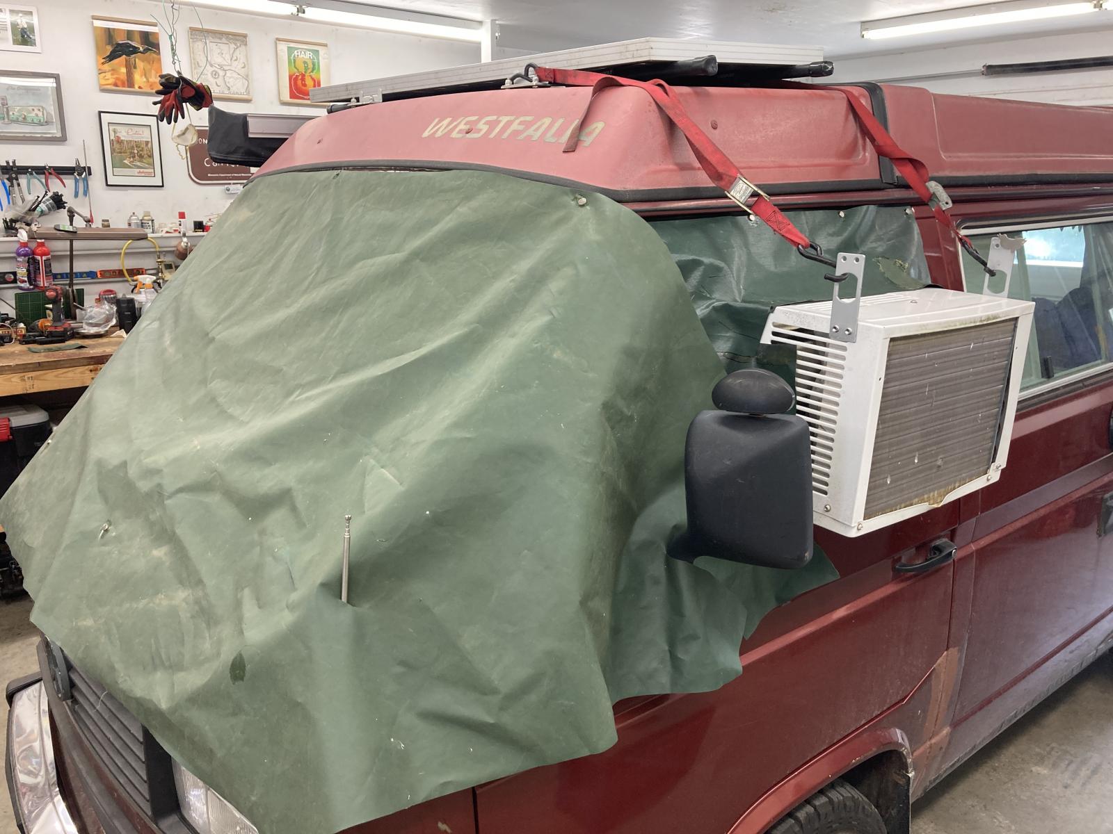

PostPosted: Sun Jul 06, 2025 12:54 pm    Post subject: Re: Air conditioning....WHILE PARKED Reply with quote
my take on AC. only cost was for the magnets. green tarp is a boat lift canopy that shredded in a storm. AC unit is the one from my shop.
-dan

PostPosted: Sun Jul 06, 2025 7:56 pm    Post subject: Re: Air conditioning....WHILE PARKED Reply with quote
That’ll do, Dan…that’ll do.

PostPosted: Mon Jul 07, 2025 7:31 am    Post subject: Re: Air conditioning....WHILE PARKED Reply with quote
Clean custom install. Probably could market them. Wink
I’m surprised that little unit cools your shop. My garage AC is 18000 btu mini split.

PostPosted: Mon Jul 07, 2025 7:55 am    Post subject: Re: Air conditioning....WHILE PARKED Reply with quote
my shop is small, 22x30 interior and very well insulated. the 5k BTU/hr unit runs pretty continuously in 95F, 90% humidity we've had the past few days but it keeps the interior below 70F and lowers humidity to around 55%
i'll probably put a mini split in when this fails. i've got a propane furnace and heat it year round but the MS would be nice in the mild temps and is much quieter.
regarding the AC install... i cut about 1" out of the pool noodle and it grips the window sill well and provides a resilient mount as well as protects the glass. just the right compression. seems pretty ideal.
