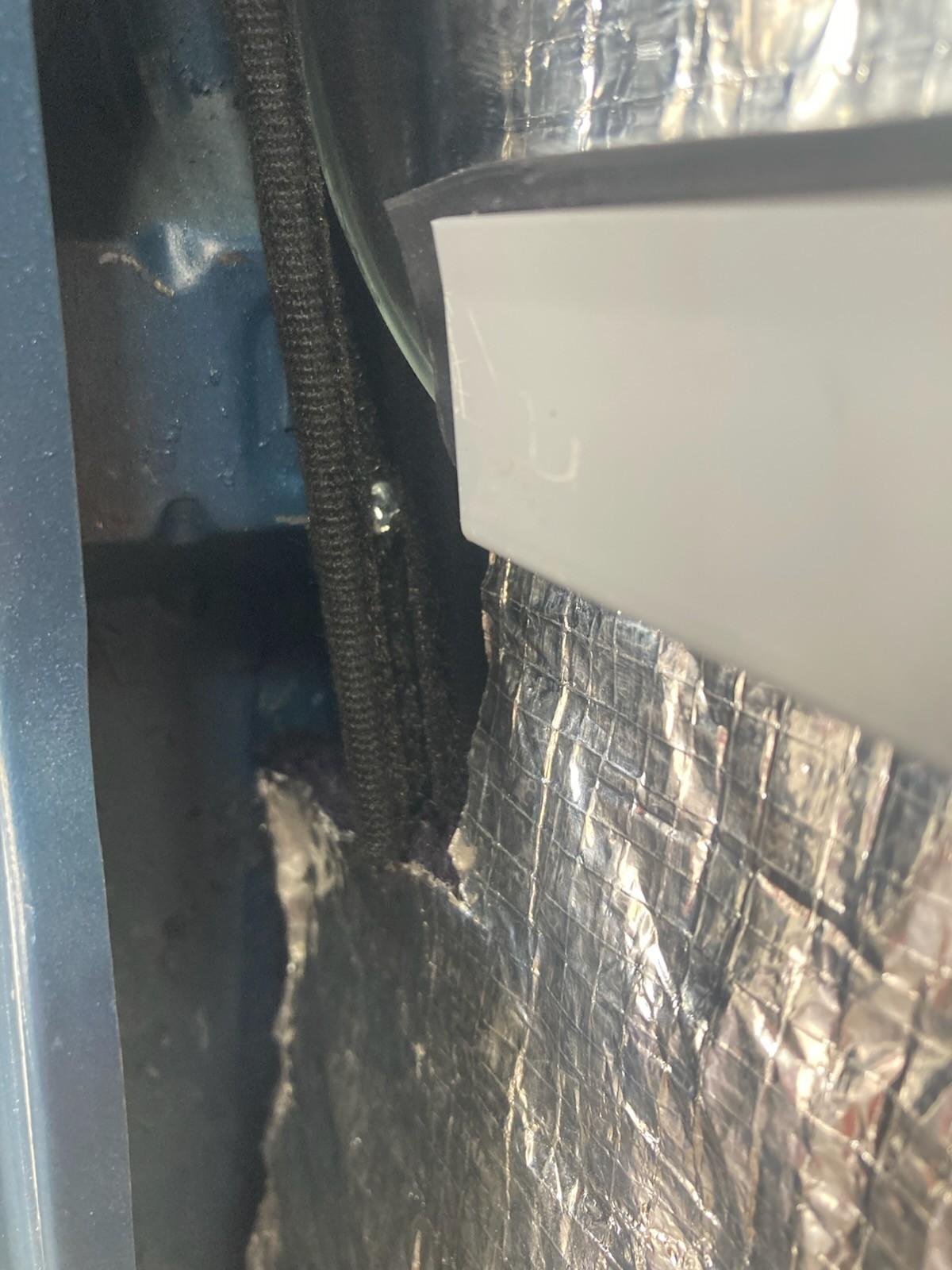

kaferfahrt
Joined: January 03, 2018
Posts: 15
Location: North Texas
kaferfahrt is offline
PostPosted: Sun Jul 13, 2025 4:12 pm    Post subject: Re: Felt channel support bracket Reply with quote
I had the same problem missing the felt channel support brackets for my '57 bug. They are impossible to find used and most of the ones available only fit the later models. WW confirmed that later ones do not work in '57 and earlier bugs. These guys sell the right bracket:
https://www.thesamba.com/vw/classifieds/detail.php?id=2269837
