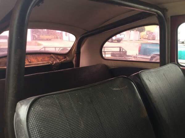

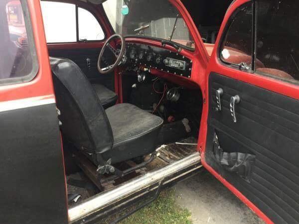

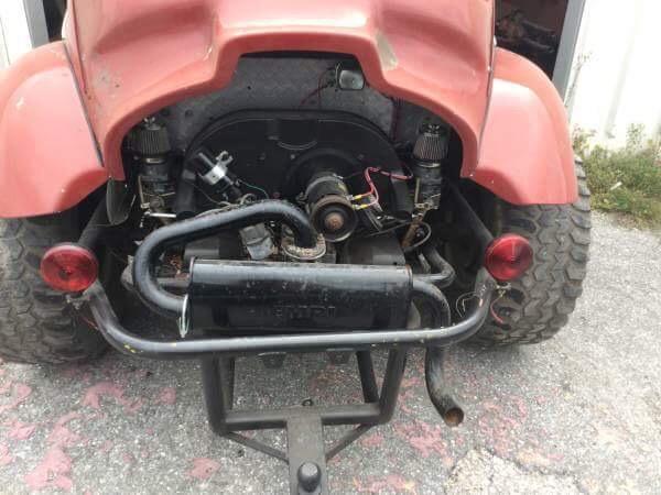

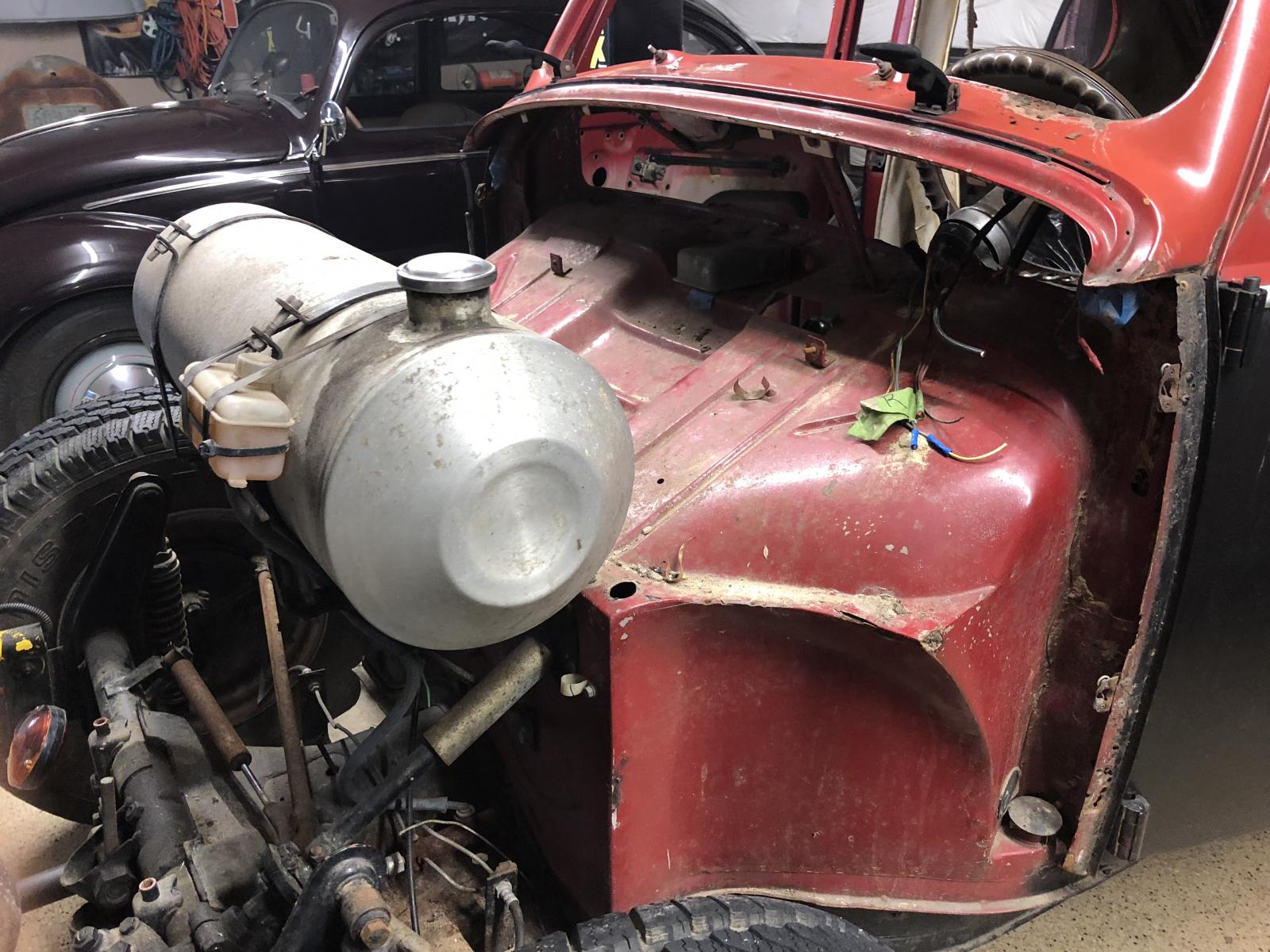

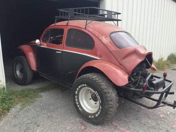

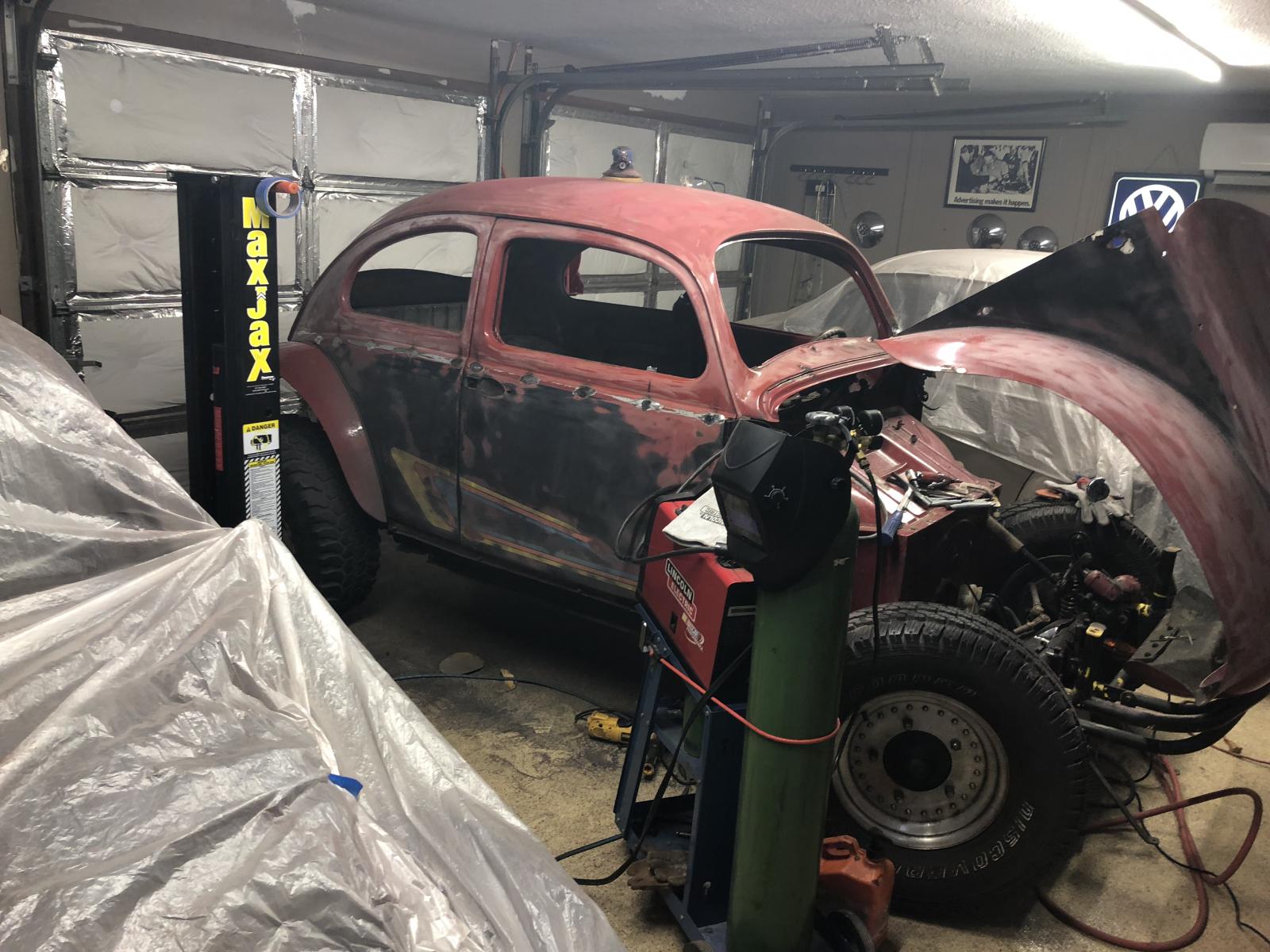

Well I went on the hunt to find a Baja for my Dad. After several failed attempts at trying to find him a nice turn key ride, we switched gears and tried to find something that had good bones and came with a price tag that reflected the condition. We settled on the 61 you will see below.
Pictures from the samba ad:

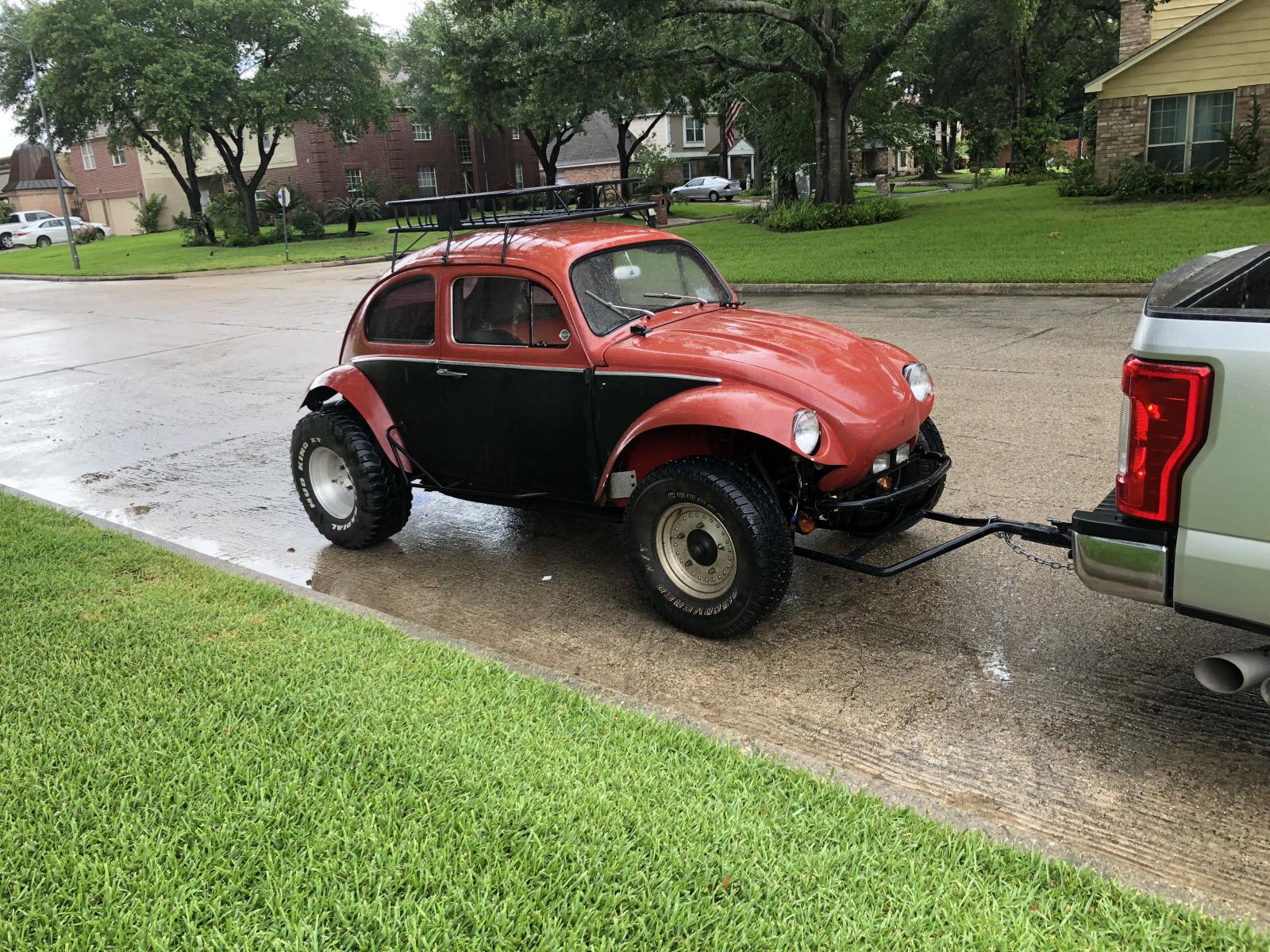

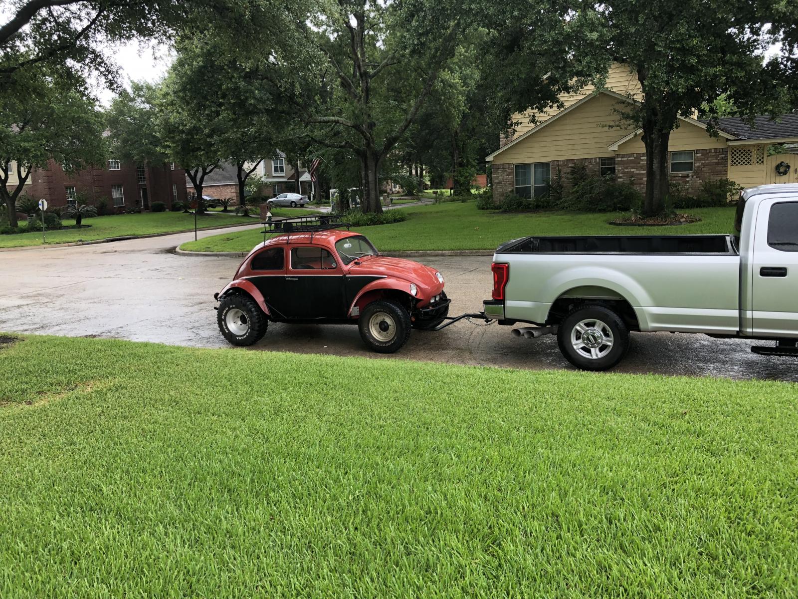

It arriving at it's new home this past monday:

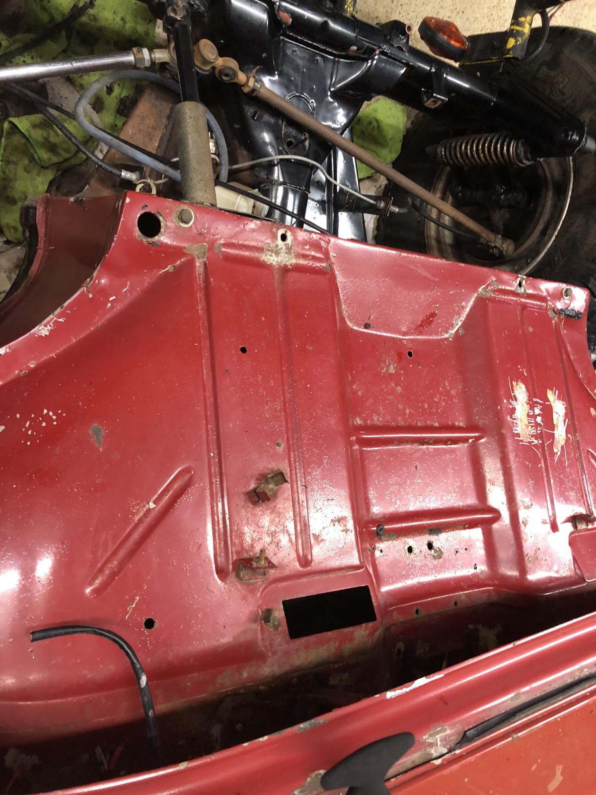

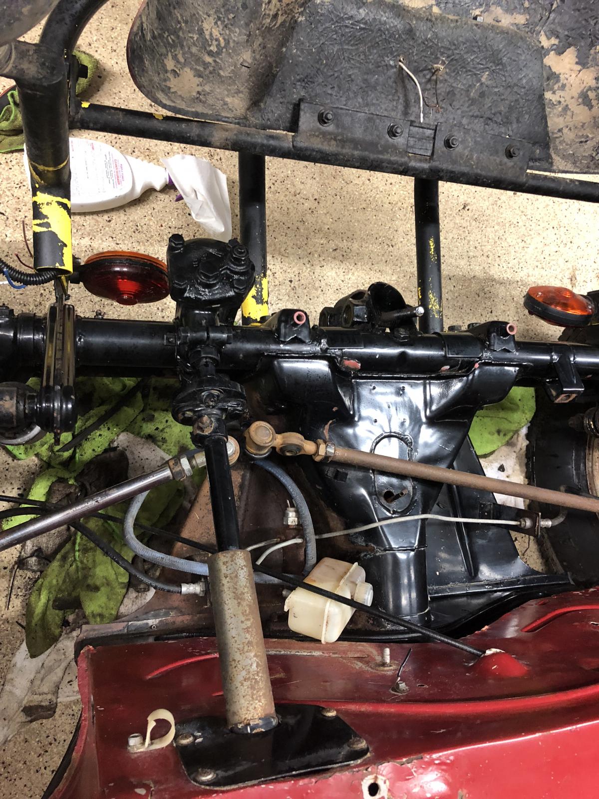

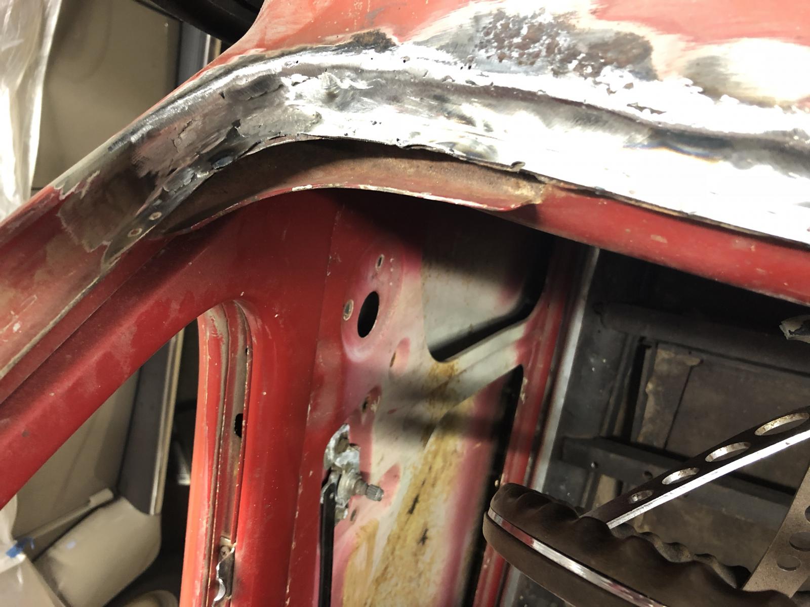

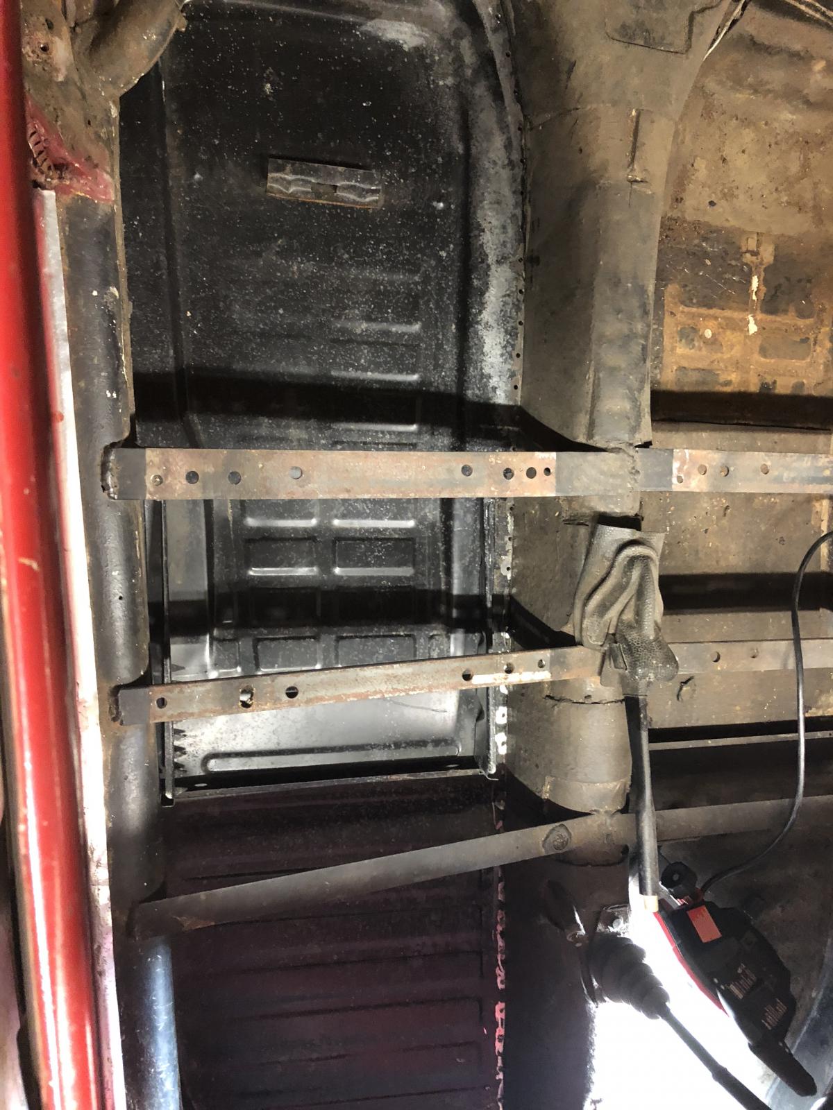

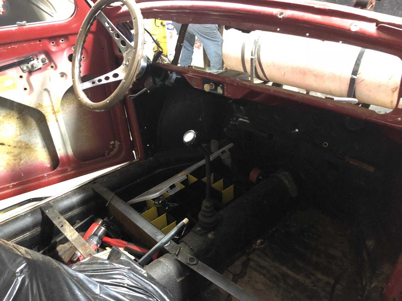

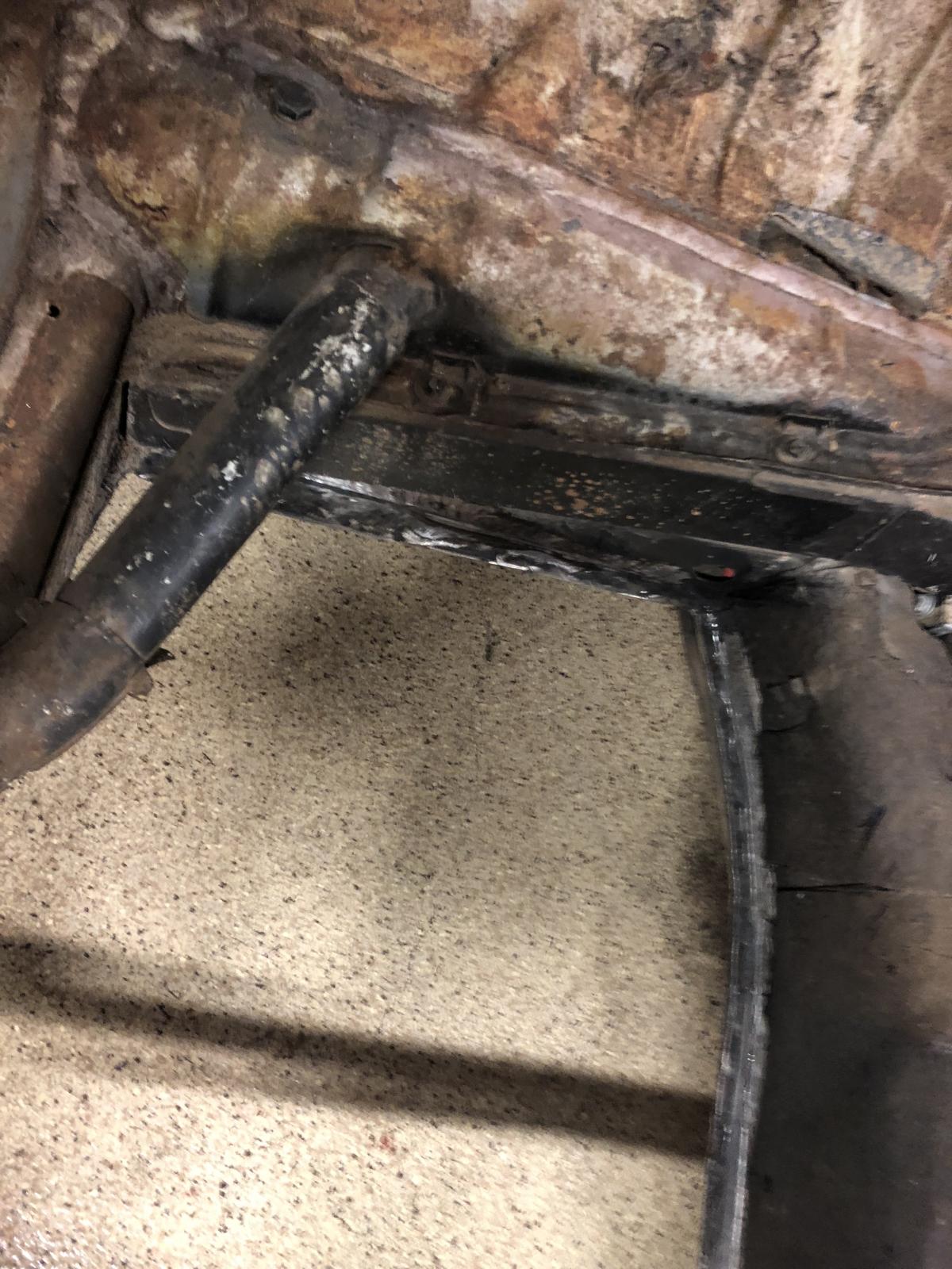

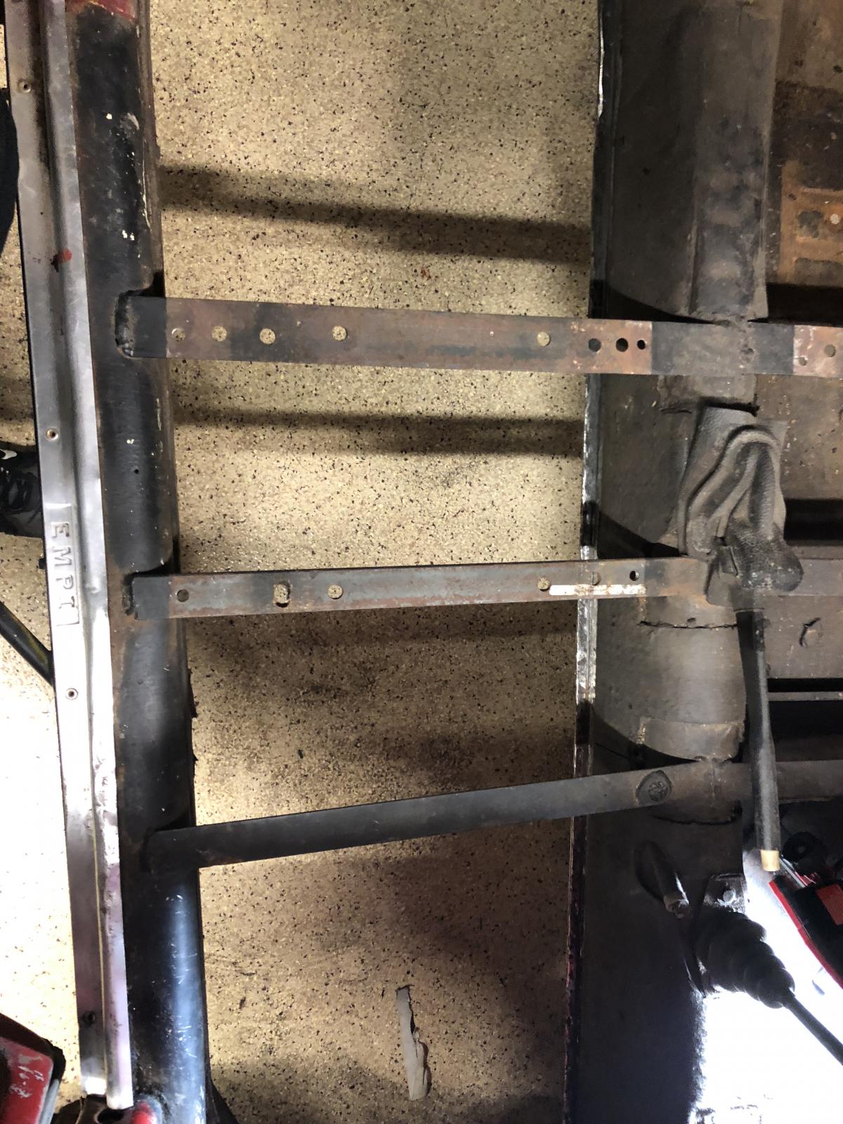

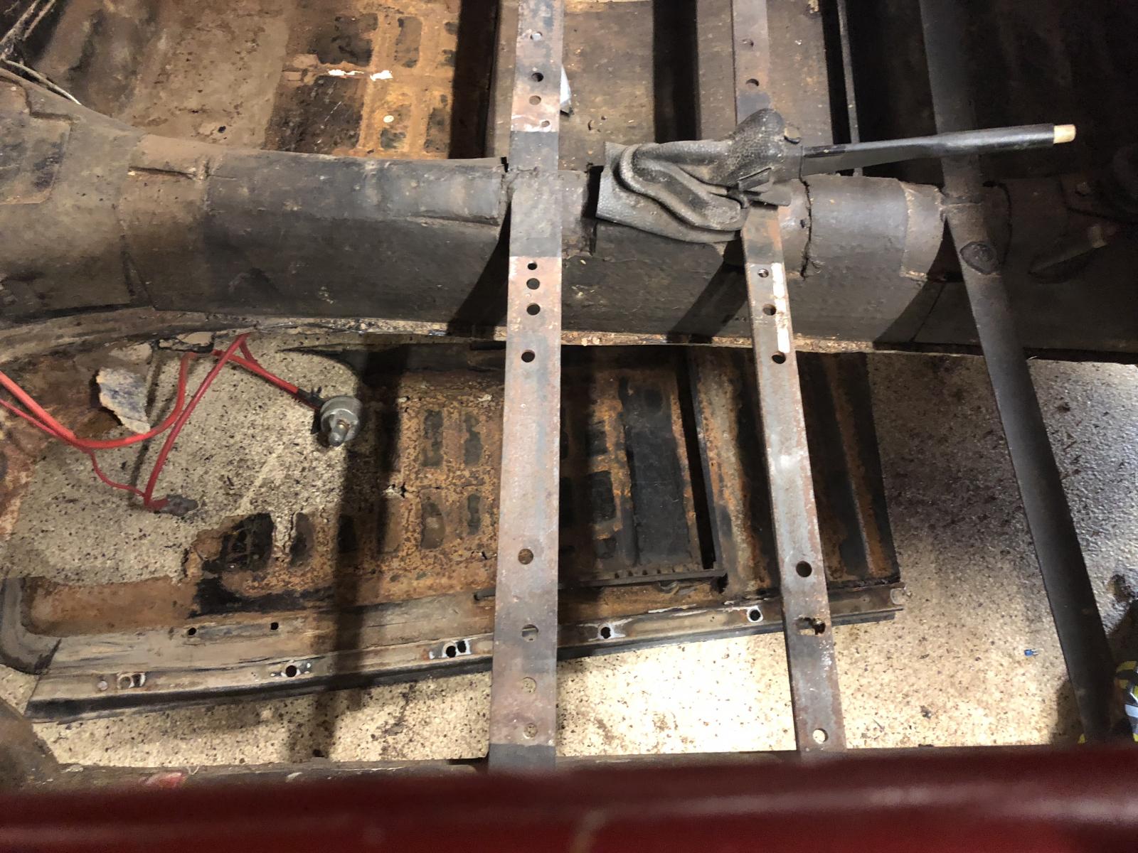

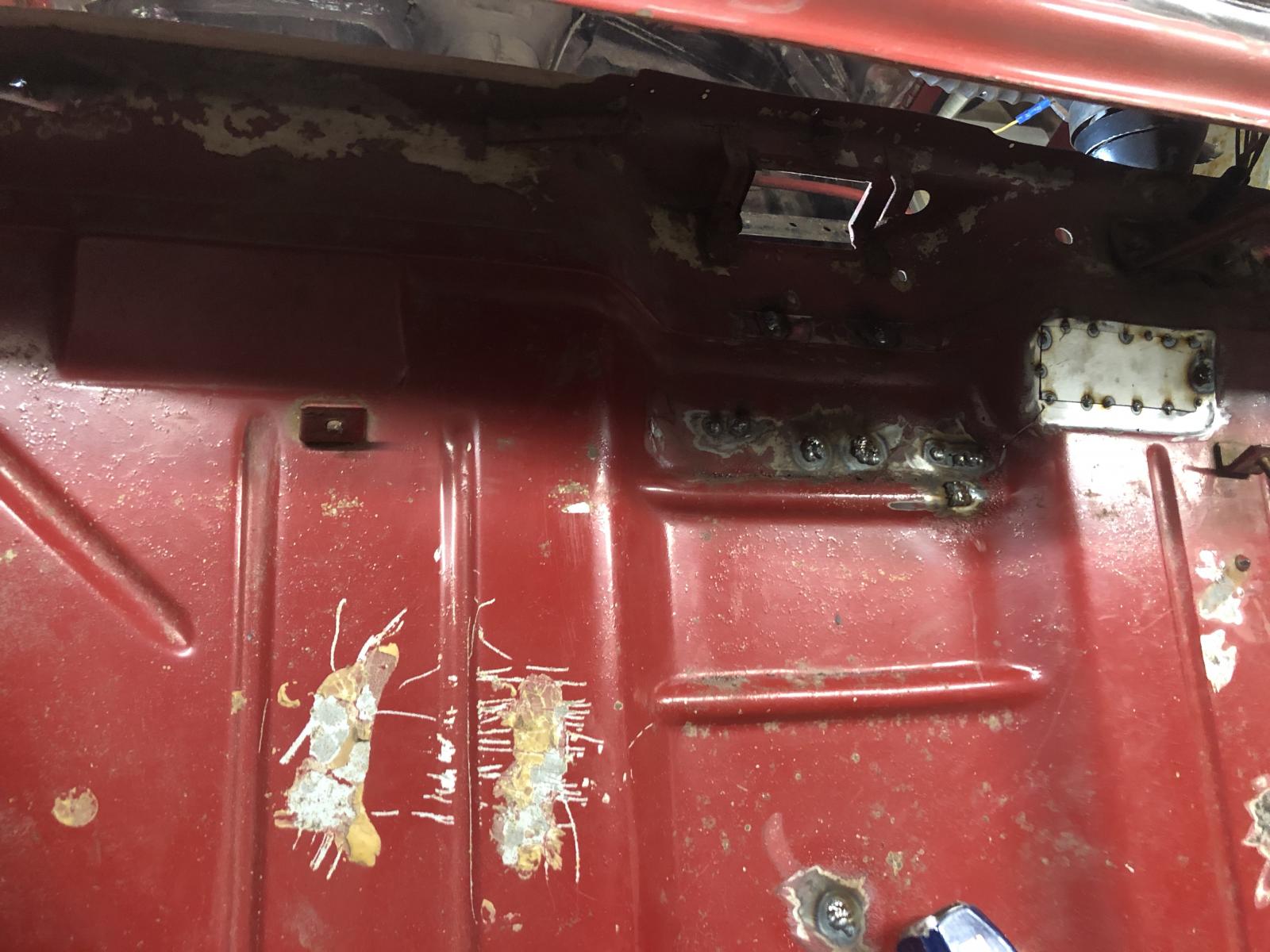

So I started the gutting process:

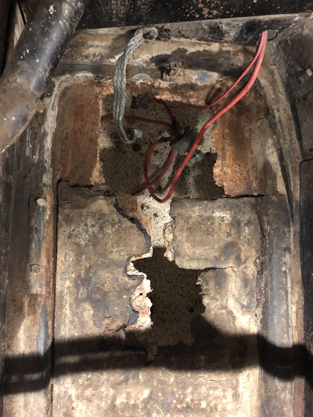

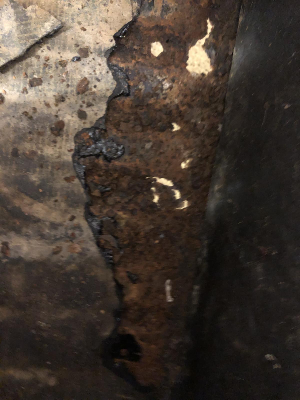

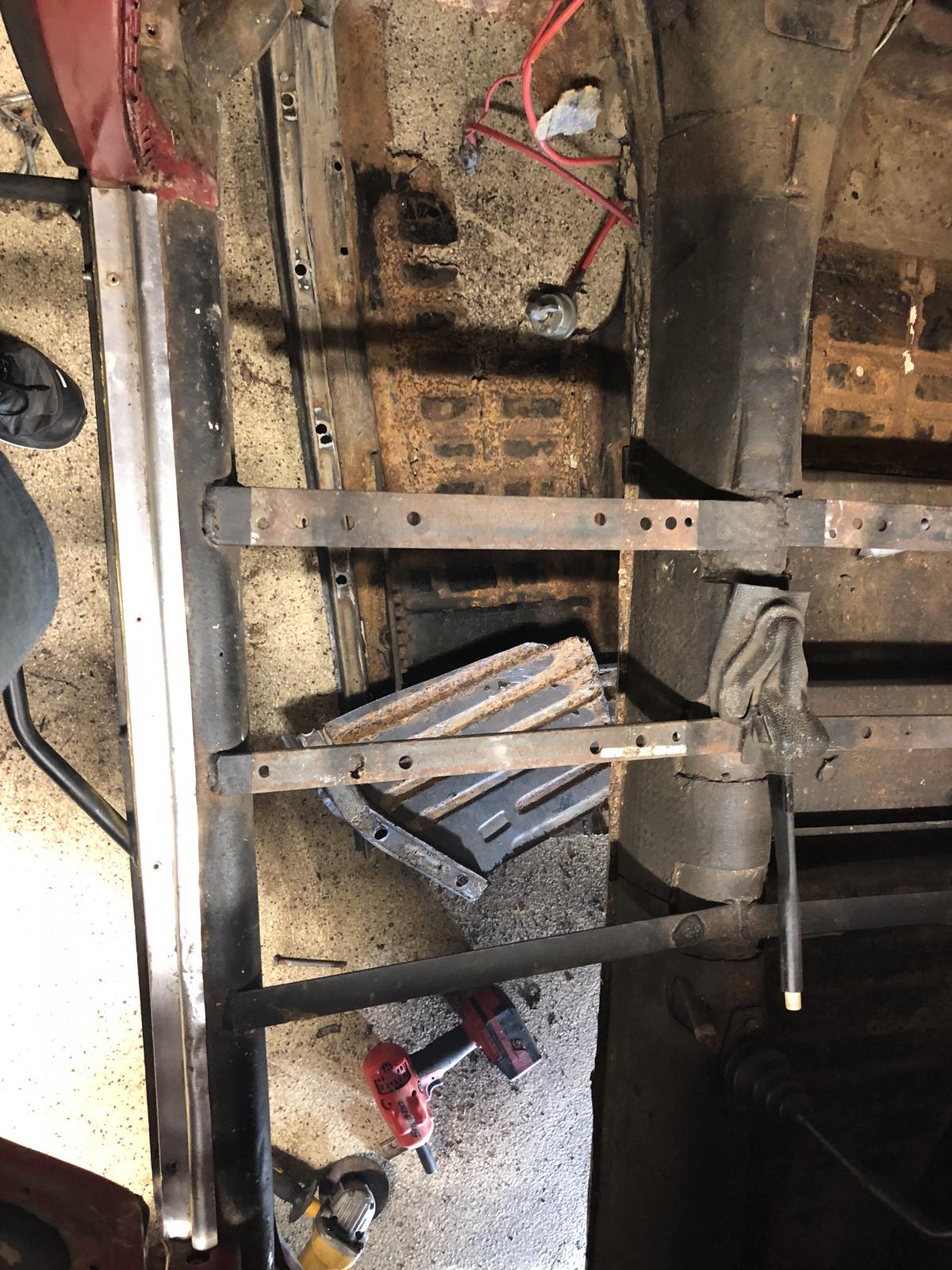

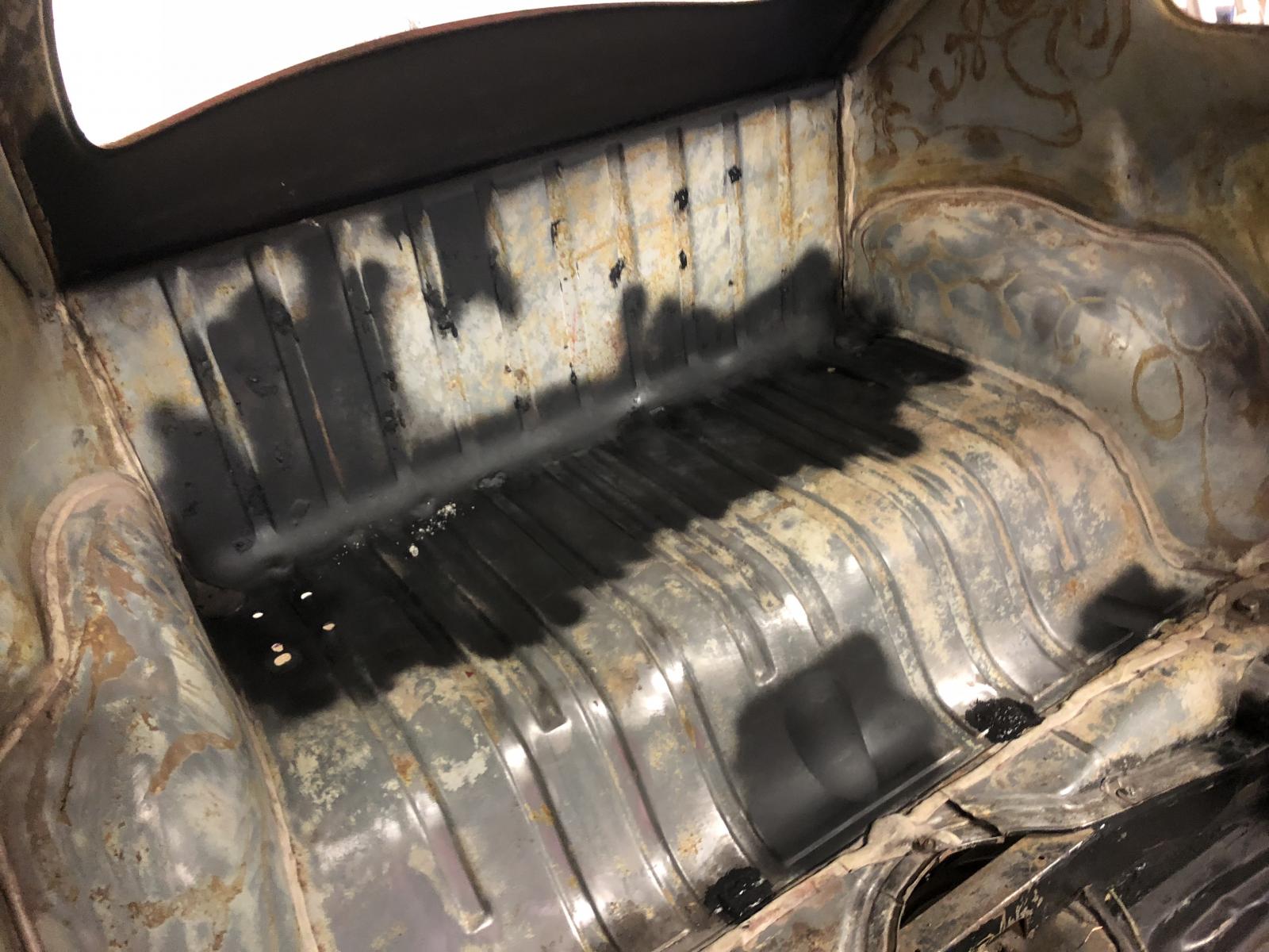

Passenger side pan was toast so I replaced it.

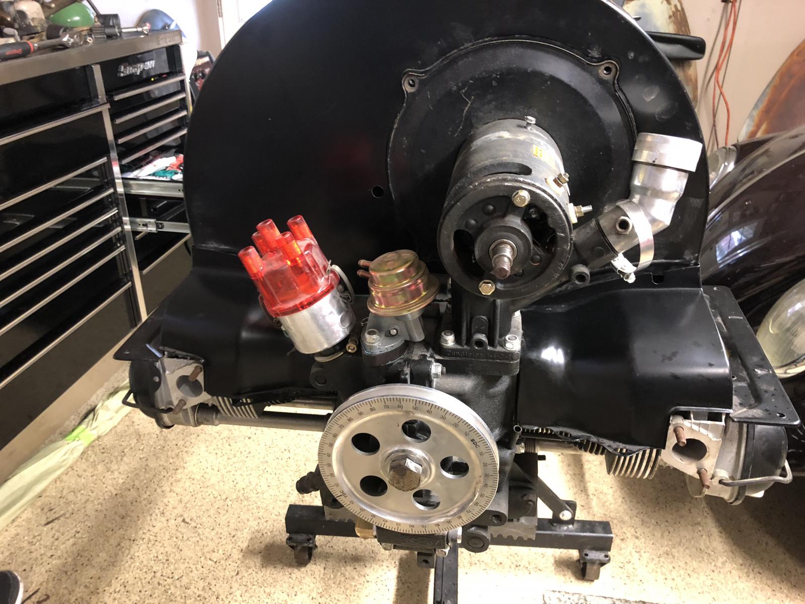

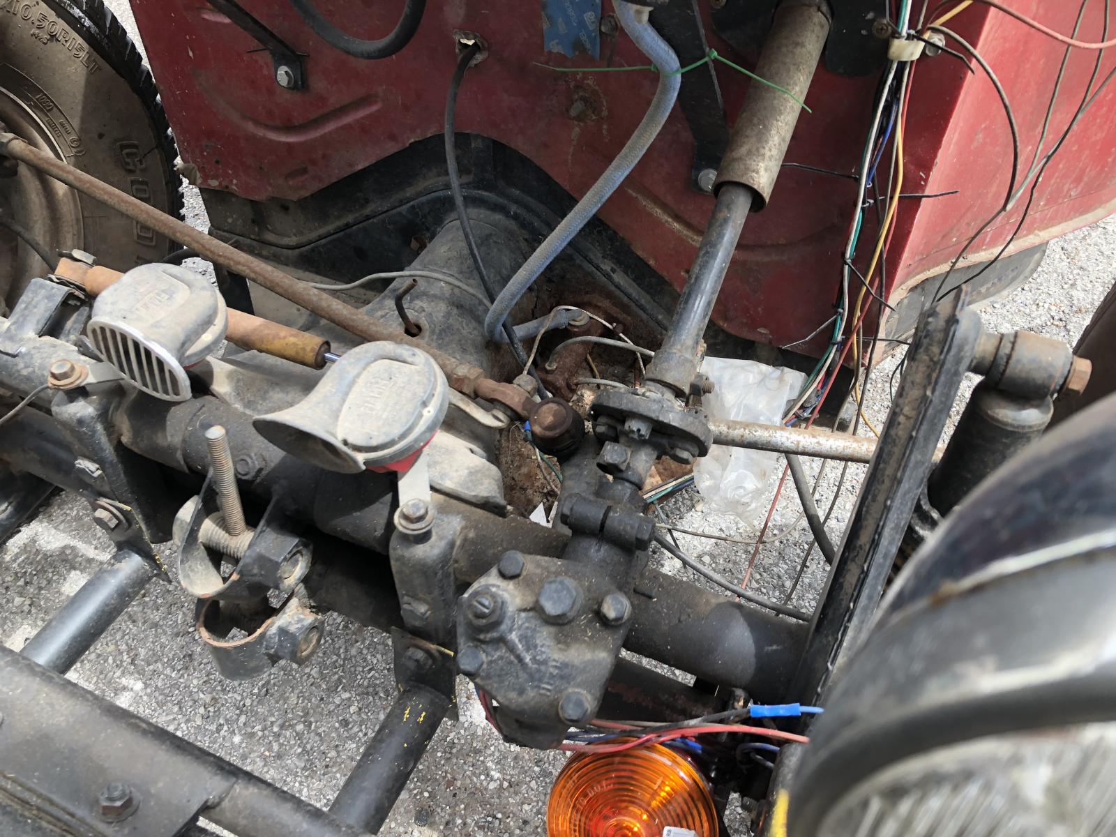

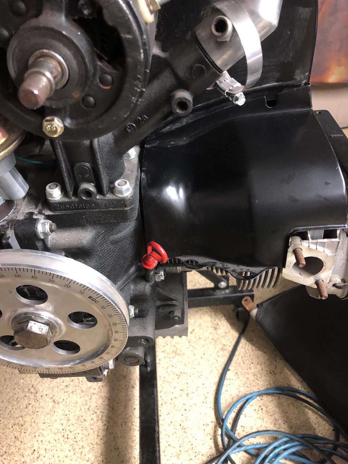

The Baja came with a SP 1500 that was locked up. I was able to score Dad a 1600 that came with new heads, pistons , cylinders and tin. Short block condition is unknown but I plan on opening it up and checking it out in the next few weeks.
We will rebuild the Kadrons and use those. The trans is supposed to be a built trans, so hopefully that will be OK.
Our plan for this build is to freshen and save all that we can to keep the cost low, new paint , interior, and replace all mechanicals that need replacing.

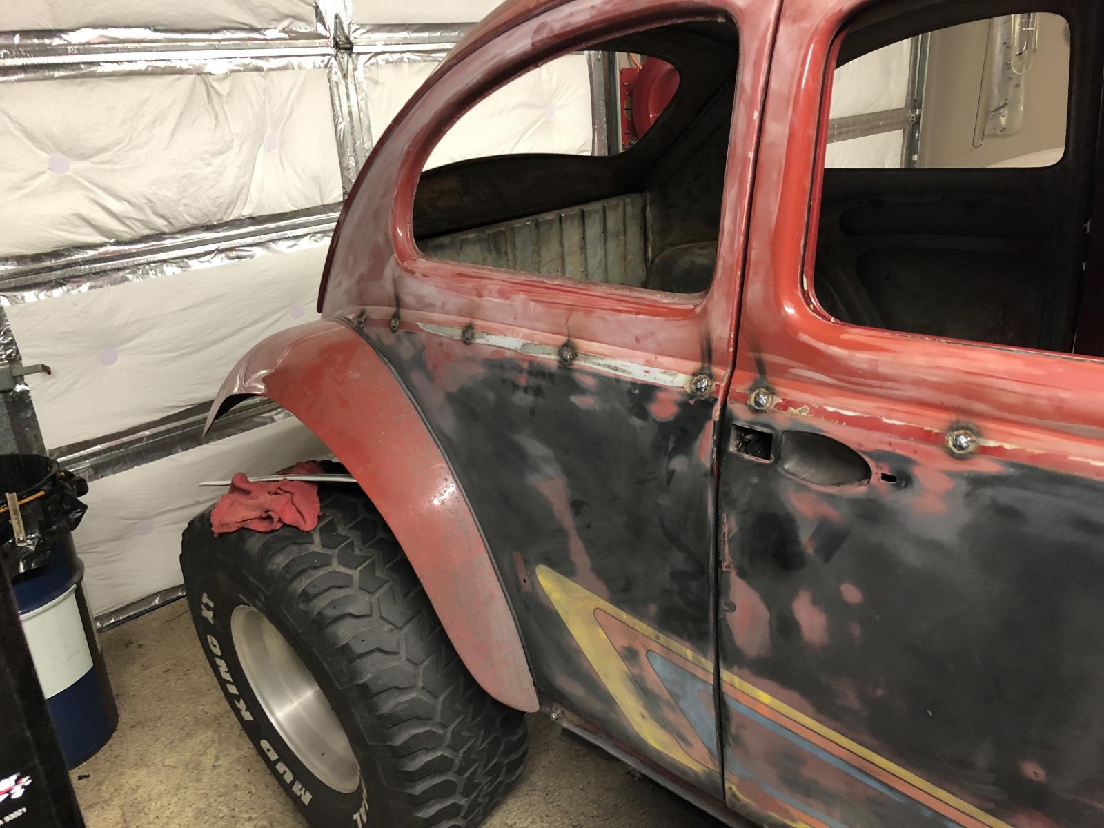

LOL I guess I really over document a build. At least when I sell a car I pretty much have a picture of everything I have done and every inch of the car. Just take a peek at any of my builds.

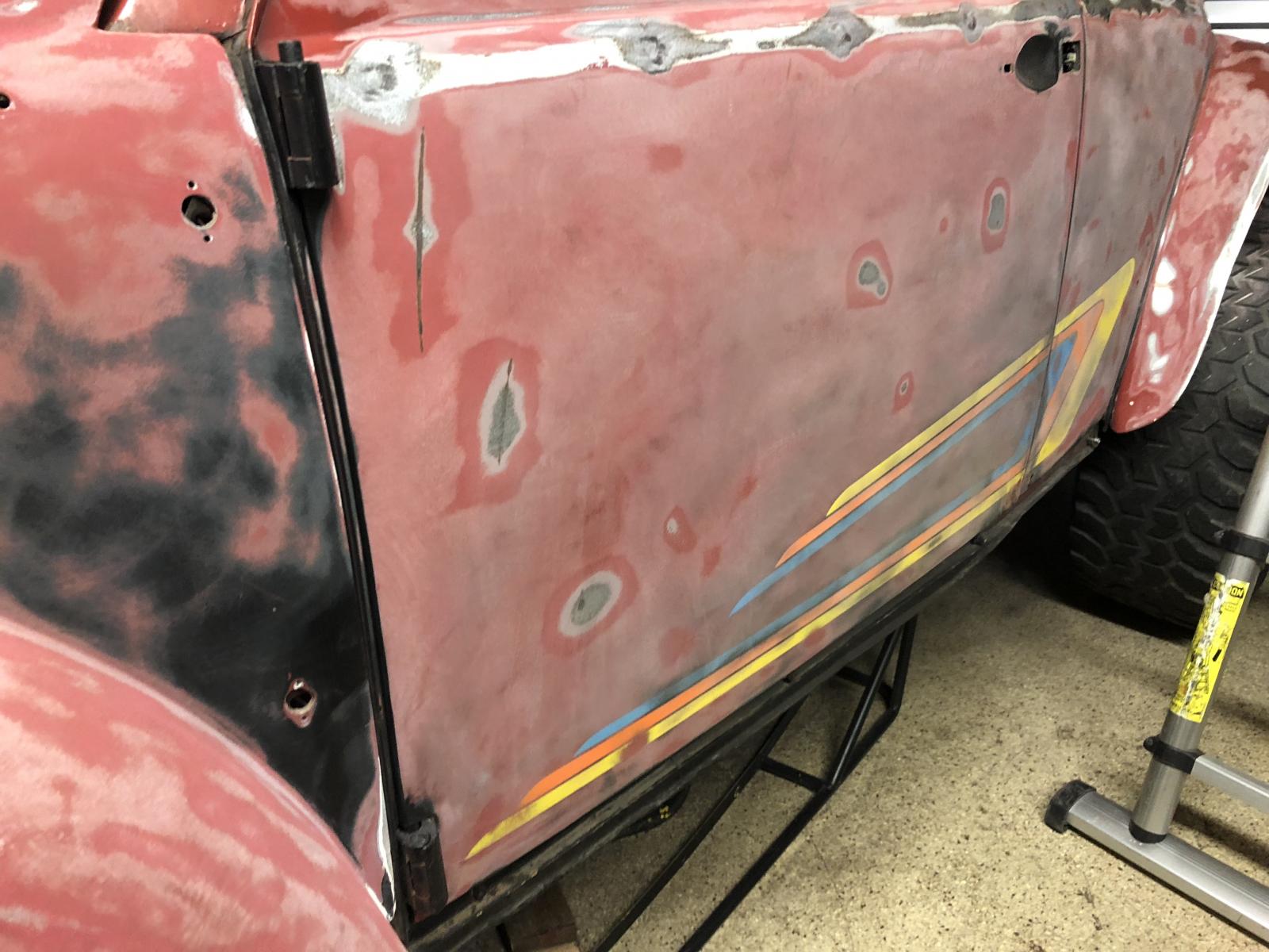

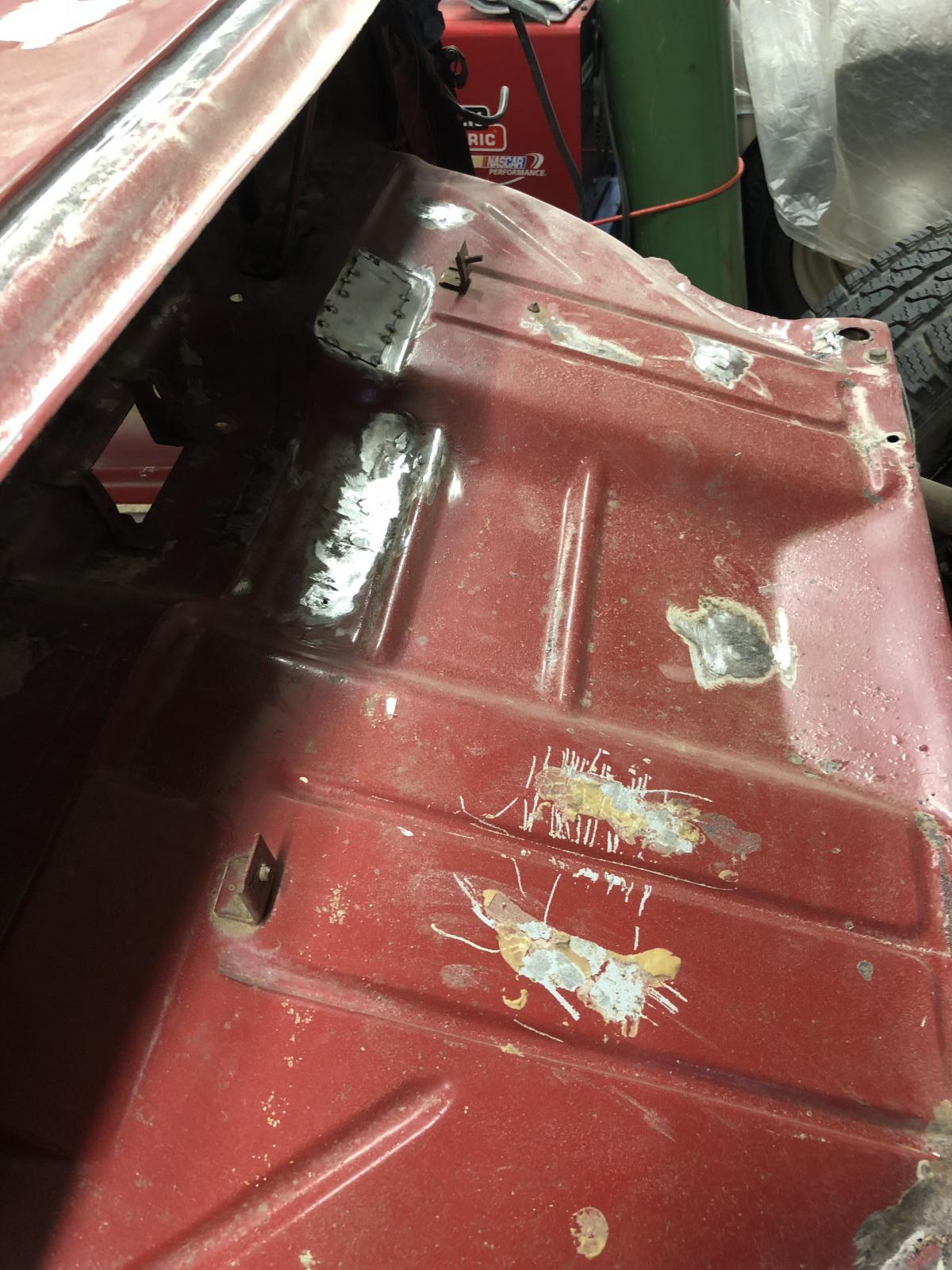

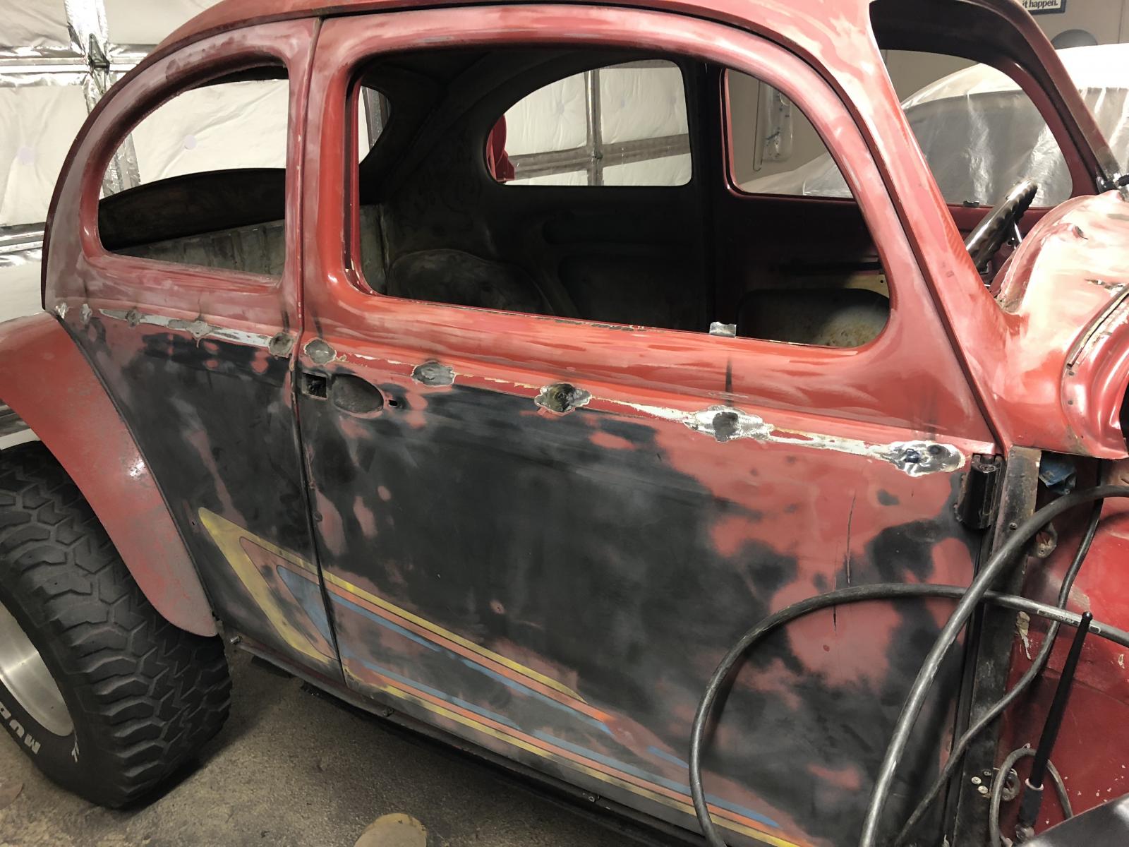

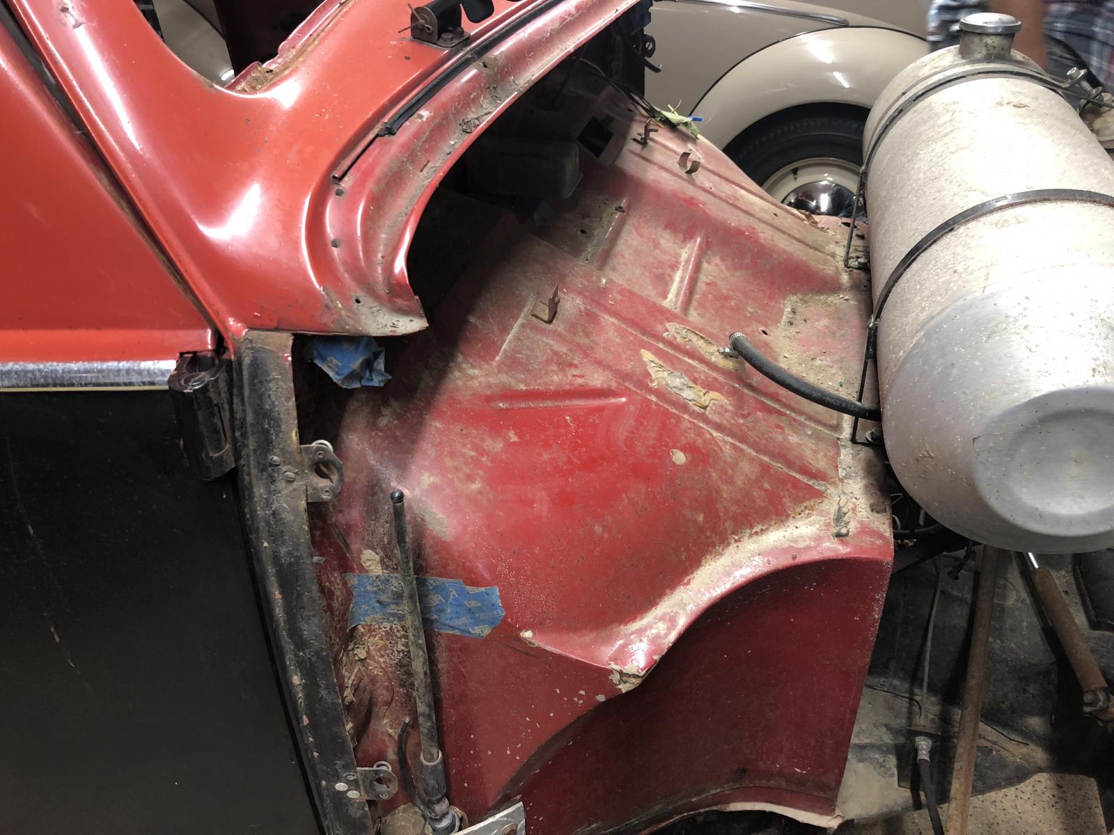

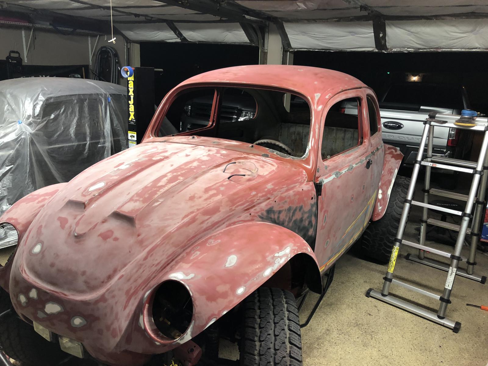

Moving along not much to report from yesterday. I did get the pan I installed seam sealed.

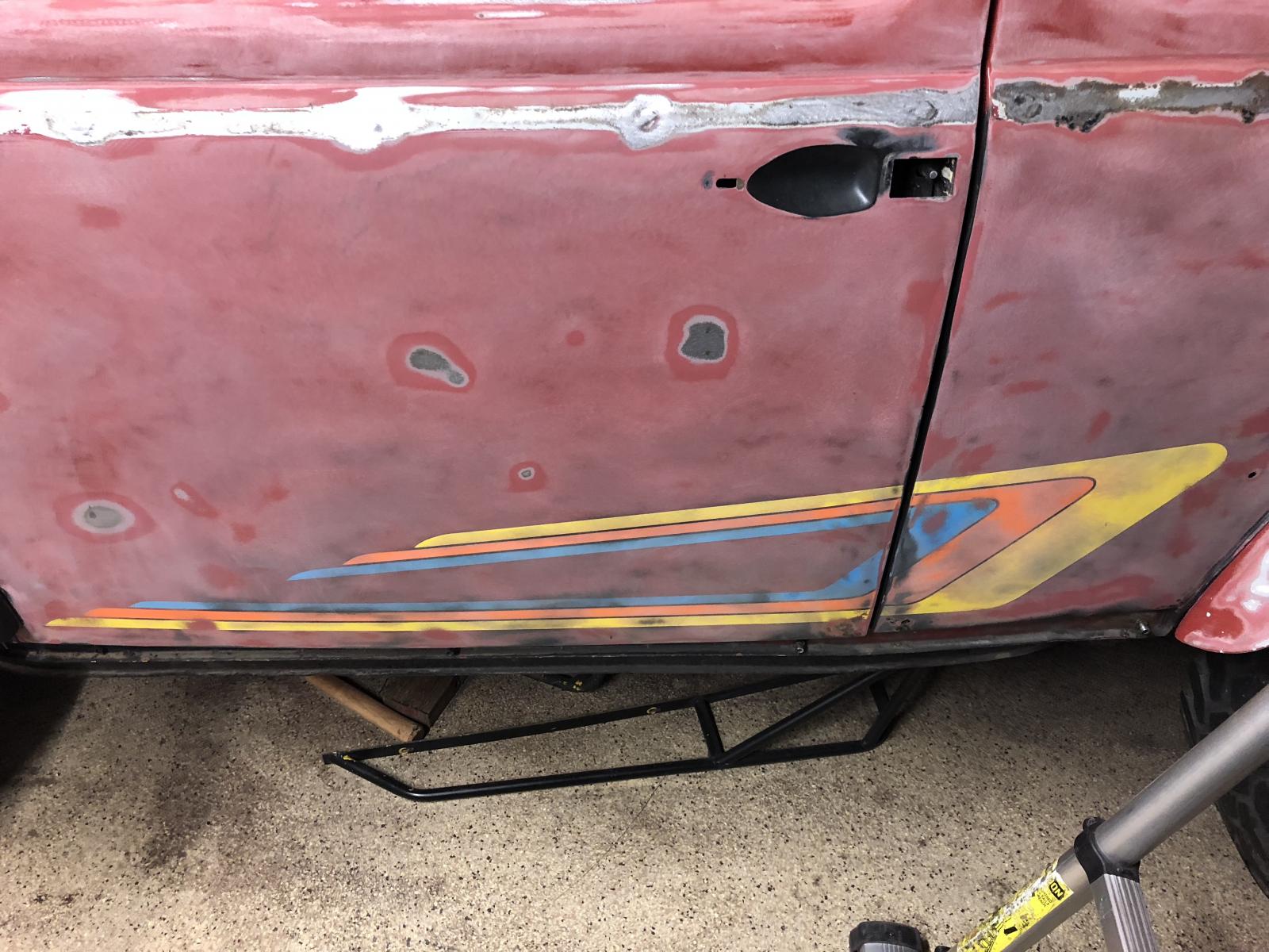

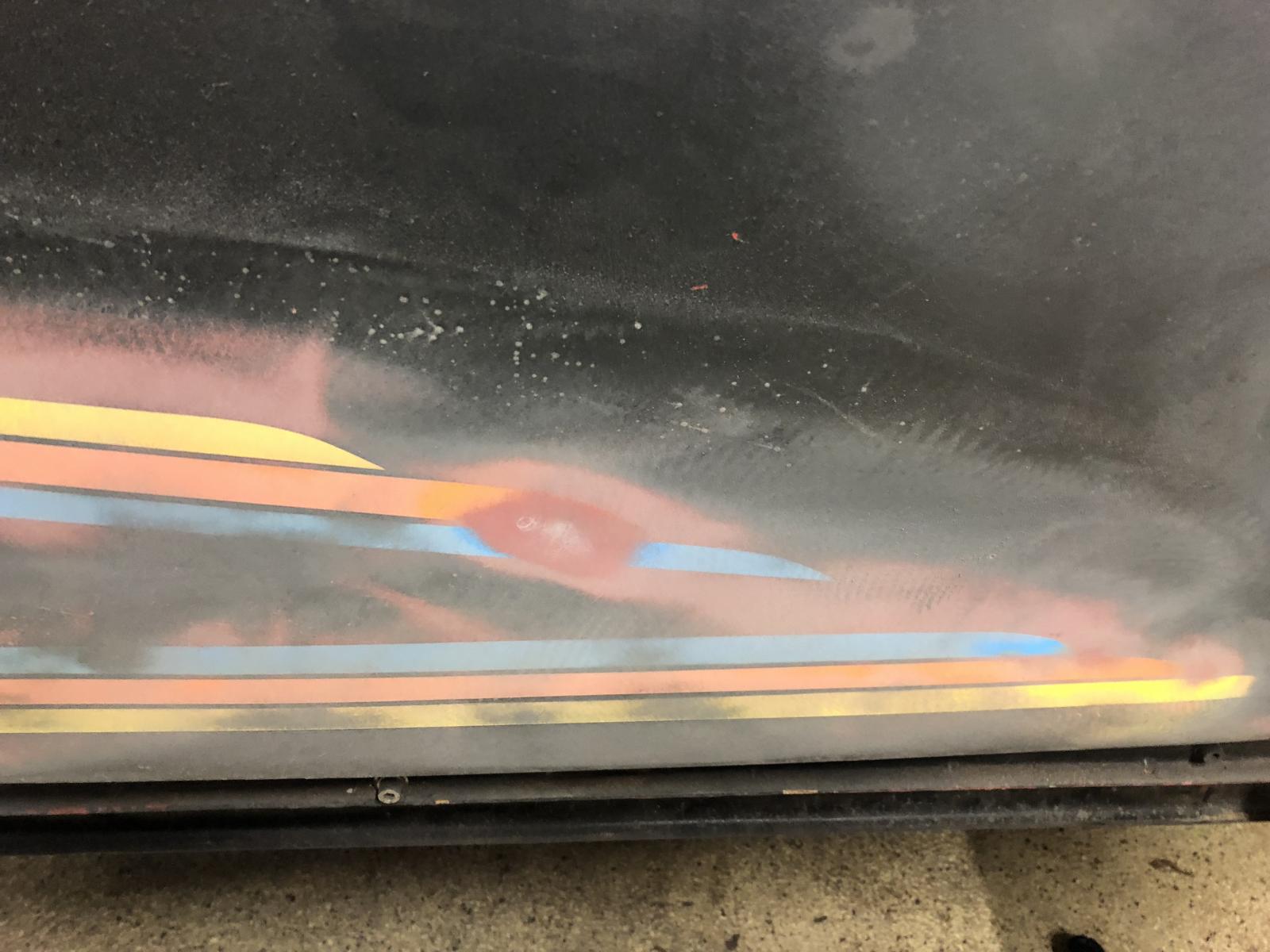

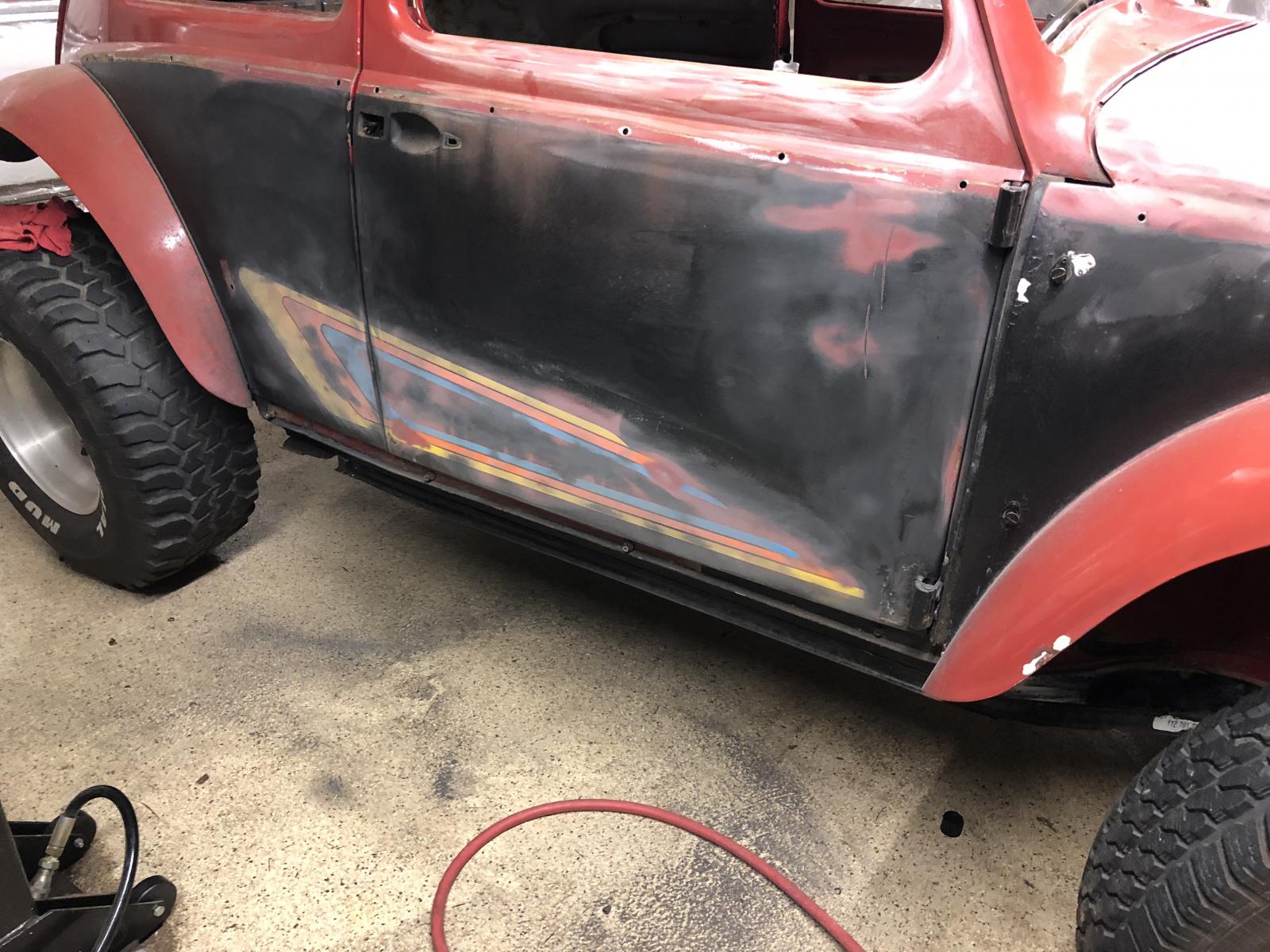

And I started getting the nasty peeling clear coat sanded off. I did uncover some pretty cool graphics. At first I thought the graphics were stickers but when color started being sanded off I realized that they were painted on in single stage. I could tell the front bumper side steps and rear bumper bars use to be yellow. I understand now why they were painted yellow. Once upon a time I bet this was one cool looking Baja.

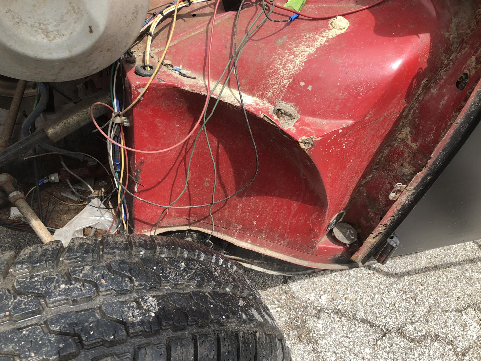

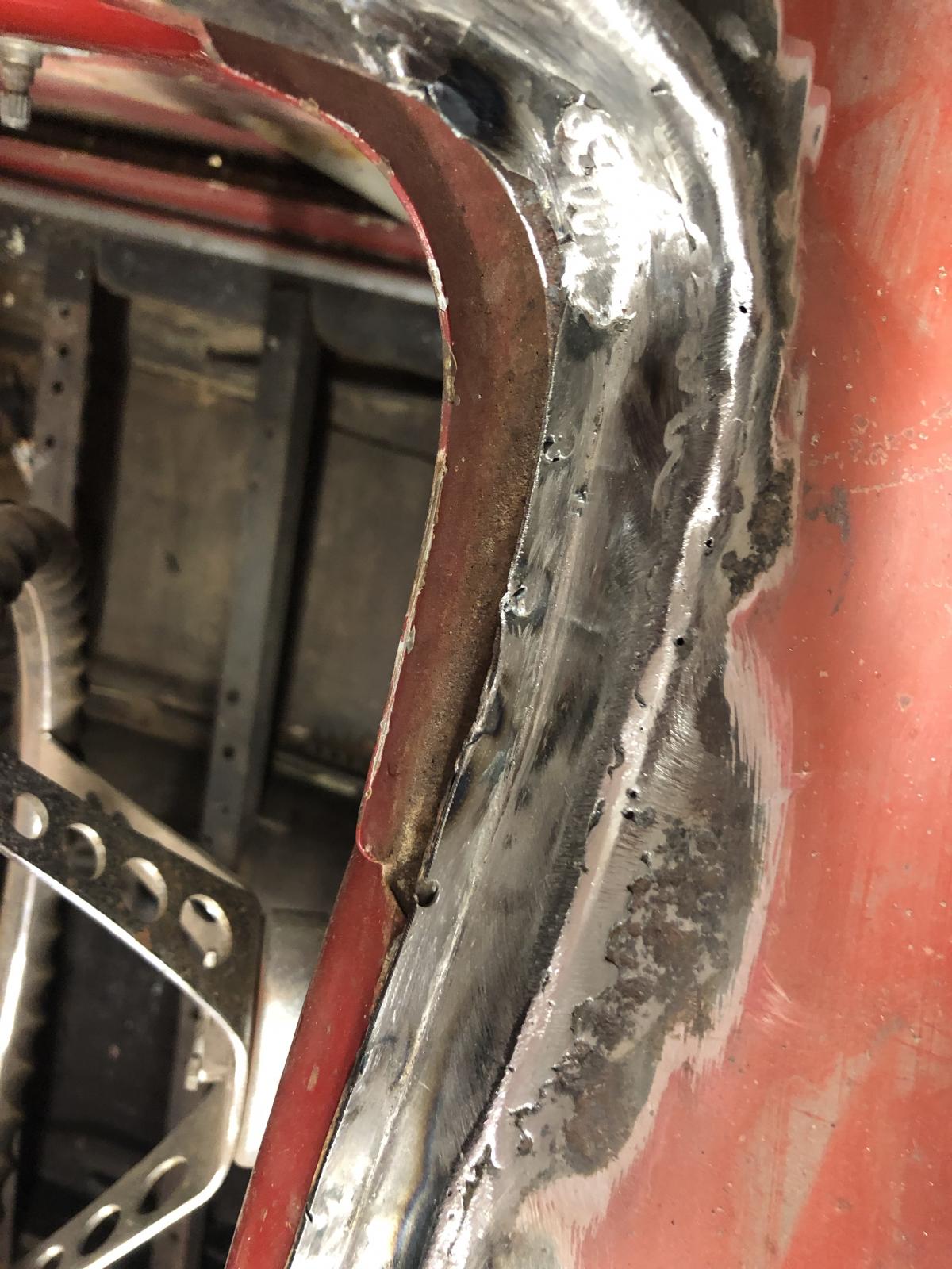

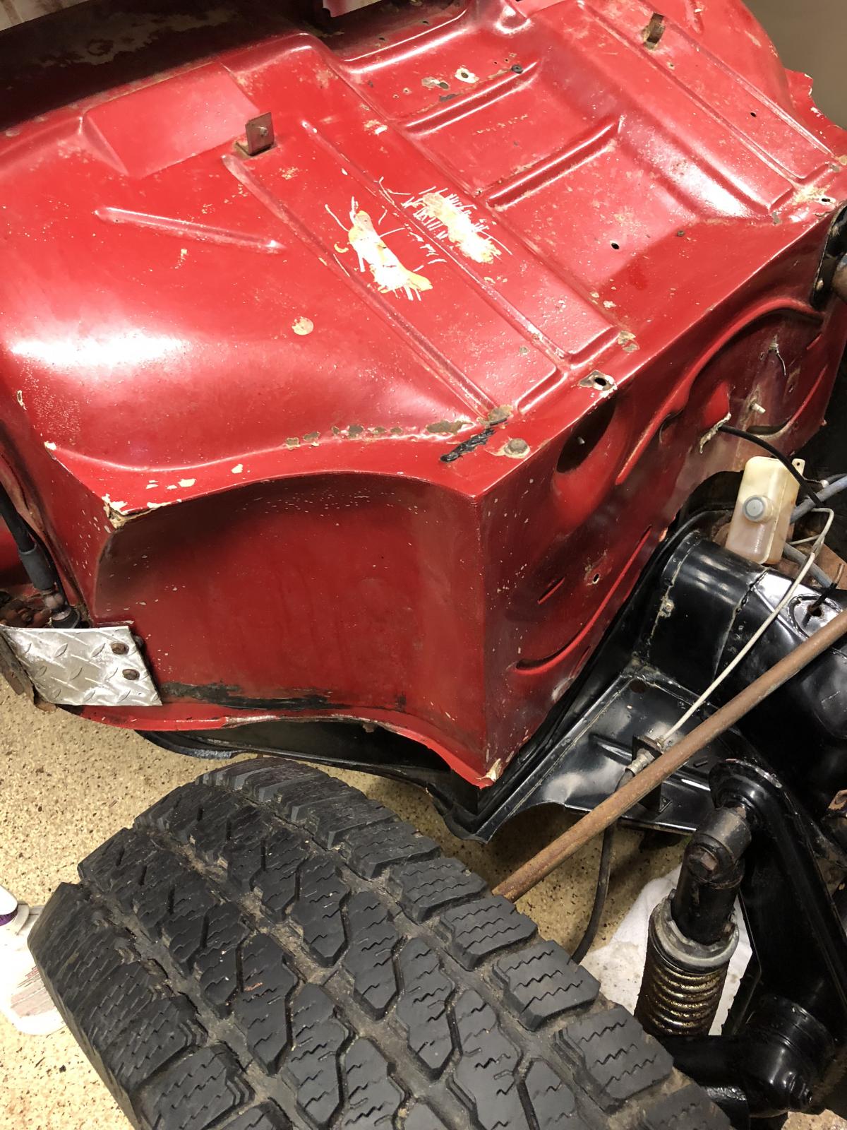

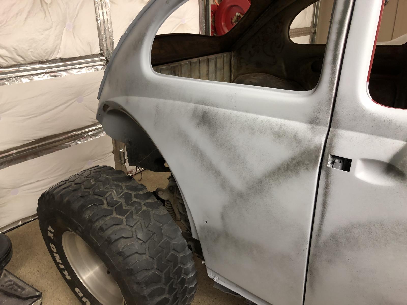

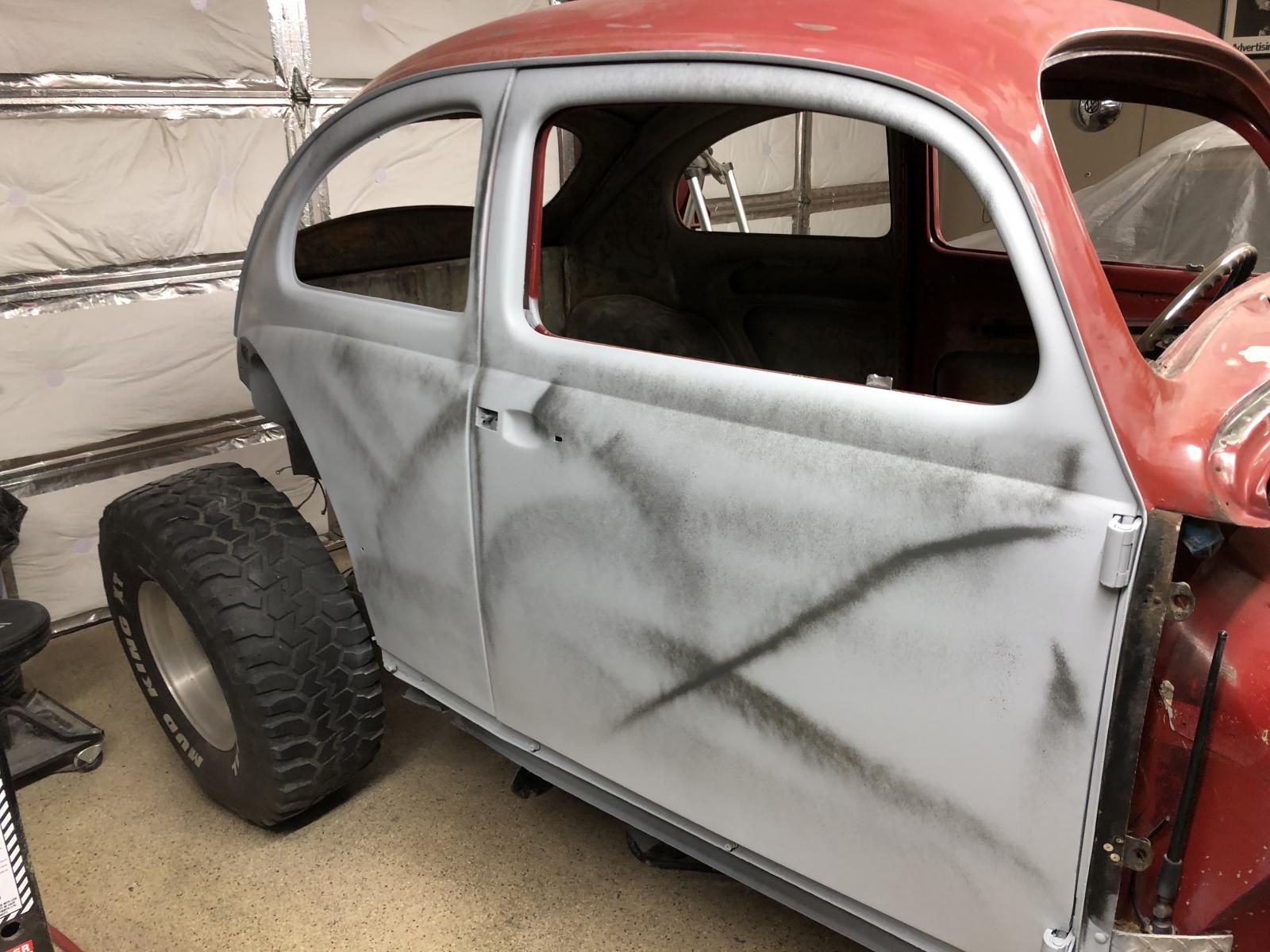

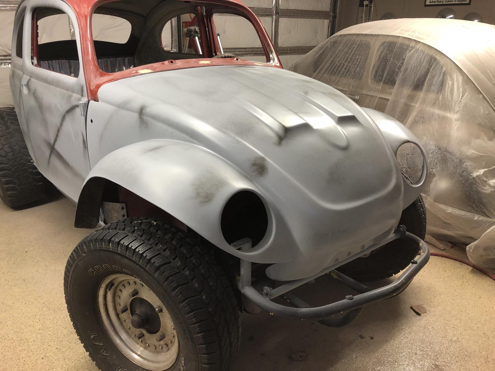

Well I knocked out a few things on my list. Got the trim holes welded up and fixed a rust hole around the front windshield.
I am also just about finished sanding off all the nasty peeling clouded clear coat.The black paint was just rattle can, I will get all that off prior to priming it.
I still think the old graphics are cool. My Dad doesn't want red, if he did I would talk him in to painting it just like it use to be. That would be pretty cool, I wish I could find pictures of the Baja in its glory days. I bet it was a nice looking Baja at one time.
My garage is a mess, that's a 56 under plastic to the right and 51 split to the left. It is gonna take a few days to pull everything out and clean it once I am done sanding. I am just doing prep here once it is ready to spray I will spray it in a buddy's booth.

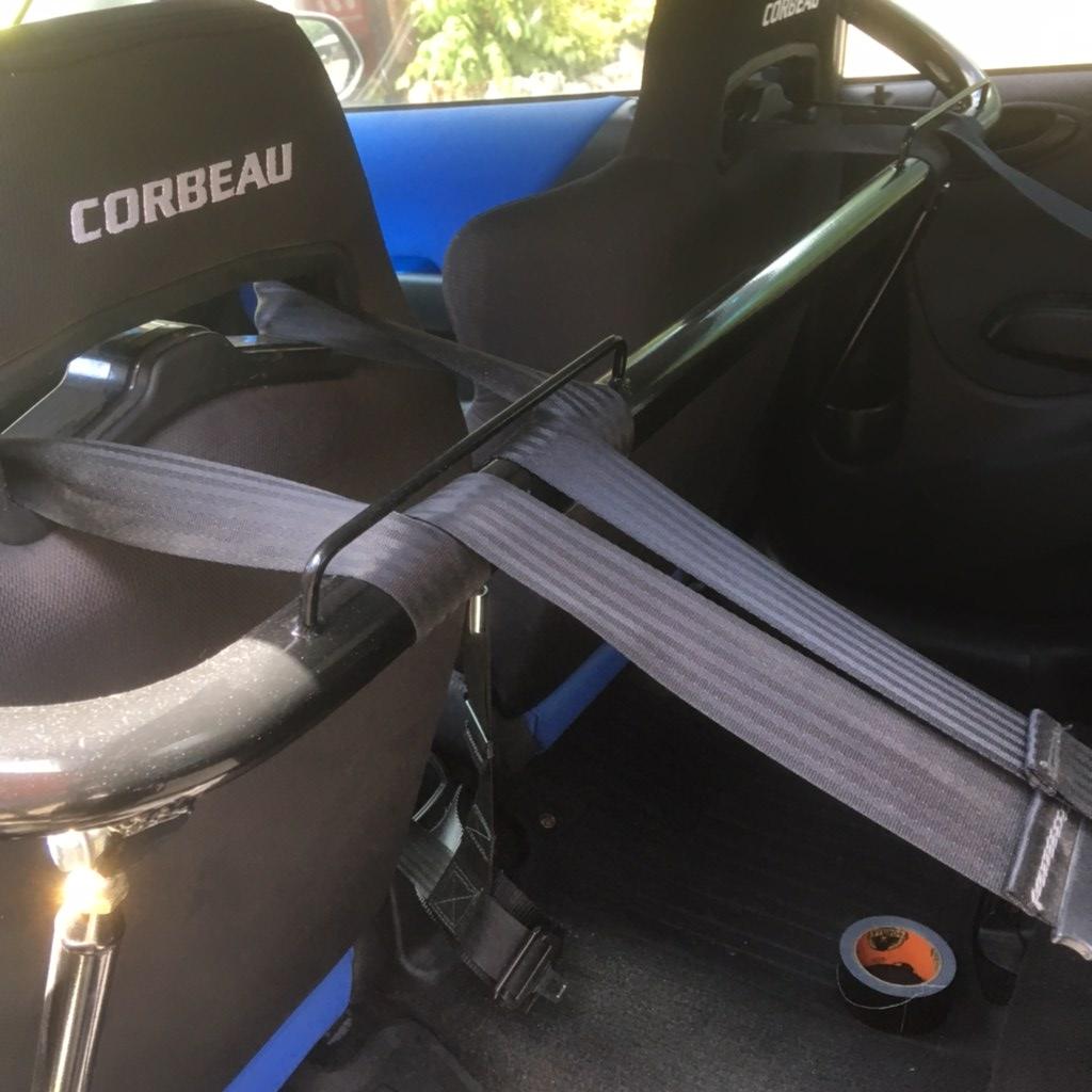

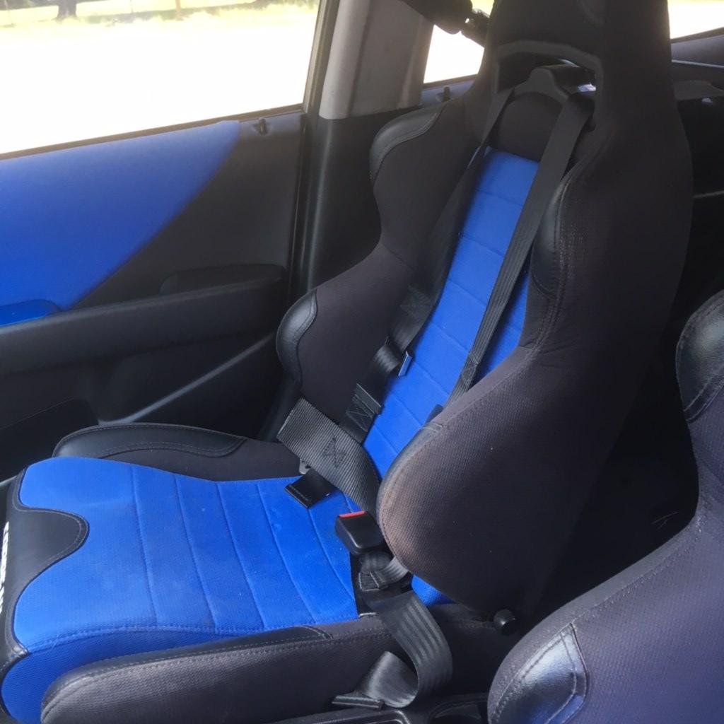

The whole reason that he wants to bring the blue into play is because we are going to re-use some seats that he has in his retired daily driver. He has had these seats since he bought the car new.
here are the seats:

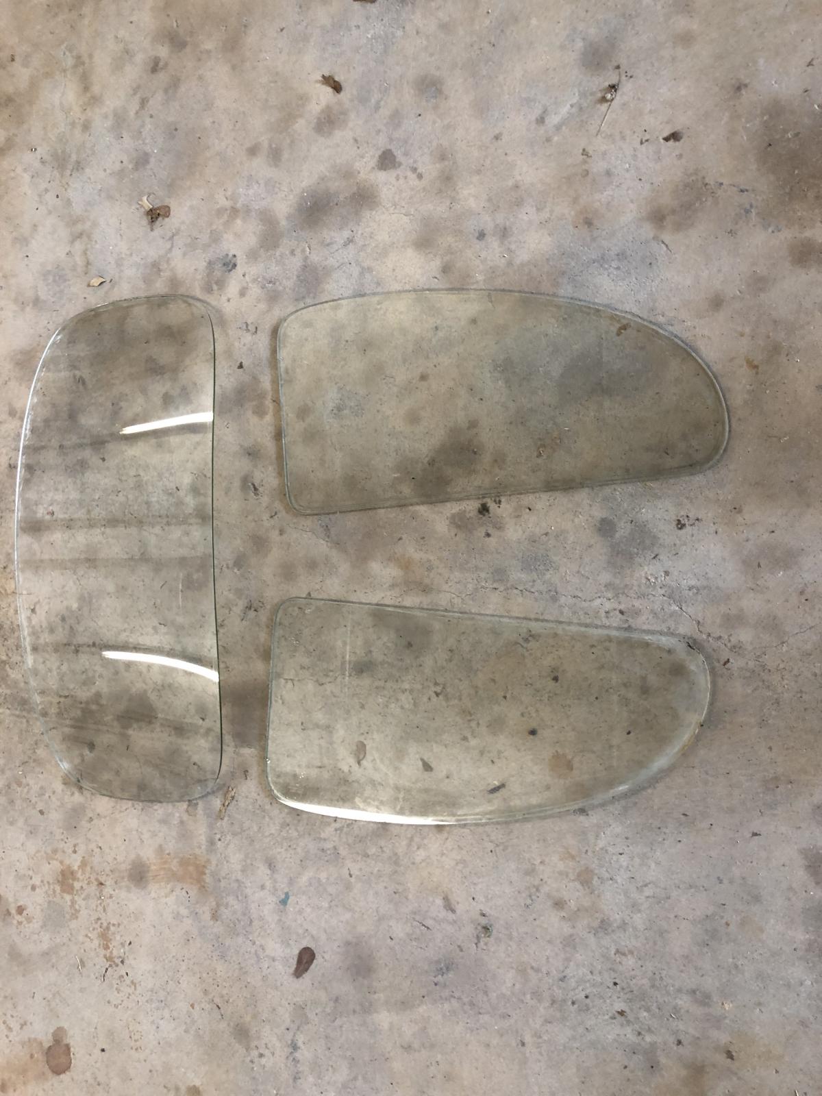

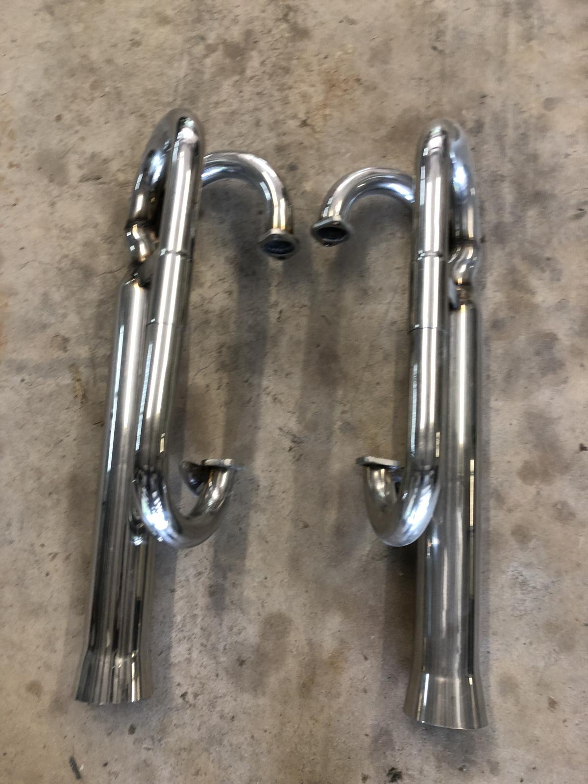

So I scored some awesome free stuff today. Which really helps because I am on a very limited budget on this build. I have to keep the cost all in at 10K. Buying the car was 3K then I scored a 1641 with new heads, P&C, and all new tin for $400 and I scored the passenger pan for $125. So I started the project with only $6475 to spend. So anything I score for cheap and or free really keeps the cost down.
So today was an awesome day. I scored a rear window, both side windows, and an exhaust. The windows I really needed bad, the ones I pulled out where plastic and purple from age. When I was looking at the Baja I just assumed that it had old tint. I never gave it a second thought until I stripped the car down and realized they were plastic.
Of course it's not the exhaust that Dad wants but it being free really helps the budget out.And as he saves more money he can eventually switch out to what he wants.

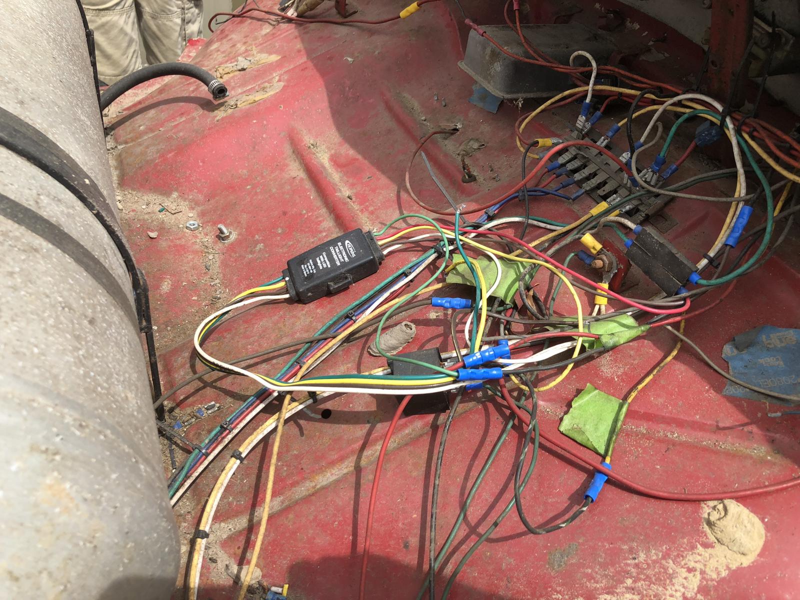

So today I ordered some things. I Ordered up the rebel harness like the one that is in my baja, everything needed to rebuild the doors, an Alt. for his motor and manifolds for the Kadrons that came with the car. I also ordered door panels from BigWig Racing, these are what Dad picked out:

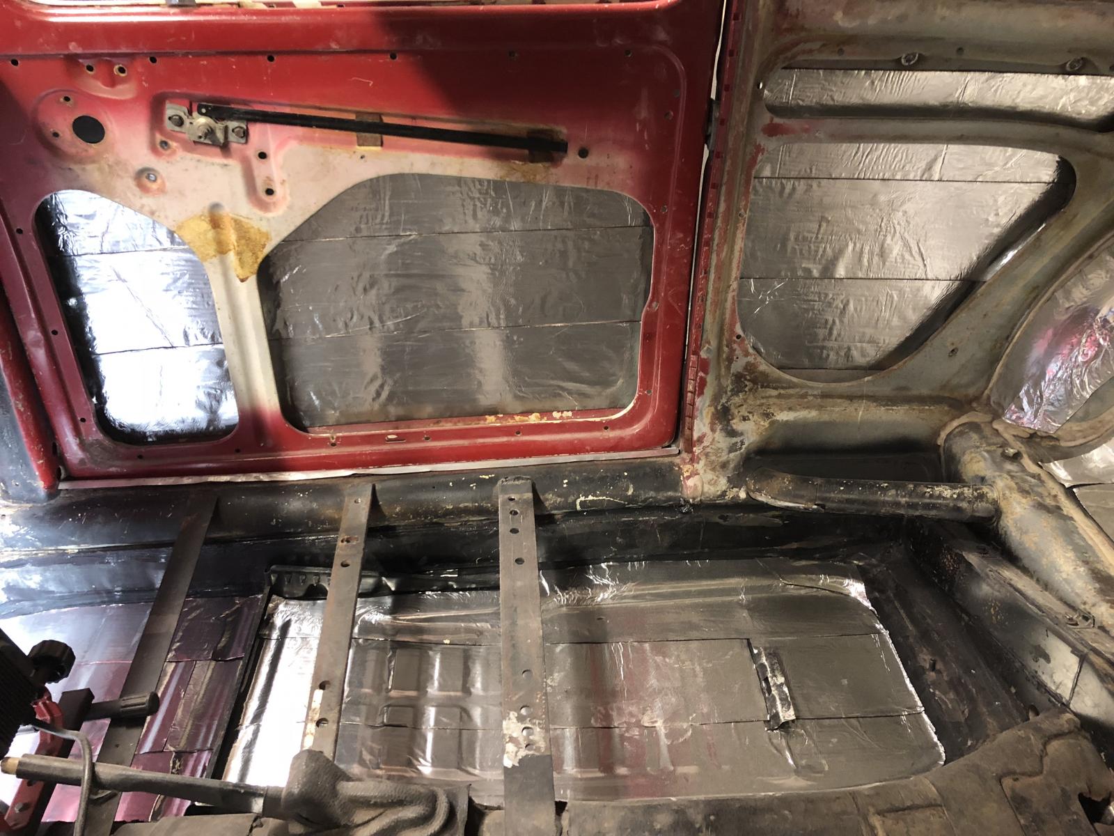

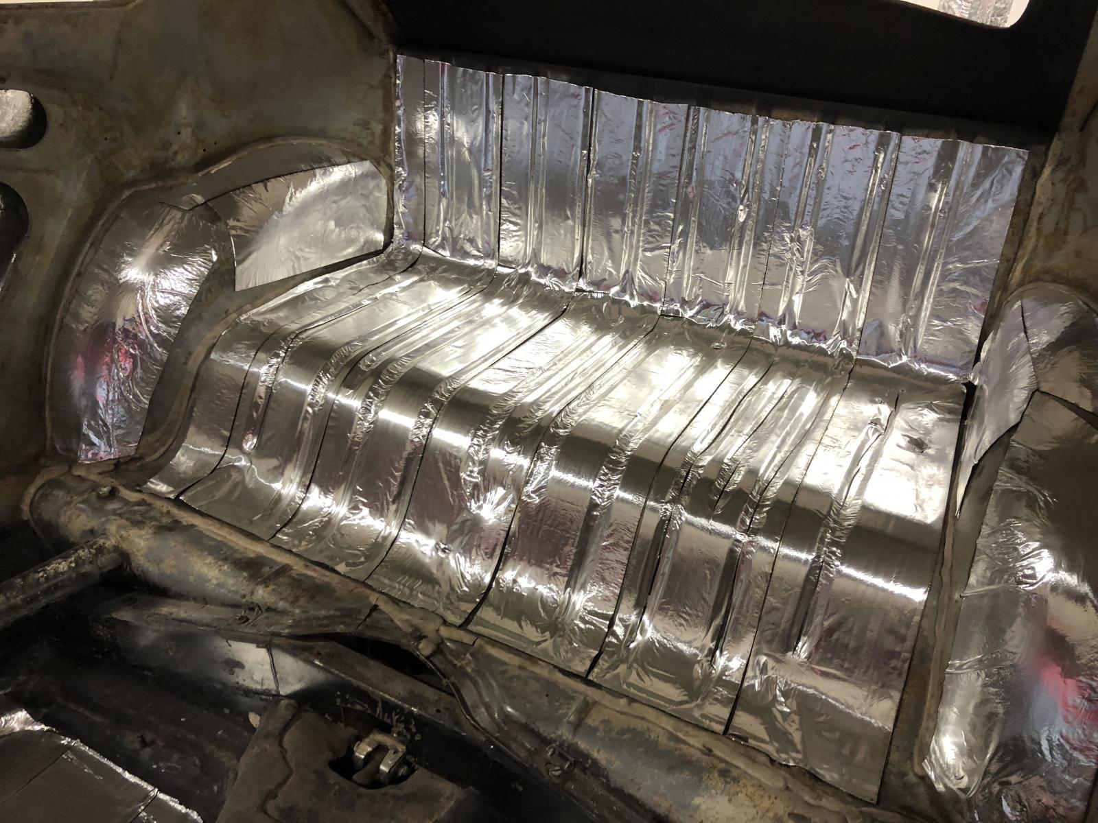

chipping away a little at a time, ran a bead of seam sealer on the inside of the pan between the lift and the pan and between the lift and the heater channel and treated all the surface rust with rust converter. Then installed some sound deadner ( yep the cheap kind from Home Depot) also got the front end primed.

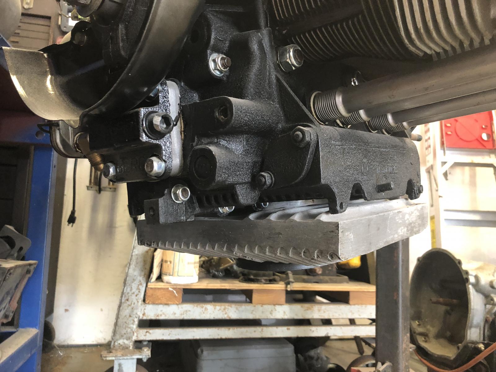

But note the drip pan under the engine. Embarassed
