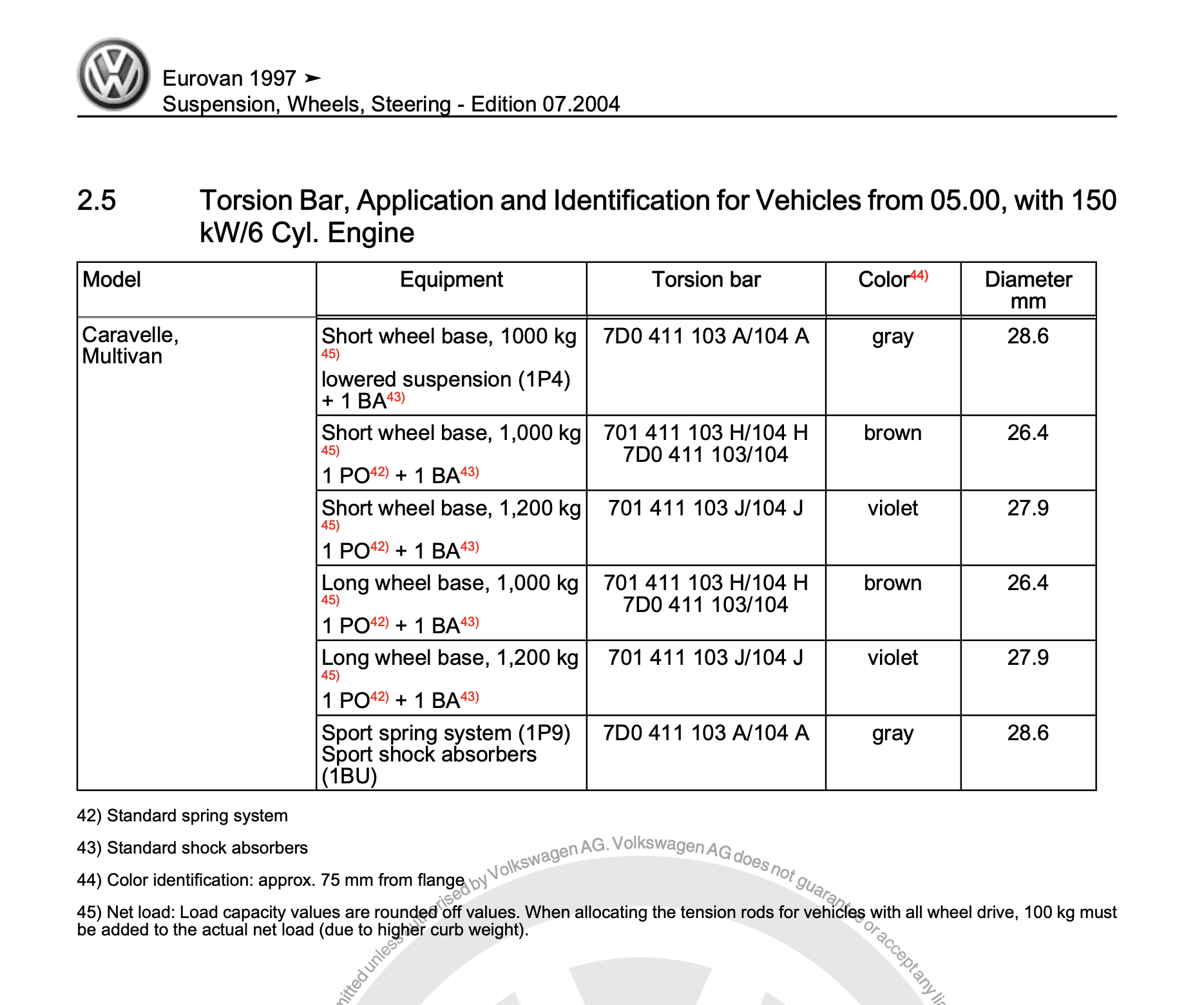

You can determine for yourself based on the Erwin notes for the AXK powered Eurovans (2001-2003). There are three torsion bar types available (gray, brown, violet) for the configs listed.
