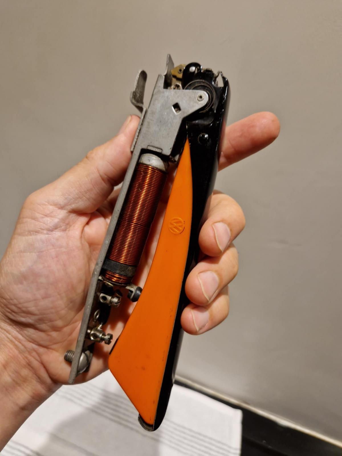

I foolishly (yes, I know) squirted some WD40 penetrating oil on a semaphore a year or so back,as it seemed to be sticking…as it was, it probably just needed a cleaner earth or cleaner wiring contacts
Then I read don’t do this, as it can will short out the solenoid…
I’ve waited some months, hoping the wd40 would evaporate, before trying again, but it smokes a little when I go to fire her up
Assuming I haven’t burnt it out:
Does anyone have any tips on how to clean it up/decontaminate it?
I’m also wondering whether it is possible/easy to remove the solenoid rod to clean the rod/inside the solenoid coil…maybe by removing that small pivot pin at the top?
Overall the semaphore looks to be in very good condition bar the missing solenoid coil wrapping.
Its matching pair is working fine.
Thank you

Electrical contact cleaner will clean it right up, and all the gunk will rinse out.
Hard to tell if any damage is done, but that's where I'd start. To lube mine I use some fairly light machine oil, almost like thread cutting oil? I dunno, it's in a squirt can here on a shelf.

Sewing machine oil might also be a good choice.

.it just occurred to me that I wonder if it's not actually a 'short' from the Wd40. When it flips and heats up it'll burn off that lubricant pretty quick, and you've seen WD40 smoke...it'll look like a damn fire.
I swear those flappy signals draw more amps than the starter.

You can rewrap the solenoid coil with High temperature electrical harness tape. Amazon has several possibilities.

You only need to lubricate the pivots. Any solvent in the coil can damage the insulation..
I’d use a little contact cleaner followed up with compressed air to blow it clean and dry..

Some advice: you never want to use any type of oil on semaphores. Unless they are sitting on a shelf and you want to stop and rust over the next 50 years.
All oil will do is attract and hold dust and dirt further impairing their function. Over the years a lot of crude accumulates in the coil affecting performance. A shot of oil can temporarily improve performance only to worsen in time.
