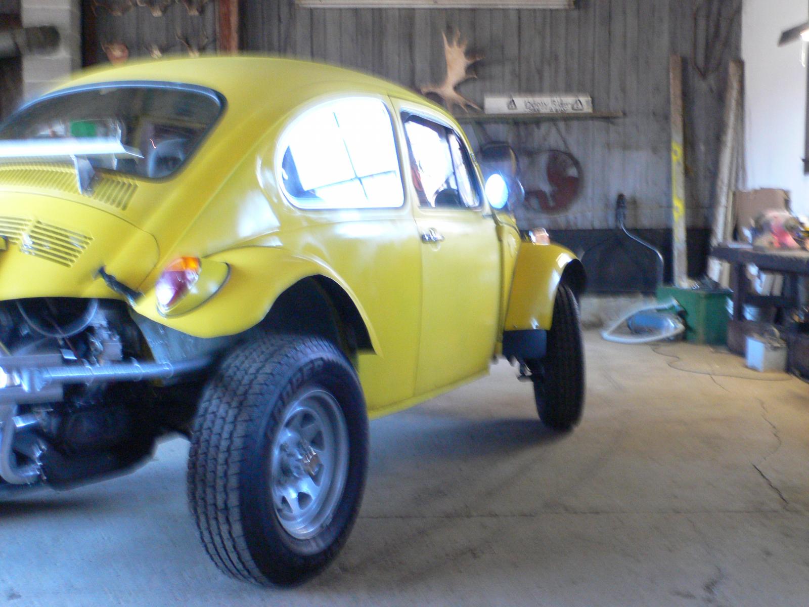

I have a 75 standard with the stock transaxle. Using 225/75x15 tires in the back. Lots of clutch slipping to go slowly enough on the class 4 roads around here. The 75 has a different nose cone mount which might limit swapping.
Needing advice as to which gearing would work best. Hope to tackle the Trans america trail at some point, probably hauling a small trailer. Thanks residents of the dirtpile.

A 4.37 is great with 29 inch tires 235/75x15.
The rear tires you have its going to be a buzz box on the highway. 4.12 would be better if your doing a bit of on road driving. IDK what came standard in 75 you might have a 3.88 or 4.12?

I think '75 got the single side cover transmission. If so, stock its 3.88. You should read the sticky on this forum "Transmissions for Dummies". I had a class 11 bug with a 1776, the single side cover 3.88 trans, 215/75/15 tires, and it was a dog on the street, let alone trails. I also have a fiberglass buggy, that has a 1915, 30x9.5x15 tires, and its on its second trans with 4.37 gears. I wouldnt go with anything else. It might not be awesome on the freeway, but its fine, and great off road.
If you do have a single side cover transmission, its the strongest type 1 case built, so you might want to have it rebuilt and modified for 4.37. Both the transmissions on my buggy (one was swing axle, and the 2nd one is now IRS, and a single side cover with 4.37) are prostreet style, meaning 3rd and 4th are stock, not close ratio, so on the sand, or large hills, I rarely hit 3rd, staying mostly in 2nd. The prostreet has several other modifications to help it last. I actually had a 5 rib bus trans in my buggy for a while (4.86), but didnt like the slower shifting and heavier feel, so went back to the type 1 with the 4.37. More fun to drive.
I hope this helps.
