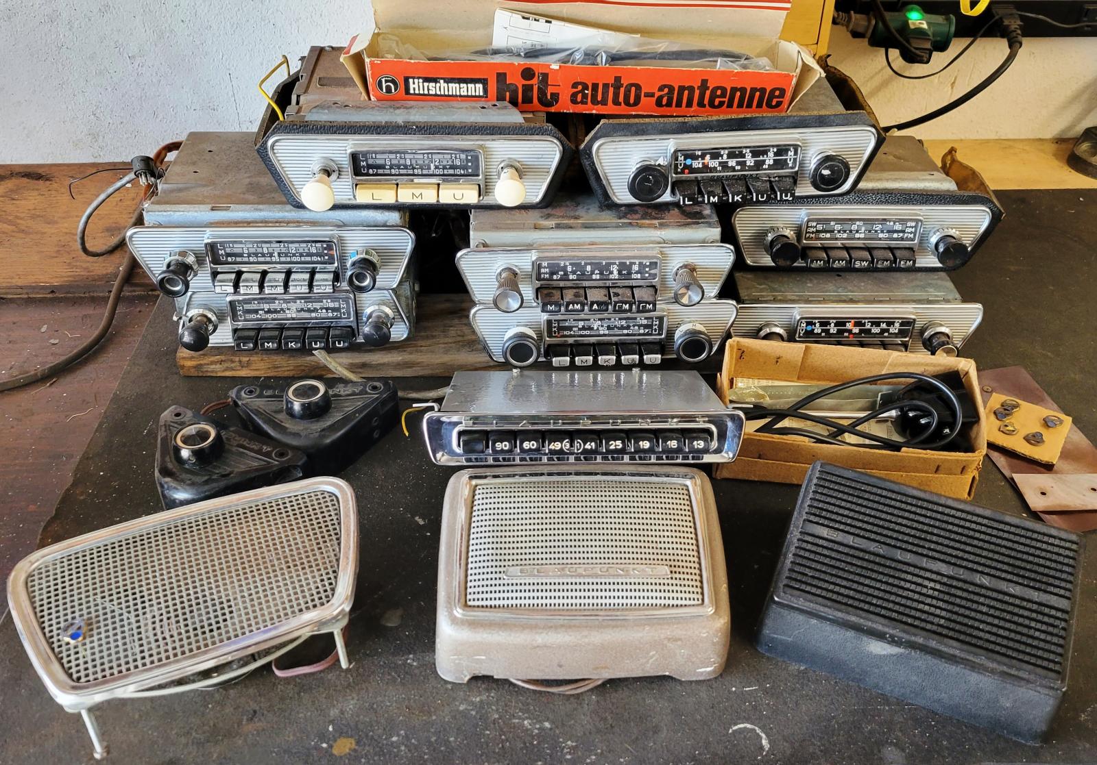

I'm sick in bed killing time with my wife's macbook air and this is the only photo of my radio on this site.
Below is the Essen, the only photo I can find on the site [albeit uninstalled] with has a T3 plate - Upper left.
Eight years ago I sold my Frankfort.
https://www.thesamba.com/vw/classifieds/detail.php?id=2052334
